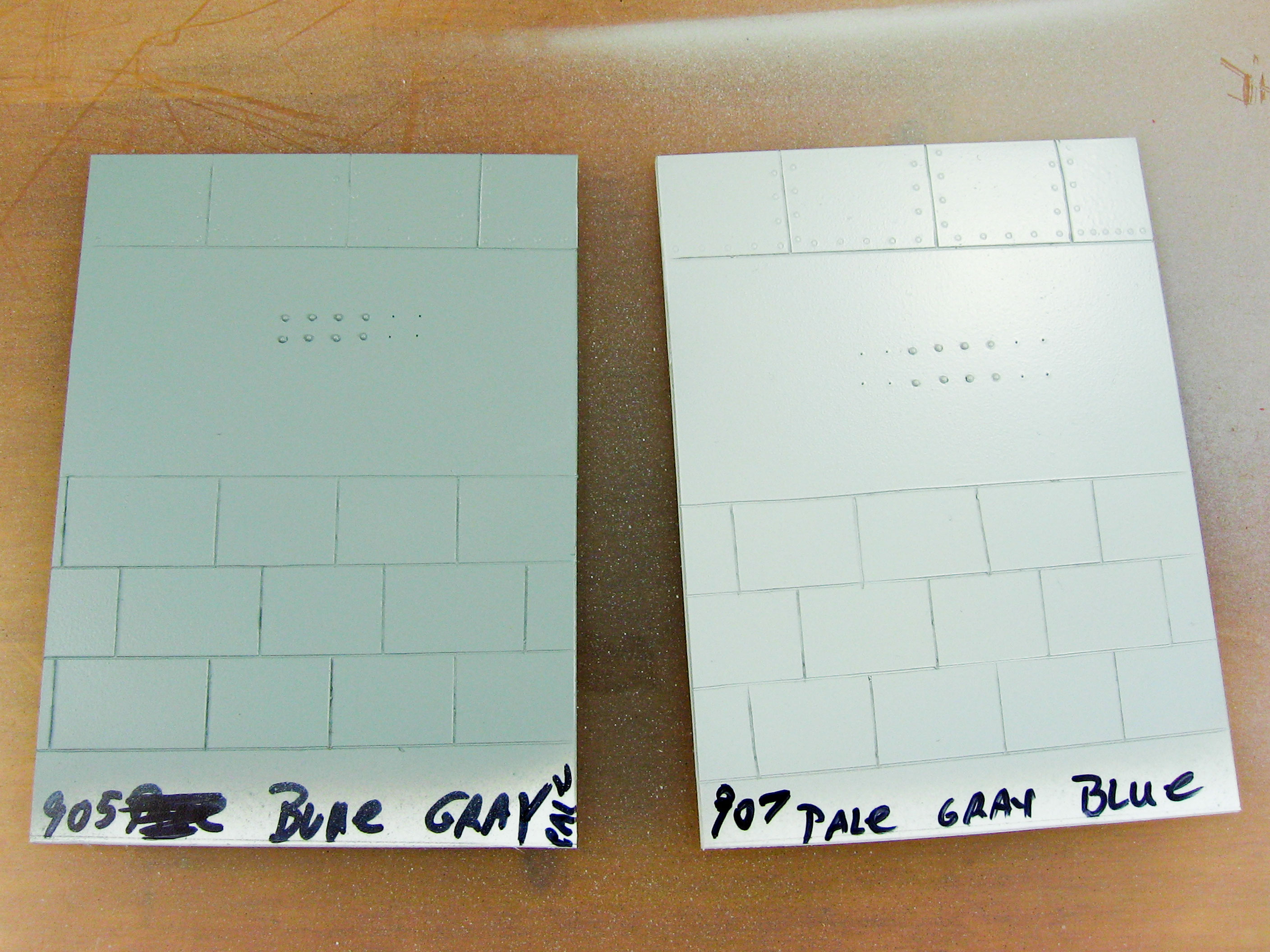

I made two test sheets. Styrene sheet, scribed with a facsimile of the deck plating, added eight raised bolts, scribed the side hull plating, and put in a bunch of flush-faced bolts. Essentially all of the work I've done on Weehawken's exterior surface on a small scale. I've got two contenders for Weehawken's described "lead" color, both are Vallejo paints. Pale Gray Blue (manufacturer #907) is mostly a simple light gray. Blue Gray Pale (905) has a bit more blue and life to it, so I think that will probably be the big winner. You can see from the photo that they're really close in hue.
The reason I made up these two test plates is so I can test weathering before I apply it to the ship. I've never built a ship in this large before (1/96). Also, Vallejo paints has this cool glaze medium that creates awesome effects. I'm going to apply a glaze of 907 over 905, and vice-versa, see how they turn out, and give both a wash of oils. The best looking results end up on the Weehawken.

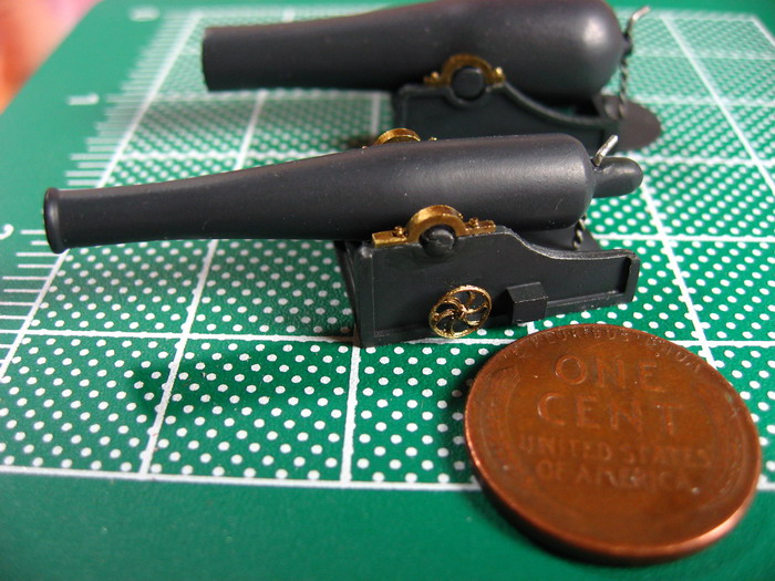

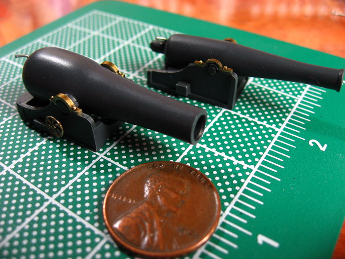

I'm so happy with how these Dahlgrens turned out that I have to share pictures.
The guns themselves and the carriage for the XV-inch gun (the fatter one) are from the Weehawken kit. I scratch built the XI-inch mount carriage, turned the elevation screws out of twisted steel wire, made the handles out of bent straight pins, made the brass trunnion caps from styrene tube and strip, and the hand wheel and hex bolts on the trunnion caps are from the Grandt Line HO scale catalog.

Yes, I'm going with the Blue Gray Pale, the more blue of the two. I've stripped and re-applied about 20 coats of paint and glazes and washes over the past few days. The conclusion is that I've put too much work into this to much around with new experimental techniques. She'll be getting a wash, dry brushing and pastels for weathering, save the glazes and overcoats for another day.

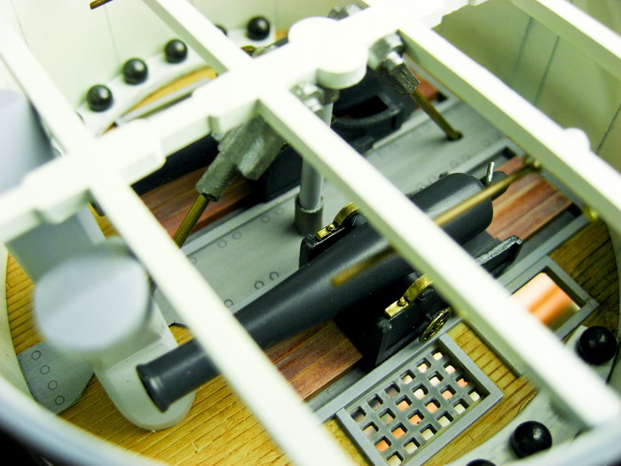

Finished up the turret tonight -- well, the inside at least -- and now the guns are in their permanent home.

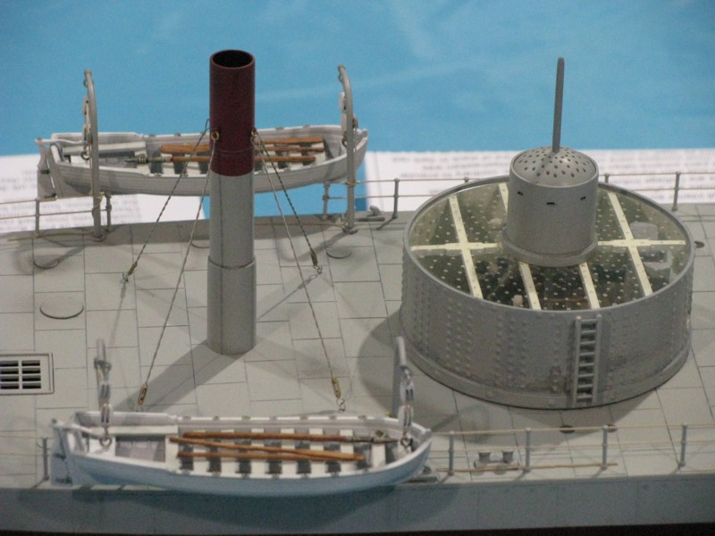

Getting very close to finishing her up!

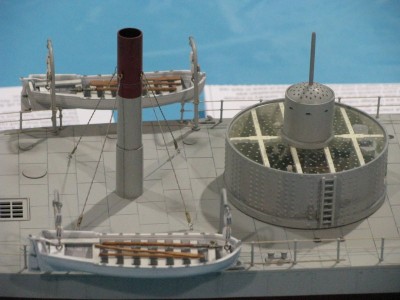

Just two quick photos before I run out the door this morning. She's basically "done", but I will add more figures and some more lines on deck this coming week before MosquitoCon next Saturday. Even though I made a few flubs I learned a LOT building this kit and really enjoyed it. Once I finish the rest of the lines on deck and get a new bulb for my photography lighting I'll post more detailed photos.
Oh yeah, and I still have to make a flag for her. The one I have just didn't cut it.

Devin ran out to the RepliCon show in Long Island, where Weehawken took a 2nd place in the Powered Ships, Larger than 1/500 category. Well done!
