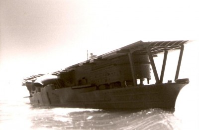

Back in 1987-89 I experimented with taking B&W photos of my 1/700 waterline ship models using a pinhole camera lens. A pinhole lens gives great depth of field and allows one to get very close to the model and still get a relatively sharp image. Exposure times varied between 2-5 minutes which necessitated mounting the camera on a tripod and using a shutter release cable. For "water" I used scrunched up plastic Saran-wrap laid out over a large swatch of black velveteen material. Background sky was an HO-scale railroad photographic backdrop with clouds printed on it. Overhead lighting was a standard shoplight with two fluorescent bulbs.
Funnel smoke and gunfire were simulated using a cotton ball dirtied up with powdered graphite and then shaking it for a minute or two during the exposure. The long exposure times often washed out the finer details (and the clouds) but that was sometimes okay because I wanted to replicate the look of old WWII naval photos.
The ships pictured are Japanese carriers Akagi and Shinano and British battleship HMS Rodney.
Has anyone else tried doing this type of photography with their ship models?

Interesting effect. I've never tried anything like that. I do well to take straight up photos of my models to post here. The do look very much like period photos of the real ships. Well done.
Bob

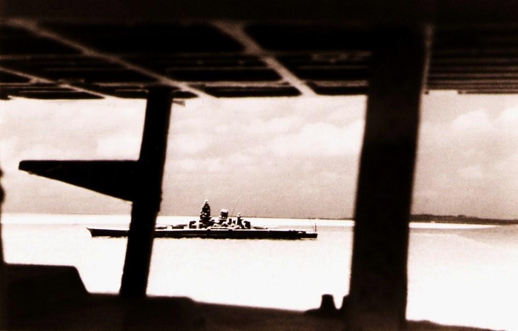

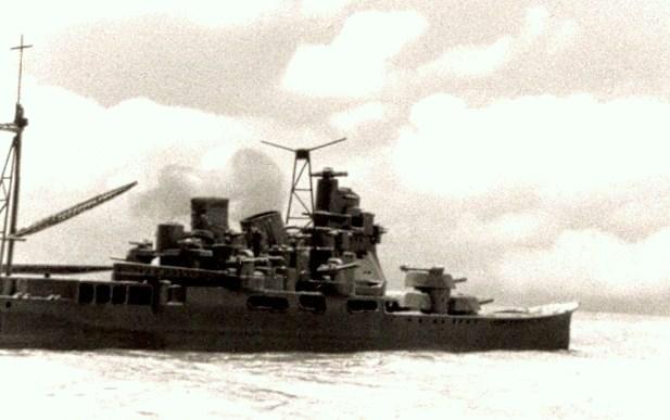

Here are a few more pinhole lens waterline ship model shots. The Yamato one is a forced perspective shot. The foreground model (1/700 scale) was the aft end of IJN carrier Akagi. The IJN Yamato model in the background (as if anchored at some deep-water Pacific atoll) was probably 1/1250 in scale.
For IJN Shinano, I tried to give some depth to the photo by placing a ship's railing in the foreground and an unspecified dome-like structure to the left, as if one is viewing the carrier from an accompanying cruiser or battleship. The second Shinano photo was an attempt to make the carrier look as if it were burning from a torpedo or bomb hit.
PostPosted: Thu Oct 27, 2011 11:11 pm
Posts: 582
That is an awesome idea. For a few, if I didn't know better, I would claim them to be true period photos.
