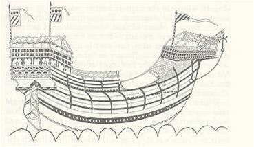

In these early-mid 15th century versions, the forecastle was normally just a single level built on a very high bow, later types had the multi-storey, mind boggling tower-like castles.
Timbotta ms 1.jpg (15.47 KiB) Viewed 4050 times
The sketch I'm basing it on shows it to be mostly open latticework, with an anti-boarding net support structure above.
I've been thinking about how I'm going to achieve it, and the stern castle is going to need a similar construct, too.
Cutting plastic sheet down to a useable size is going to stretch the material's utility to just about the breaking point, but, in my opinion, I don't know what else is going to capture the right "look", if not "feel".
