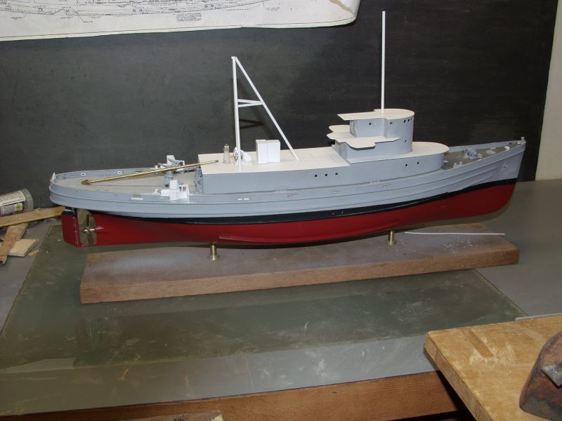

Been visiting this site for awhile now and now have enough material on my build I can start posting something. This is the first time I have used styrene as a building medium.
I served on the Takelma from 72-75 home ported in Pearl Harbor. I started this project with a prebuilt fiberglass hull and basic deck house. Knowing what I now know I would have built my own. Since I had already bought them I am using them.
First steps were cutting off the molded bulwarks as they were to thick for scale and adding bilge keels and building the rudder.
Made some mounts with a temporary build board. Used some .060 styrene for the main deck.

I think you will like working with plastic over Fiberglass.
I would advise to keep on a lookout for 1/96 scale parts. Everything seems to be in short supply these days. From Kits to paint, AM parts to Testors Glue, times are tough all over.
I will be following along. Thanks for Posting this.

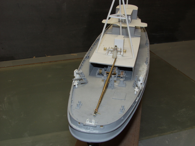

Here are a few more photo's of my build.

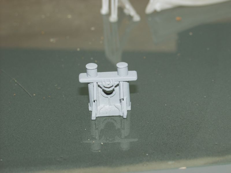

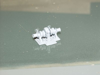

Also some of the smaller parts

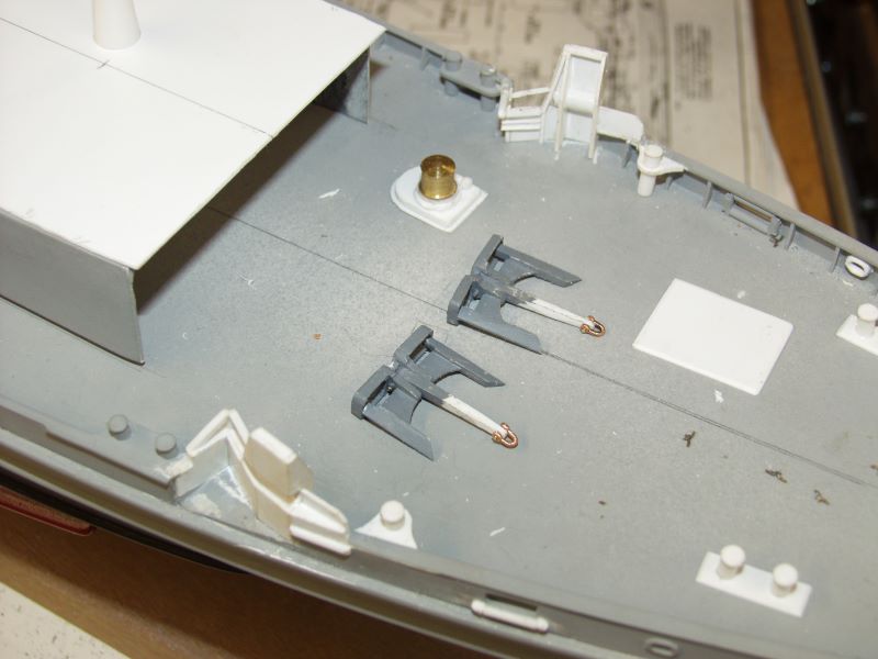

Well after finding a drawing of the Ellis anchor I was able to make up a pair.
After which I was able to build the bill boards that held them and even than it took me about 5 tries to get them right.
I am currently looking for Hi-Viz hull numbers and letters for this build. I know Hawk's graphics has the hull numbers and are working on hull letters. Does anyone else make hull letters in 1/96 scale? Printing them myself is most likely above my pay grade.

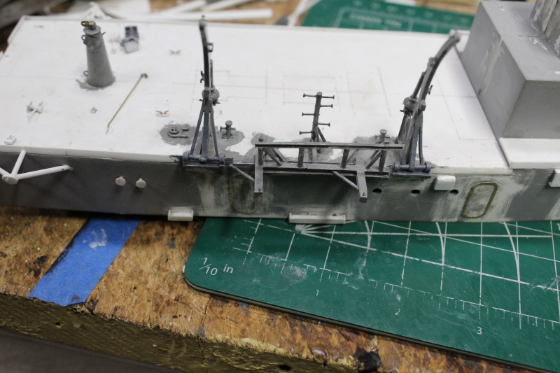

Well It's about time I posted a update on my project. I have been working on it but very slowly. The first picture is of the boat davit and only took me 5 tries to get things correct
. Still have a few things to add to it. Some other pictures of the project.

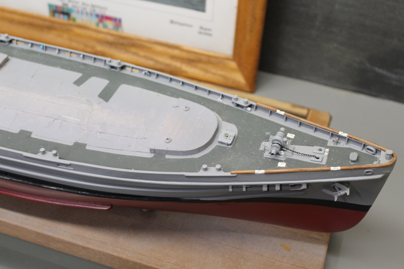

Here's a few more pictures of my project. I used some wet & dry 1500 grit for the nonskid. Oh and never mind my messy bench top.
