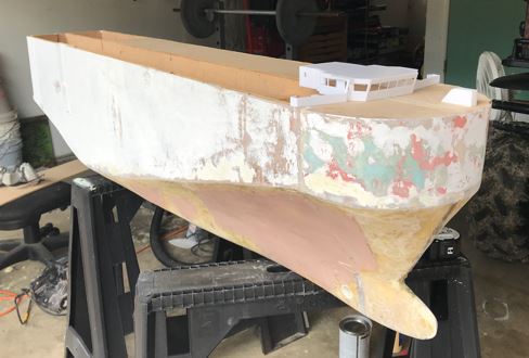

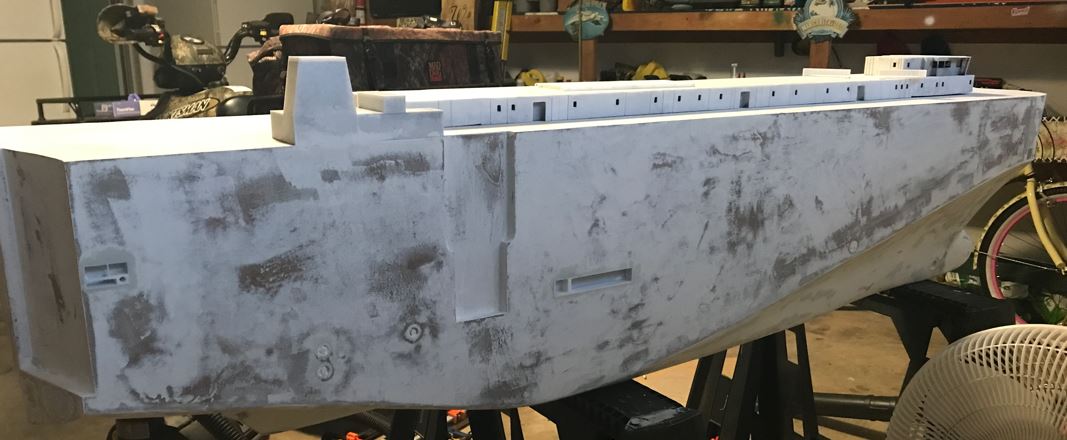

Progress on the modern express has finally picked back up. I redid the hull with polyurethane foam and redid the fiberglass. Currently sanding and filling.
Bridge/other structures are 3d printed on this one

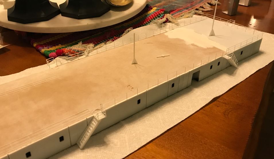

Currently printing walls for the rest of the main structure

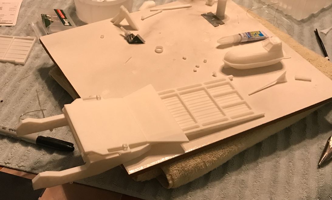

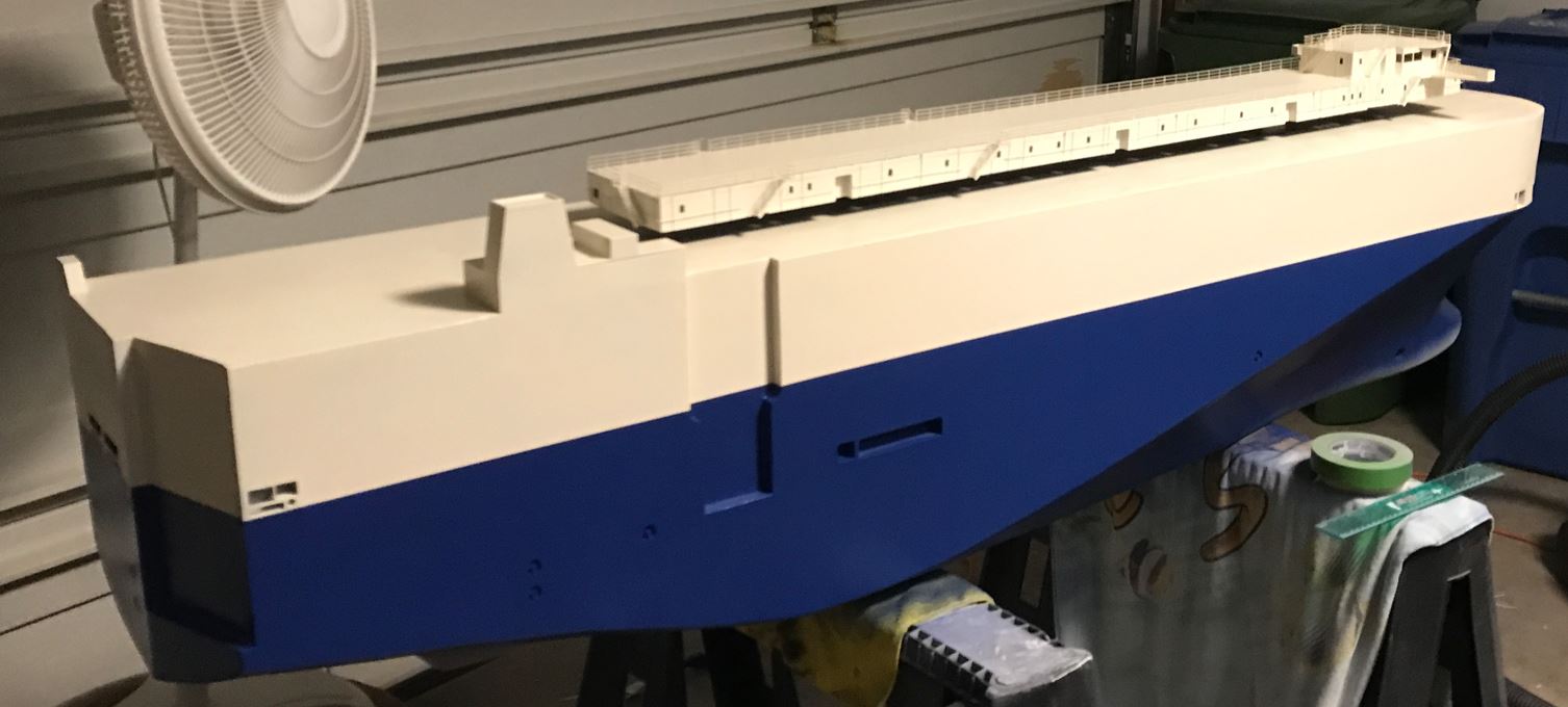

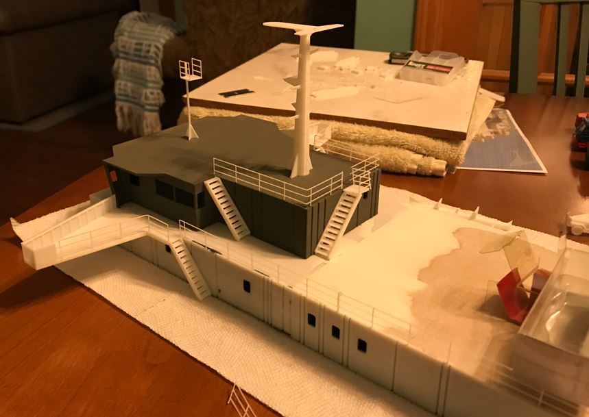

Progess on the Modern Express: lots of sanding, filling, priming, and finally - the first 2 colors
Working on the sternramp and lifeboats now.
Does anyone have a method for making DIY decals with white lettering?
MikeGR, using polyurethane foam allows you to fiberglass right over without it melting the foam
