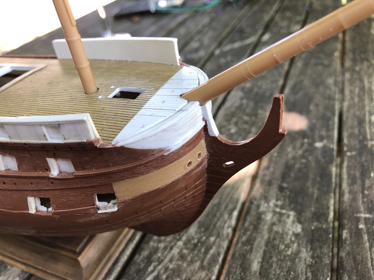

The next update: I assembled the lower mast parts, including brass rods into them to add stiffness. This will later be vital to get the rigging taut.
Then I modified the mast sockets on the keel: each of the three masts requires to be repositioned several mm to the rear. The relocated holes in the lower deck served as a guide to create the new sockets. In this ship the masts are all three square to the keel: this is not the case with most 17th century sailing ships.
Then I modeled the forecastle bulwarks from scratch. To have them firm and strong I included brass pins into them, seven in each. Holes drilled into the kit hull rims to receive the pins. The results look good in my view.

Great job Maarten! :thumbs_up_1: :thumbs_up_1: :thumbs_up_1:
A very clever and simple solution for the gun ports! :thumbs_up_1:
And a good idea too to replace the (visible) decks. That will give you much more flexibility.
Have you thought about thickening the hull walls? I may be mistaken, but the kit's hull sides look pretty thin to me. That's a common defect with plastic sailing ships, caused by the limitations of injection moulding (at least back when these models were first made). At the lower gun ports, I think the walls should be about 3mm thick in 1/150 if I remember correctly. But maybe just a little thinner than the real thing would still look ok. You wouldn't need to thicken everywhere of course, only around the gun ports etc.
I will be following this thread with great interest! :smallsmile: :wave_1:

Regarding the wall thickness: I hadn't given it a thought yet, but I think you're right: at least when viewing the gun ports the thickness of their frames should be around 2 mm, or one foot in reality. When I will install the lower gun deck (with the 36 pdr guns) I will add a strip, or smal strips vertically to simulate the frames. The thickness of the kit wall is 1 mm so adding one mm should do. I was also wondering when I added the bulwark to the foc'sle to add 0.5mm there as well.
Dafi, I found that on your marvellous Victory you did a similar thing, right?
