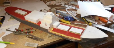

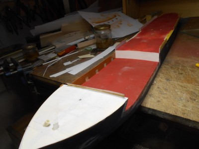

The frames are filled with balsa. Now it's sanding time !

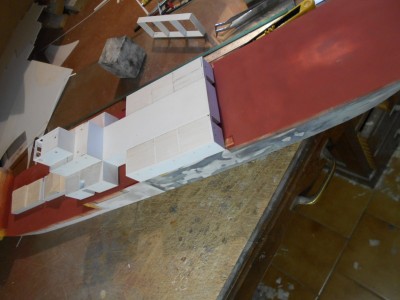

I never thought a styrene clad hull would need so much sanding
File comment: the superstructures are made with 1mm styrene filled with balsa wood

Intersting construction technique! Tremendous amount of Balsa wood involved, being far from the source here, there probably isn't that much Balsa in the entire state! That should be a method allowing accurate hull shape. Are you using some laser technique for cutting the styrene or standard knife and ruler techniques? Makes for a clean construction.

Hi Fliger !!!!!
Balsa is not very expensive, it cost me 20 euros on the net .
Concerning styrene I glue the shape printed on paper with a glue thats peels off easily without leaving any trace (PATTEX repair 100%), then I cut with Xacto blade and then peel off the paper.
I tried laser cutting on styrene but the cut is too large.

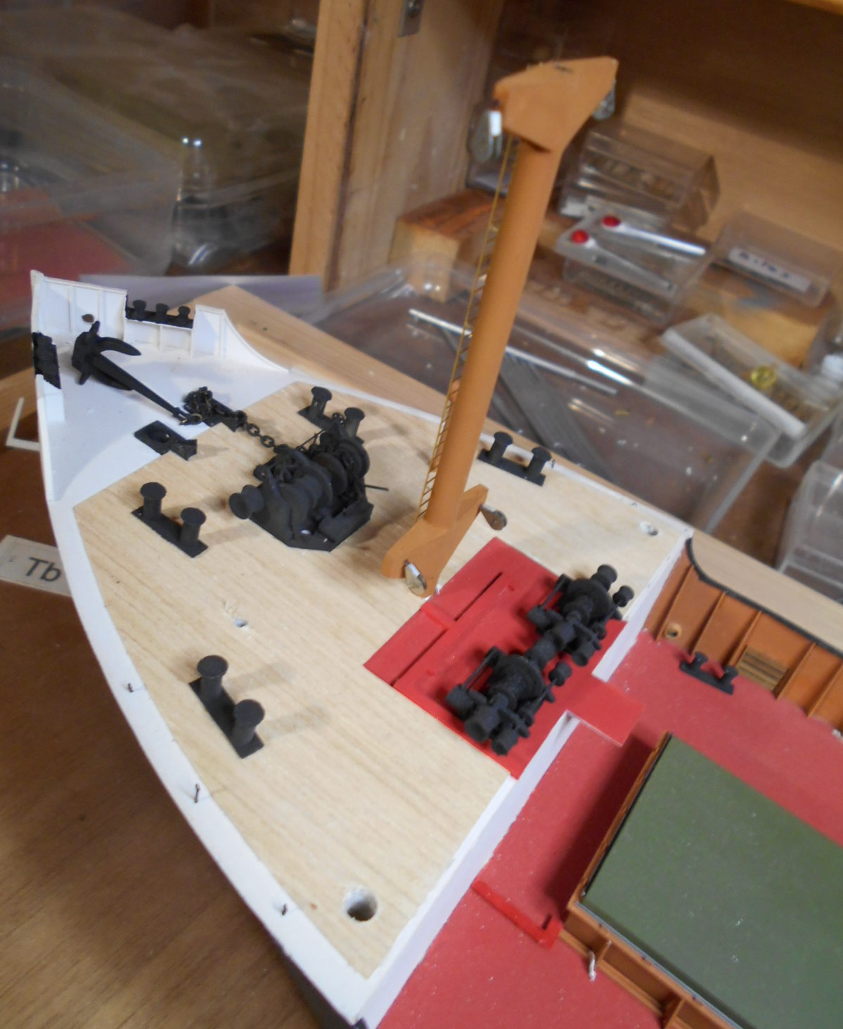

Location: france

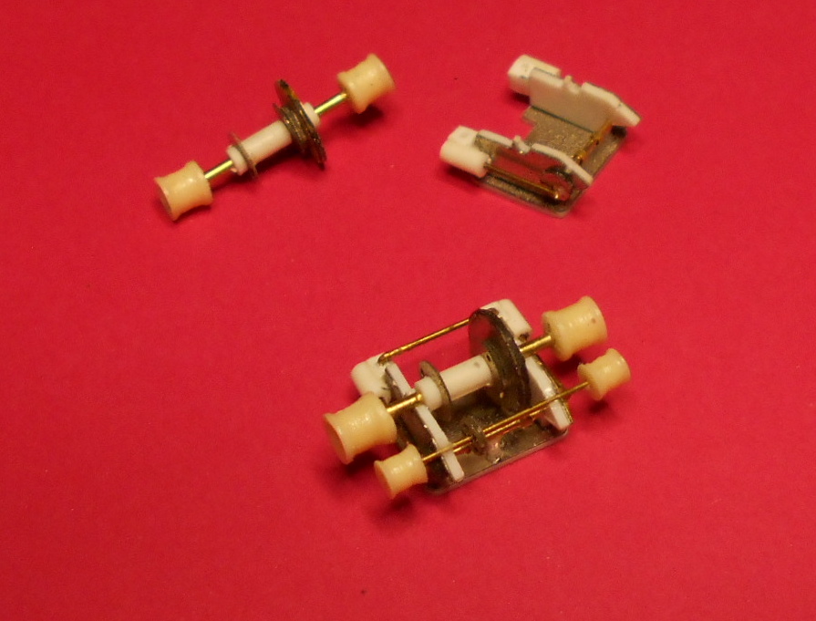

I've worked ond the windlass and the cargo winches. here is how they look before painting. I made them from photoetch styrene and resin mouldind for the winch drums. Some handles are missing , i'll glue them later as tey are too fragile

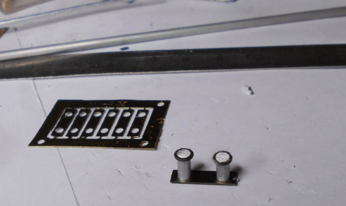

Bollards are made with custom photo etch and aluminium rod.
The winches are now painted.
The mast is made from aluminium tube and the ladder is cuqtom photoetch

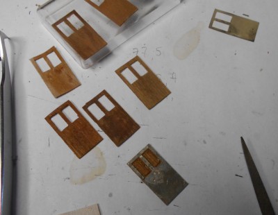

The little wooden shacks (I don't know the real name ) on the bridge were made with veneer wood and using a photoetched template
