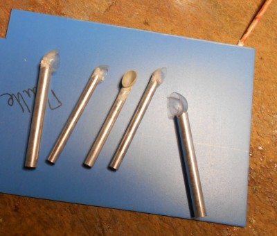

The vents are made with brass or aluminium tubes and vacuumformed tops.
I made the masts with aluminium rods and styrene. the articulation between the mast and the derrick is made with small photoetched parts

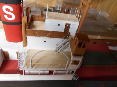

PostPosted: Sun May 21, 2023 11:43 am
Joined: Wed Feb 25, 2009 8:31 am
Posts: 294
Location: france
I made one double mast with the corresponding derricks. As I want to finish the central part first, I'm making the railings with photoetched stanchions made by Saemann

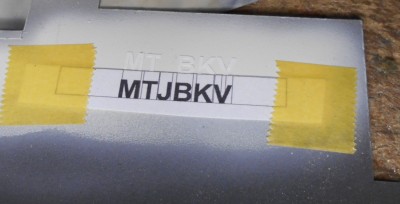

PostPosted: Thu Oct 12, 2023 7:17 am
Posts: 294
Location: france
I tried DrPr method with BECC letters 4mm high.
But these letters are too big, 3.5 mm would be much better.
I'm not very satisfied with the result, maybe because of the vinyl lettres. There are traces of glue left, as you can see and white paint is peeled in some places.
Conclusion : I still don't know what to do.
Maybe I could go to the fablab in Sete, but it's expensive
