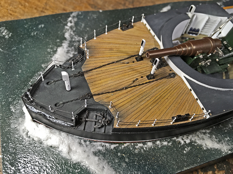

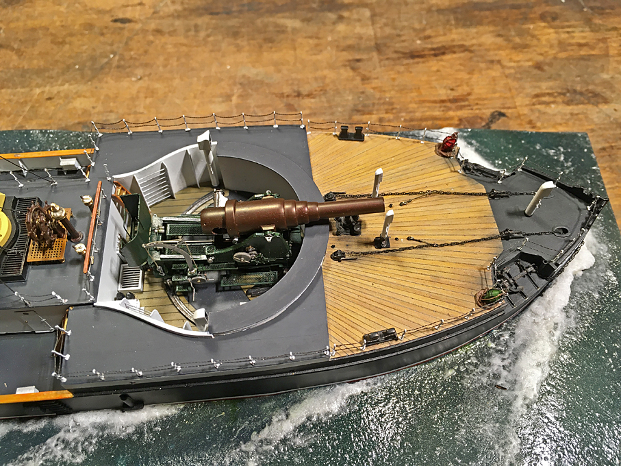

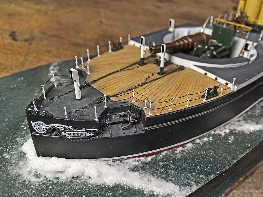

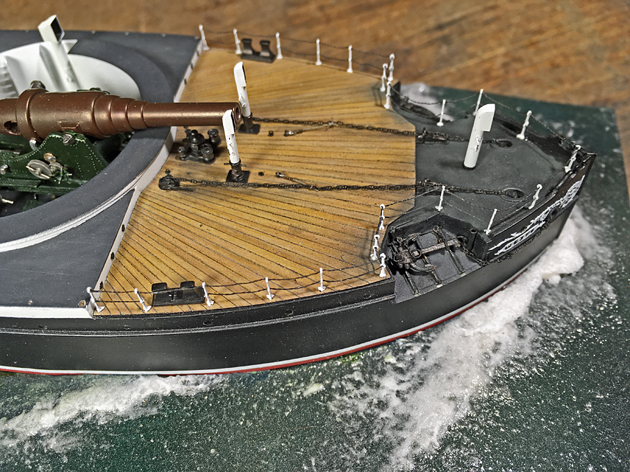

Foredeck Chain-Rails
Progress has been slow over the last few weeks because of various travels in the course of May (Italy, Germany, Spain) and because installing the rails is actually a slow process with breaks in between steps to let glue or paint dry.
I was a bit worried about the various corners these chain rails take on the foredeck – not a problem in real life, but the fake chain made from double-twisted turned out to be surprisingly compliant, without getting kinks that could not be straightened out.

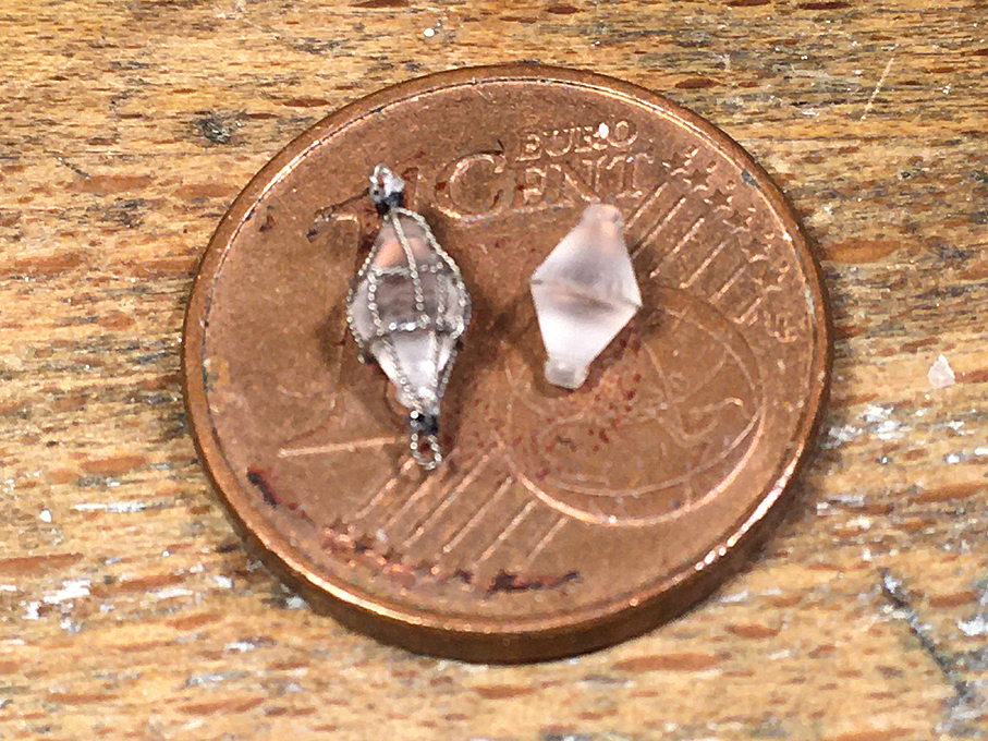

Completion of the staying of the funnel
According to the principle of working ‘inside-out’, installation of the outer pairs of funnel stays had been left to a moment, when other work would not interfere with them anymore.
The remaining funnel stays installed
The stays are chain and they were simulated in the same way as the chains for the rails etc. Luckily the lithograph represents these chain-stays by dotted lines, so that the points where they have to be made fast are known. Miniature eyebolts were fashioned from wire and glued into holes drilled for the purpose. They also received laser-cut washers of 0.5 mm diameter. The stays are set taught with lanyards made from thread as used in the old days for mending ladies’ ‘nylons’.
Not sure, whether I showed pictures before of how I am making fake chains using twisted wire. The material is oxidised Konstantan (a Cu/Ni alloy), sofar the best material I found for the purpose due to its tensile strength.
Twisting two 0.06 mm wires together so that the length of each ‘twist’ is the desired length of the chain link.
Laying in half of the twisted wire and twisting it together in the opposite direction.
The finished ‘chain’.
