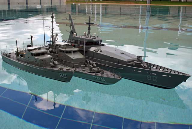

Australia has had three classes of Patrol Boat since the mid 1960's and I have made models of each class in several scales over the years. The 1:350 models are the smallest that I have attempted and pose a different challenge to normal for me.
Attached are some photos of progress so far.

File comment: Three generations of Australian Patrol Boats. Attack class in front then Fremantle class then Armidale class. All my 1:72nd scale models.
Steve Batcheldor
File comment: The real ships together.

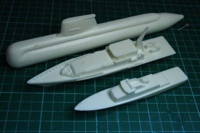

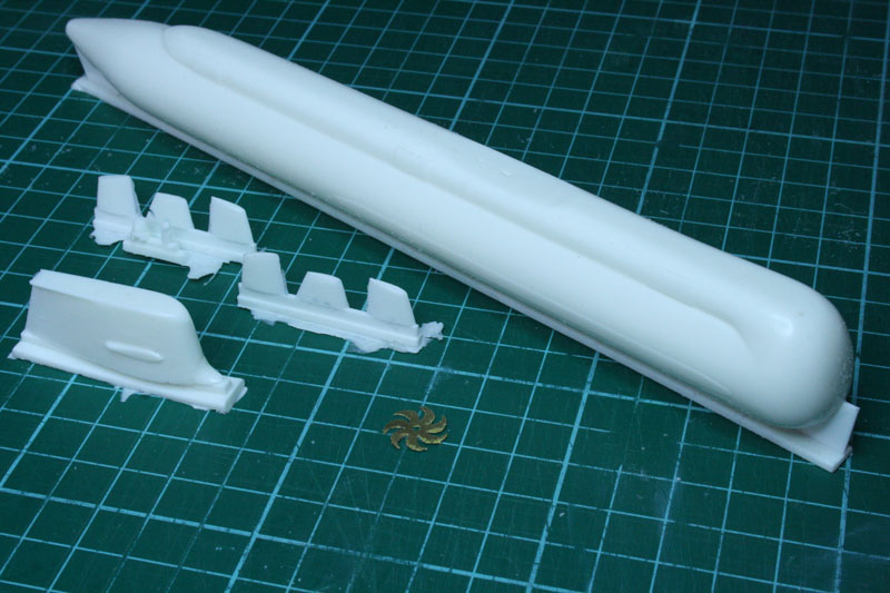

I have finally made some progress with a couple of the Australian Patrol Boats. I have been able to mould the main components in resin. Still working on some of the smaller parts. A long way to go before any of these are finished but I am pretty happy with the results so far.
The photos below show the recent progress.
File comment: An Australian Collins Sub, an Armidale and a Fremantle Patrol Boat moulded in polyurethane resin at 1:350 scale

File comment: The main components of the Collins Submarine.

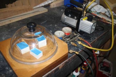

your casting is very good. Do you have the use of a pressure chamber or are they just poured and set.
The reason i ask is that i can not discern any pin holes or bubbles.
Again :thumbs_up_1: :thumbs_up_1: :thumbs_up_1:
Roy
PostPosted: Mon Oct 29, 2012 5:38 am
Joined: Sun Aug 15, 2010 7:05 am
Posts: 39
Location: Wagga Wagga NSW Australia
Hi Roy
I use a home made vacuum chamber to pull air bubbles out of both the rubber mould mix and the resin. It is not perfect but I do get much better results than just pouring the mix. Generally I will mix the rubber or the resin in a cup and put that into the chamber to de-air before pouring. I will then half fill and put back into the vacumm chamber for a short time. Then fill to the desired level and back into the chamber for a last time.
You need to work quickly. I use a resin with a pot life of about 20 minutes.

nice set up and a lot cheaper than a pressure chamber.
The resin i use for my 1/700 kits is fast setting (pot life 2,1/2mins max)
Although i am on the trail of a much slower setting resin which i intend on using in future.
Roy

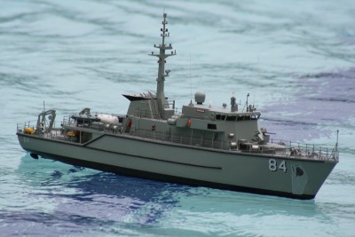

The Houn is one that I have started in 1:350. Not much to show at the moment as it is still just a chunky wooden hull that requires a bit of shaping to make a suitable plug for moulding. I will eventually make the main components much like the castings for the Armidale.
I have had my 1:72 scale Huon running for a few years now, it is quite a nice model that runs very well. A couple of pics are below.
Kind regards Steve
File comment: My 1:72 Huon Class Mine Hunter, HMAS Norman.
