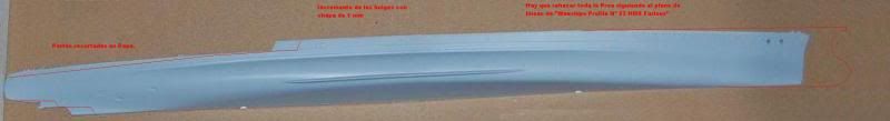

This time, due to the precarious means, I have only 1 mm plastic as the shop that sold in Alicante, Spain, that stuff does not matter anymore and I was 0'5 mm plastic enough, I decided to wear a helmet Heller HMS Hood at 1/400 with slight modifications and a new bow, is perfectly suited to my purpose.
Basically the changes made are:
One: Lowering the forecastle deck and shapes to suit the Furious.
Two: Add plastic sheet to increase and rounding "Bulges".
Three: Add the entire bow section from the frame # 60 from plans that appear on the book series "Profiles" "Warship No 23" "HMS Furious / Aircraft Carrier 1917-1948. Part 1: The First Eight Years "on pages 256-257 and fairings box on page 251.

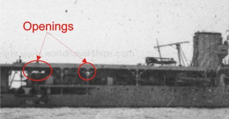

The last I've found, very good in detail and also to be nearly deck level, has revealed details hidden in all other photos I have, I owe to this page http://www.militarian.com / threads/hms-furious-1917.6483 / # post-40539
Where does this photo:
Approaching her in the aft part of the hangar I discovered what I believe, are openings in the hull and a second door in the hangar in the forward wall.
Here I put an extension:
So I ask for help to anyone who has information and I can clarify if I have reason or not. To me the impression I get is that if they are opening and a second door in the hangar.
Suggestions?

That's is a really nice project you have here, Julio. Excellent dazzle painting. Are you going to do her as in the Tondern raid configuration?
About your question, looking at all drawings and pictures I have seen when trying to build the Loose cannon kit I have to conclude that there may not have been a hangar in that area but relatively open structure (s). In the very similar 1918 conversion of Vindictive this is even more apparent. In both vessels the former funnel/boat decks seem to be quite close to the original configuration and the flight deck is simply built up over existing structure with pillars and light structure. Now if anyone would have acess to the orginal plans of the conversion than I can rebuild my Loose Cannon Furious again. After replacing the landing deck and part of the forward structure and fightin the photo-etch parts for years....

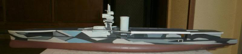

Thank You Pieter:
This is the solution that I'had done in my model.

This second Picture confirm my suspicions.

On the plan of 1918, I profiling superstructures and then I overlaid the 1917 plan. So you can see that the holes correspond to the difference between indoor and but I guess in 1918, equaled the width of the two superstructures, this and the hangar.
Any idea?

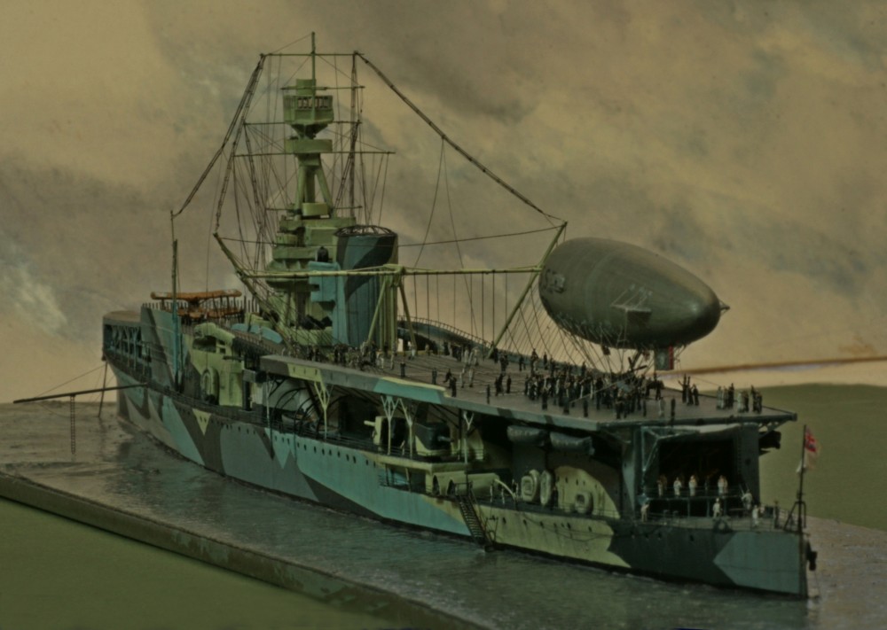

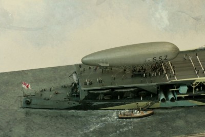

here are a few recent snaps of my model that I built in 2003 in 1/700 scale
Best wishes
JIM BAUMANN
