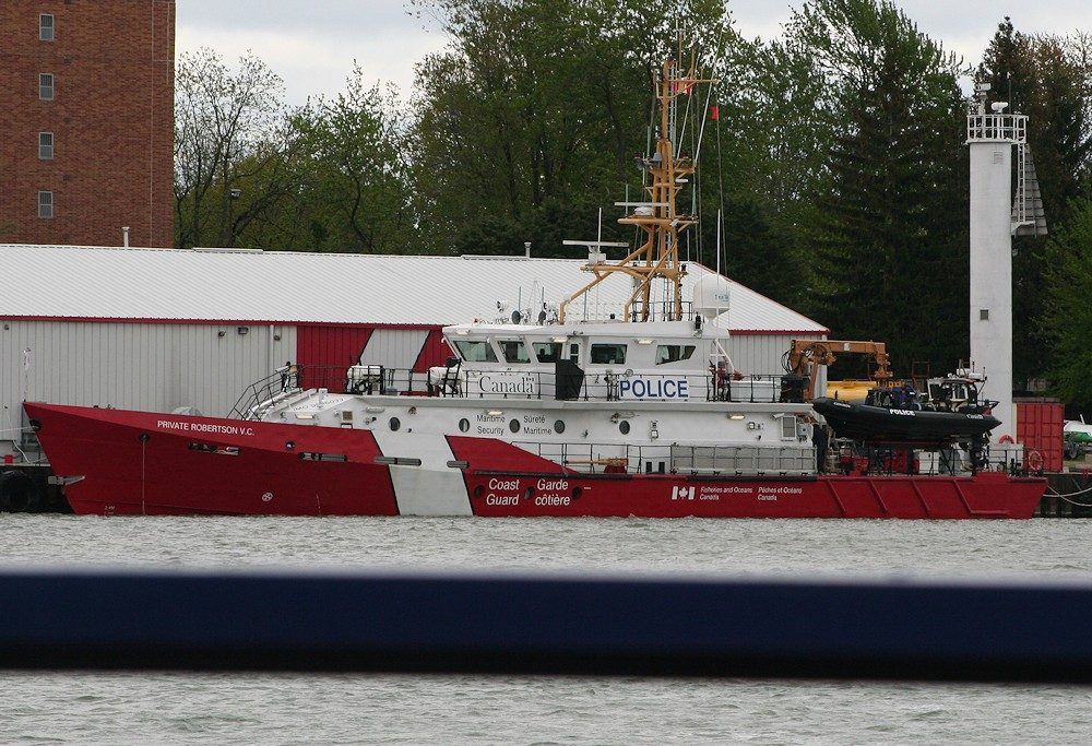

Thanks Tim, and it's been my pleasure... especially the part where I was given the opportunity to visit ship and crew, and to fill up my camera.
The model is a commission, and it won't be long before it goes to its new home.
BTW, I am compelled to point out that not everything on this model is 3D Printed plastic... I just turned the ship's bell tonight from brass!

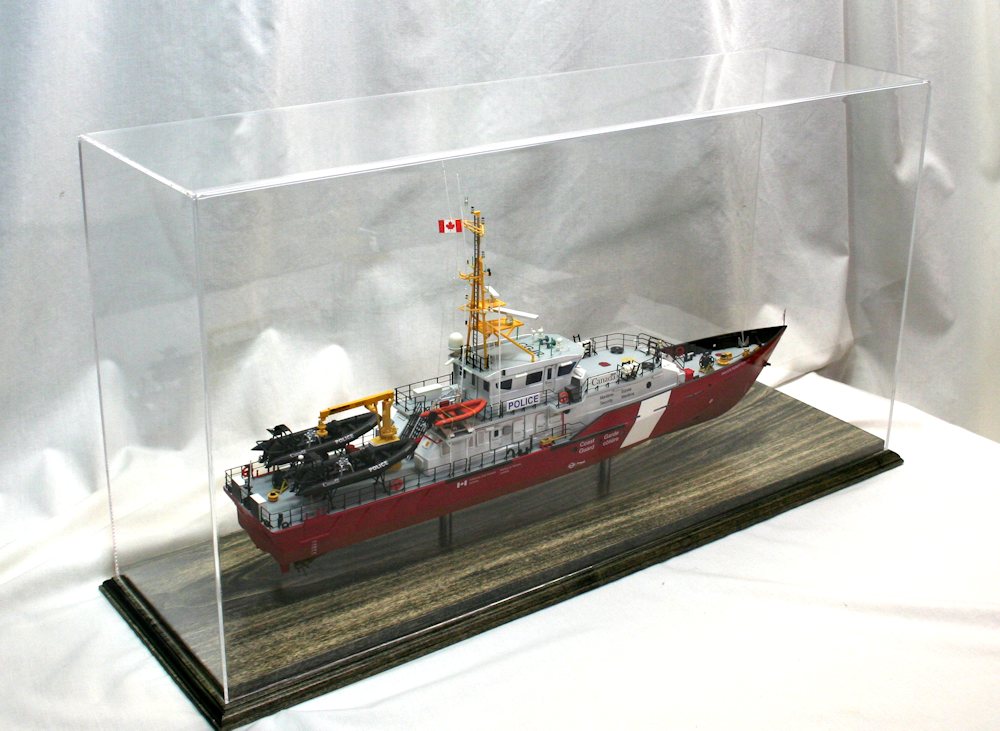

And, done.
I'll forward more pics to the Gallery...
File comment: Private Robertson V.C.
Launched 2012
Launched 2012
