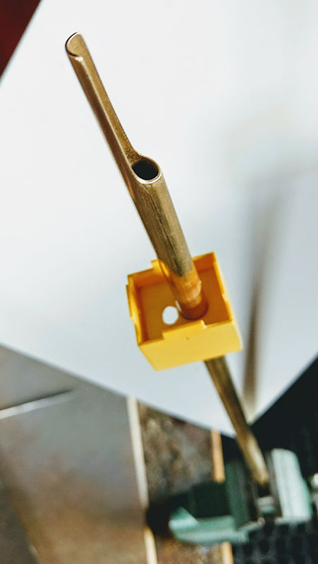

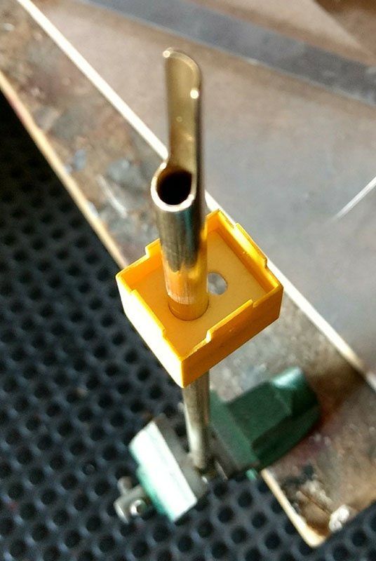

An example of my port wellenhosen :wave_1:
File comment: i separate each stanchion
File comment: the shipyard job
off course i will refine it
p.s.
Yellow bulkhead has a closed micro ball bearing inside the bulkhead acting as a thrust bearing, inside the hull will another. :cool_2:

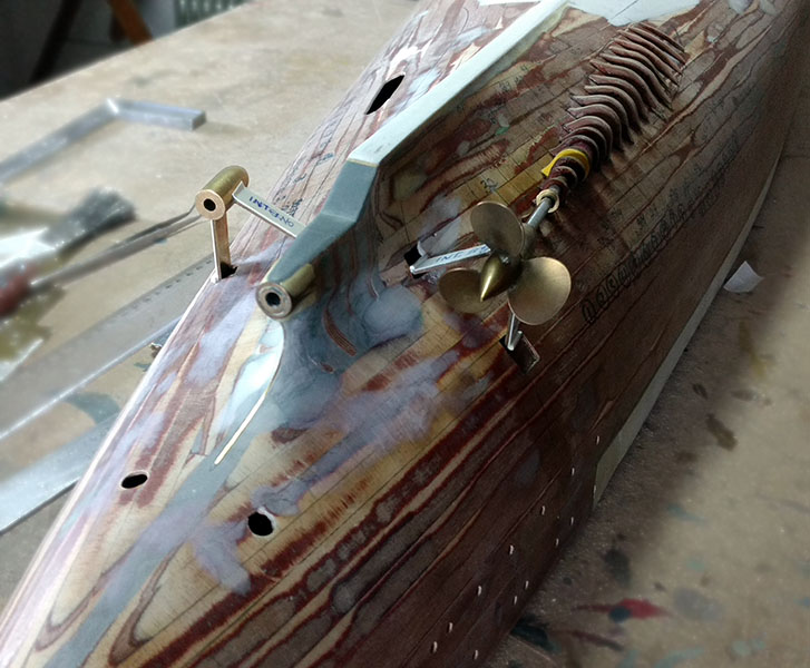

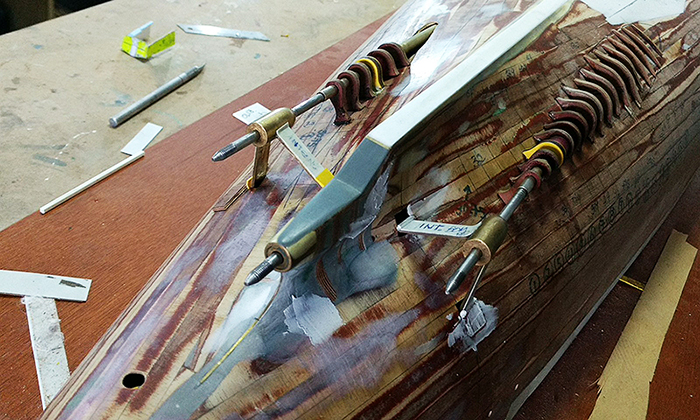

starboard shaft tunnel in building process.
yellow stanchion is an enclosed micro ball bearing :wave_1:

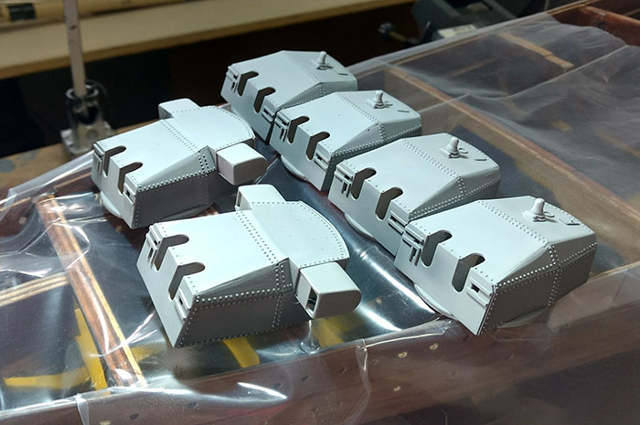

Hi all fellow modellers
SK/C-28 with first coat of primer.

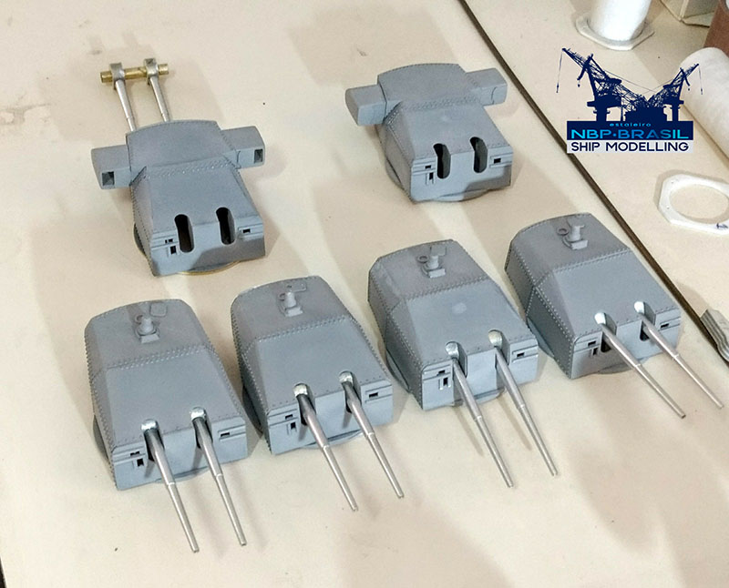

Hi my friends just some update :smallsmile:

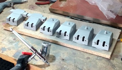

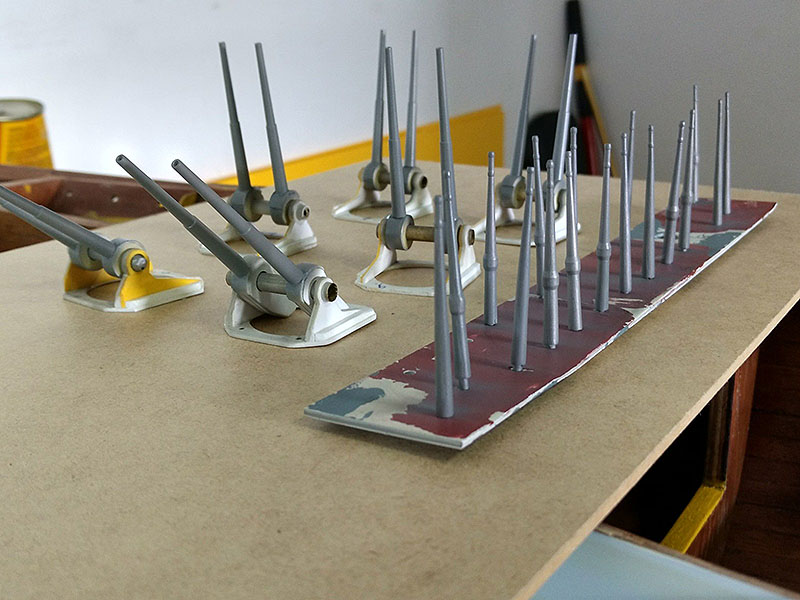

File comment: SK-C/28 A.A. guns

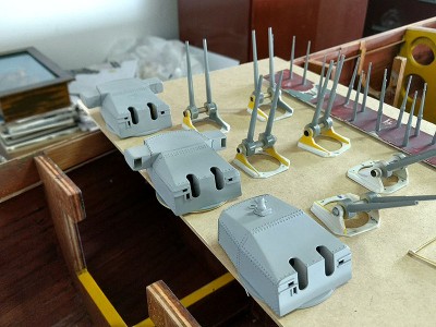

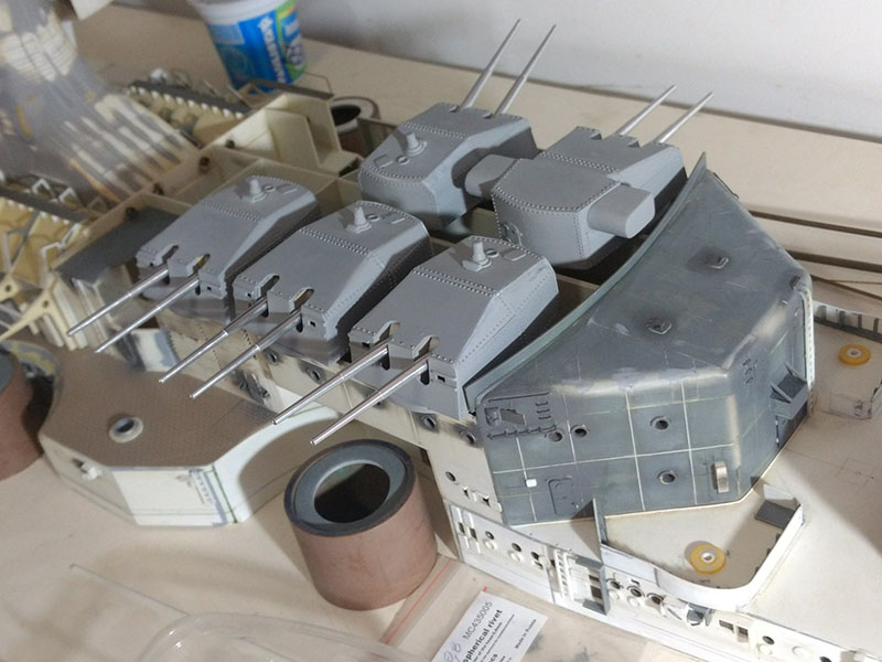

File comment: mock up SK-C/33
File comment: INTERNAL PARTS
File comment: SK-C/28 rear

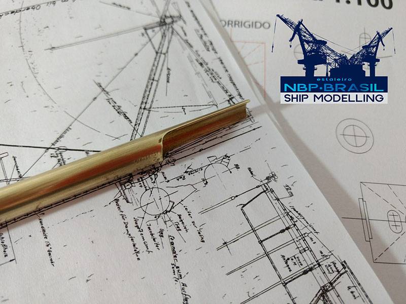

thanks Richard for the interest.
I haven't posted anything in a long time and my ship has come a long way since the last time. any time I post again here.
the ventilations I make by hand even using the construction plans and the portholes are made by wrapping a brass wire in a certain pipe diametre, then tighten and cut and install. I think scratch is an option, nothing difficult or expensive to do.
The water inlet openings in the hull have already been located and adjusted, but I haven't opened the hull yet, so I will soon. I think this is what it refers to, if it is the deck equipment grids, yes they would be good if they were made of photoetch, but for me I will try to solve it in another way since the currency of my country has devalued and is worth 6 times less than the American dollar. thanks again :thumbs_up_1: :wave_1:
