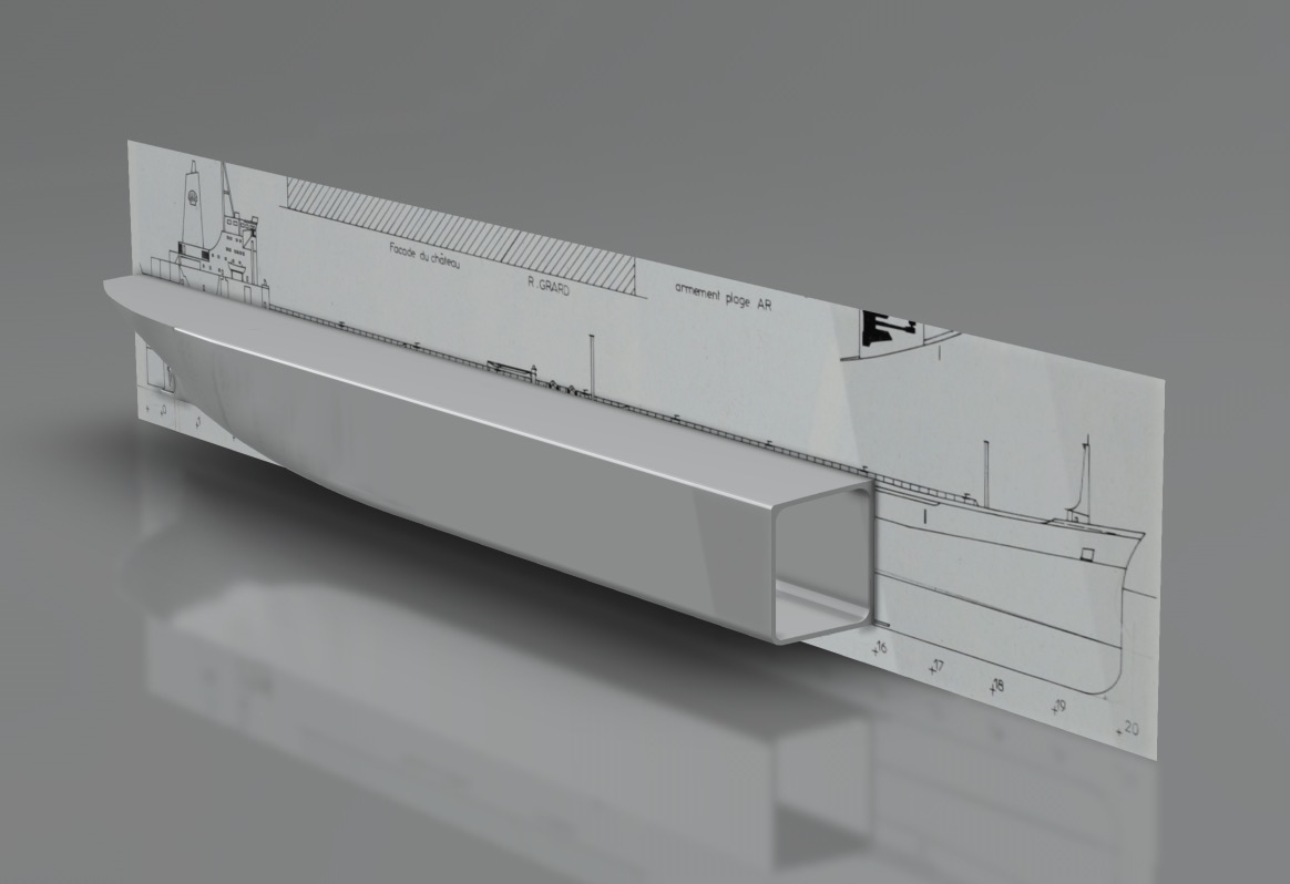

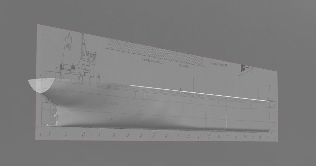

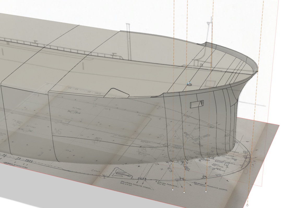

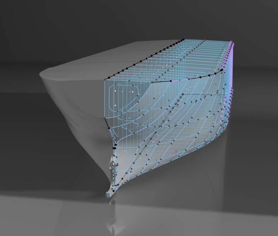

Some pictures of the progress of the modeling started a few days ago.
Pascal

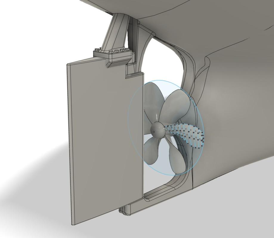

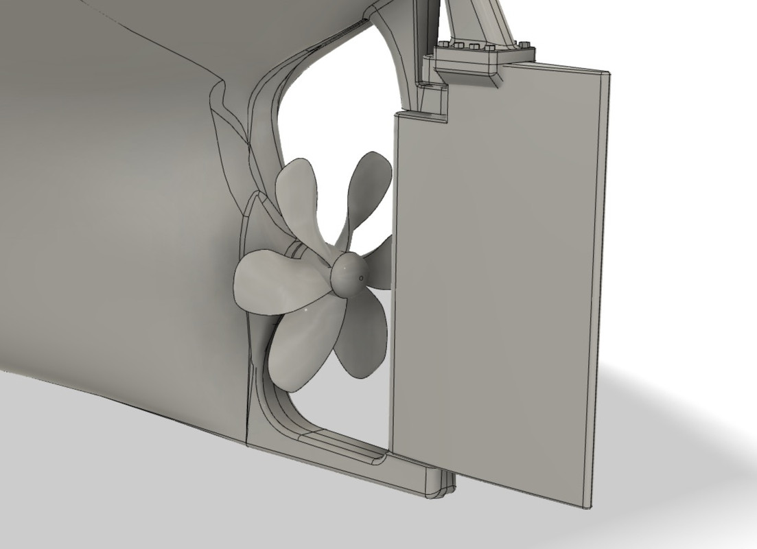

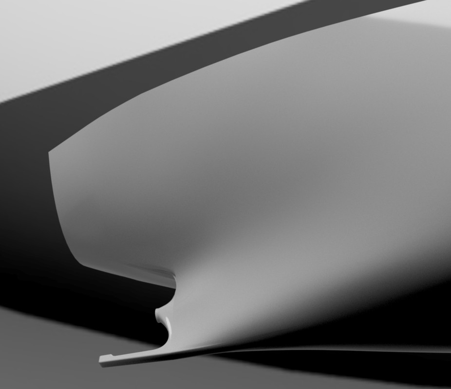

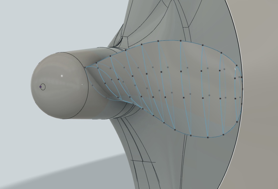

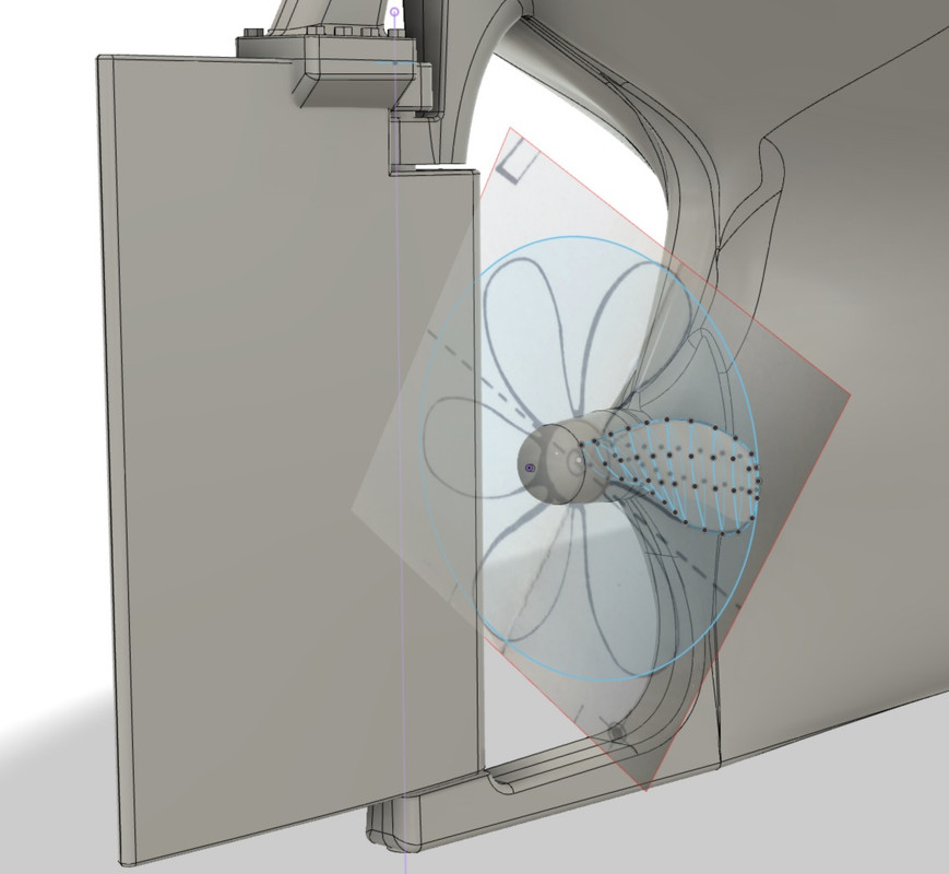

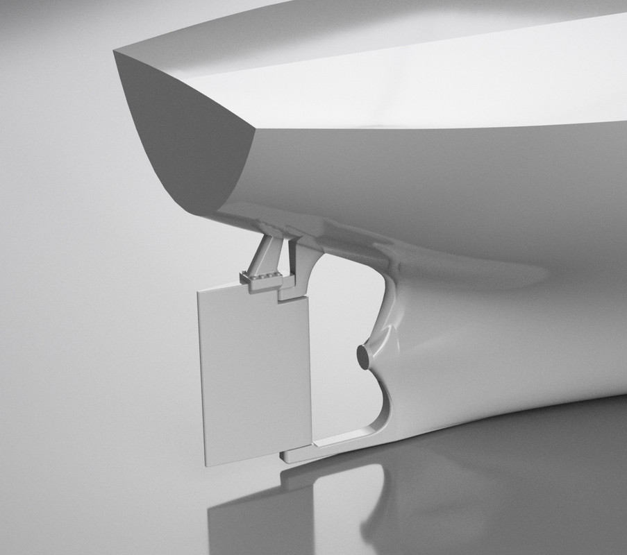

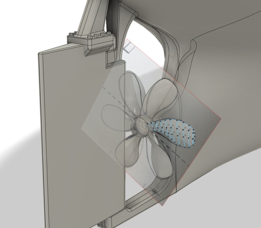

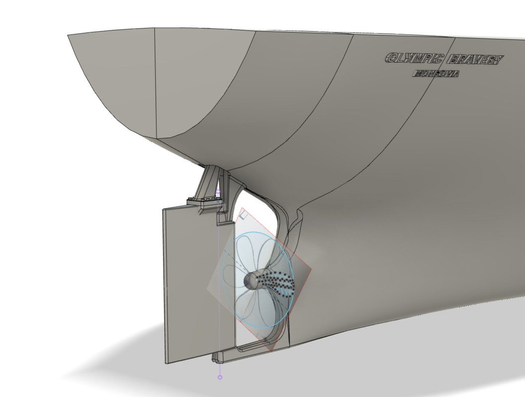

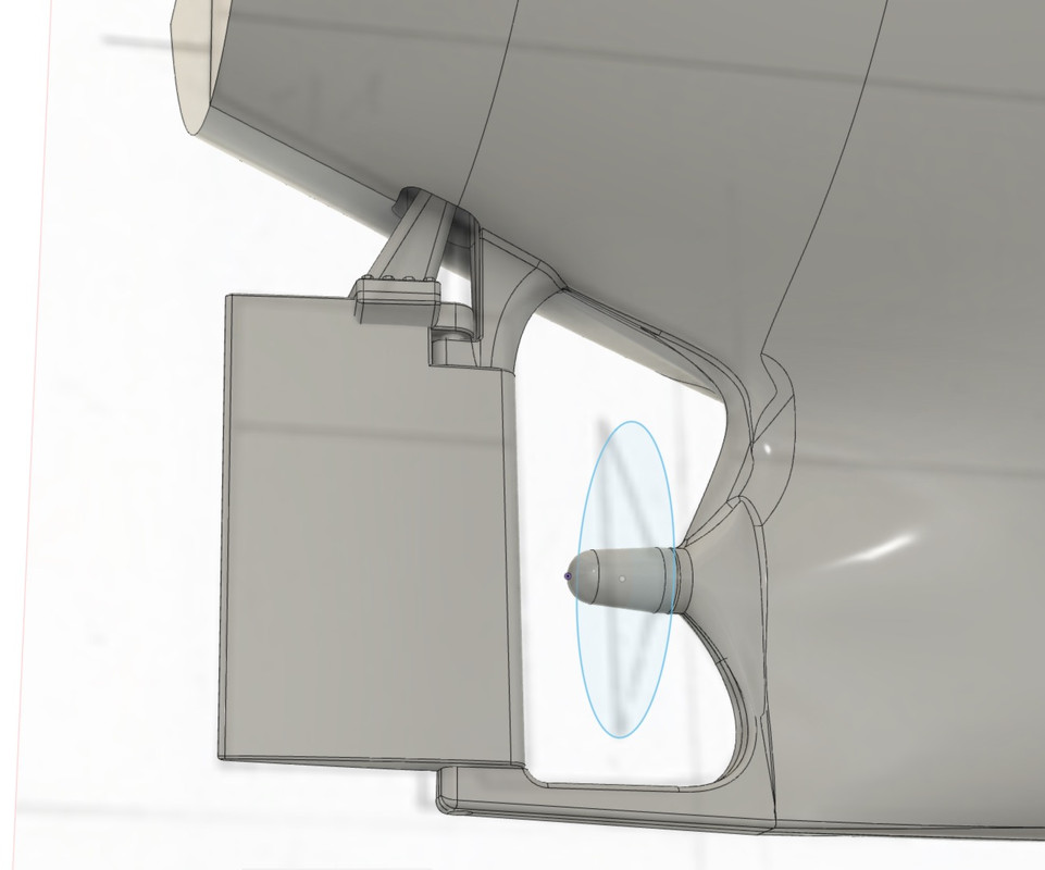

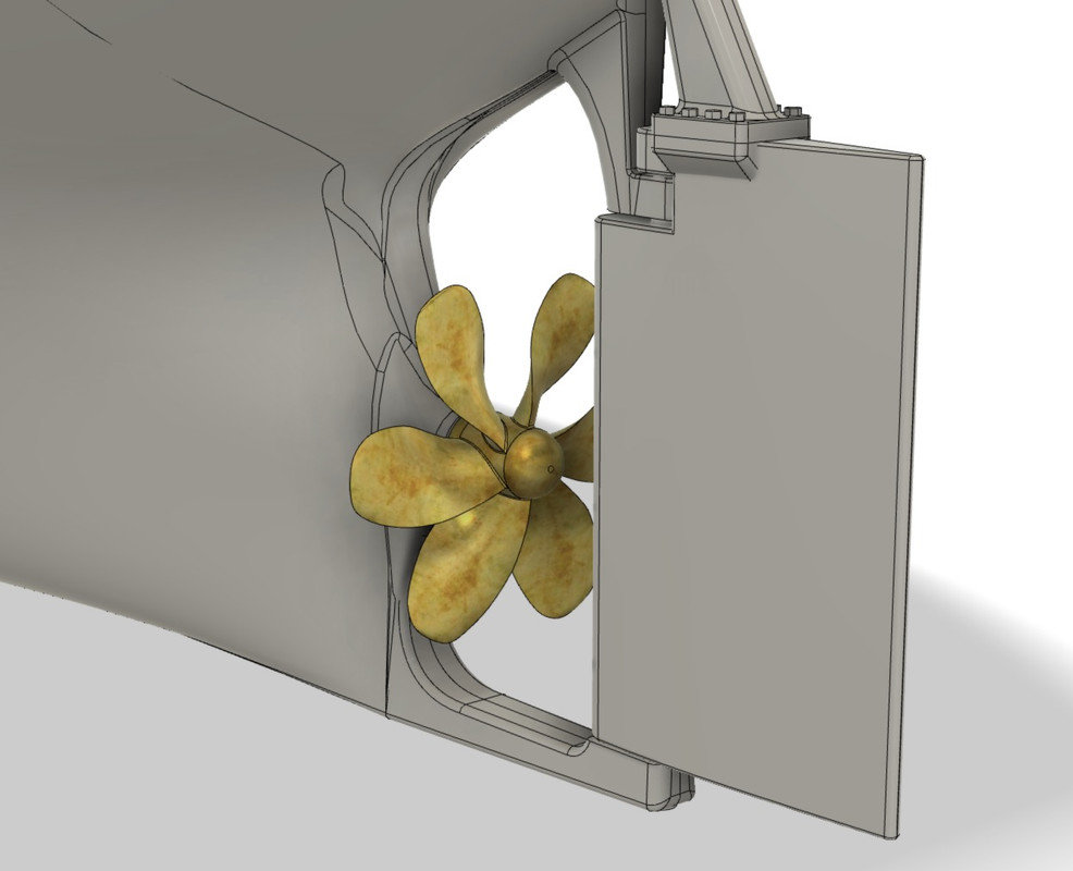

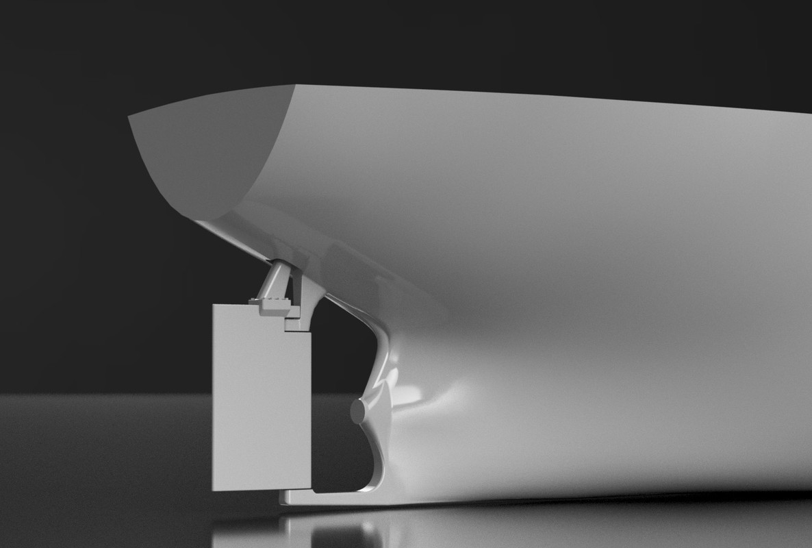

Drawing of the rudder, it is a rudder with two spurs (N°2).
I'm going to draw the 6 blades propeller of 8,60 meters diameter.
Alexander S Onassis. a sistership in dry dock.
Pascal

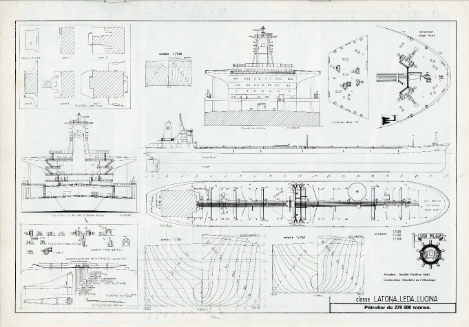

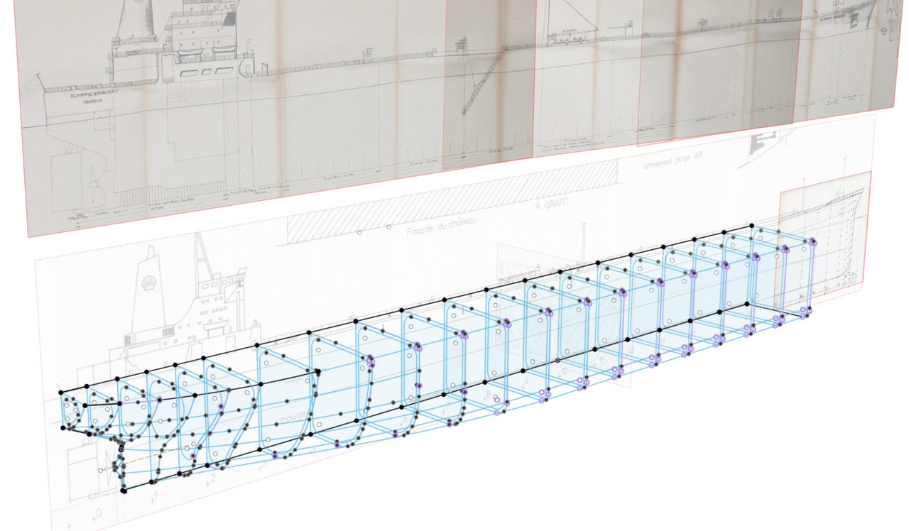

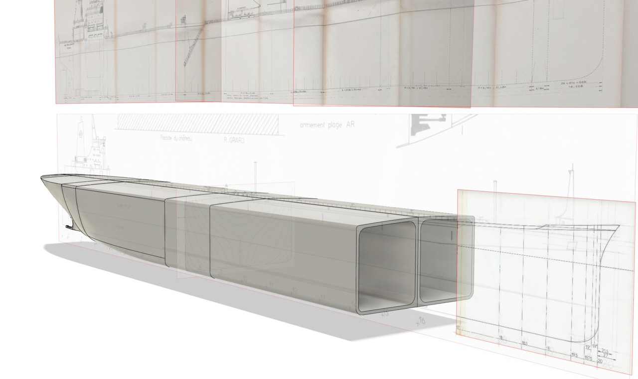

There is a plan in MRB N° 212, the hull plan comes from there.
For the castle and the layout of the deck and hull, I have the original plan of the Olympic Bravery from the Chantier de l'Atlantique, Saint Nazaire, thanks to Roland.
But I used the MRB plan of the Shell ships (but also Auxiliaire de Navigation and Total TCFN) for the hull which is identical.

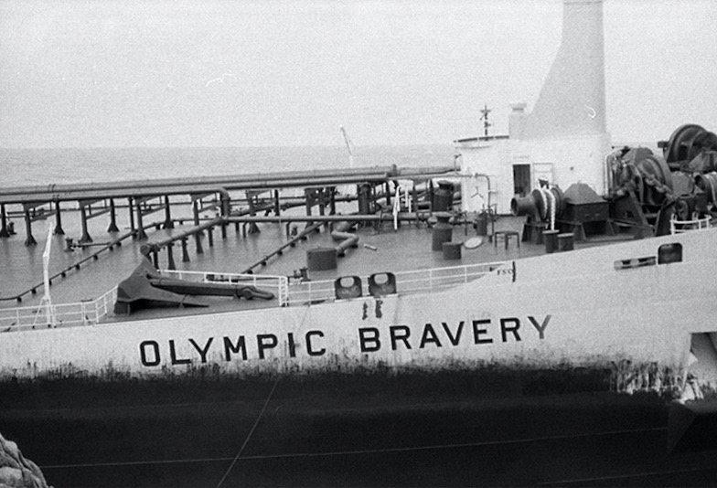

For the photos of the ship, I have the copy of the originals taken in Brest before the wreck, in Ouessant by Roland and those of the Chantiers de l'Atlantique also entrusted to Roland.
The MRB 212:

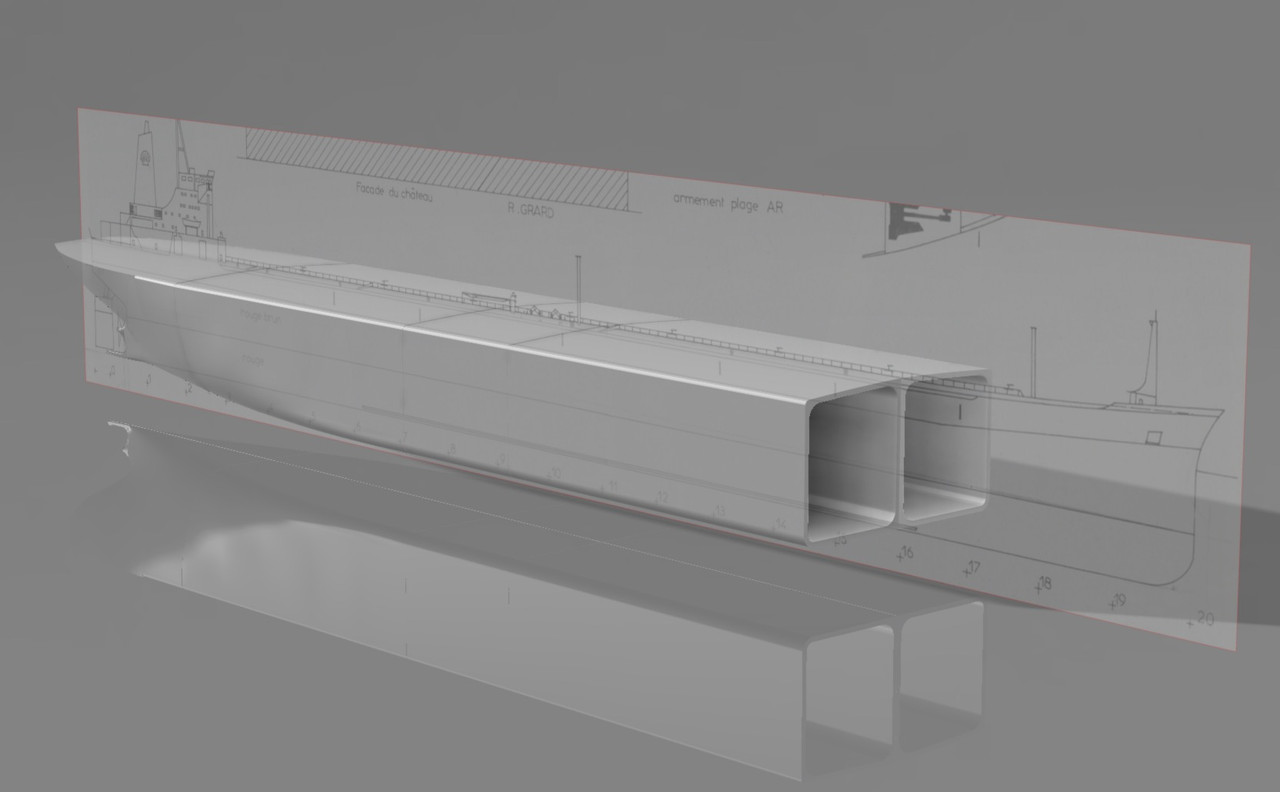

It's not perfect, but for the scale it's ok ( 12,3 mm diameter ). I only have this as a canvas, but it's better than nothing.
Two different textures.
Pascal

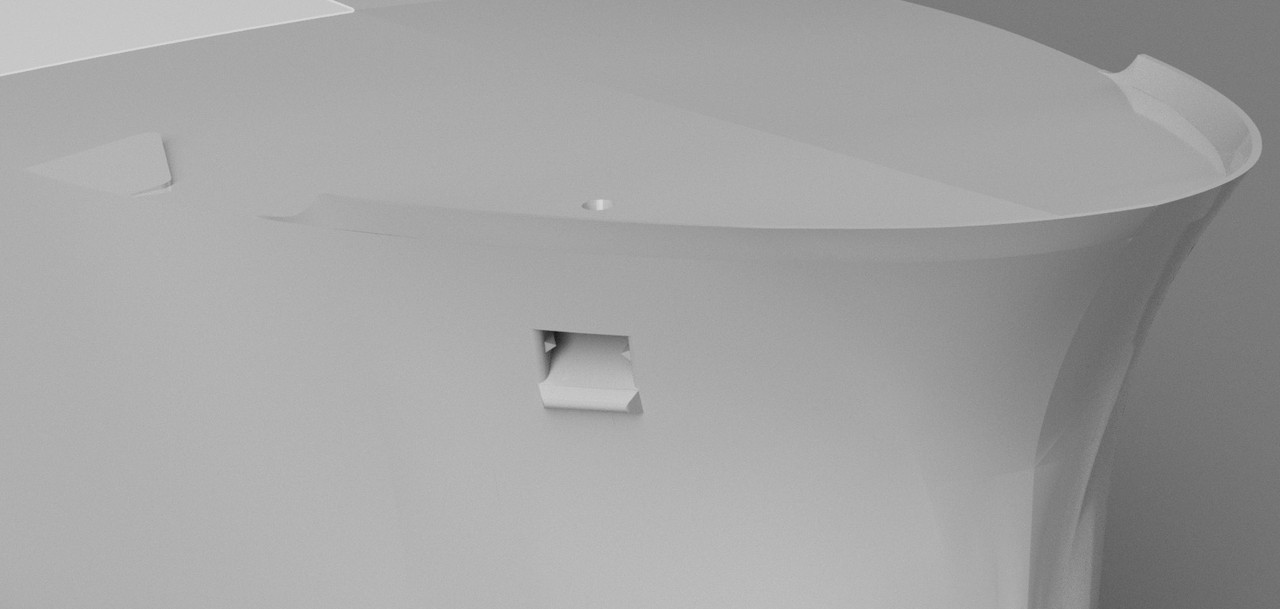

There are a few small defects as usual, but it will be fine for the printing.
Just to give an order of thé ship size .

No is less expensive than plastic card from Evergreen Card, i think..

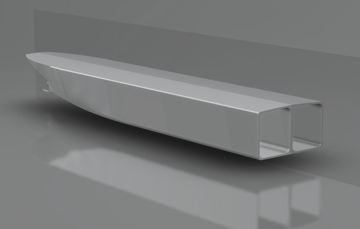

The blocks are hollowed out, so it uses a small amount of resin. This is very interesting in terms of cost. There is of course the investment of the 3D printer at the base.
For the pipes, I choose to make a mix of Evergreen, 3D printing, piano wire, iron wire, copper wire.
At 1/700, the valves will be a bit small to be represented, I think, maybe symbolically, I don't know yet, I practice for the first time this scale, I'm rather fan of 1/200 and above.
For the tanker T2 at 1/200, I had printed half blocks (half hull) around 11.5 centimeters high. In total the 80cm long ship was made of 14 hollowed half blocks.
viewtopic.php?f=13&t=305869
Half blocks glued together.

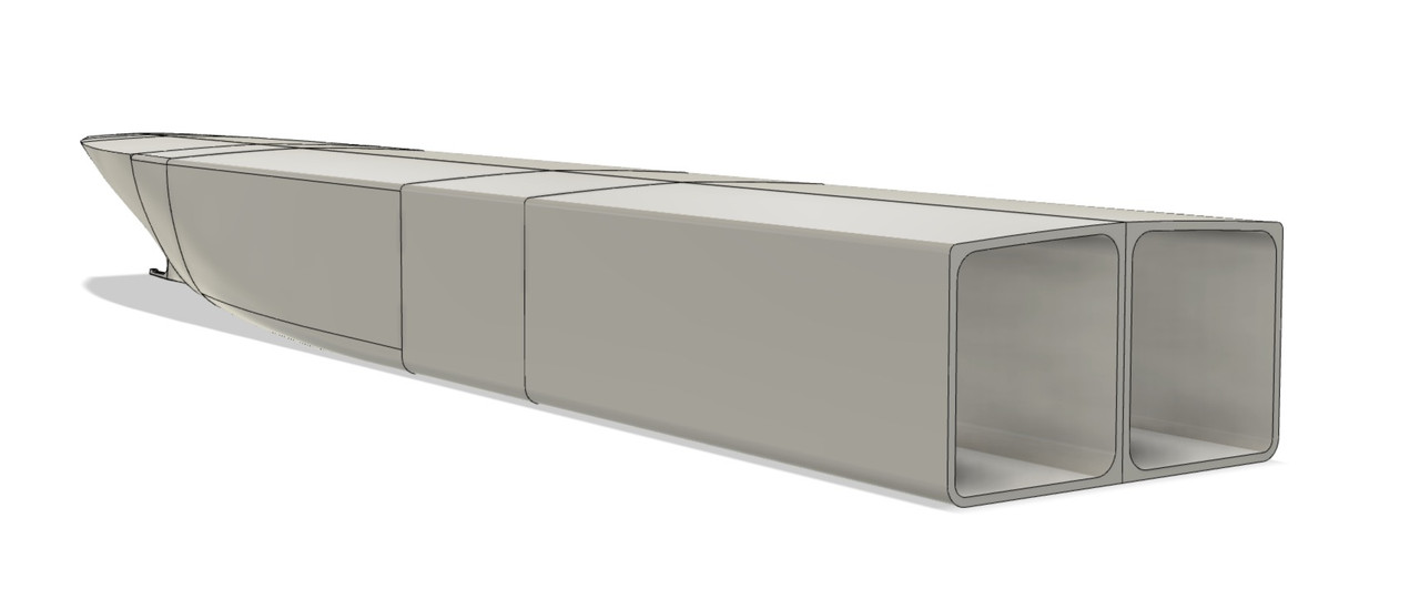

Piping:

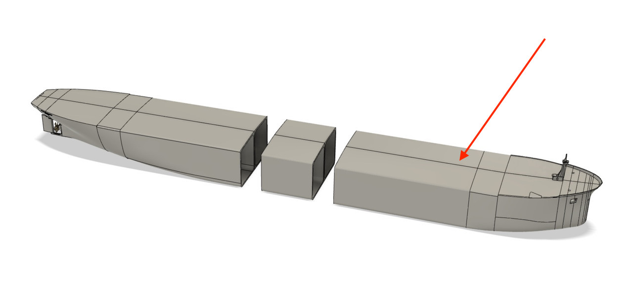

But since that time I received the Anycubic Mono X which allows to print a max base of 19,2 by 12 cm on a height of 24,5 cm.
This ship will be 49 cm long, smaller and will be printed in 3 full hollowed out blocks (not halves, it is 7.28 cm wide, so I am far from the max width..).
Printing a 20 cm block can take 14 hours.
This way:

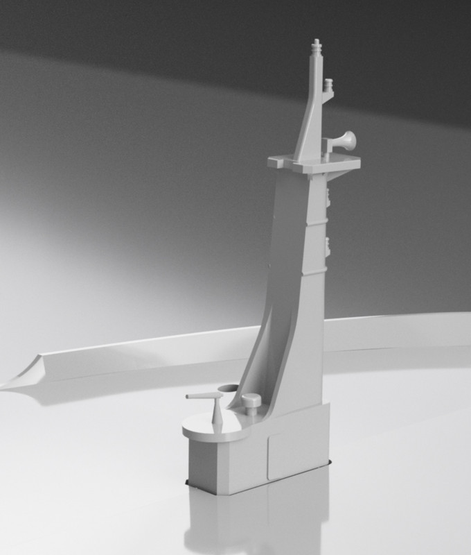

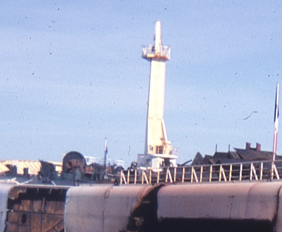

Model of the front mast which is 25 mm high. I have a few details to add.
Photos Captures of the mast for details.
Pascal

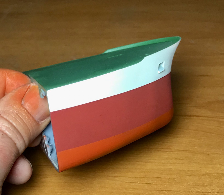

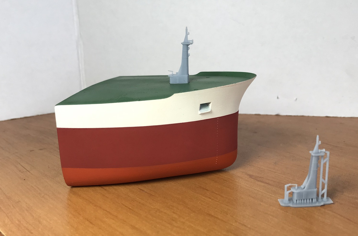

The test bow. I painted quickly today, without really waiting for it to dry to the core.
White Revell 05 matte.
Green, base Revell green SM364+ addition of Revell black SM302.
Dark red antifouling, my pot is too old, at least 20 years. I re-ordered some. But I managed to apply it by filtering it, otherwise the color is perfect: Humbrol 60 matt
Lighter red, antifouling, Humbrol satin 132, which will have to be made matt with Revell 02 varnish.
The light yellow color of the inside of the bulwark and the mast is still to be found.
Draught scale: White Revell 05 matte.
The white marks for the places where the tugs can push will be in white 05 too.
Name: Charcoal gray Revell 09.
The Olympic Bravery in form C in Saint-Nazaire.
I based my choice of colors on this beautiful photo.
Pascal

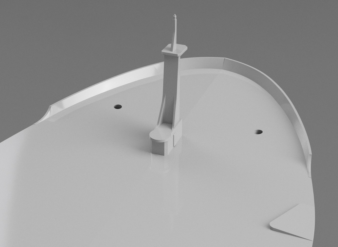

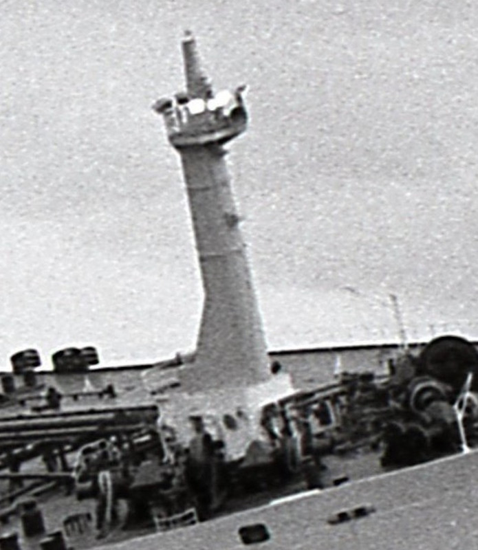

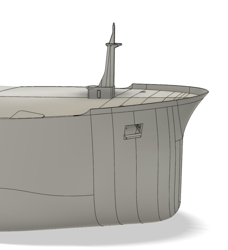

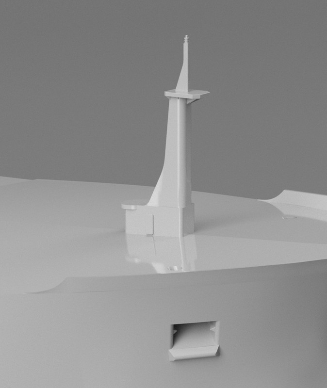

I printed the front mast. It will be a bit further back on the final version and the bulwark will be 2 to 3 mm longer. There will be some railing to glue. The 7 deck lights to be placed.
Pascal

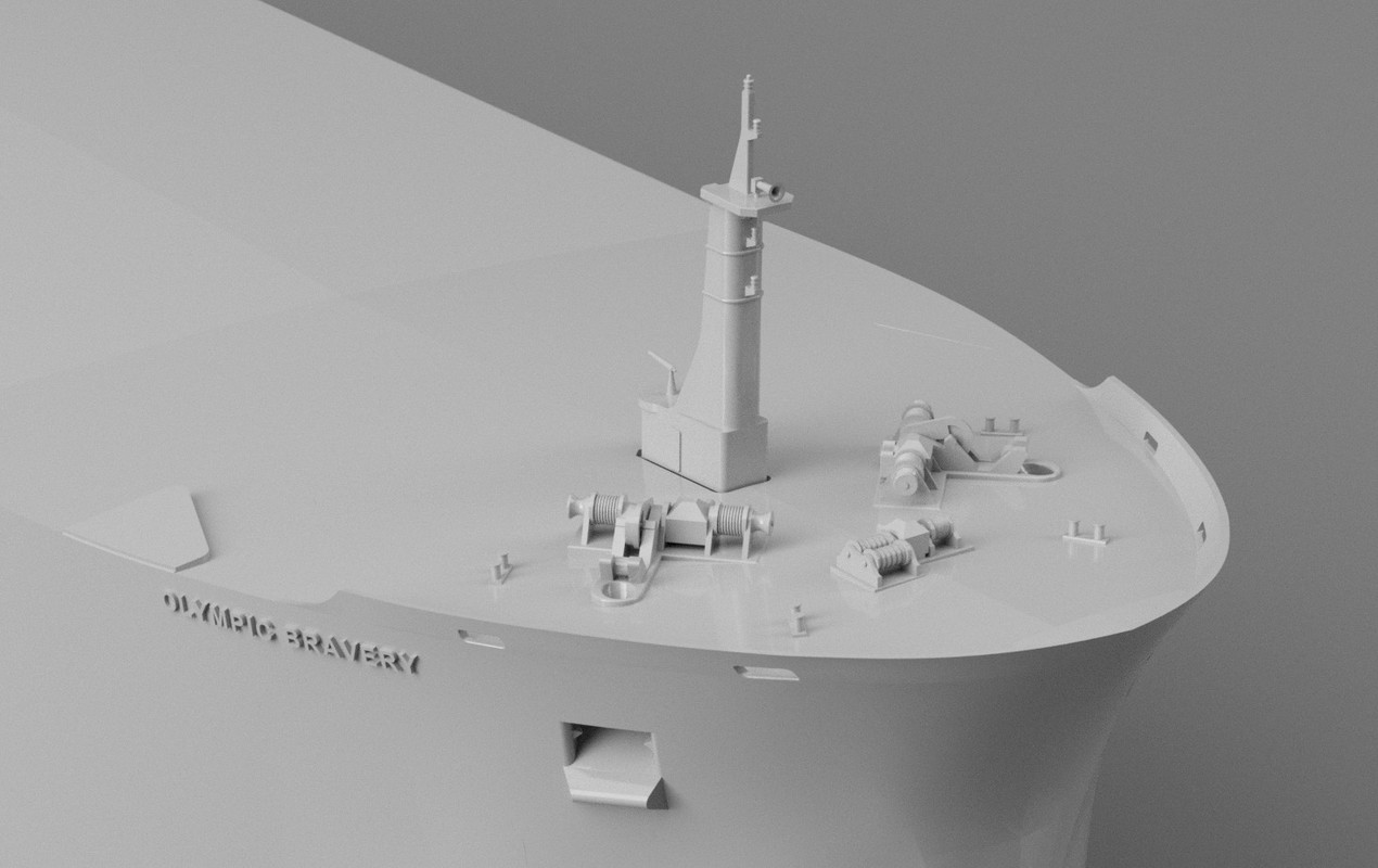

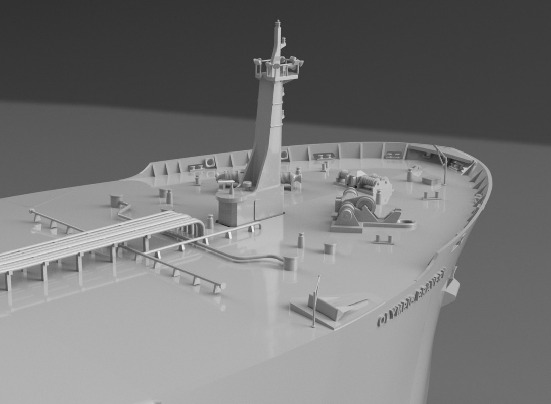

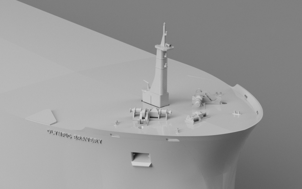

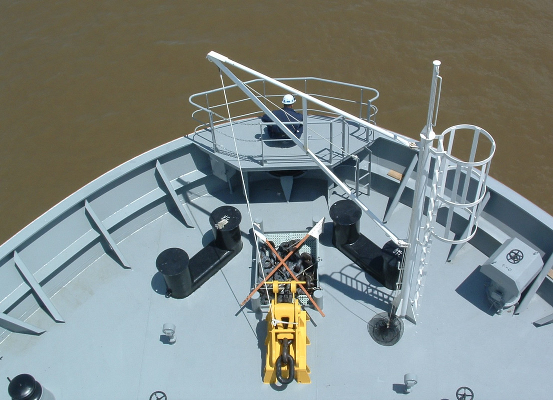

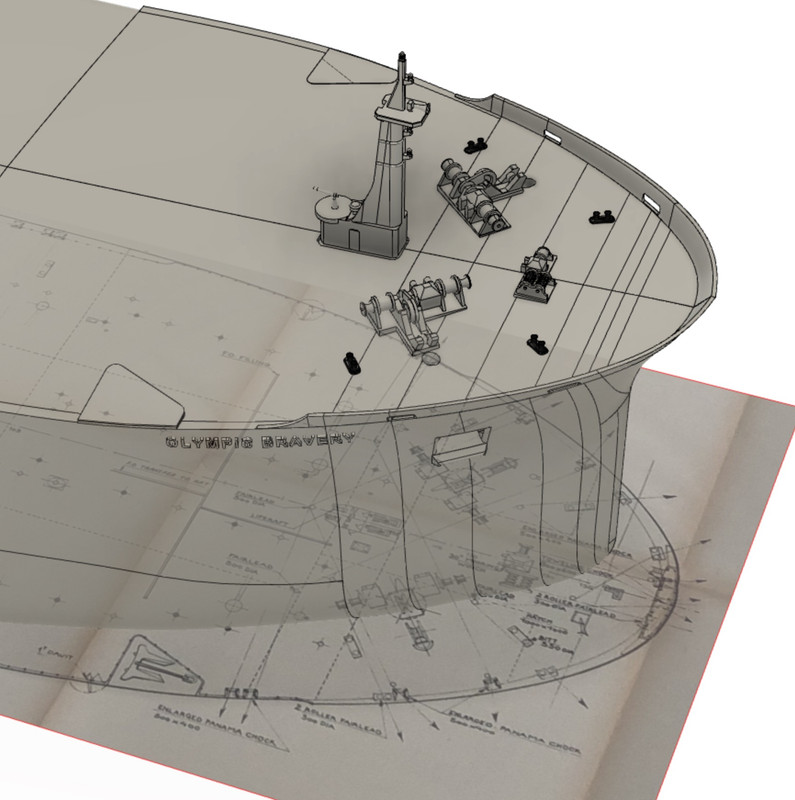

I'm drawing the front maneuver right now. Fortunately I have some good pictures.
Yesterday:

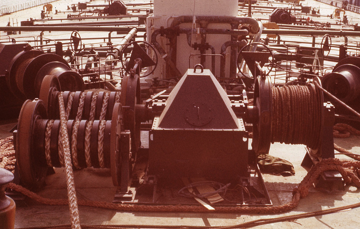

The huge windlass, I worked on this kind of gear, especially to replace the chain brake bands, not an easy task.
Each chain link weighs more than 200 kilos.
The front winch, with special hawser reel system of the time.
Ropes are not used anymore on big ships, too flexible, they are often replaced by steel cables, with a 10 to 20 meters rope at the end to bring some flexibility. The disadvantage is that it is very heavy to move for the boatmen. The winch drums are then very specific. you can see it on these personal pictures:
An example:
Cartagena, Spain.
Up the Mississippi River:
The front winch, and on the left you can see half of the bollard of the towing chain. It is on this chain that the tug's tow is captivated in case of towing at sea when the ship has no propulsion and is drifting near the coast.
You can see it better on this picture, it is painted in yellow. The small loading mast is used to move the chain if necessary to maintain it and also to take the Suez projector out of the forecastle and mount it on the platform where the bosco is on the front platform.
Forward winch.
Today:
Some modifications have been made, and details improved.
Pascal

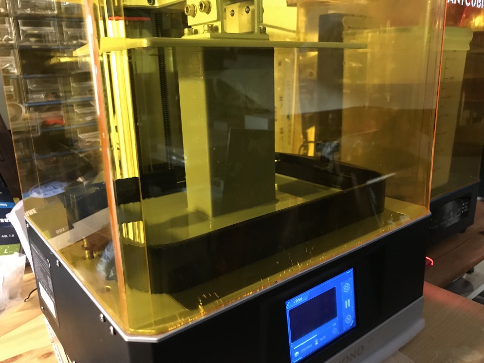

The printing of the front part is in progress, the first one, it has three unequal slices in the length, it has a reason. Because I remind you, there will be two copies built, a full, site model style, and a copy for the diorama. The central part being the part treated differently on the two entities because of the place of the break of the ship.
223 mm high, impressive this printer, I do not get used to it, I love it. She could print 3 or 4 of these hulls at the same time Image Max 245mm. A resin ogre.
End around 00h30n or 10h30 for this slot. This is one of the highest (longest) pieces I've had to print.
I surround myself with all the experience I've acquired to prepare this print before pressing the button, I mustn't fail, at best I waste resin, at worst I can damage the film or "better" the 4K screen, so I take at least 4 times to recheck everything that can potentially screw up the print, a long job that is not the most exciting, but which is essential, I spent a good day there.
