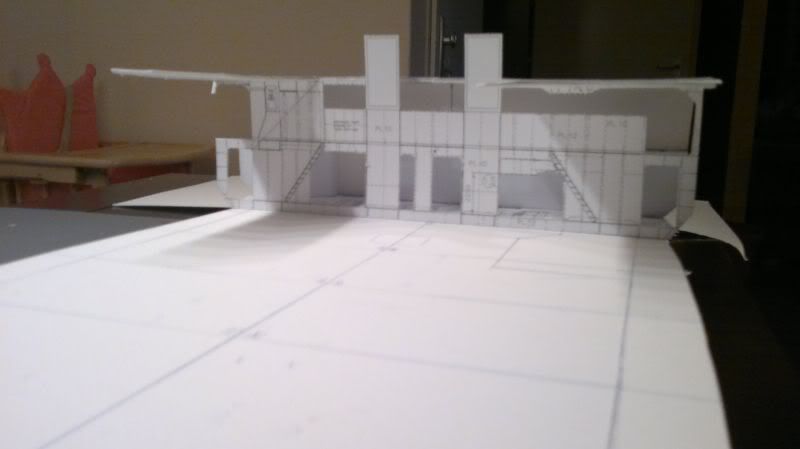

As I'm giving comments on builds of others, I thought I had to show my own work :big_grin:
This is my first start of cutting out the frames and keel out of 2mm cardboard:

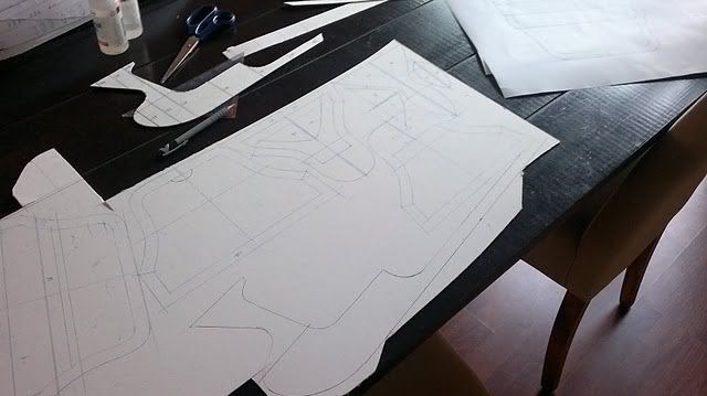

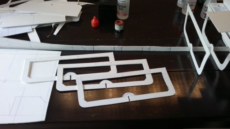

With some more progress photo's of the fitting of frames and forecastledeck to the keel.
Already showing the size. I'm used to 1:100 scale warships, makes this a little bigger :heh:

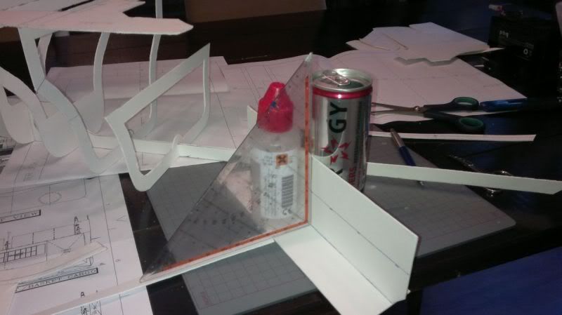

Cutting out the forecastledeck, already taking into account the openings for the deckhouse, anchor chains and stairways down to the maindeck:

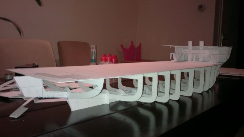

Keeping it straight:
Fitting of frames upside down to keep the deck perfectly flat:
Bowsection framed:

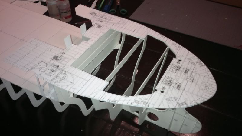

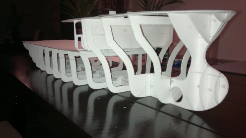

It's weekend so I've had some time to model today :woo_hoo: Finishing the framing towards the stern first. I know there are bigger ships on this forum but for me she is getting quite big! A lot of displacement as well.
Still some frames left fitting:
I've already been starting cutting out the bulkheads as well. They are a little weak now but they will be framed with profiles. When finished this area of the ship can be viewed from the outside so I want them to look real.
And a overall view:
There appears to be a little bump in the maindeck but that has been corrected now :thumbs_up_1:
