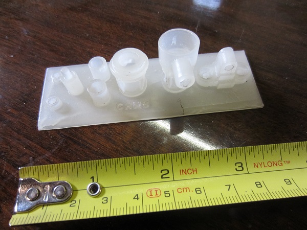

I love it when some one asks a sensible question.
The simple answer is that there is resin and resin.
There are so many different types of casting resin and they all have different properties. I'm still experimenting and discovering different ones and the very helpful rep from my resin supply company has let me try out some different ones. Casting resin (particularly for casting small and detailed components) needs to have as low a viscosity as possible, otherwise it's very difficult, nay impossible, to get it into the detail of the mould, even under pressure. Some of the first resins I used worked great but turned out to be brittle when it set hard. OK for more chunky components, but some of the fine stuff was breaking when it was extracted from the silicon moulds. De mould success rates were down to 60% or 70%. I unfortunately ended up with a lot of 1/48th scale Victorian Royal Navy figures who were all double amputees!
I then identified an alternative resin which was quite a bit stronger and the de mould success rate went up to 95%.
I'm currently trying a practically clear resin which is very tough. As its clear you can actually see drill bits penetrating so you know when to stop. Check out the picture below. This stuff is really tough.
Carving drilling and sanding the stuff I find easy (with care). If you are drilling into any of this cast resin (either by hand with a pin vice or with a power drill) withdraw the drill FREQUENTLY to clear any debris as it packs tight around the spiral of the drill bit, expands and can burst the component. If you hear the drill making squeaking noises you have a problem and I have actually broken small drills off.
It sticks very very quickly with CA glue (some sort of chemical reaction going on there I think) and leaves little or no time for re positioning. I tend to capillary glue into joints if I can. Always wash resin fittings in warm soapy water and rinse. The surface may have silicon release agent residues on it which makes gluing qualities poor.
In hindsight I could have designed all the rudder and diving planes as brass PE components, but the advantage of the resin ones is they have a little thickness a slight aerofoil section and I am quite confident in their ability to withstand actually being used. underwater.
Hope that answers some of your sensible questions.
Keep watching.

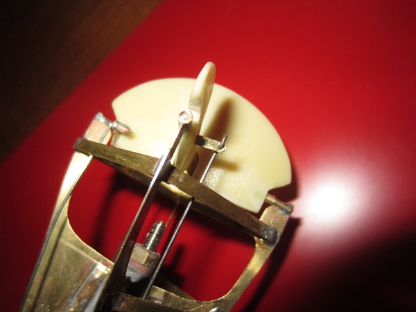

File comment: Clear cast resin components that you can see drill bits penetrating. Very useful.

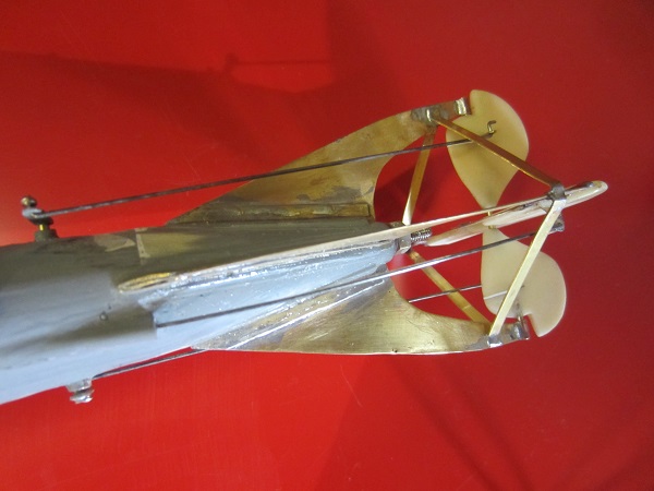

The aft diving planes were then installed within the brass frame work. I should have installed the piano wire connecting rods at the same time but didn't. Installing them afterwards was more of a problem and fiddly. I should have thought of that.
The piano wire was bent into a small "S" shaped kink to locate it (and hopefully retain it) in the brass control horn. This is standard practice in other modelling fields and works well. Where it connected to the control arm, along side the aft hull, I opted to solder a very small copper washer onto the end of the wire, after it had been fitted in place. I made the tiny washer by slicing a thin slice off some fine copper tube. This worked well but the piano wire has to be very clean and pre tinned. Again a large soldering iron and speed was essential to stop other components being affected.
I checked that both the rudder and diving planes moved freely. The control rod to the rudder had to be bent slightly to have the best "approach". I did not lubricate them but will add a little oil after the painting stage.
File comment: The installed aft diving planes.

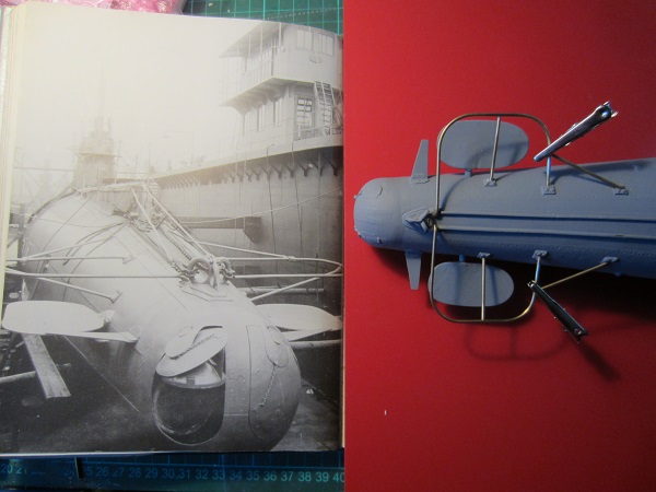

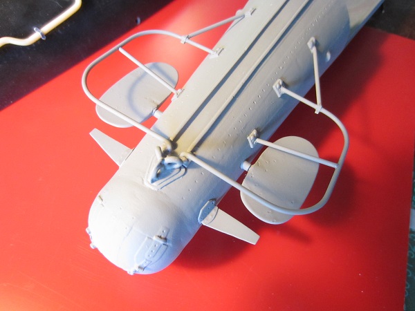

One of the last major features to be added to the external detail of the hull are the metal frames which protect the forward diving planes. The mounting points for these had already been cast into the GRP hull.
Interestingly photos show C1 both with and without these frames. The detailing for these on the model was based on the wonderful bow photo of C1 taken whilst she was in dry dock. I have reproduced this again alongside the model
One can only assume that these frames caused a considerable amount of drag in the water, reduced performance and if damaged risked jamming the diving planes. It might be that they were only bolted on when it was thought they were essential?
I decided that they look good, adding extra detail, and afford considerable protection for bow diving planes on this working model. I chose brass wire (1.5mm) to make them, bending each frame to shape around a suitable wooden dowel. Holes to accept the frames were drilled in the hull. The brass frames were then installed and CA glue was allowed to capillary into each hole to secure the components in place. The metal to metal joints were soft soldered. Small crocodile clips held everything in place while the latter two stages were carried out.
The finished frames proved very strong and add considerably to the character of the model.
The last picture shows them in primer paint as I start to prime the hull.

File comment: The brass frames fitted "dry".
File comment: The model next to the picture of C1 in dry dock.
File comment: The frames installed.
File comment: These should protect the bow diving planes quite well. Here they have been primed.

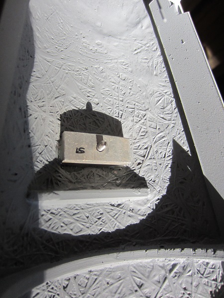

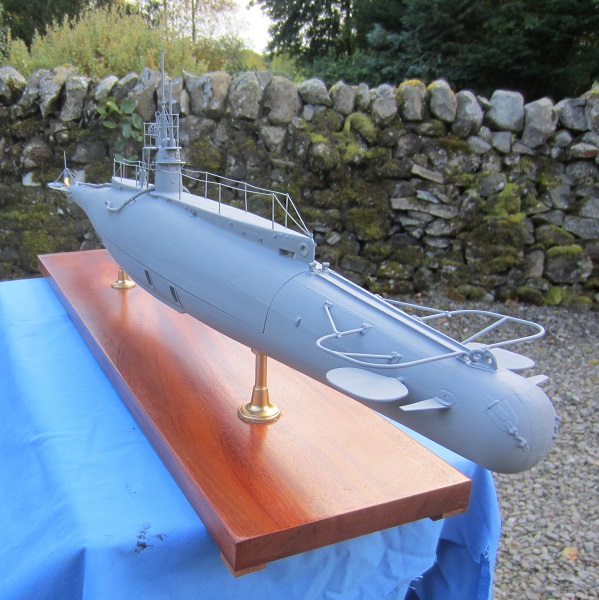

Strangely the next item to be made was the stand.
Before I could continue with the paint finish on the model, it had to be secured and made level so that the waterline could be drawn in. The easiest way to achieve this is on a level surface with the hull held rock solid.
The stand is made from a nice piece of recycled 19th century mahogany (being a furniture restorer as a day job has hidden advantages). The support pillars are turned from brass and drilled right through before being fixed with epoxy to the base. The top of each pillar has a soft rubber washer glued in place to prevent scratching the model’s paint finish. The two 3.5mm holes on the underside of the model hull are barely visible and will help with getting water either in or out of the free flooding hull section.
Two long stainless M3 bolts were made up, each with over sized wing nut heads. Having these, made removing the model from the stand easy and no tools are required. The wing nuts recess into countersunk pockets on the underside of the stand.
Inside the model hull two shaped and tapped aluminium blocks were glued, also with epoxy. The system works well and the model hull and stand becomes a single unit without having to over tighten the bolts.
This base is going to be handy not just for displaying the model but for holding the lower hull whilst setting/installing up the internal WTC.
File comment: The wooden base and turned brass mounting pillars to support the model.
File comment: The red arrow indicated the soft rubber washers fitted to each pillar.
File comment: Two threaded aluminium blocks were glued inside the model hull.

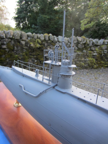

Hi all

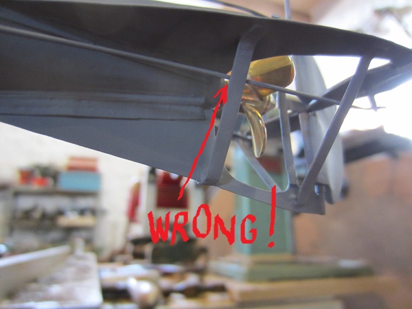

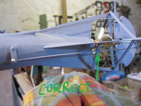

The new correct sized prop arrived. At this point I discovered a problem. The port diving plane connecting rod had been installed incorrectly, inside the fin support, resulting in it fouling the prop. I removed (un-soldered) the connecting rod and re fitted it. End of problem.
The pictures below also show the model with most of the detail fitted and now in primer. It actually now looks like a sub and as Mick said it is kind of Jules Verne (esque).
File comment: Incorrectly installed port diving plane connecting rod.
File comment: And re installed correctly.

File comment: Conning tower and fore deck.

I have an aversion to intense white on these older models which I have previously explained on this forum.
The colours I used were:-
Humbrol Matt Black Ref 33 (Below waterline).
Humbrol Matt Dark Grey Ref 32 (Above waterline).
Humbrol Matt Camouflage Grey Ref 28 (Boot topping and ID numbers).
The BECC self adhesive numbers were carefully painted before they were applied and the black shadow was added with a fine marker pen.
The completed model was spray finished with satin finish polyurethane varnish. This brings all the paint to the same level of “mattness” if you know what I mean. It also seals the vinyl numbers and protects the whole model as it will be getting wet.
I will post some more close up picture taken in day light as soon as I can.
File comment: HMSubmarine C1 nearly completed.
File comment: The external detail is just about complete. The next stage will be to return to the WTC (dive unit).
File comment: The ID numbers have been added to the conning tower.
File comment: The aft end. The model has been spray finished in satin varnish.
File comment: The 1/48th scale "shipyard manager" gives an idea of the size of the vessel (and the model). He is 1 1/2 inches.
