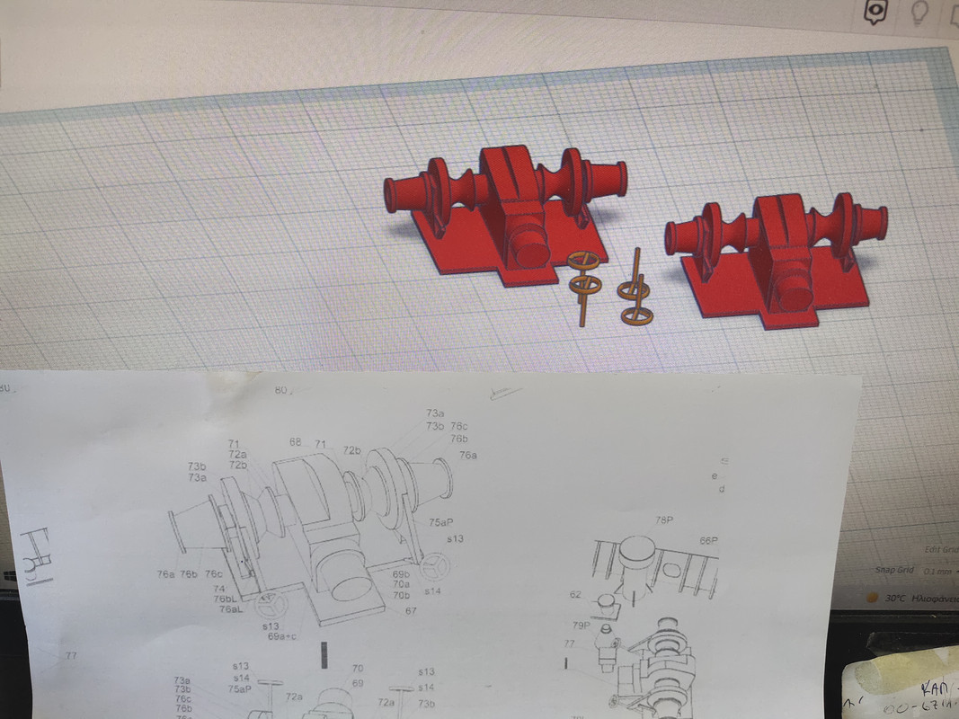

While I am almost done with the cargo holds, meantime I designed some parts for 3d printing

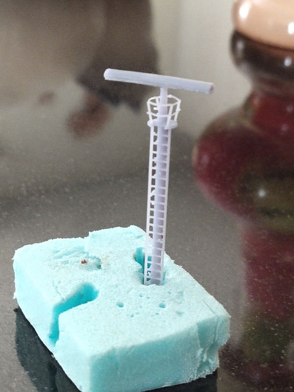

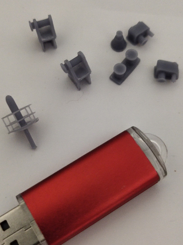

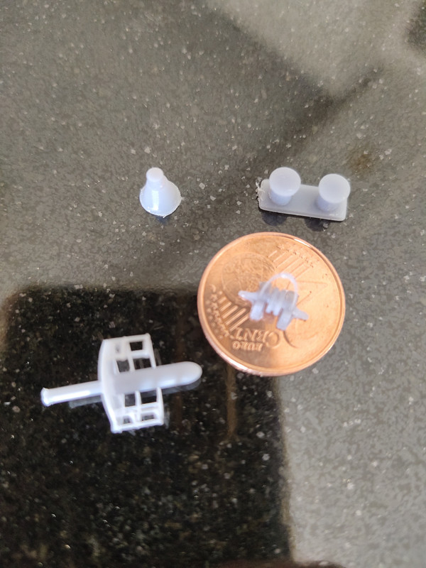

First prints were successful in general although had failed attempts. Correct printer settings takes time to be learnt. Design online is fun though

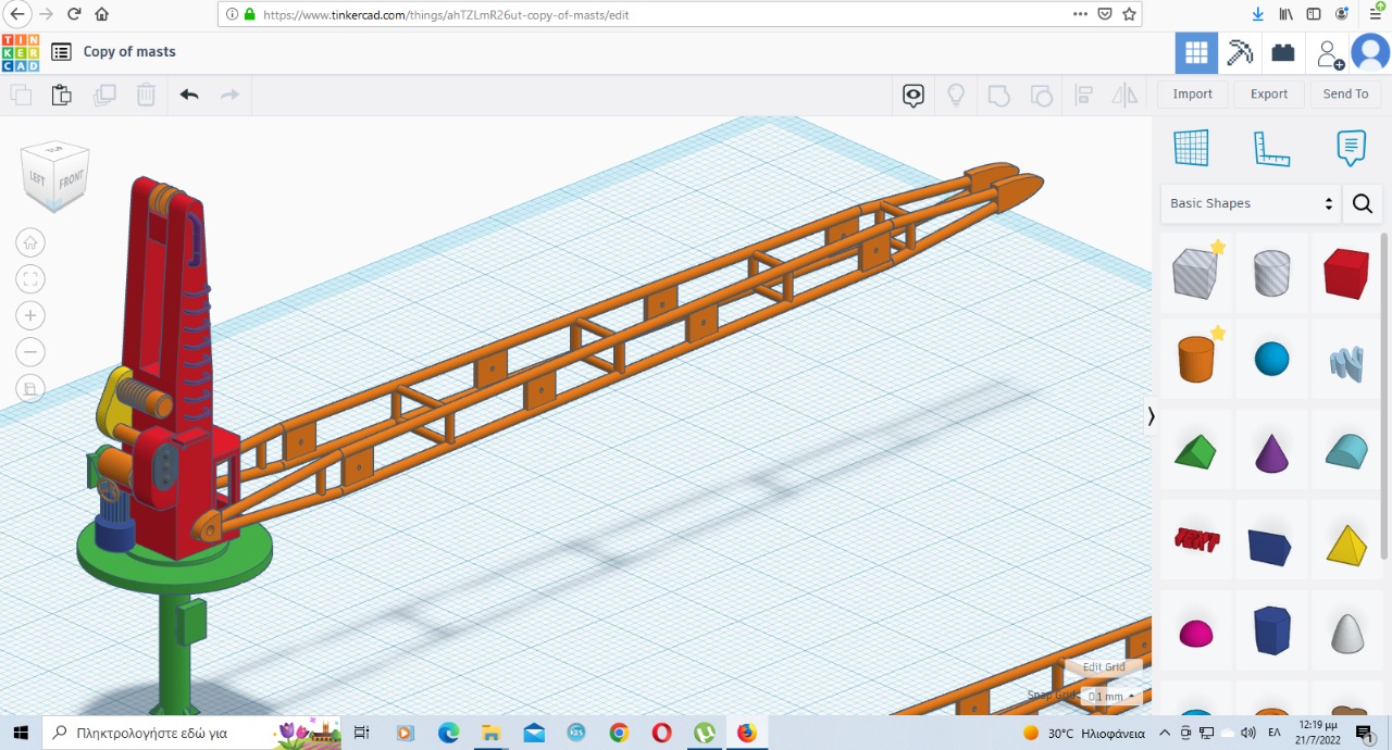

The progress in 3d is going on. I put all things together as a preview although I will print the cranes in separate pieces.

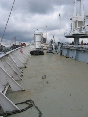

However it seems that i prefer spend time on this and avoid to concentrate on a more challenging project. To built the deck frame, present on all cargo ships of the time instead of rail bars
Because of the curvy shape that follows the hull, I'm not sure how to design yet. And still I am worry about the overall fitting of the triangle supports to the deck. A last worry would be to find a glue for resin that won't also make a mess to the deck.
For scratchbuild this piece I face the problem of finding the proper material. Metal strip would be to thin to handle and the tiny supports too hard to be made equal. So I am worry of visible imperfections
Balsa over 1mm would be more stable and still easy to work but too thick while thinner would be very optically ideal but easy to break unles

For my current project I photo-etched these bulwark stanchions. In fact, they were made as mirror-image surface-etched parts and then soft-soldered back to back.
To avoid issues with glue-smear, one can glue them in place using the same paint as used for the bulwark and deck. Quite fragile the whole though. One can also use locating pins, but it is difficult to drill the holes at the correct places.

As you can see, the framing on the real ship isn't visually perfect neither. Look at base inward tip of each frame and you'll see they aren't on a nice curved line either.
You could either use plasticard or very thin plywood. Plywood of 1mm exists, I've used it on the Chaconia bulwark as well. It does have some drawbacks, like texture, but it's quite easy to work with and still quite strong.

My APA has a similar bow bulwark. Though not perfect, the bulwark is made from Balsa, slowly sanded from each side, the outside finished to blend and match the hull, then the inside thinned slowly with sand paper. A very thin glass cloth could be applied to the outside and faired into the hull, for strength. I used paper or plasticard for the bracing though these could be printed. These actually add some strength.
Good luck with whatever you do, persistence, not a stranger, may be necessary!
