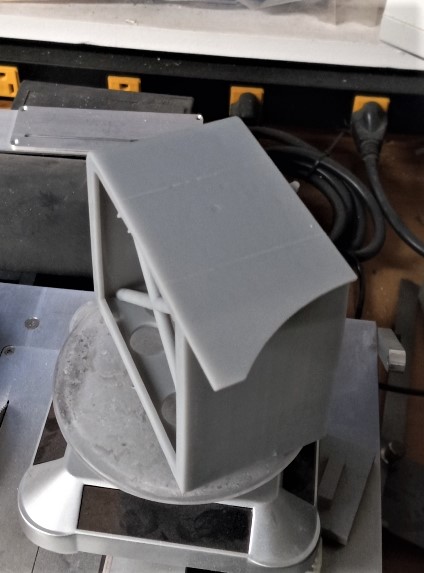

My attempts (2 trys) finally paid off on printing the 5" gun tub directly on the printing platen w/o supports. Yesterday's efforts were nil due to not realizing that the tub was actually not on the plate, but somewhere above. What printed was a Dali-esk shape that got deep 6'd. Today I did the orientation a bit differently, aligning the part from the side view and thus getting it to sit on the platen, not above it. Printed very well and after painting and getting the mount installed, I'll post photos - maybe tomorrow.
My sounding booms also printed today (oriented flat) as they didn't yesterday (@ 45 deg.). So, still a trial & error type of production of parts. Learning curve intact!!
PostPosted: Fri Jan 14, 2022 10:24 pm
Posts: 5058
Hank:
I guess I forgot to mention the small detail in that you have to set the elevation of the item to zero, otherwise it is sitting in mid air without supports. All's well that ends!

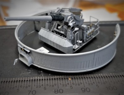

OK, so here are a couple photos of the 5" gun tub that I printed flat on the printer plate without any supports:
The first edition tub that was printed using supports had a very uneven underside which I sanded flat. This one would require no cleanup at all. Here is the tub with the mount, towing hook pad in place and painted:
I haven't figured out what caused the stridations on the tub walls, but I will sand, apply some putty, resand & repaint if I decide to actually use this tub instead of my 1st version. I'm now going to revise the sounding booms slightly and then reprint in a straight up orientation as the last version had flat areas due to printing flat.

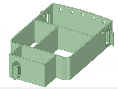

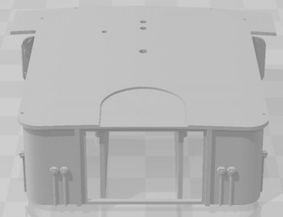

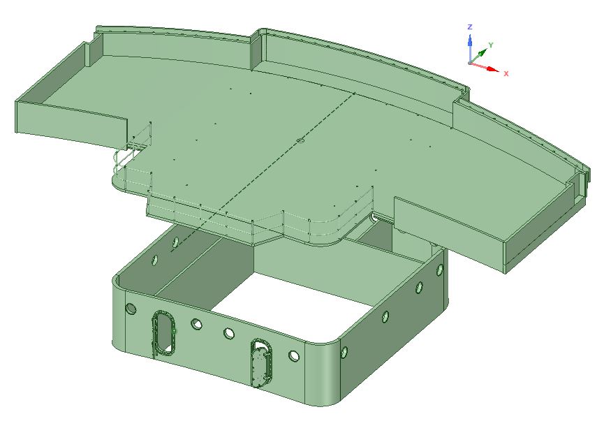

After printing most of the parts for the forward superstructure, I've been assembling and in the process, I realized that some serious redesign was in order. The pilot house was too long by about 1/4" so that got redesigned and I managed to add some refinements to the design along the way, including a depression for accurate placement of the Mk. 52 FC Director tub as well as placement holes for various deck equipment. I also corrected the deck camber of this part and will follow thru with each deck & deckhouse located below to ensure a proper fit. I'm also redesigning the Navigation Bridge Deck & Upper Bridge Deck to be one unit with the adjacent superstructure below each of those decks instead of separate parts. These will need to be then sectioned into printable parts (each side + middle) but will include the deck above with the deckhouse below. I will follow this plan for the remaining superstructure down to the main deck level. Here are some design pix:
File comment: New Pilot House from aft
That will sit above the Nav Bridge Deck which I've also got close to being completed:
File comment: New Nav Bridge Deck
In the meantime, other work includes thickening up the tub walls of both the sky lookout tubs and the Mk. 51 FC director tubs - they were too thin and had gaps in the printed editions. These are now reprinted and painted and ready for their details to be added. I've also reprinted the Pilot House RADAR room extension after doing a bit of redesign on it, as well:
File comment: New Pilot House RADAR Room Ext
144 scaled T-3 New Pilot House RADAR Room Extension.JPG [ 15.37 KiB | Viewed 751 times ]
This will be attached to open (after) end of the Pilot House prior to located the completed unit to the Upper Nav Bridge Deck. It came out really well from the printer and I'm in the process of painting. Of course, I may need to go and inventory small deck gear to make sure I have enough for a 2nd version of the pilot house as the 1st edition has all those parts on it and will probably be sacrificed due to them not surviving removal. If not, I will do a loaded print run of various parts.
