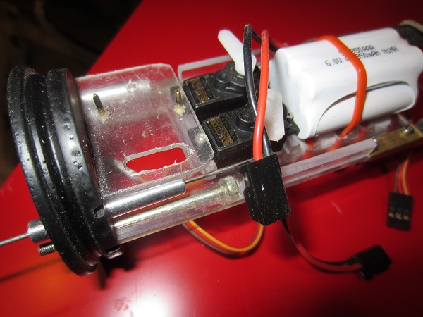

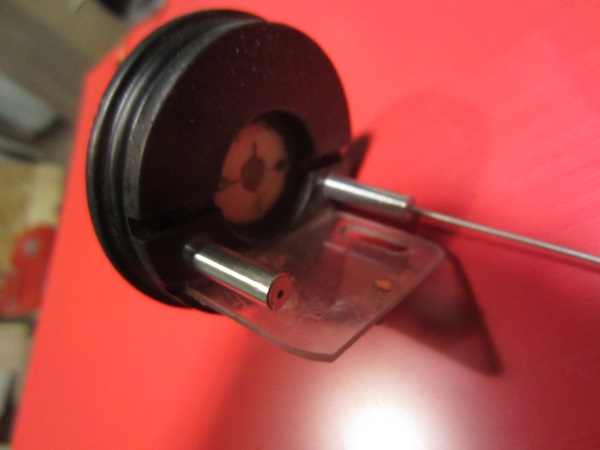

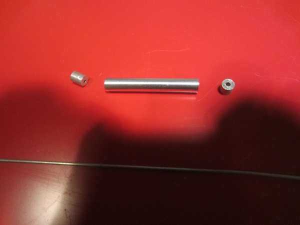

The WTC end bungs needed to be fitted with seals for the rudder and diving plane connecting rods. These seals or waterproof glands were made up from thin walled aluminium tube. Aluminium plugs were turned up for each end of each tube. These plugs were drilled to take the rods. After push fitting one end plug the tubes were one third filled with RTV silicon rubber, the stainless steel connecting rod previously had been sprayed with release agent. When the silicon rubber had set the remainder of the tube was packed with waterproof grease before push fitting the other end plug.
I’m pretty confident that this will provide a watertight seal yet not restrict the movement of the connecting rod.

LOL. Yeah, those things are funnier if you're made to work for it. Dear God, tell me you didn't tell her what you were laughing at.
Anyway ...
With your seal hydrostatic force will eventually shove the grease and water into the dry space -- stuffing tubes went out with the buggy-whip. How about some of my seals? Suitable for 1/16" or 1/8" pushrod diameters. If so, send me your address and I'll fix you up. dmeriman@aol.com
Those seals have a body diameter of 1/4" and the length is about 1/2". They'll last forever and only require the occasional drop of silicon oil on the pushrod.
