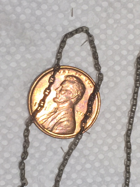

Amazingly the 1.3 mm stud link chain printed well with careful hand arrangement of the supports (lots of them). I counted 17 links/inch.
The ne pen ultimate of bad eye phone photos. But it is pretty dinky and remains sharp and flexible!
Tom
Tom

Willie.
Printing chains is not merely going beyond the beyonds: it is actually to jump out to the outer space and remain there for three months.Fliger747 wrote:Amazingly the 1.3 mm stud link chain printed well with careful hand arrangement of the supports (lots of them). I counted 17 links/inch.
And at this quality level... I am speechless again. Superb progress.
Nice going from beyond the seas,
Willie.

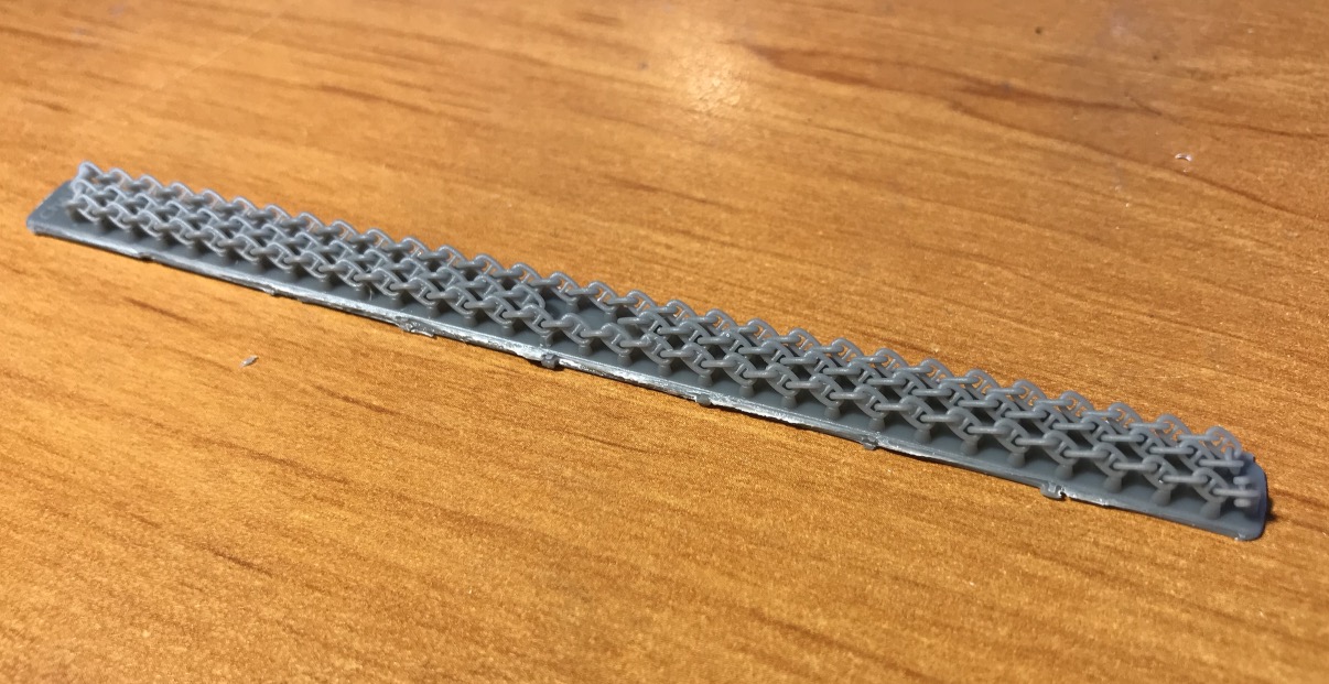

Now you have my curiosity up! Did you set up the 3d print with each link having an individual support? I have a printer and might be interested in going after some scale chain so I'm really interested in your set-up.

But, YES! - each link needs to be supported - I do the vertical links with a single centered support from the bottom and on the horizontal links I use a single support centered on each side of the link. Takes a lot of time, but you need to have each link self supported as it's an entity unto itself (theoretically, that is
Well, as we've both found out, there is a limit to how small an individual link can be printed where it's separate - and at 1/144 scale an anchor chain for a FLETCHER class isn't one of them!!! I may try again with the T-3 development work but the last run of the STODDARD chains will work fine as is.
Bruce (not to steal Tom's thread) -

I had good luck with tall (3 mm) thin supports and the chain could be nicely pulled off of them like a zipper. So far with my equipment 1.4 mm link height has been a limit for a fully flexible chain. 1.2 mm can come off the supports OK but tends to fuse slightly when curing. It can be bent easily, but isn't limp. I think that a more thorough washing in Alcohol and a minor curing might work better. Possibly it could be placed on the model uncured and then cured in place?

As to the chain, each link has a fine support, the platform function in Chitubox will put most of those in, but you have to go back and delete any that are too close to the vertical links. Often it does not put a support on the horizontal links. Each horizontal link must have a support to remain free of the other in printing. I alternate the link supports side to side, not sure if this is necessary. Happily the chain pulls off the supports like a zipper. The longest 2 mm chain I have printed is about 14"!
You will find that some experimentation is necessary to come out with a flexible chain, but it's a fun exercise.
Good luck! Tom
