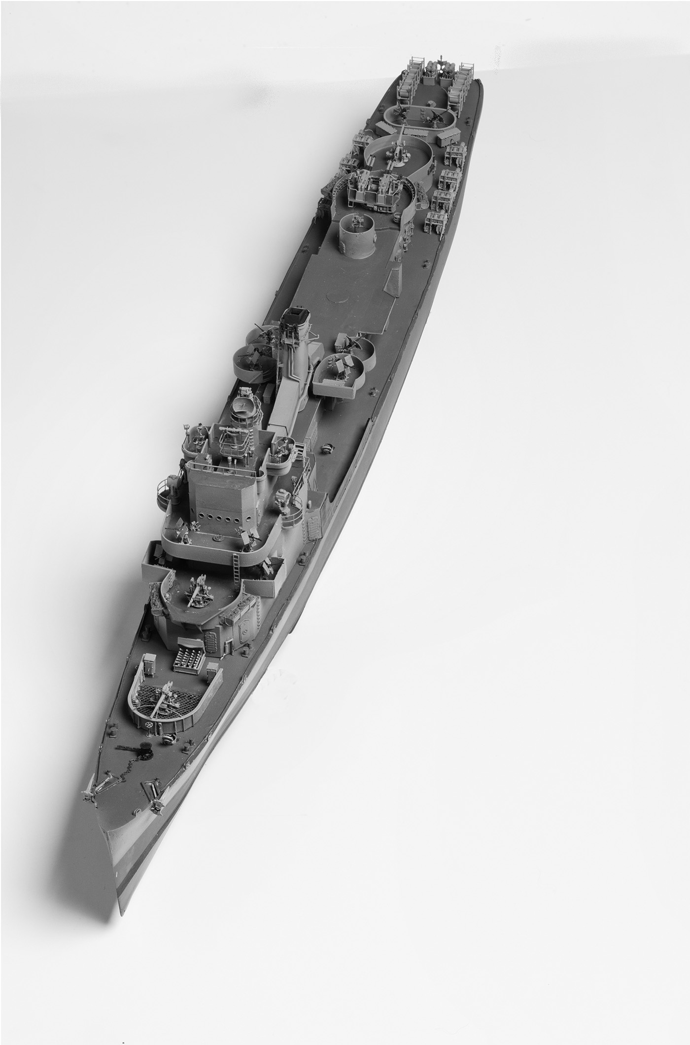

PostPosted: Sun Nov 06, 2022 7:11 pm
Posts: 5062
Added a few more items, port midships bulwark installed but not finished as yet.
Tom

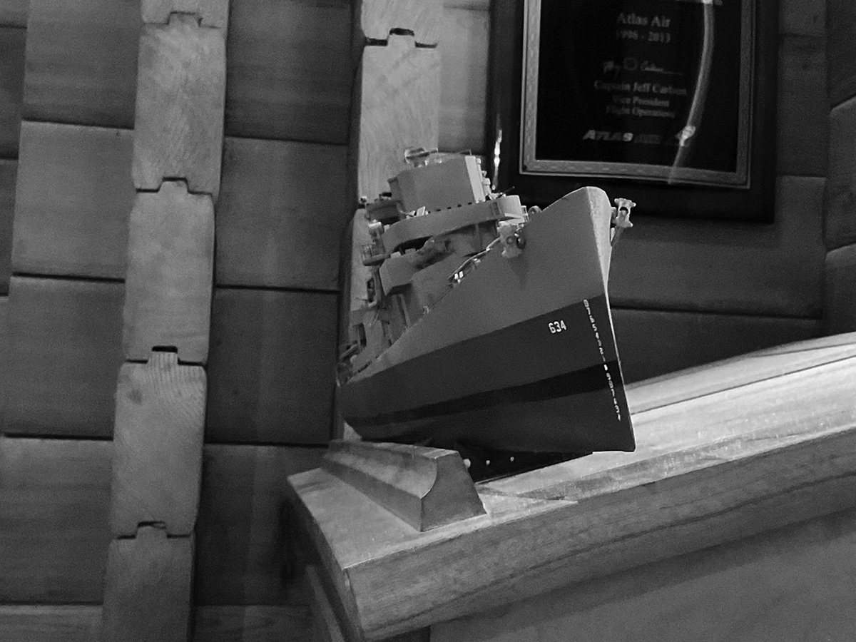

PostPosted: Mon Nov 07, 2022 3:02 pm
Posts: 5062
Eye pad (as opposed to pad eye) photo this morning. More items from the Pissantium ship works added and more to go. Next to add, forward rafts on the side of the bridge structure, supports for the midships Orlikon tubs, bow jackstaff and chock, bow towing pad, make aft raft racks, vents before and aft of stack loudspeaker and light to front of bridge and on and on.
Be time soon to dig out the stencil machine for hull numbers etc. Always a little bit of a task to get it adjusted such that it barely but completely separates the small hull markings without over penetrating and curling the tiny characters.
Best regards. Tom

PostPosted: Mon Nov 07, 2022 11:34 pm
Posts: 5062
Hank:
It's out in the workshop at the moment, test wearing a few new items. That rail is where I park my morning coffee cup. I suppose the greatest danger to any of the models is an earthquake, an occasional occurrence.
Having to decide whether or not to repeat the printed masts with piano wire reinforcement or build from Brass. Because of the small scale the 1:514 version was a brass mast.

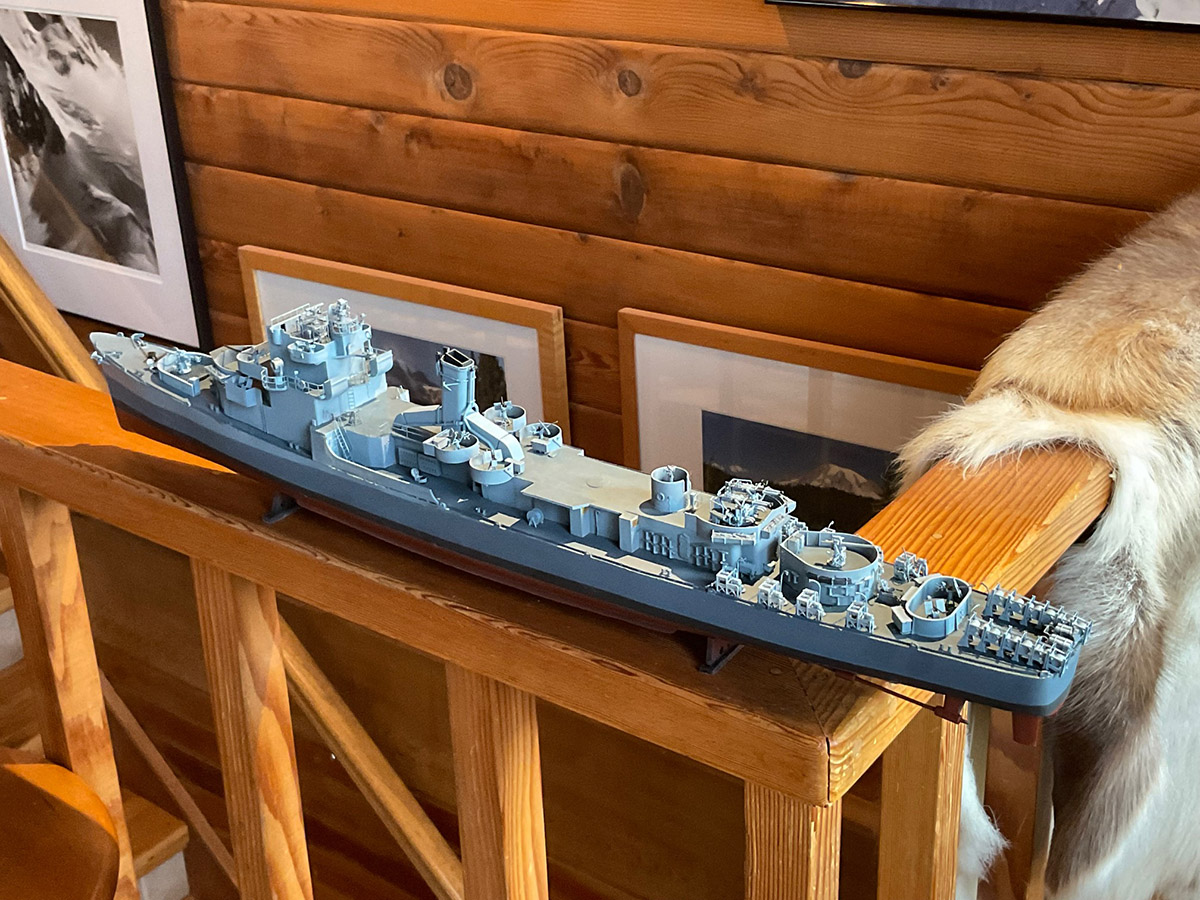

Thank you Rick! Interesting discussion. I have no idea what Whitehurst (DE 634) had though she was retained into the mid-late 60's as a Reserve training ship.
Here she is this morning ready for a sideways launching though these ships were built by Bethlehem Shipbuilding San Fransisco so probably had a natural birth.
Mast print was mostly a failure, bottom portion looked like it had arthritis (bad case).

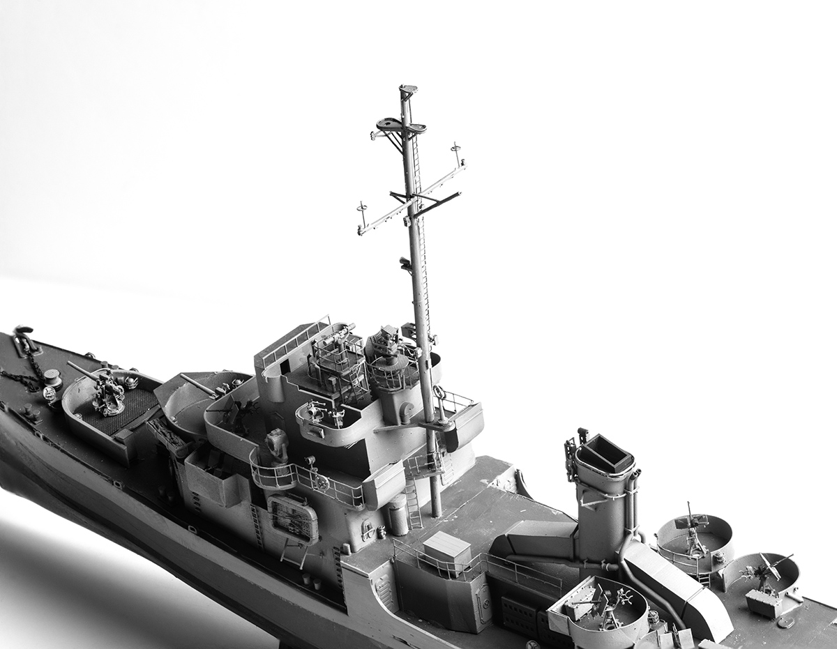

Masts seem to have printed OK at about a 60 degree angle, advantage to this is it is easier to arrange supports which will not interfere with the actual object. First thing I did after an initial rinse was to run a piano wire through to ensure a clean bore. Both masts have a small parting of the vertical ladder at the same point, but I printed extra ladders so it's a minor repair. Drying over the heater vent, which seems to be an effective method. The thin rapid black resin can form bubbles of resin in the hollow mast, preventing the supporting wire from passing all the way through unless it is carefully cleaned out.
Stern draft marks have been placed, which seem a little odd, indicating draft to the bottom of the hull, not the keel, which is only a couple of feet here. Waterline being at 3'.
Postscript (doubling a post) : Basically de platformed the mast and stepped it in place, looks good. The cross piece that locates the signal yard has a small hole that needs to be drilled, such holes tend to fill in. The yard is printed in two pieces and joined by a piano wire that passes through both and the mast hole. For printed parts, the lack of turgidity suggests that yards also need a reinforcement.
PostPosted: Sun Nov 13, 2022 7:23 pm
Posts: 5062
Mast stepped and yards added, contains piano wire inside for mast and yards.
