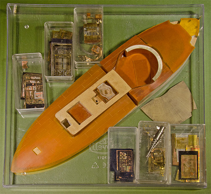

I hope everyone made it safely into 2017. Now that various toolmaking and machine-building projects (http://www.maritima-et-mechanika.org/tools/diefiler/diefiler.html, http://www.maritima-et-mechanika.org/tools/micromill/micromill.html, http://www.maritima-et-mechanika.org/tools/handsander/handsander.html) have been completed I am returning to SMS WESPE after a long break.
First I had a look at the box with the parts already made to aid my memory a bit:
Also, the building-log proper is a great aid in recapitulating what has been done already. I hope to be able to soon report here on real progress ...

I then turned my attention back to the hull and its superstructures. All surfaces that would have been iron plating, will be covered in thin sheets of Pertinax. The necessary holes for portholes and other opening will be drilled or cut before the sheets are fixed. In this way the barbette was lined with sheets of Pertinax as was the deck-house.
Deck-house covered in a thin sheet of Pertinax
The decks on the prototype were iron plate and this plating was covered in oil-paint that was mixed with sand and cement in order to provide a certain corrosion resistance and above all a better grip in wet conditions. A modelling plan drawn by Wolfgang Bohlayer shows wood on some decks, but evidence that since has become available shows that this was not the case. Also, linoleum decking apparently was never used on these boats.
Engraving plate-lines and planking seams
As the model will show the boat in its original appearence, the plating was reproduced by engraving fine lines into thin sheets of Pertinax. All decks, including that of the barbette will covered in this way. The exception is the deck above the foc'sle that has a cover of planks, presumably to reduce wear, where the anchors were worked. This planking was laid-out in a radiant pattern, which seems to have been more resistant to the gun-blast than the more common parallel layout. The planks were also reproduced by lightly engraving the plank seams. In reality these seams would have been more or less flush with the deck, depending on the temperature and humidity, but a light engraving adds some life to the appearance.
Engraved rear-deck plating and planking for the foc’sl
to be continued ...
