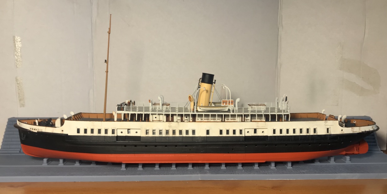

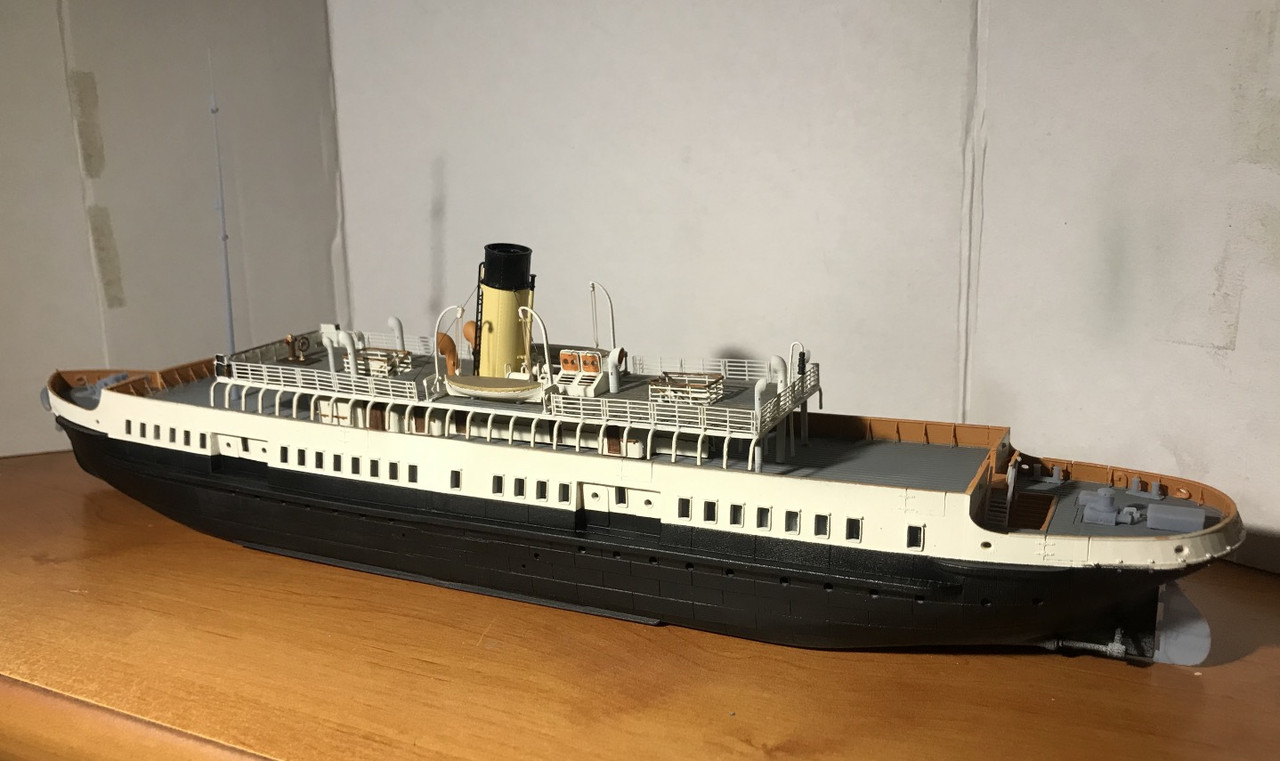

I replaced the funnel, the yellow from Vallejo does not match the White star line Buff.
So I made the colour myself, we are getting close to it.
I have finished the front and back guys.
I am still waiting for the red of the bright works, no postman since the beginning of the week... Because of the cold... So I can't glue the upper deck yet, nor put the rigging down.
I started to treat the weathering and light ageing, because the boat was one year old.
We are close to the end of the assembly.
On the left the Vallejo sand yellow, which is not sand yellow. On the right my pre 1920 WSB.

A lovely jewel! It is a tribute that it looks to be at a larger scale than it actually is. Having built a couple of ships in 1:192, I have some idea of the size of this!
Regards: Tom
Regards: Tom

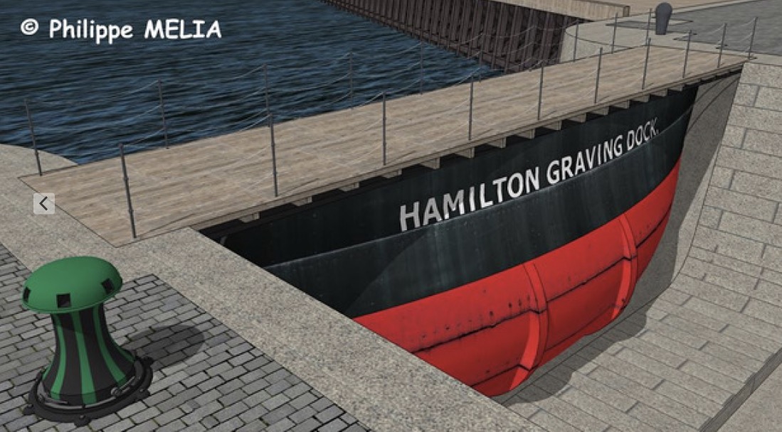

Thank you Tom! you have motivated me well to support this proud ship, because I had not planned anything at the base, while it was being carried by its mother ship.
Moreover it allows me to improve my experience of making dry docks for possible future dioramas, I like this subject which I know well. It's not to say that I don't want to make the boat-dock for this one in order to enhance the decor a little more. Just add an element at the end of the dry dock.
I have just finished the Humbrol 132 anti-fouling, I really like this colour, I would probably paint the Titanic to follow in the same shade. I still have a few touch ups to do but very little, it went well.
I simply made it more matt with a varnish.
I will now finally be able to glue the upper deck to the hull, and continue to assemble the rigging, then age it a little to be connected with the hull.

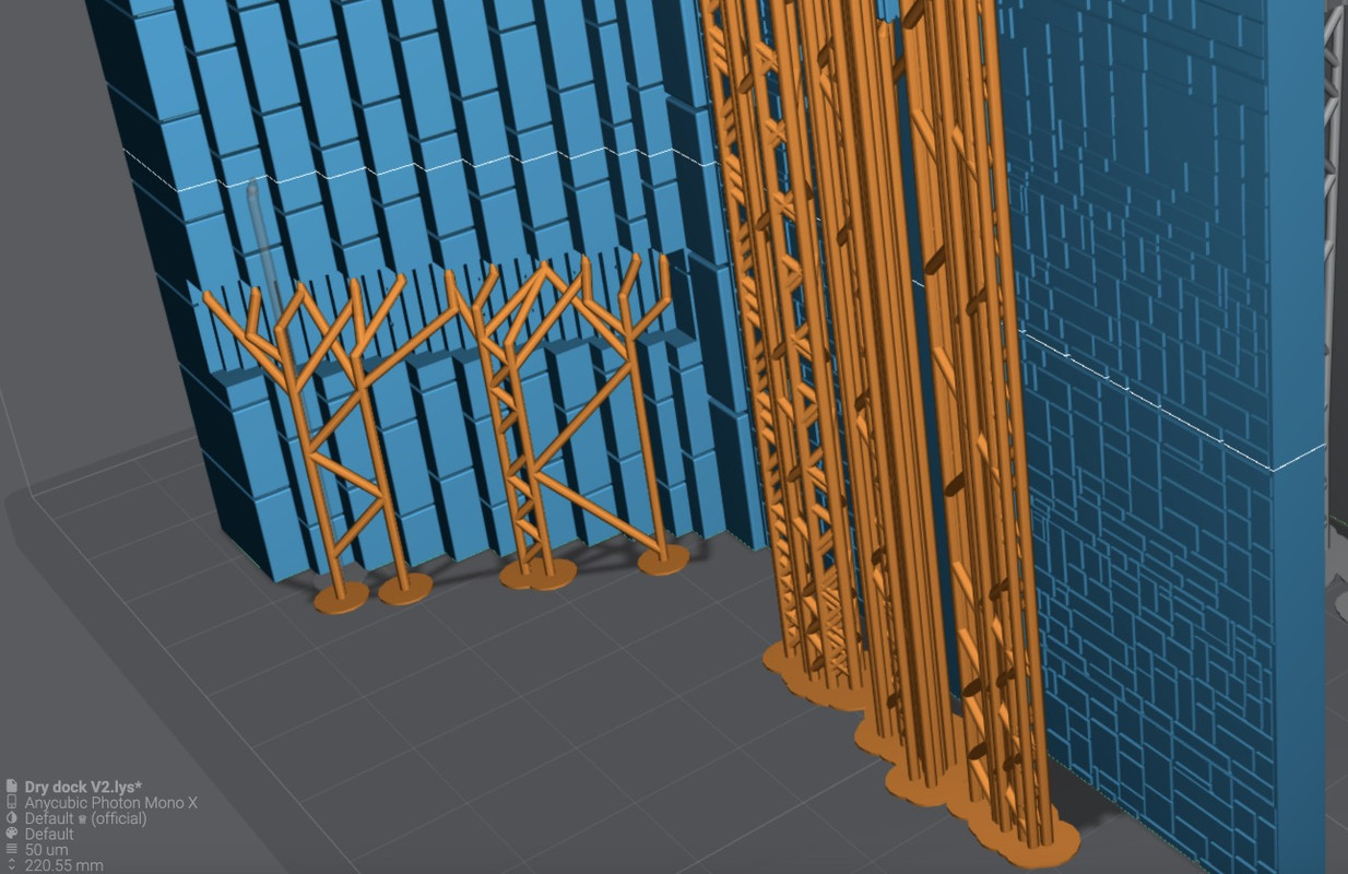

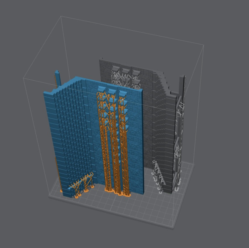

This is the largest structure I have ever printed, two 21.5 elements for a total length of 43 cm. I love this printer!
The Mac has gone through a lot of technical work to calculate all the joint lines of the dry dock stones, a big job. A simple piece to draw in appearance, but not for the machine.

that Dry-dock does really enhance the full hull model!
Most excellent-- your design and 3D printing skills are remarkable!
One of my favourite dry-dock models was this one by Sandro paretti
oh... and best wishes for a successful union between upper deck and lower hull!
JIM B

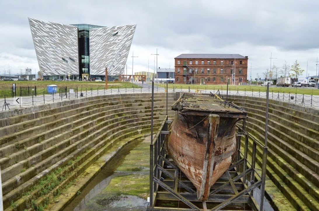

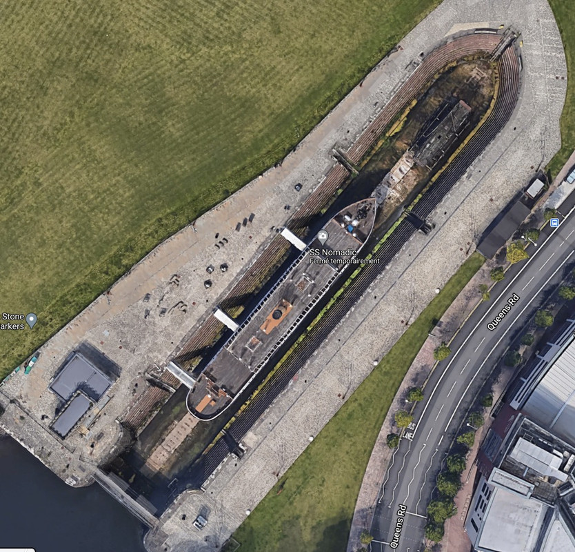

Thank you Jim for this link, it will be very helpful to me in trying to get the same thing done, but I don't think I'm getting to that level of perfection. He must have spent a lot of hours painting hundreds of stones with brushes! The colours are superb!
Thank Tom!

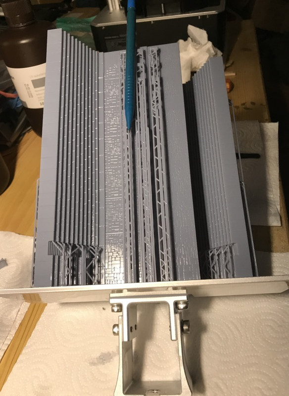

I printed both part at the same time, side by side, 10 hours. 4100 layers of 50 micron resin, 0.267 litres of resin (9.35 euros).
The type of caisson of the Hamilton Graving dock at the Nomadic:�
Putting in the propellers, I have the zincs to paint.
Thank Tom!

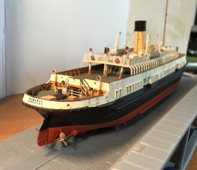

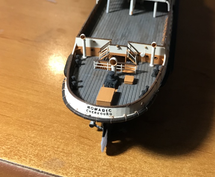

Some pictures of the day's progress:
The rigging among others, a mix of lycra infinity and stretched plastic. The upper deck has been glued, a very delicate operation.
I also worked on how to paint the drydock.
Some photos, a little dark, made with another camera much more powerful than the Iphone, I will have to invest in a photo booth...
Pascal

Probably a mix of building capacity, not being able to make such high upstanding concrete walls in history as well as the construction of vessels themselves. Curved hulls were kept upright in dock by wooden beams under an angle, the steps in the dock walls gave a good footing for those beams. Nowadays most vessels apart from warships, have flat bottoms and parallel sides, not requiring such beams.That's a lot of keel blocks for a large ship. Older dry-docks seem to use the stepped construction and newer ones (maybe 1930 or later) use more vertical concrete walls. Not sure why?
Great job on this model. I guess the stone effect in the example was created much in the same way as people sometimes recreate wooden decks by painting plastic decks. Base layer of one color over the entire surface and then add 3 or 4 shades on seperate planks/stones.
