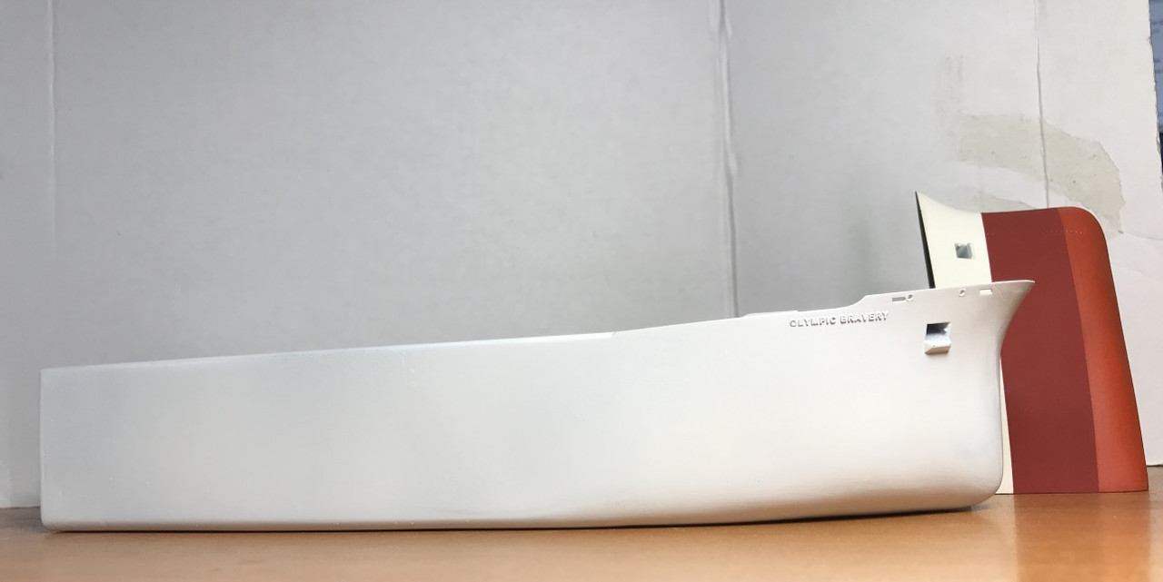

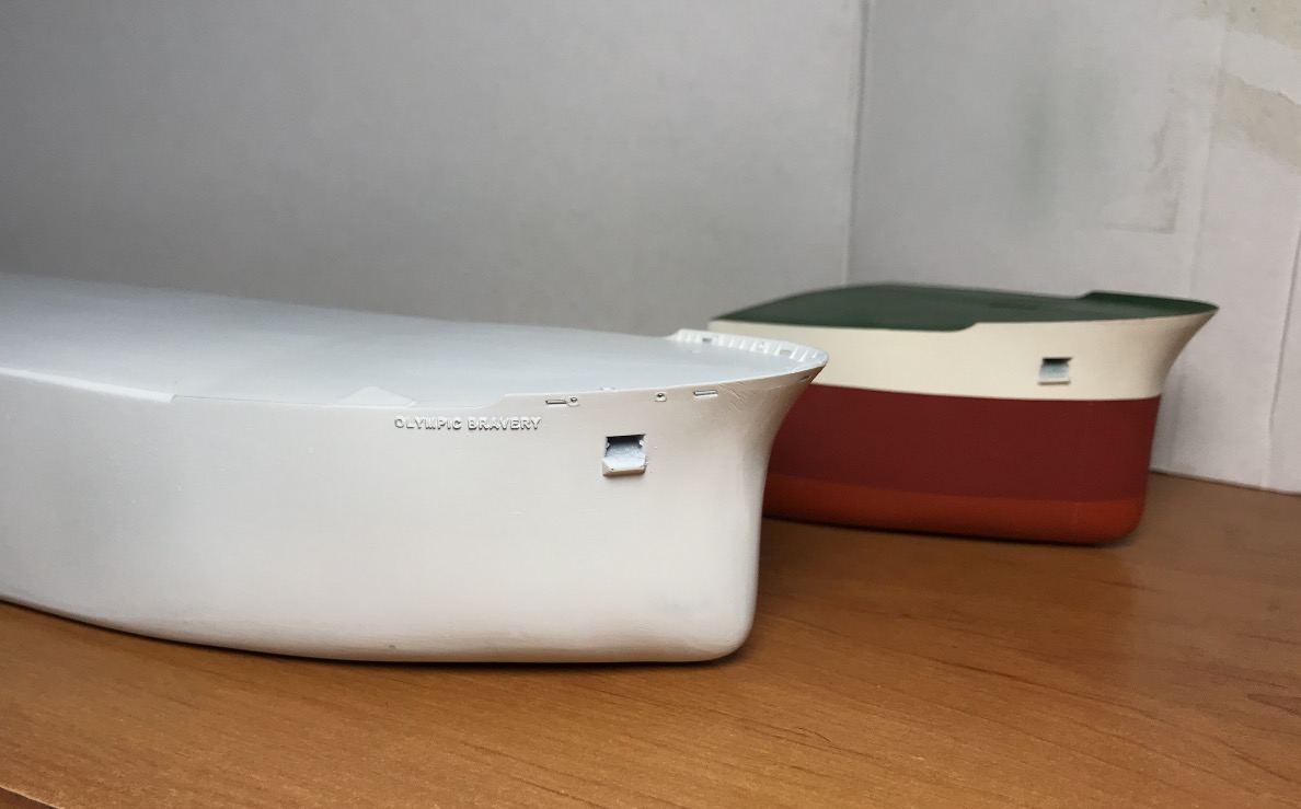

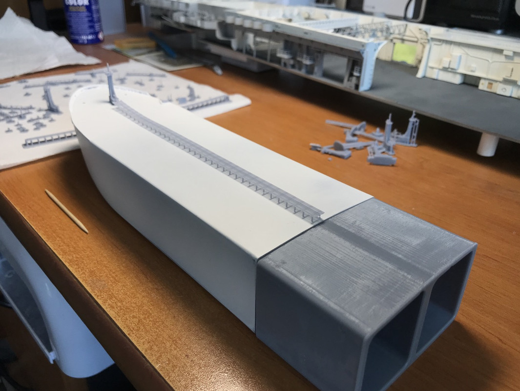

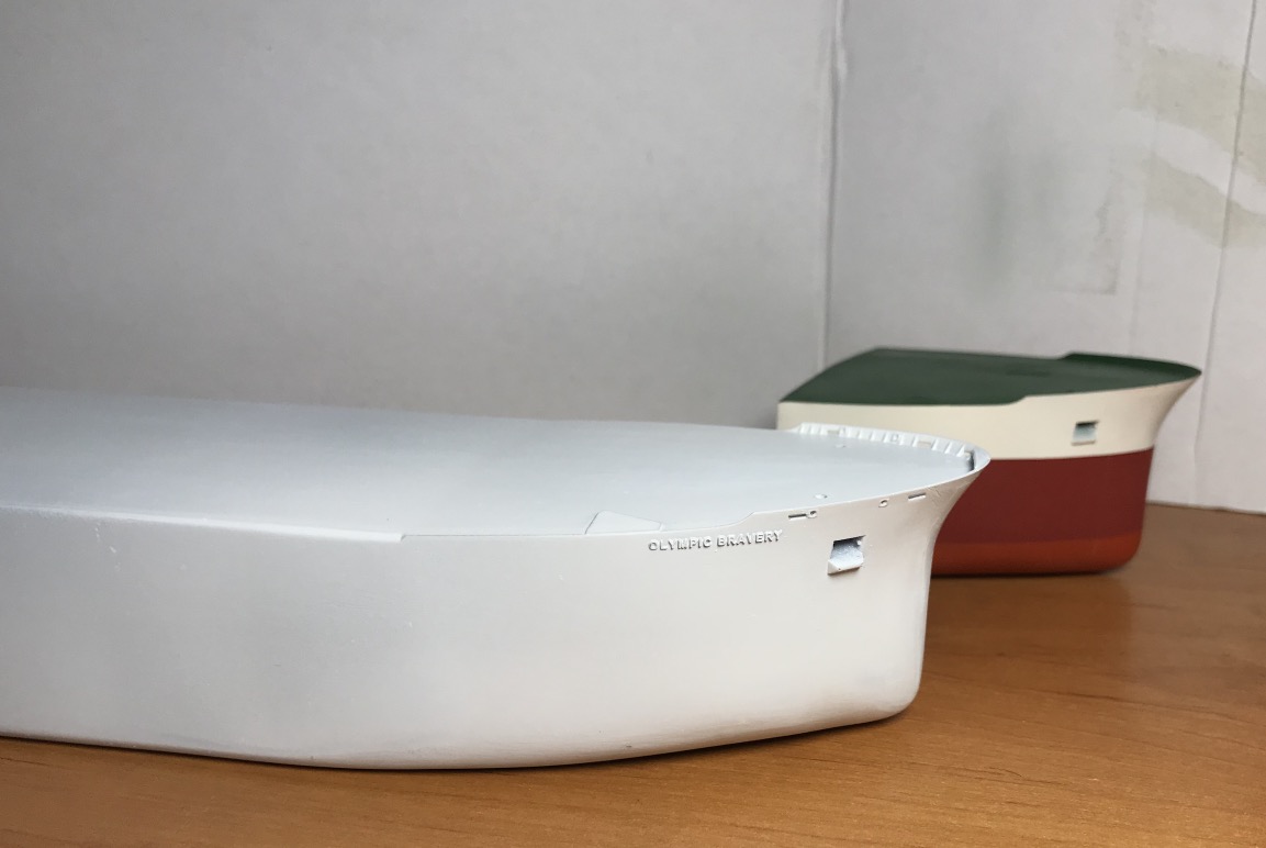

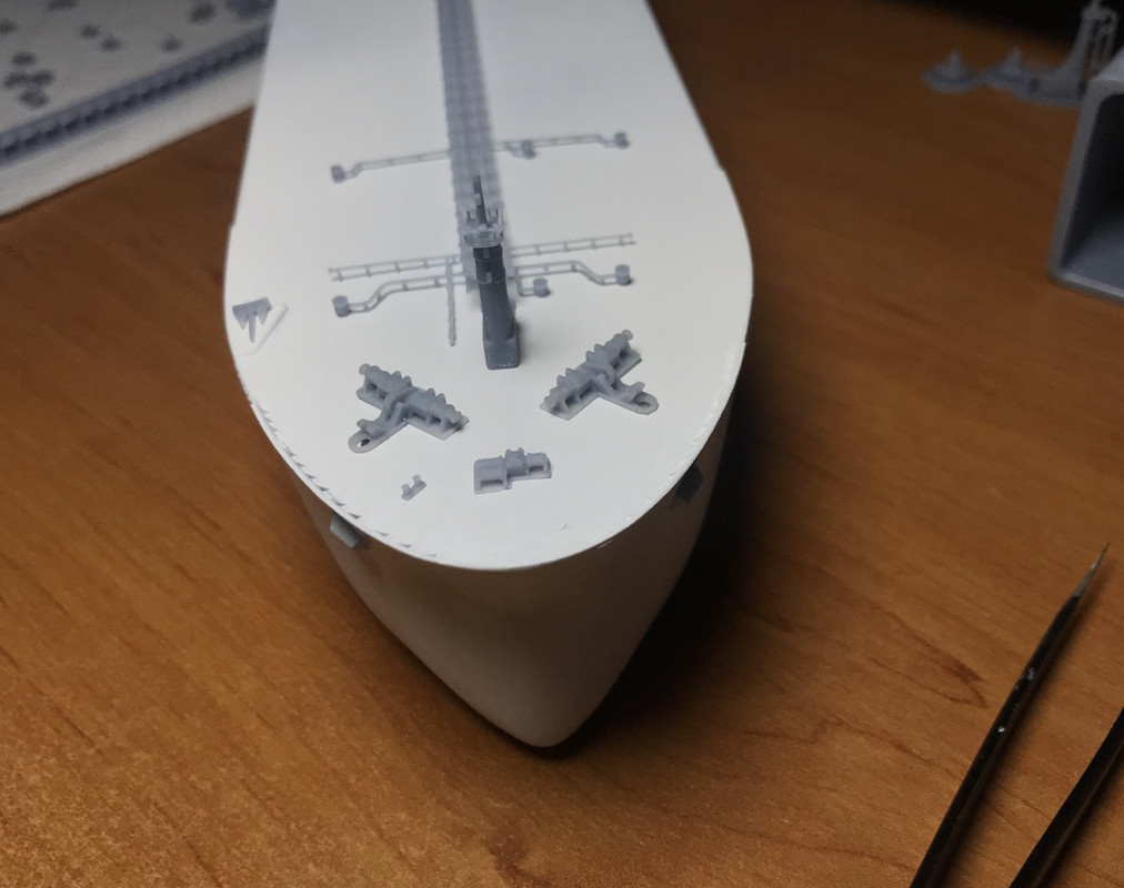

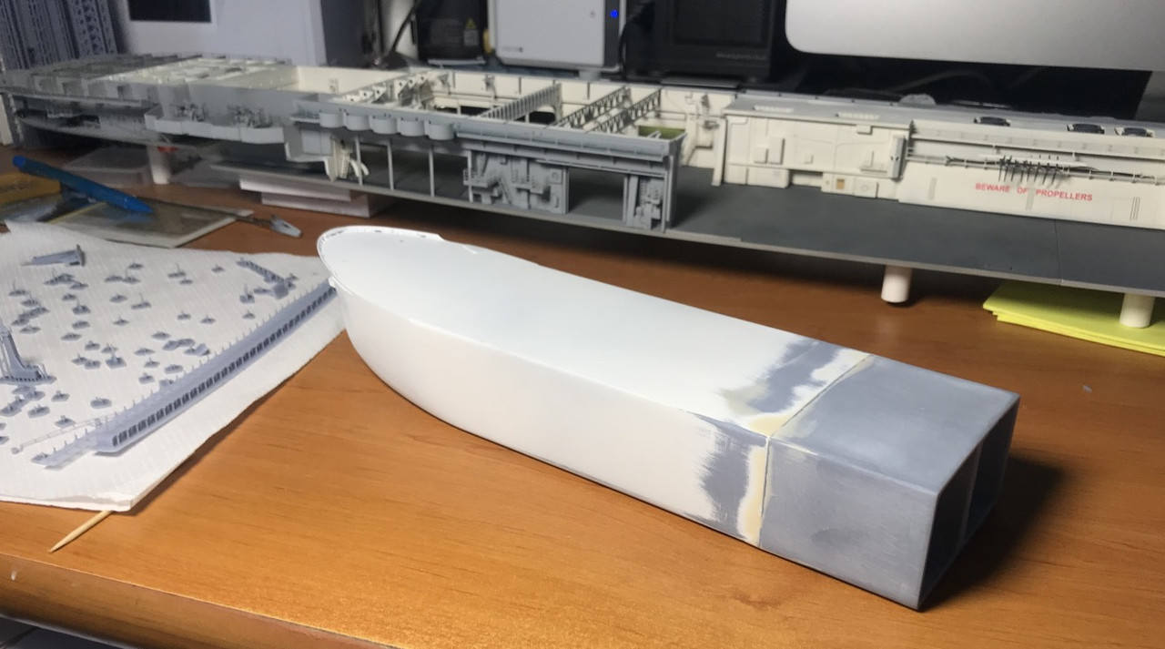

After first sanding and first coat of Enamel primer tonight. Still have to sand with 1000 paper, the primer allows to see better the areas to be rectified.
The second copy of the front part is being printed.
Pascal

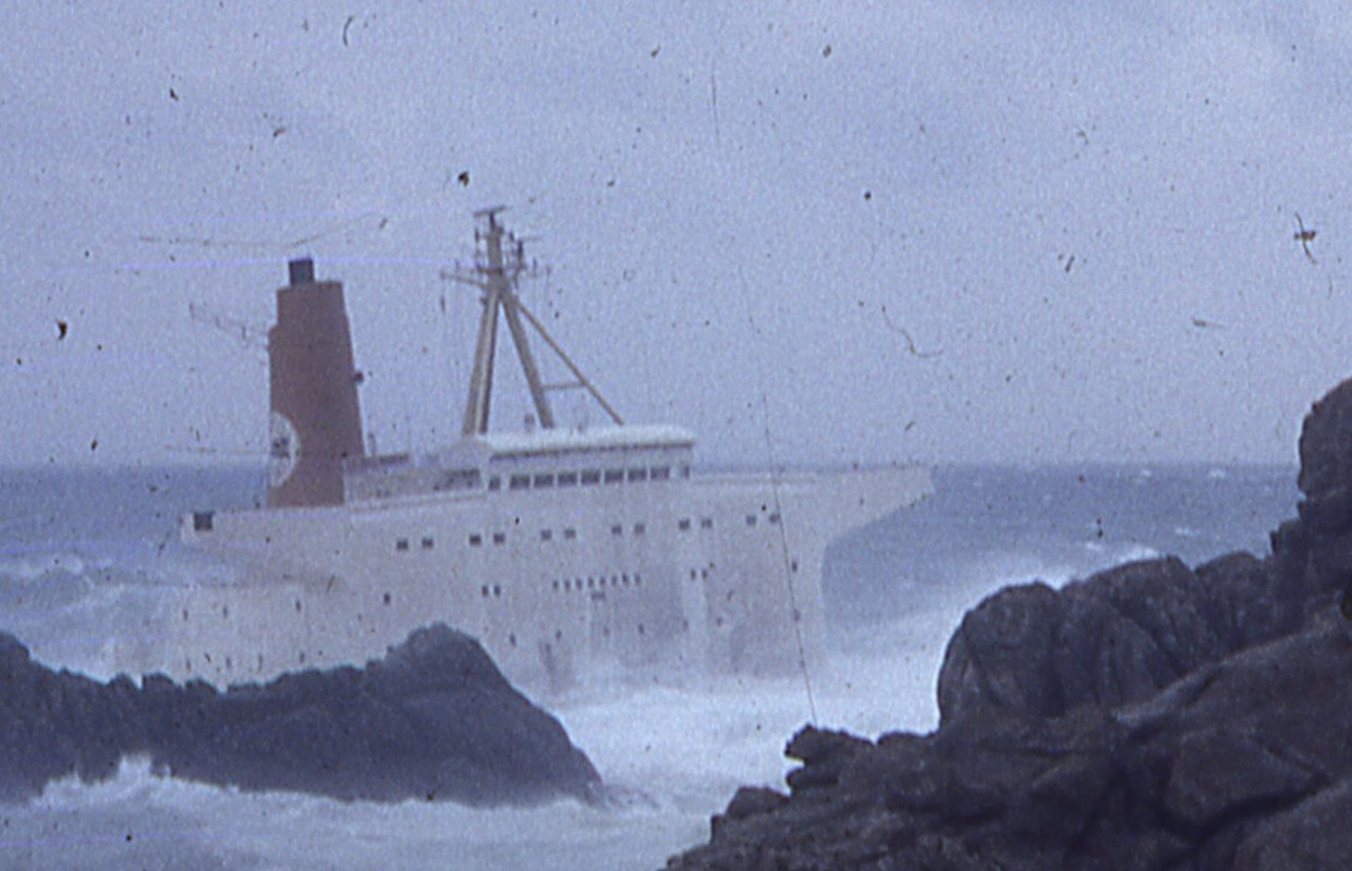

Some pictures to show the atmosphere during a storm on this charming and very beautiful island, whether in good or bad weather.  It has also been witness to many shipwrecks over the centuries. The sea currents are very violent, the winds also, the two can confront each other in a tumult sometimes Dantesque.
Lighthouse of "la Jument" and the guard Theodore Malgorne, in the storm. Erected on a stone called la Jument, "Ar-Gazec" in breton. Route of Fromveur near the island of Ouessant, Sea of Iroise, west Brittany. The keeper has survived to the wave.
https://youtu.be/AH02UMFTknI
Fromveur Passage, south Ouessant, during a severe storm:
D-646 Latouche-Treville, french frigate, specialized on anti submarine warfare, class F-70 type Georges Leygues, 139 mts long, 4910 tons displacement, crew 240 Part of this footage is also visible on the movie "Oceans" from Jacques Perrin & Jacques Cluzaud.
https://youtu.be/YuIO4Cyni-w
Wrecks around Ouessant:
Clic 2 time to enlarge:
Pascal

The second front hull is printed, but I'm out of Revell spray primer. On order.
Printing the center element.
Pascal

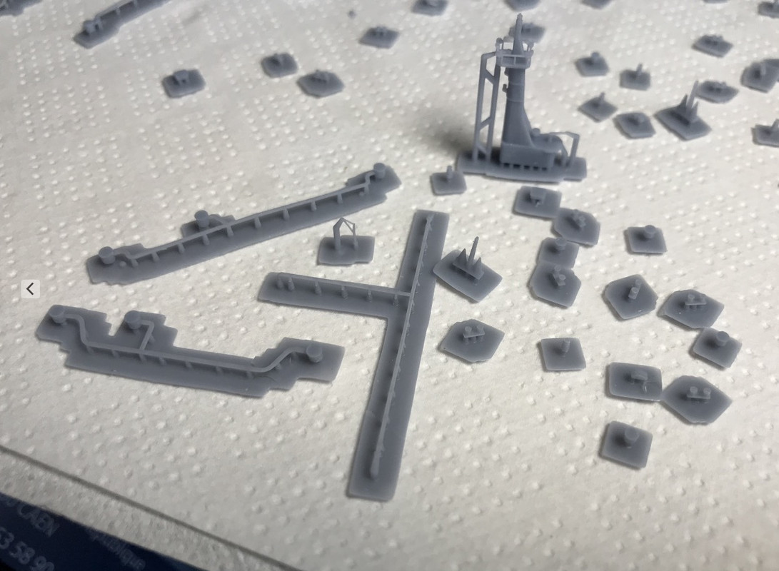

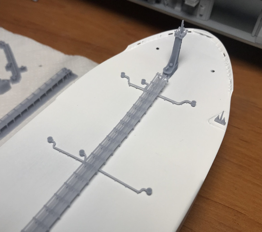

Printing of some deck accessories.

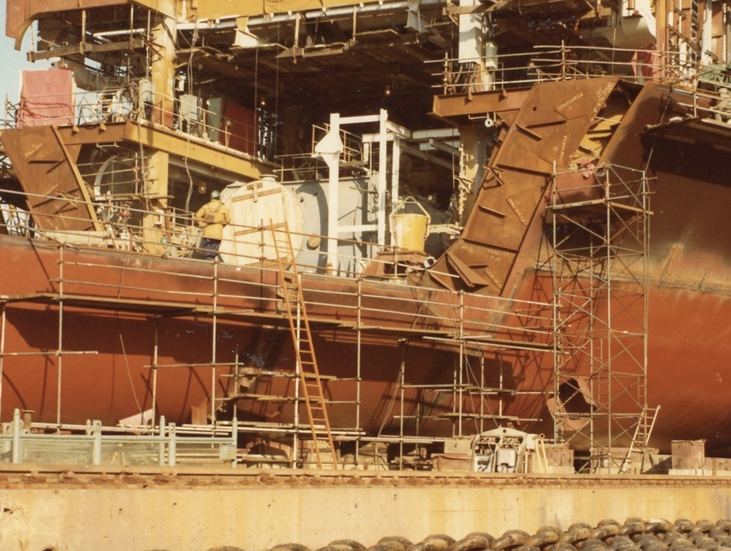

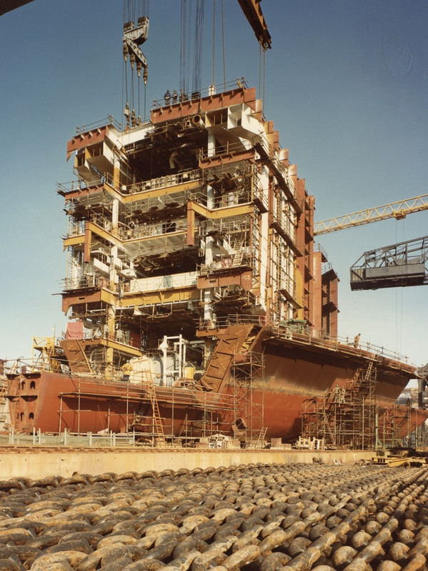

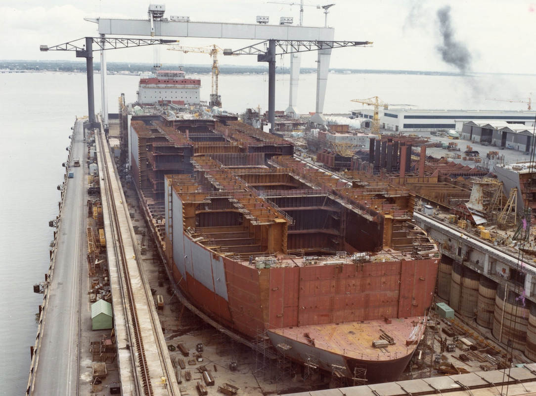

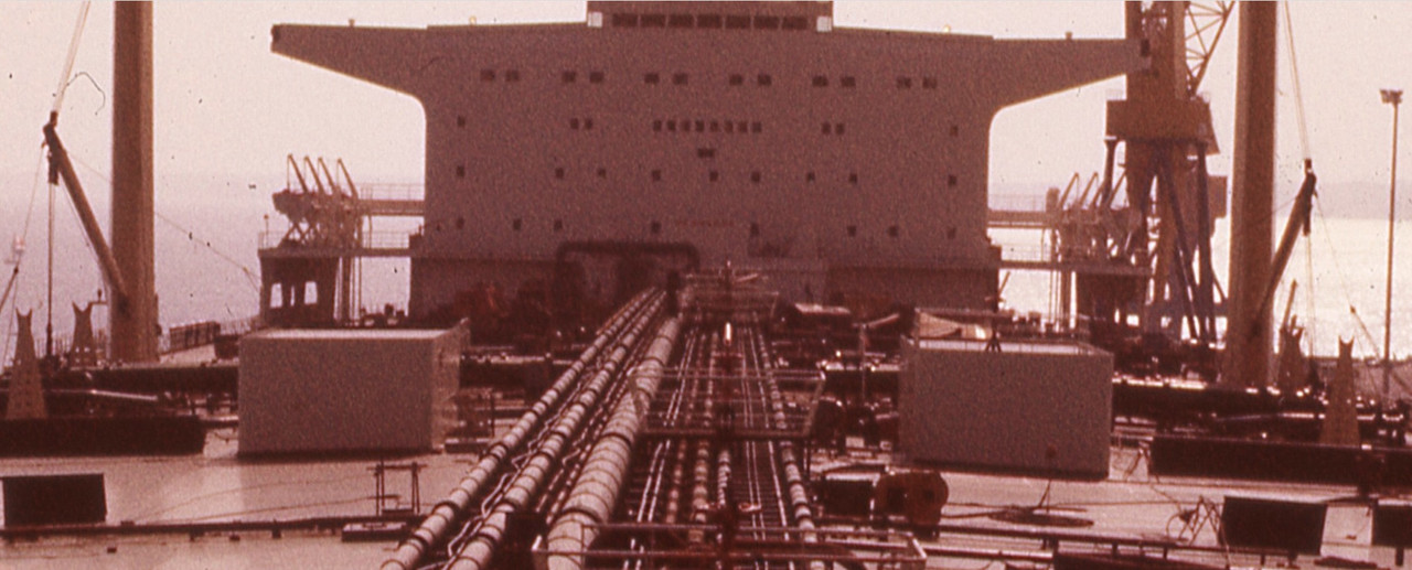

During construction at the Chantier de l'Atlantique in Saint Nazaire.
The back of the engine room
The exit of the main condenser can be seen at the bottom right, which I will have to reproduce.
Pascal

It looks good despite the small scale (1/700) of the pieces. :cool_1:

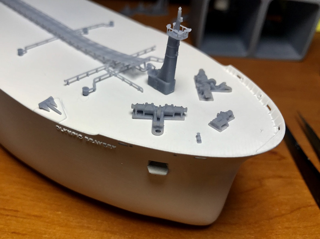

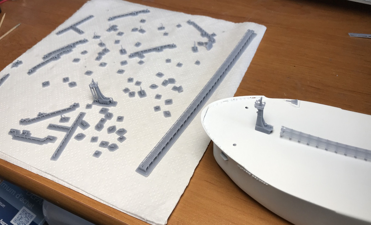

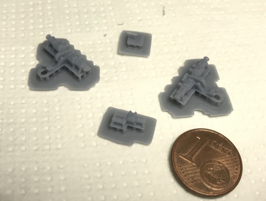

front winch and windlass, platform fire hose with physical foam:
Pascal

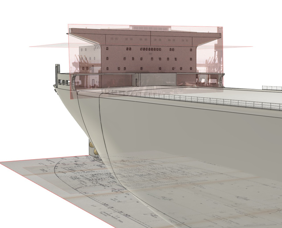

Pascal,
Quite the ambitious project - and....coming along very nicely!!! I appreciate your posting of the Chitubox layout of your 3D parts - always good to see how others are setting this up for printing.

Thanks Hank, in the future I'll post more pictures of the layout of the brackets to print, nothing "secret", if it can be people who are just starting out, which you aren't, I'm glad.
It benefits this new form of modeling, without harming the so-called "traditional" method that I also use. What I like is to quickly build anything I can think of and to serve the built model.
Pascal

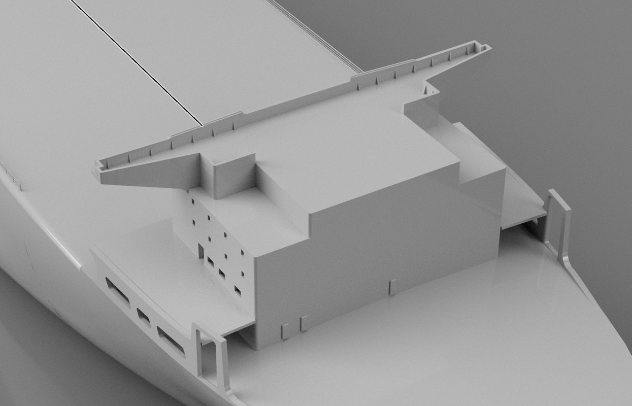

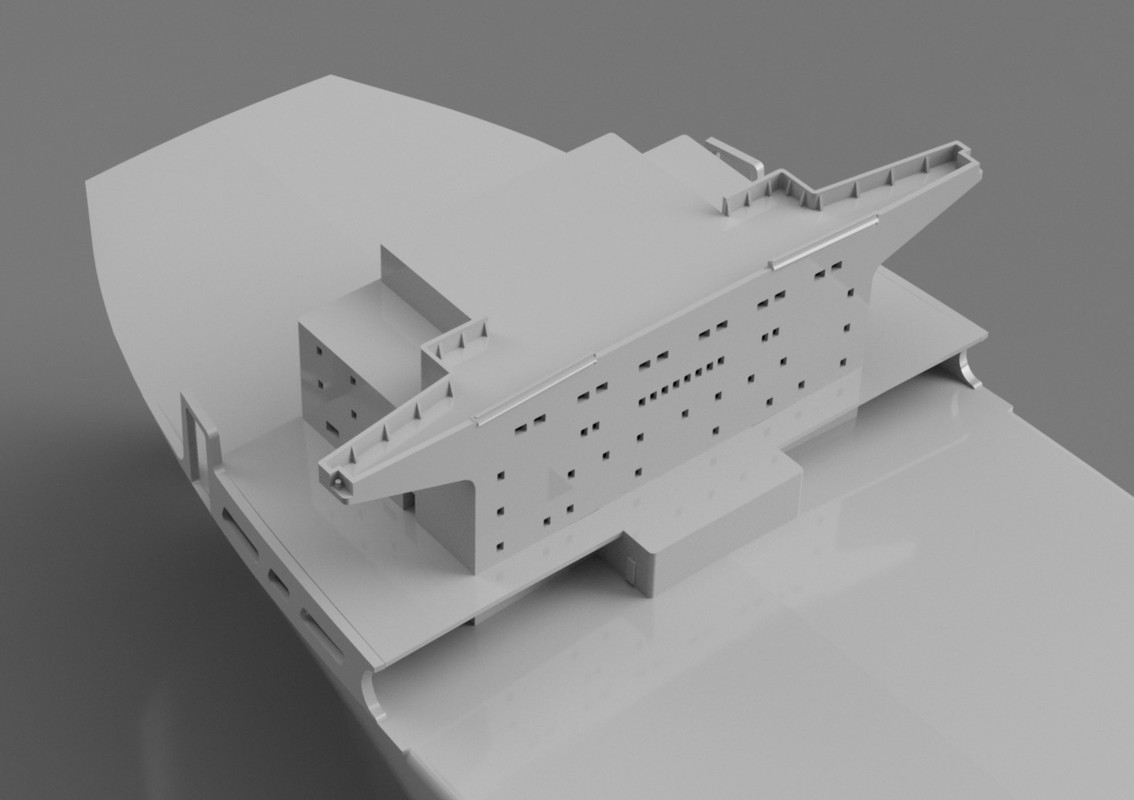

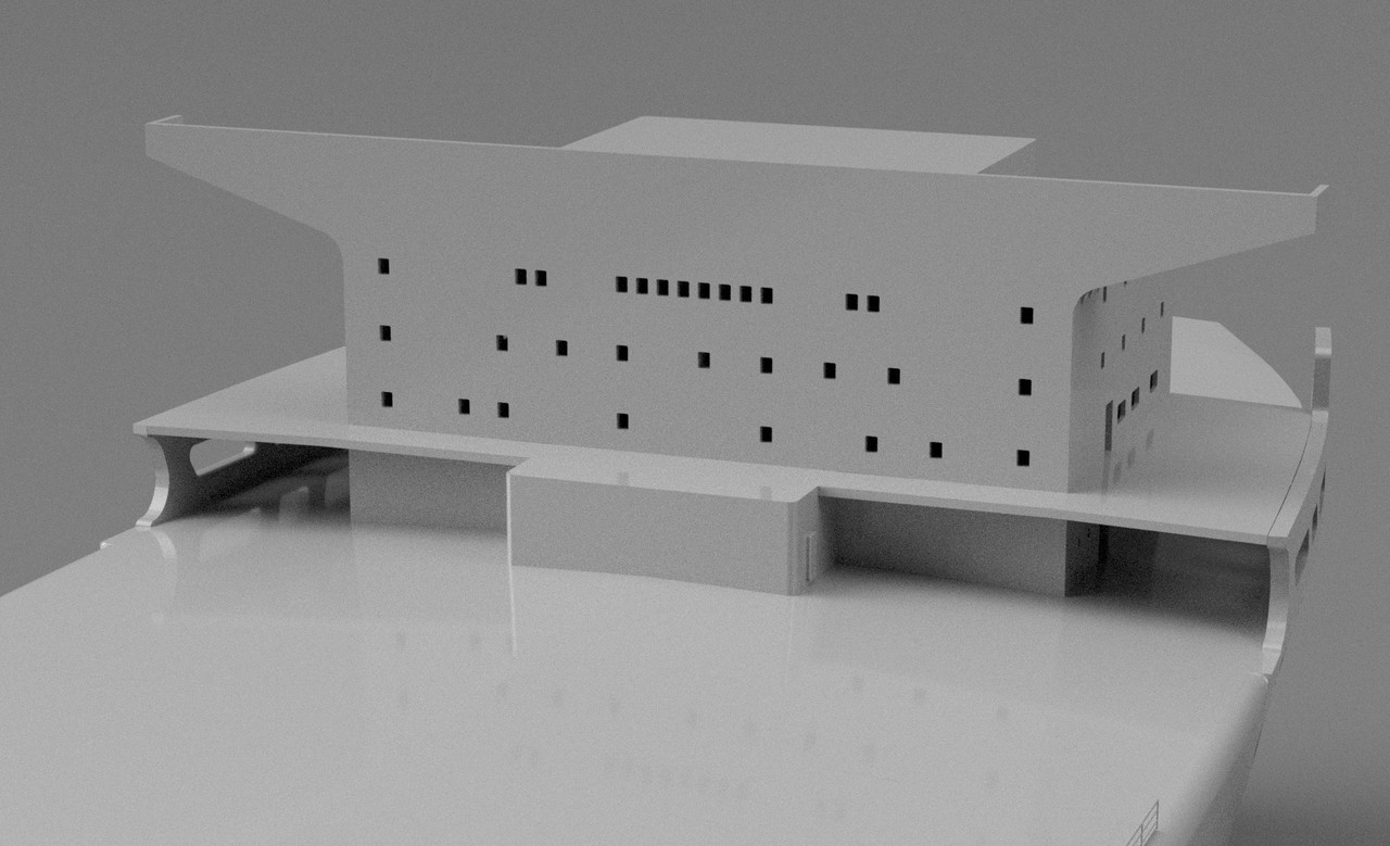

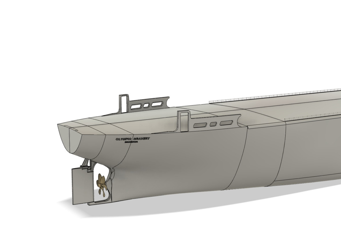

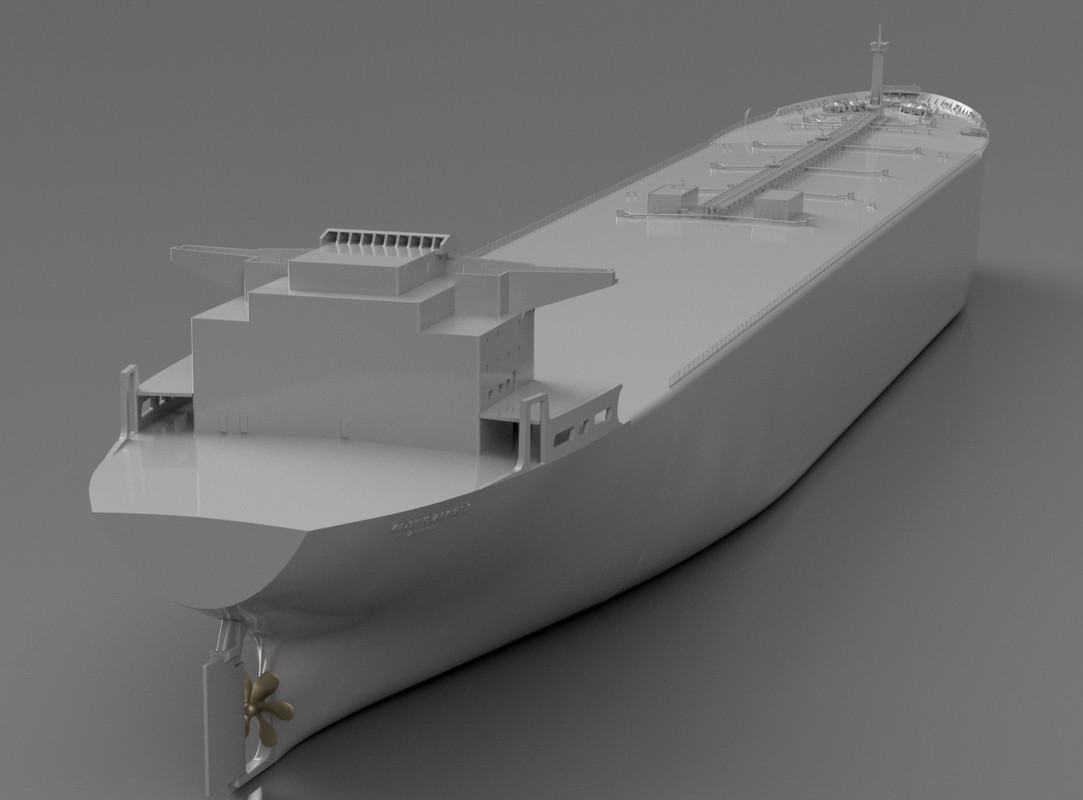

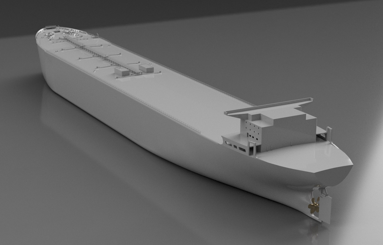

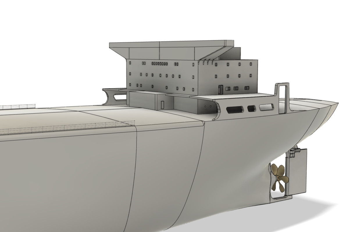

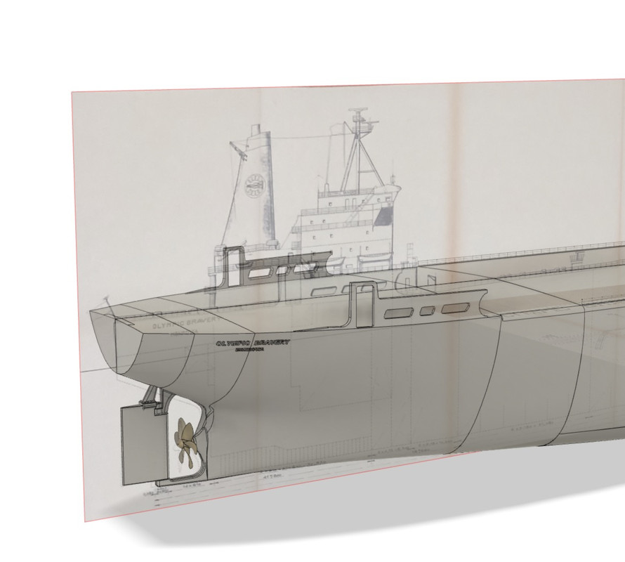

I started the drawing of the castle, the two stores bosun/pumpman are drawn.
I also assembled the central part to the front part. I used my car body filler and then sanded.
I'm getting the Revell Enamel spray primer tomorrow from french retailer.
Pascal

Progress of the day.
Pascal
