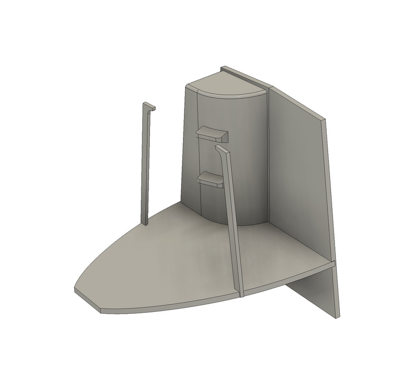

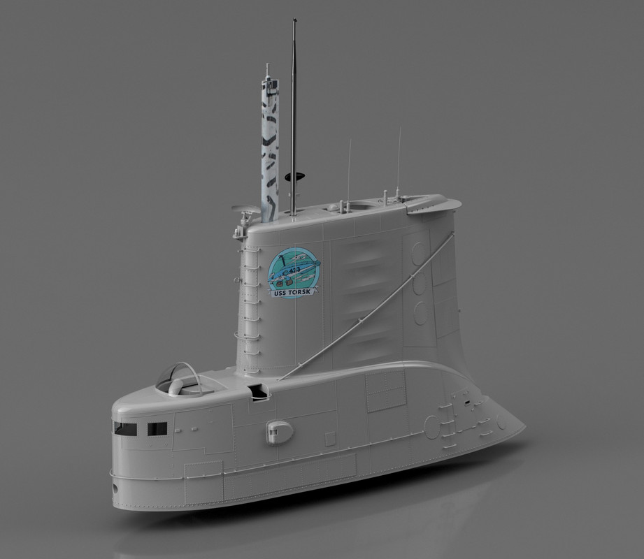

Today's progress on the top of the sail.
I have some modifications to apply on the front periscope n�1, for the rest it seems to hold the sea.
The antenna with the bulb is a VLF antenna,( Tks Mike).

Nice job on the Snort! Later iterations of sub sails moved the "bridge" higher, to the top to better stay out of the spray. Earlier the bridge was directly on top of the coning tower allowing quick evacuation of the bridge. Later on with better detection gear the need for a cash drive was considerably reduced.

The antenna with the bulb, if you mean shaped like an American football, is a VLF Loop. It allows reception of VLF radio broadcasts while the top of the sail is 10-15 feet below the surface without having to expose an antenna above the water. It is Omni directional and receive-only.

Here is a link to some info on VLF loop antennas for sub use, they look a bit different with a horizontal unit with a low profile fairing.
http://cdn.thomasnet.com/ccp/01150582/110357.pdf
Interesting discussion!

Tks Mike for this information. I will modify my message.MPERRY wrote:The antenna with the bulb, if you mean shaped like an American football, is a VLF Loop. It allows reception of VLF radio broadcasts while the top of the sail is 10-15 feet below the surface without having to expose an antenna above the water. It is Omni directional and receive-only.

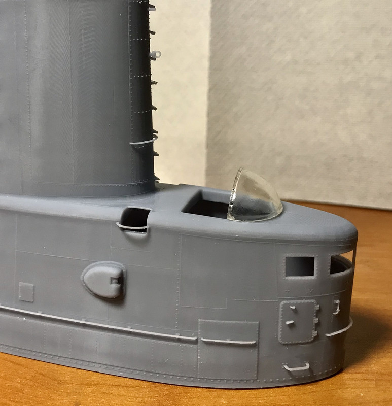

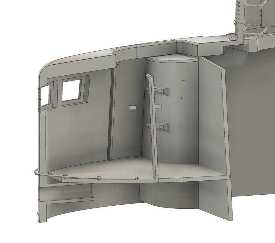

I added some details. I reduced the surface of the fin.

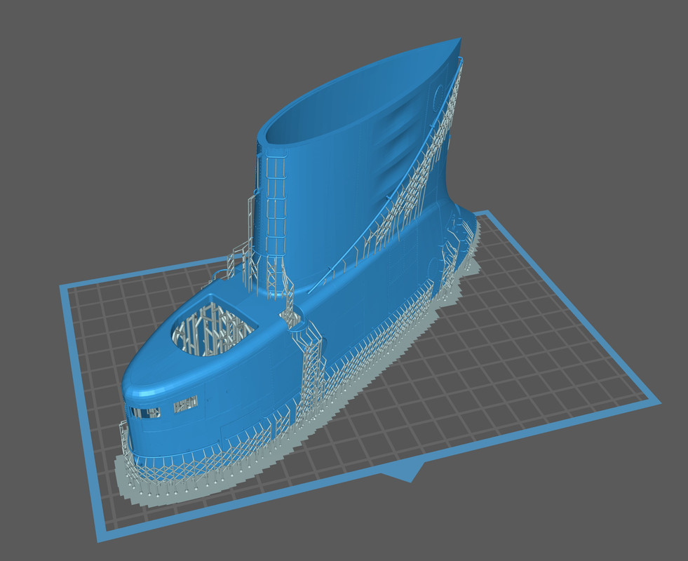

Then I started the test printing of the top of the sail without its accessories which will be printed separately.
This part is tricky to print correctly. I am also printing it with 20 micron layers.
Who will be the winner? �

As always, when printing, it's not a push button procedure. With launching a rocket, a lot goes into preparation for success before the button is pushed and the outcome awaited. It does seem a good idea to print several to ensure against the many possible failures. Orientation is always a big consideration, sometimes to help the printing process, other times a certain orientation will allow fewer supports, which can be difficult to remove from a complex part. In this case you have chosen to produce this as a number of separate parts, useful as some parts may be difficult to realize.

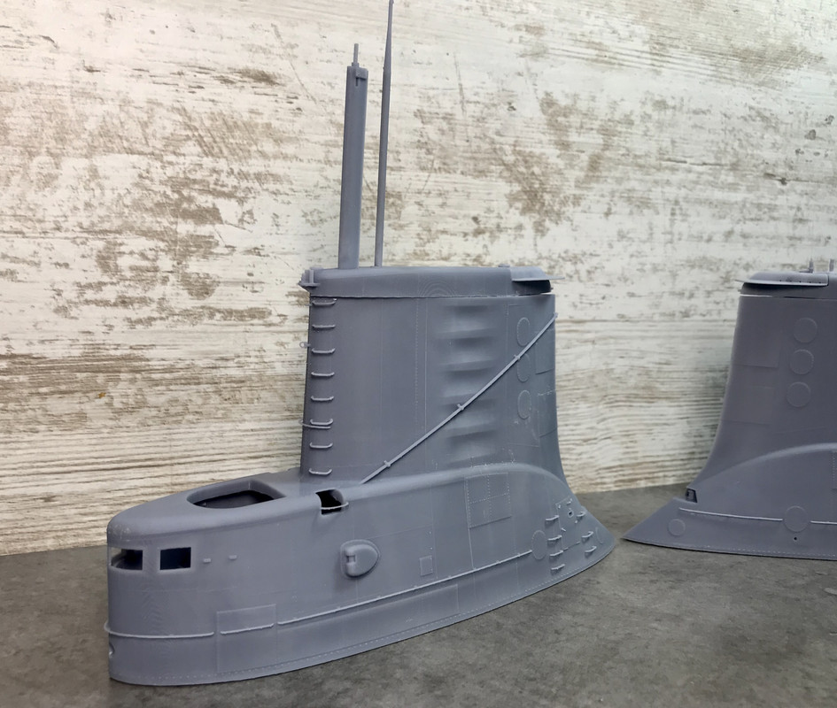

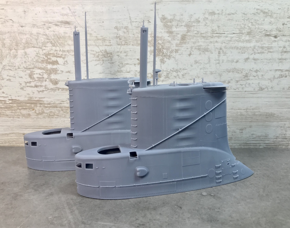

The prints went well. The top of the booth printed with an angle comes out the winner, but the horizontal one is not bad either, but you can see more the 20 micron layers.

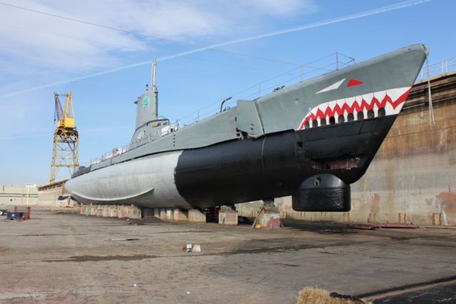

I'm looking for the camouflage measurement from the era that was prevalent for USN subs, year 50 to 70.
AK proposes this:
The museum photos give a slightly bluer gray if accurate.. So I have a doubt.
RC258 Dark Sea Blue
RC220 Light Gull Grey FS 16440
RC222 Insignia White FS 17875
RC231 Field Green FS 34097
Advances on 3D printing:
I have the #2 periscopes to reprint, with a bigger internal hole, because it got clogged, so I can put a piano wire through it to prevent it from bending, which happens with this kind of resin part.
For the periscope n�1, I was able to put the rod. It won't move anymore.
I mount two of them. One for me, the one on the right,
On the left you can see the parts that make up the top of the clump, I'll leave it to my friend Vincent to assemble it, it will be easier for the painting.

Good looking parts. Doing masts and booms I had best luck with the thinner resin, but even such the holes would tend to clog. With the semi transparent rapid black i was using one could see the clogs, I had to begin by running the wire back and forth before the resin began to dry. Bubbles could clog the holes! But yes the wire reinforcement is a great reinforcement and with some resins the piece will shrink around the wire with drying and curing. Advantages in working with a larger scale.
Thanks for the update! Tom

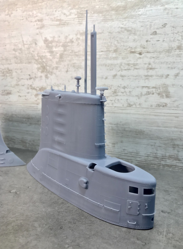

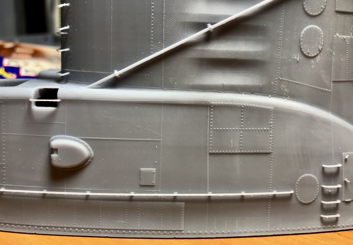

TKs Tom for the trick!
Problem of the periscope N�2 solved, reprint with a larger hole, the piano wire fits by itself. The solid now, I left a little more gap for it to fit with the paint.
The sail one came out very well without a hitch, in one piece, like what, you have to spend time on the whole process.�
The porthole and the bubble will be printed separately in translucent resin.
By the way, I tested Bernard's friend method which consists in repainting the resin transparencies with a glossy varnish, the result is unexpected, no more yellowing and you can see through. Thanks for the trick.
I'm going to test this method with a professional high gloss car paint (2K) in a spray can, the result should be even better than with Humbrol.
Nothing is stuck yet.

For the paint I found some interesting things while searching as always, but it's never easy:
The grey is probably modern Haze Gray. Do not confuse with Haze Gray ww2 type 5H.
http://www.navsource.org/archives/08/08492.htm
A brief illustrated history of submarine camouflage:
Excerpt:
"The decade of the 1950s saw a return to the overall black of pre world war 2 days. The changes took place in a peacetime environment, so individual boats may have started the period wearing a #27 haze grey and progressed through dark grey to black by 1960 with the color being changed during each yard refit period. Refits usually took place on a 3 year rotational basis.
A particular boat might be in light grey at some time during this period while her sister, fresh from a yard period, would be in black. There were also special cases where paint was changed to match specific circumstances.
For example; in 1958 Halfbeak (SS-352) was painted white for arctic operations and submarines assigned to the Sixth Fleet in the Mediterranean were often painted in lighter grey because the color was regarded as more suitable for that environment. Entemedor (SS-340) is known to have been painted in light grey as late as 1969.
I also noticed this interesting info while doing my research, a new LifeColors set has just been released for the following period including UA 655 US modern Haze Gray:
Here you can see the size of the sail which takes up the entire large width of the Photon Mono X's tray. 190 mm long.

3D printing of the bubble of the quarterdeck.
I printed several bubbles and ports to test the varnish, method recommended by my friend Bernard to remove the yellowing of the transparent resin after printing and give it much more transparency.
The best method after test is to paint this bubble with 2 or 3 coats of Humbrol gloss varnish n�1 and then paint again once dry with 2 coats of 2K professional body shop varnish. The Humbrol paint is used as a primer, because the body shop varnish had a tendency to react by making micro-craters with the resin. Humbrol gloss alone is not satisfactory. The 2K varnish stretches much more and is super smooth and shiny.
I am currently reprinting bubbles and scuttles with the Phrozen Mini 4k but at 20 microns instead of 50. This printer is dedicated to transparency.
It is good news to know that you can print good quality canopies with this process.
I plan to print seaplanes one day and I will need cockpit canopies then.
I think there is still room for improvement in transparency. But it's not bad.
You can see the difference here on the left, without Humbrol varnish, only 2K.
Here you can see the ports at the print output, not varnished. They are yellow and opaque.

Well, this is it, the floor of the kiosk watch room of this submarine is the final point of this exciting drawing/project of this sail.
I didn't go into too much detail on this part because I only have one picture of the interior of this place.
I will start the sonar soon and then it will be finished.
Oil canning galore! �:D
