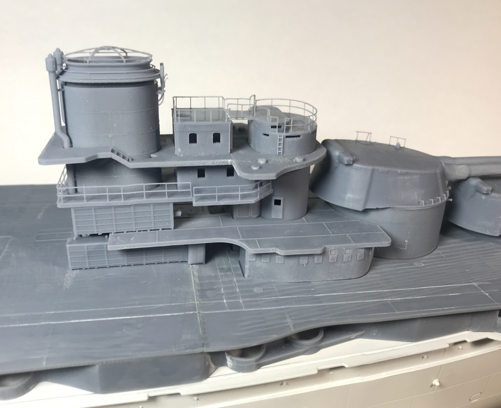

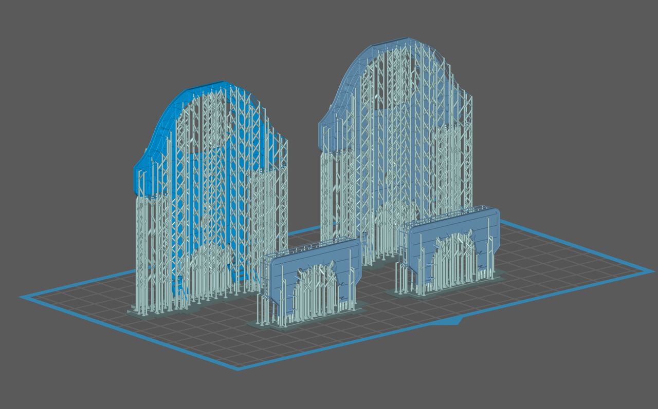

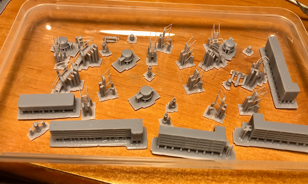

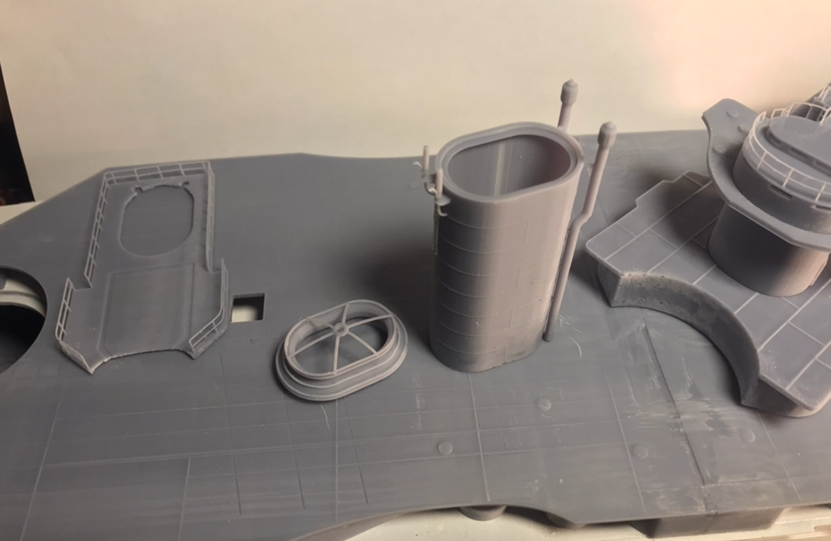

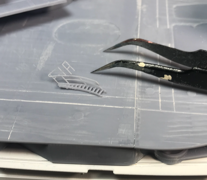

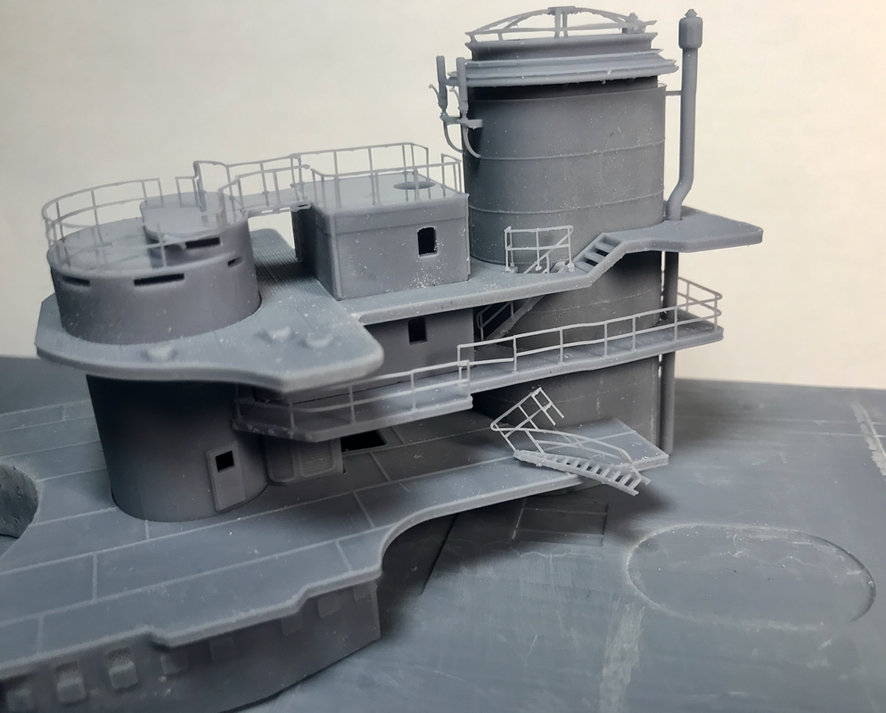

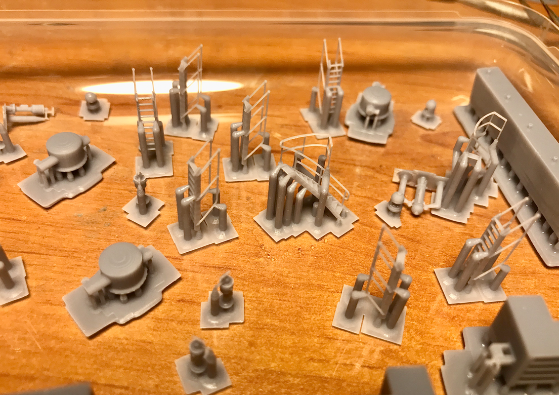

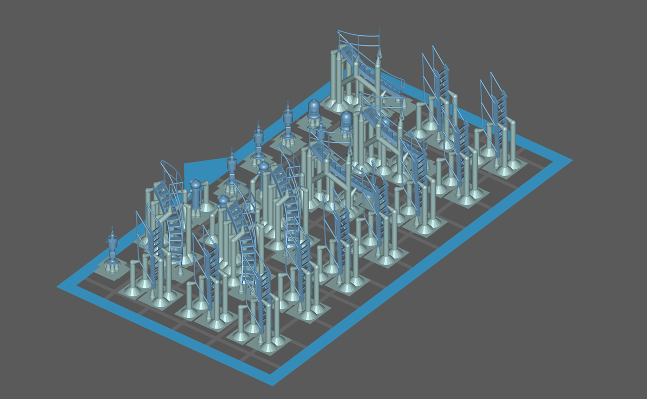

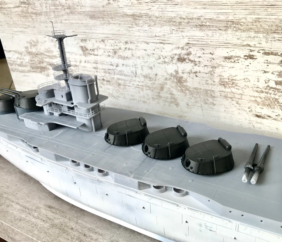

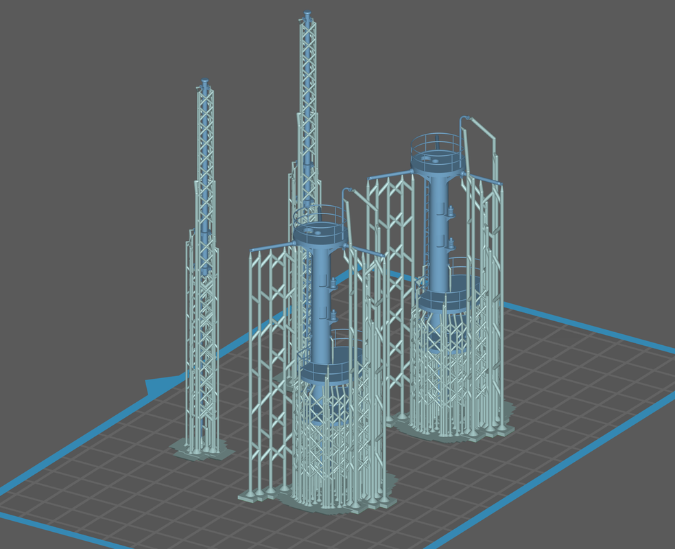

Printing again of the stack but in two pieces, it's even better, for the de-grappling and the painting.
Printing also a lot of small parts, and the protective railings, but which are also used to store life jackets and not hammocks as said above.
The spiral staircases are very well done, very fragile. The more classic ladders too are nice.
Reprint of the bridge with the railings, but in two parts.
Up:
The famous railings:

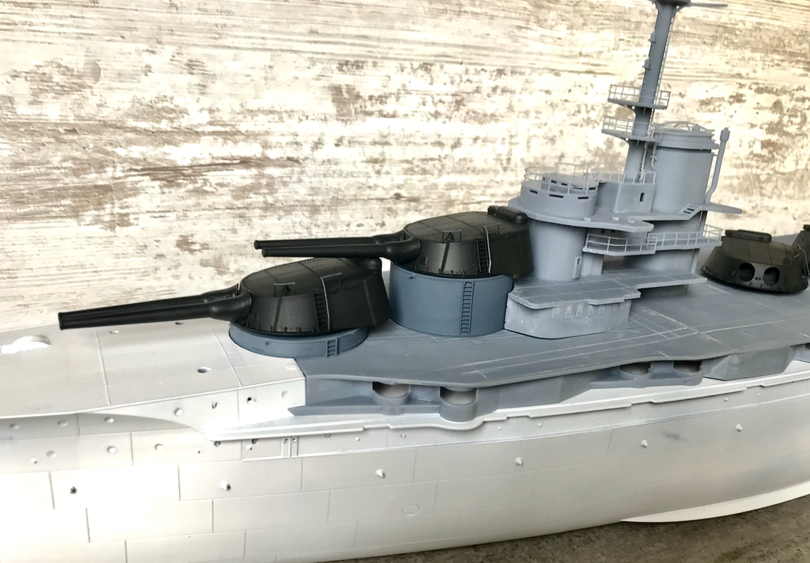

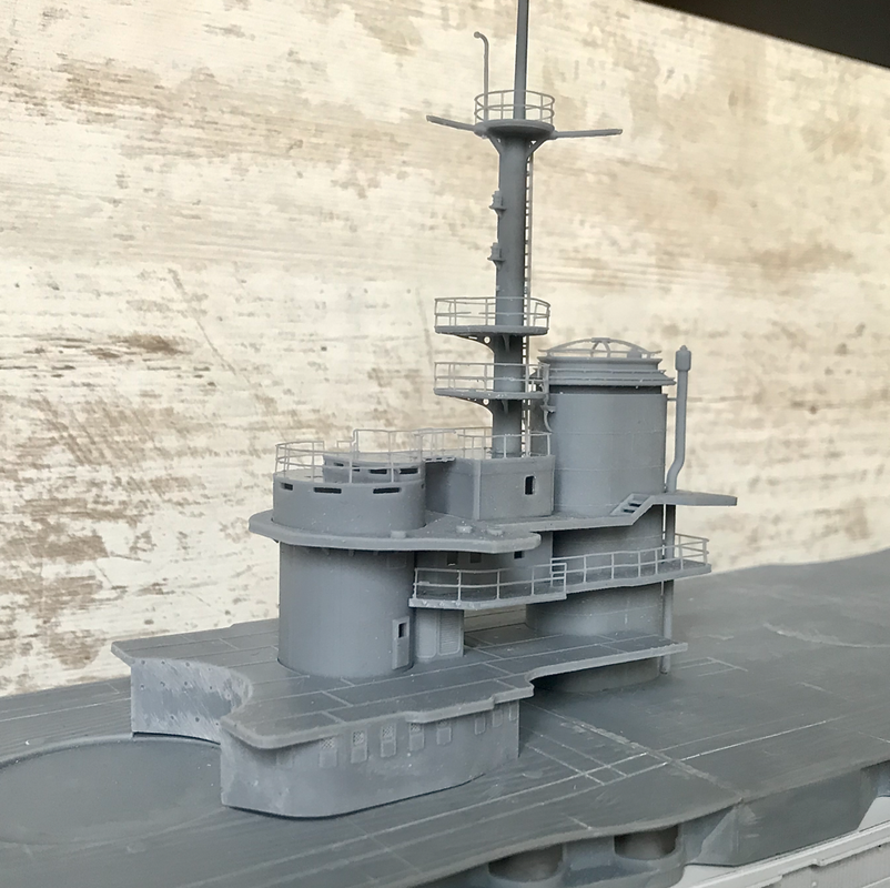

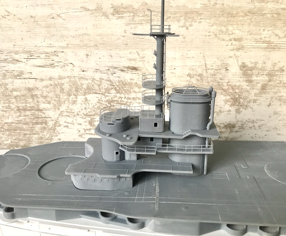

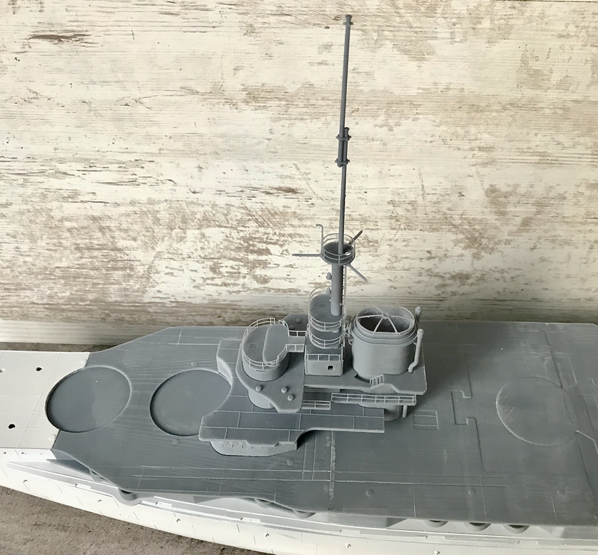

Printing the front mast in two pieces.
I reinforced them with piano wire inside.
I have a few minor repairs on the rail, not easy to de-grapple.
Pascal

Indeed the masts work quite well hollow with piano wire, it's rather amazing how thin walled the mast sections can be printed as long as one keeps the passages clear before the bubbles and whatnot harden.
Those masts look good! Always useful for the rest of us to see how you arranged your supports, a critical part of printing!
Best regards! Tom

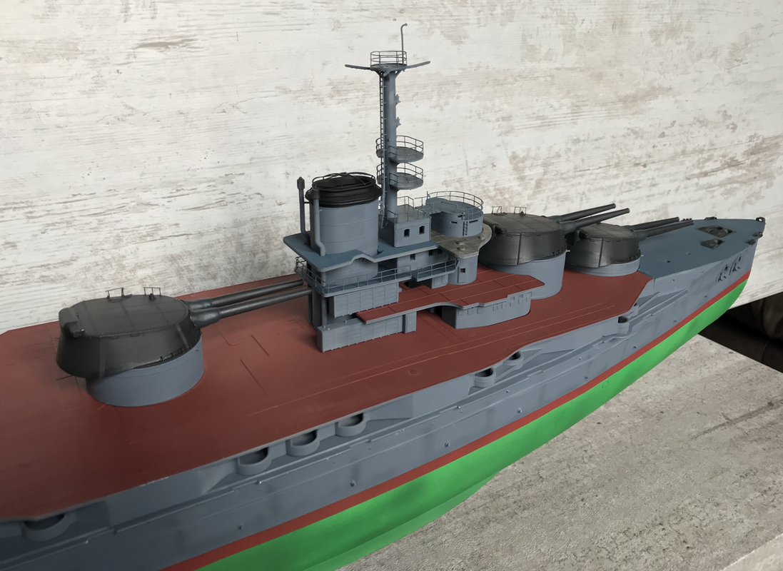

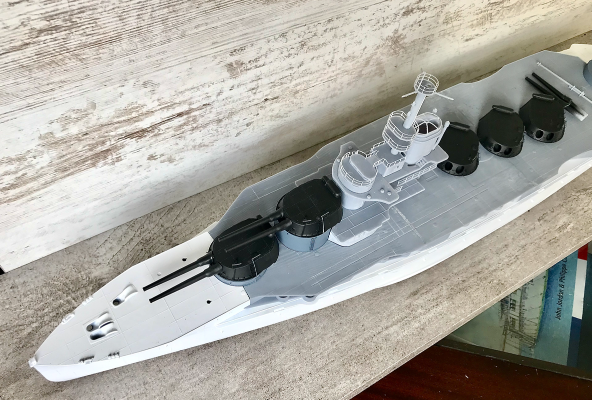

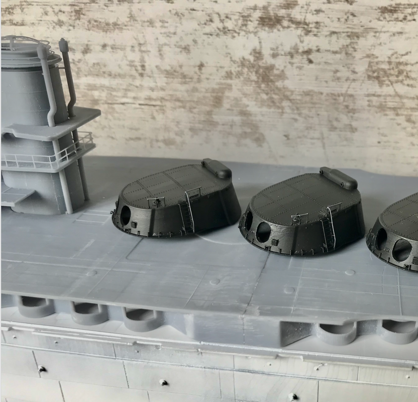

I printed a new mast. :big_grin:
Painted the turrets, anthracite grey matt N°9 Revell and medium blue grey matt 144 Humbrol.
I like it.
Pascal

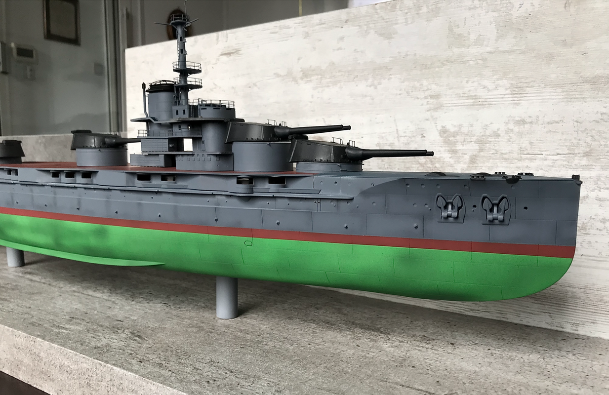

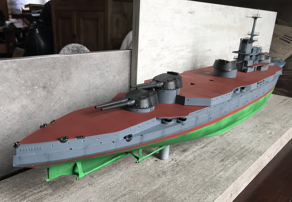

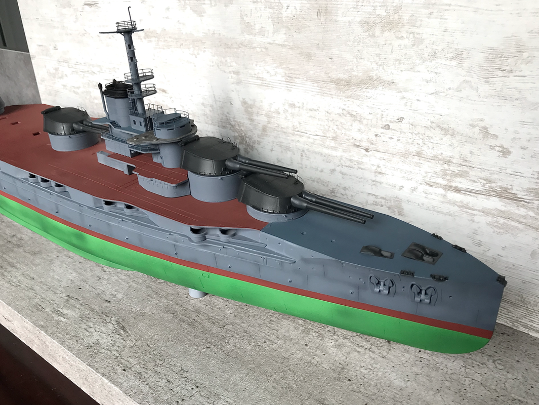

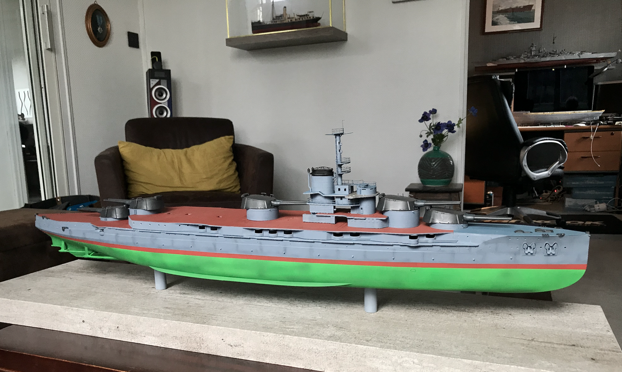

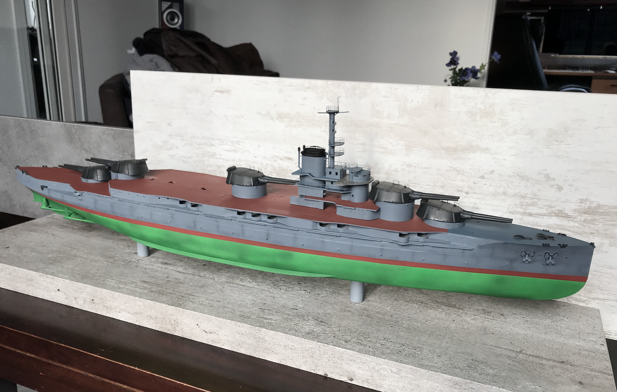

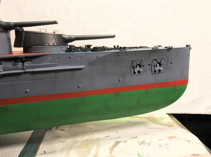

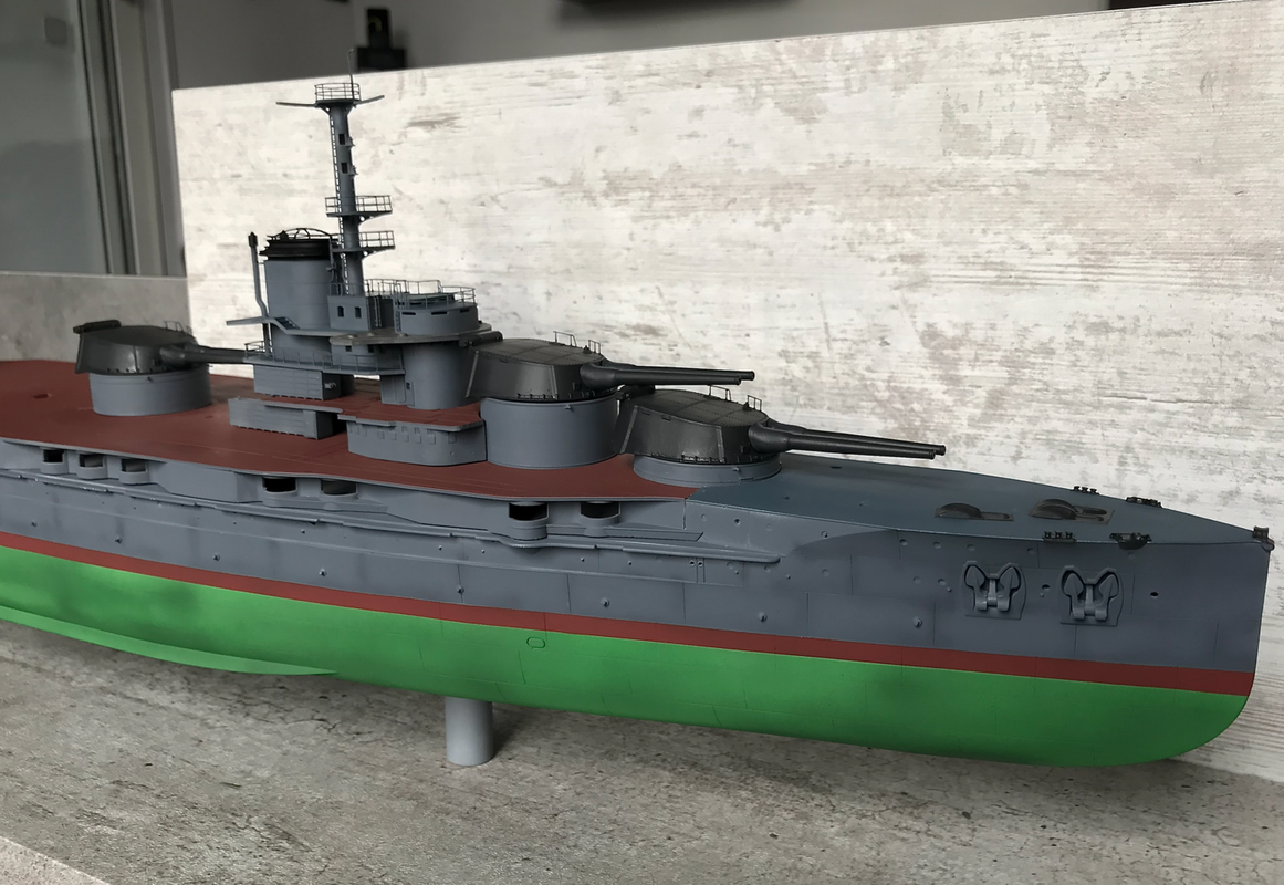

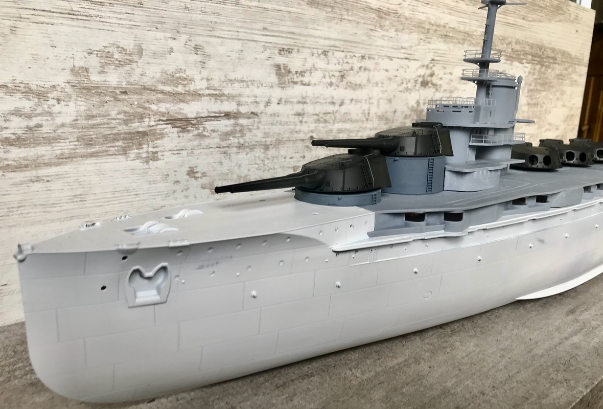

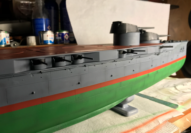

Some pictures of the progress of the painting.
I used Humbrol 144 matt for the hull and superstructure.
Humbrol 96 matt for the steel decks.
Revell 37 matt for the linoleum decks.
Shading with N°9 matt Revell anthracite. Turret also with N°9, chimney top with Revell matt black n°8. The straps are a little lighter with a mixture of Humbrol 9 and H 144 grey.
For the hull, first layers with Humbrol 37 matte green, then SM364 Revell green.
I still have to work on the hull which is too light for my taste to get as close as possible to the "Vert de Paris", I have to add some shading around the sheet metal plates before reinforcing the SM364 green to darken it slightly. But for now the effect is the right one, I don't want a uniform hull colour.
All this in anticipation of the ageing of the whole.
Nothing is glued yet.
The problem was that the Humbrol 37 green doesn't cover anything, it's water, first time I used it, I used up 1 and a half pots for the coat.
The SM364 green covers well, so that'll do it, but then my shading took a hit, so I'm going to redo it, then 364 again, then a coat of clear matt after aging to immortalize it.
The red surface corrosion protection strip is painted with Humbrol matt 60 which I mixed a bit.

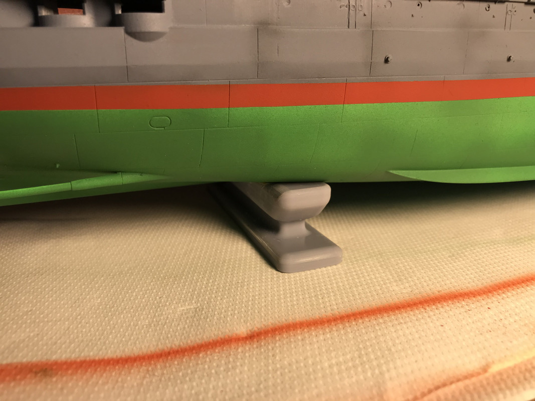

I printed out work supports for the hull to avoid damaging the paint, they are aimed at the place of the supports of the final display. Practical.
Pascal

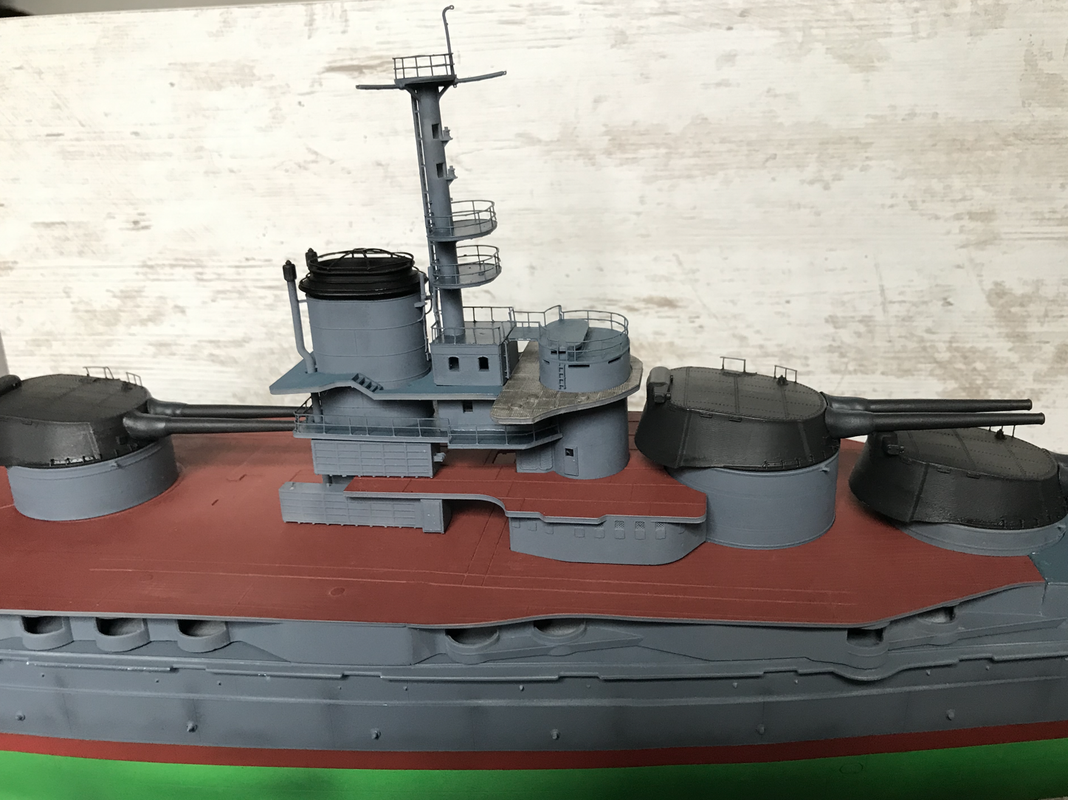

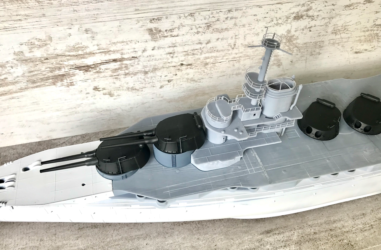

Painting, placing, gluing the fittings of the forecastle, everything is of course not yet in place.
Deck 2 is not yet glued, only the 140mm guns are.
Pascal
