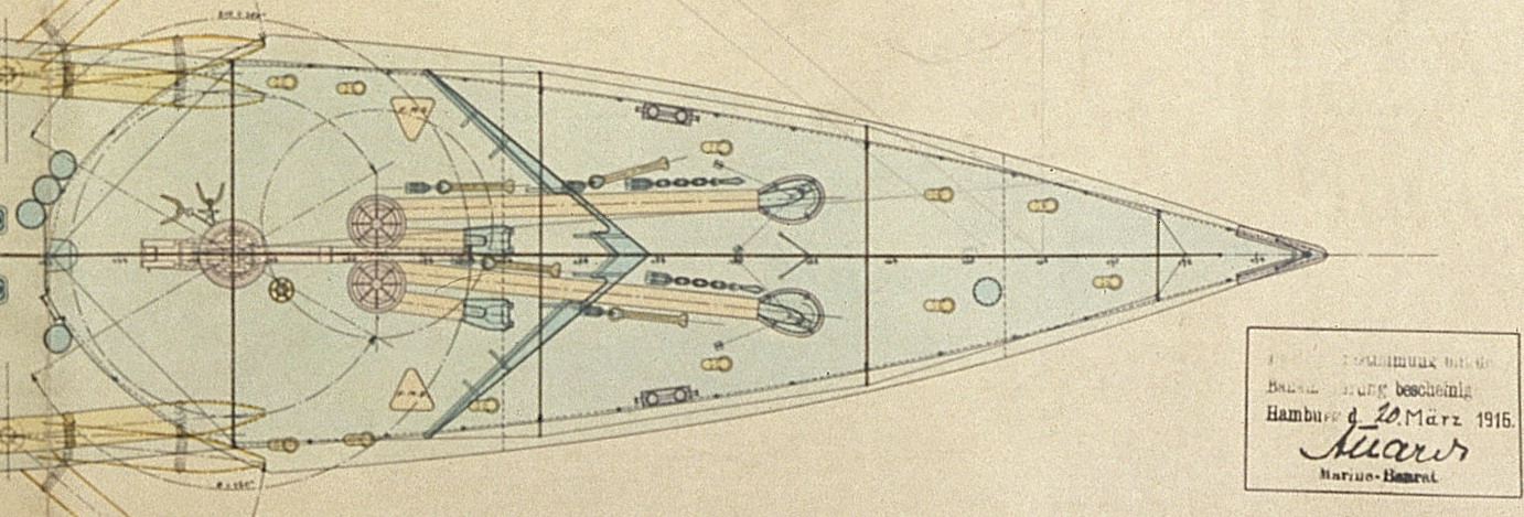

PostPosted: Tue Jan 22, 2008 3:58 am
Joined: Thu Feb 22, 2007 4:06 am
Posts: 322
Location: Berlin, Germany
Some questions on the plan:
What the heck are those things I marked with the red arrows?
And what kind of gauge/wheel could the blue one be?
Uli "Torpedo" Setzermann
http://www.marine-forum.de - Das Kaiserliche Marineforum
Currently Building: SM TrpBt B-110, SM TrpBt S-37
Upcoming: SMS Derfflinger
PostPosted: Tue Jan 22, 2008 6:42 am
Posts: 2557
I think they are called chain stoppers, when the anchor is up they relieve the pressure on the windlass.
