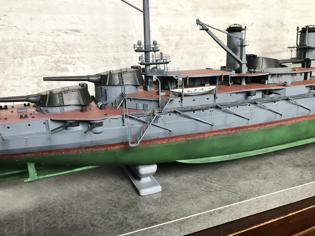

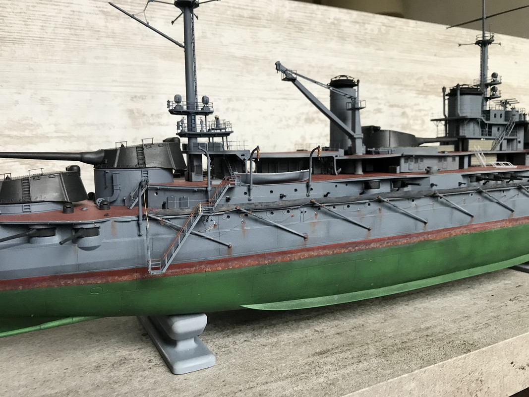

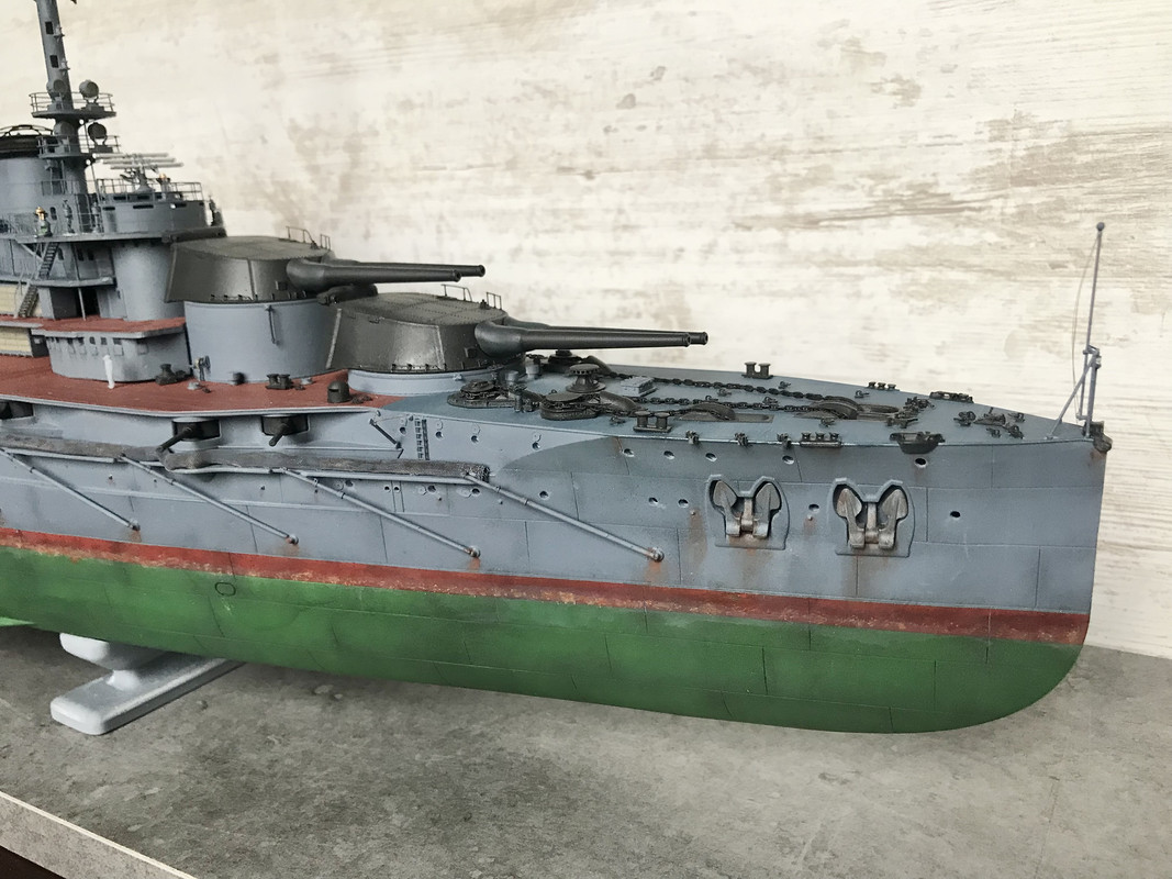

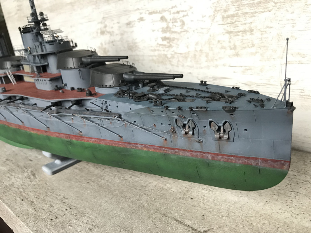

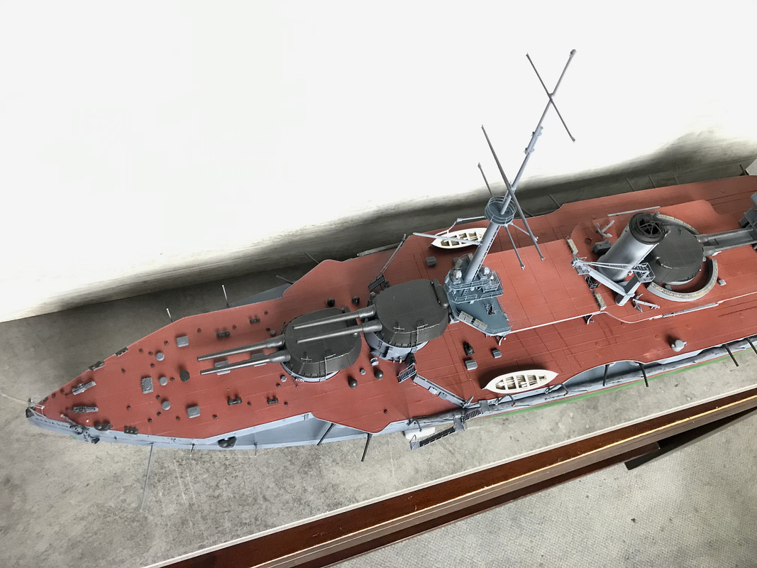

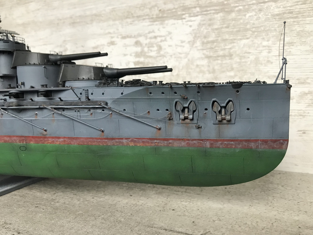

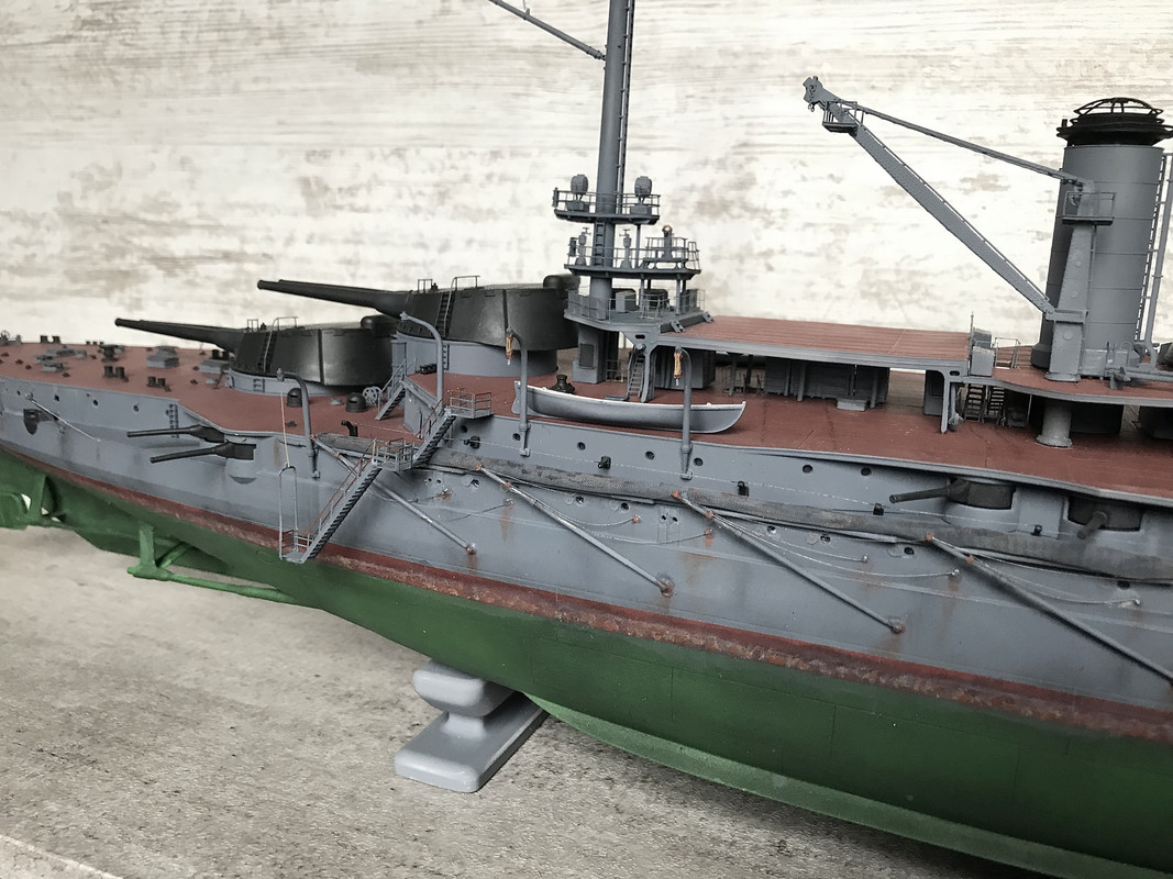

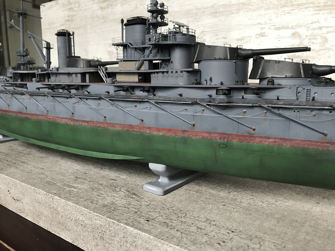

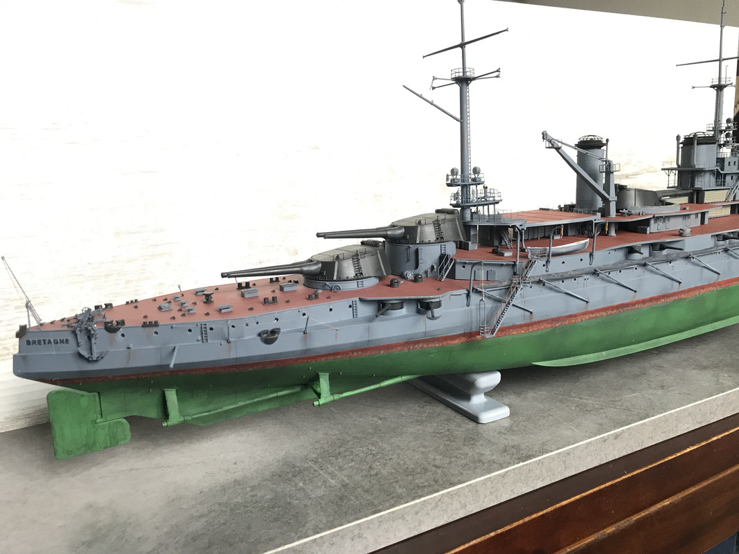

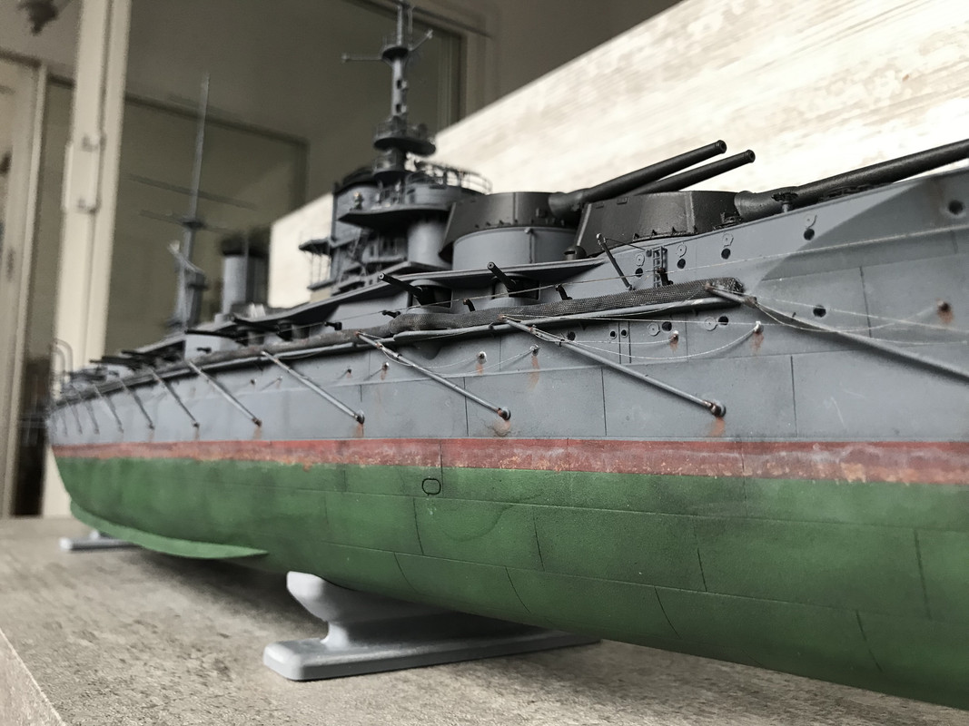

Some small progress, small details, gluing of decks, deck ladders, etc., the bridge is not yet glued.
Improved aging at the waterline.
Pascal

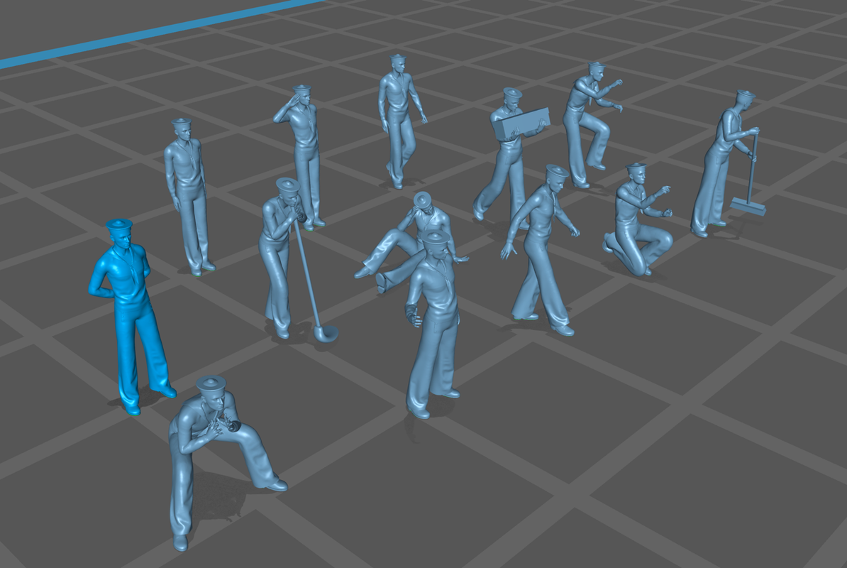

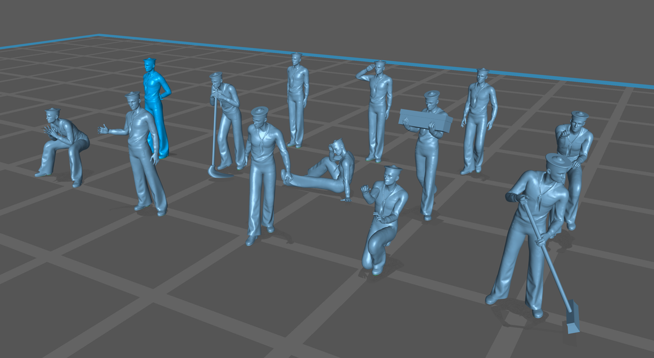

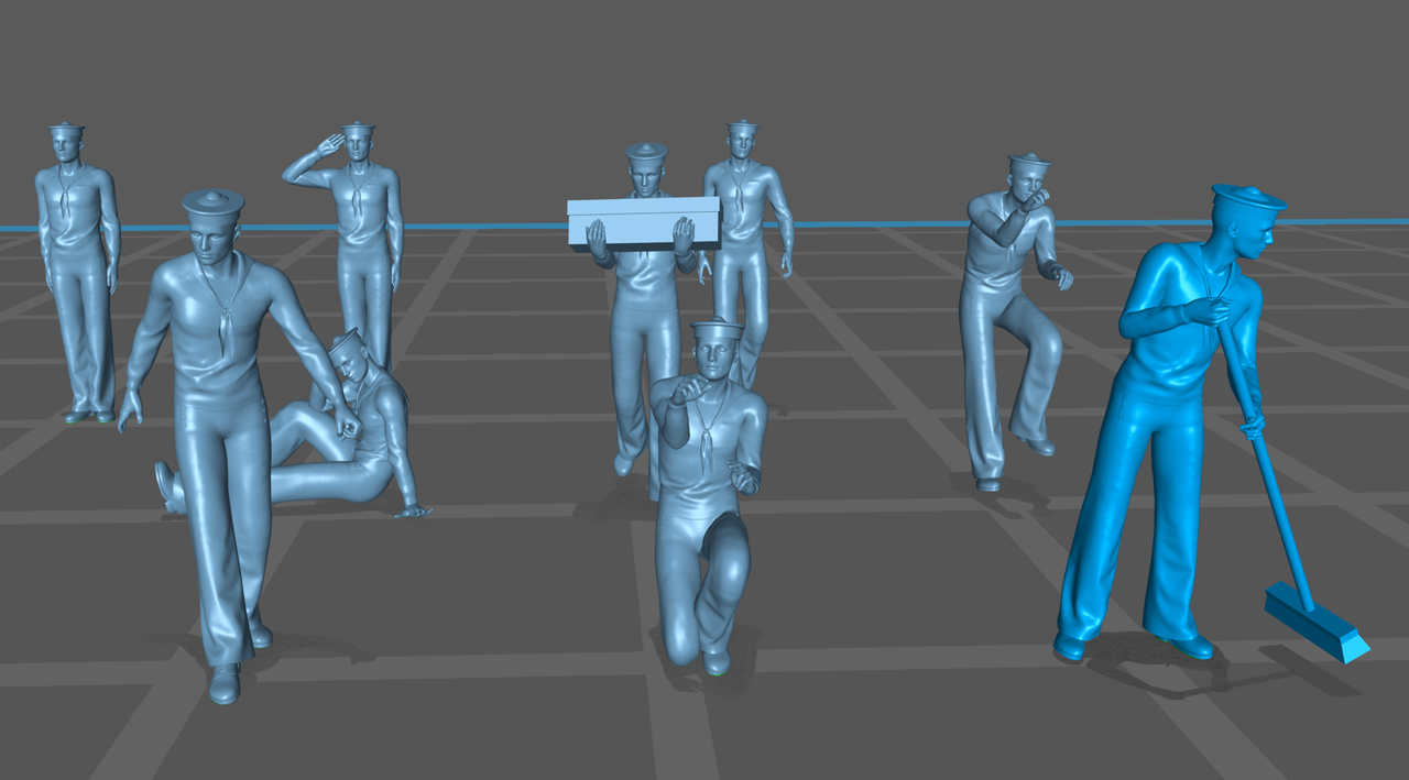

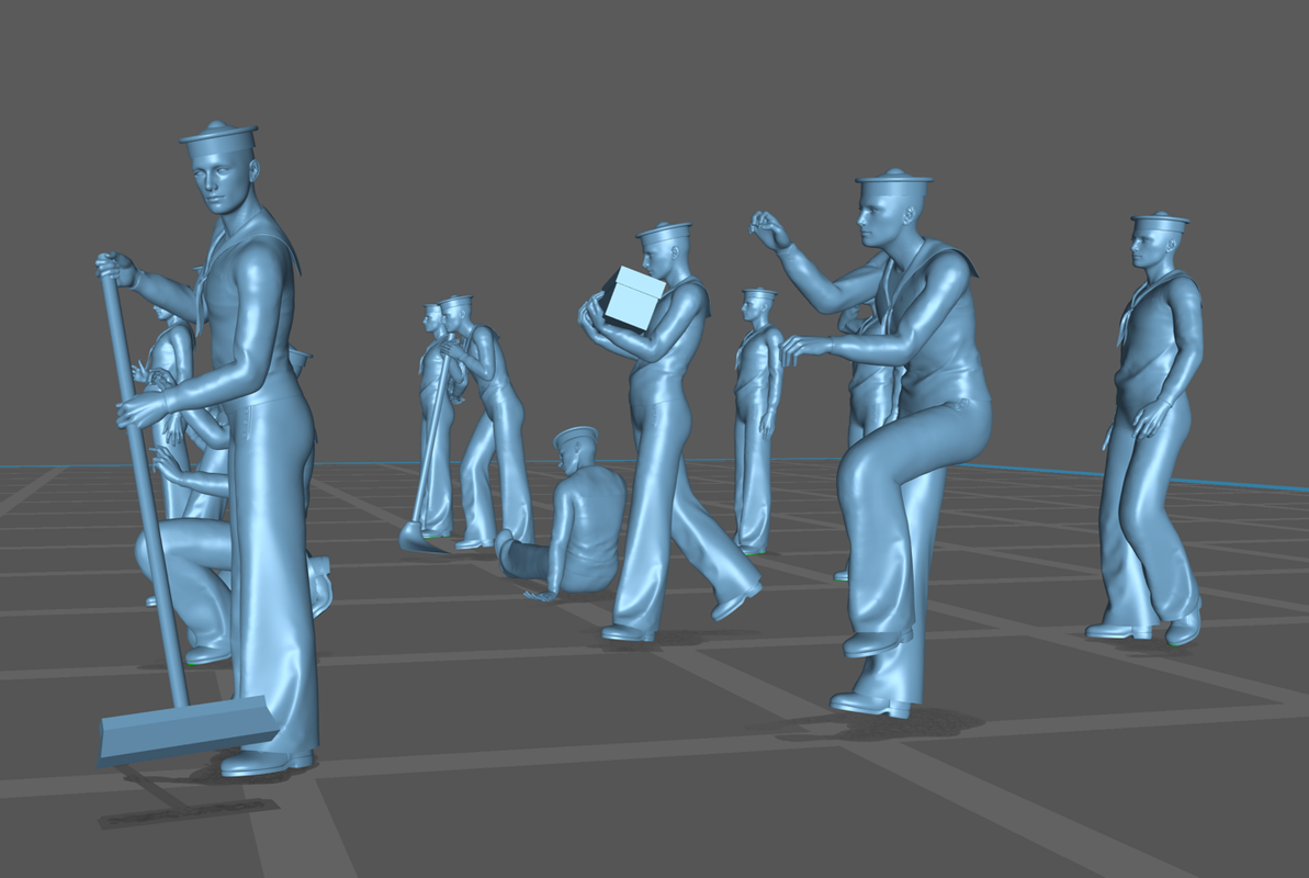

A batch of postures created this afternoon. I need to make another batch with figures with more stoutness. :big_grin:
Pascal

Looking interesting. I suppose one can also change their height and body type ? Not everyone was 6' and slim, particular the older ratings may have accumulated some girth.

Yes, of course we can do that, although humans were less big and fat or obese than now in percentage. But also less tall. :big_grin:
That's what I'll do for the next series.
Pascal

Indeed, on-board rations kept them slim ;) However, I was thinking of some pictures of older petty and warrant officers in the austro-hungarian navy that I have seen, who were decidedly more portly. I suppose it was similar in other navies before the times of obsession with 'physical fitness' and when an 'embonpoint' was a sign of socio-economic achievement and not a health detriment.

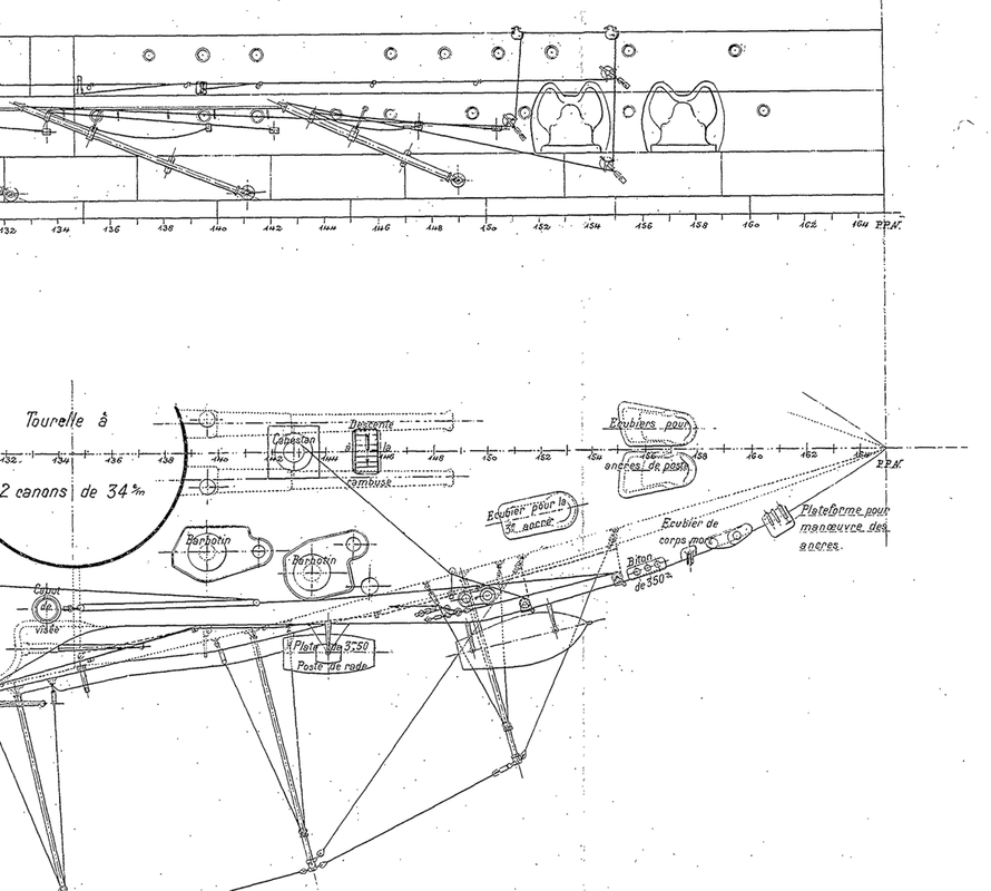

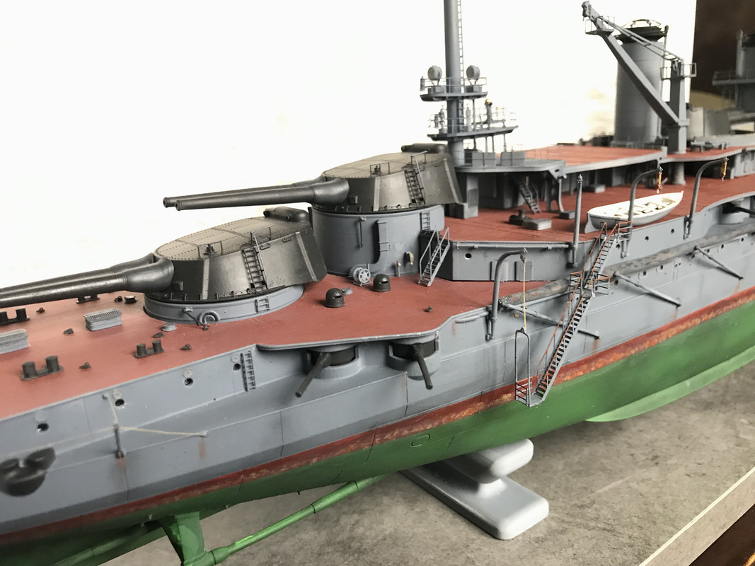

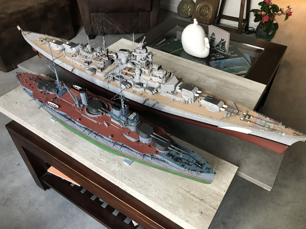

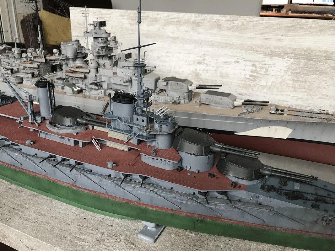

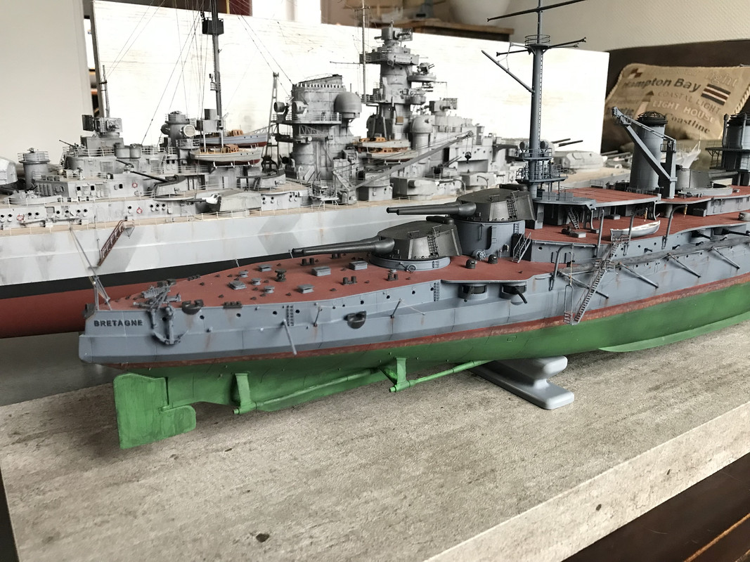

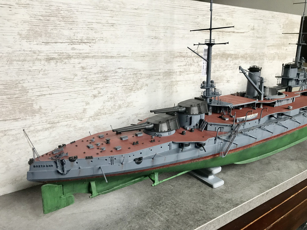

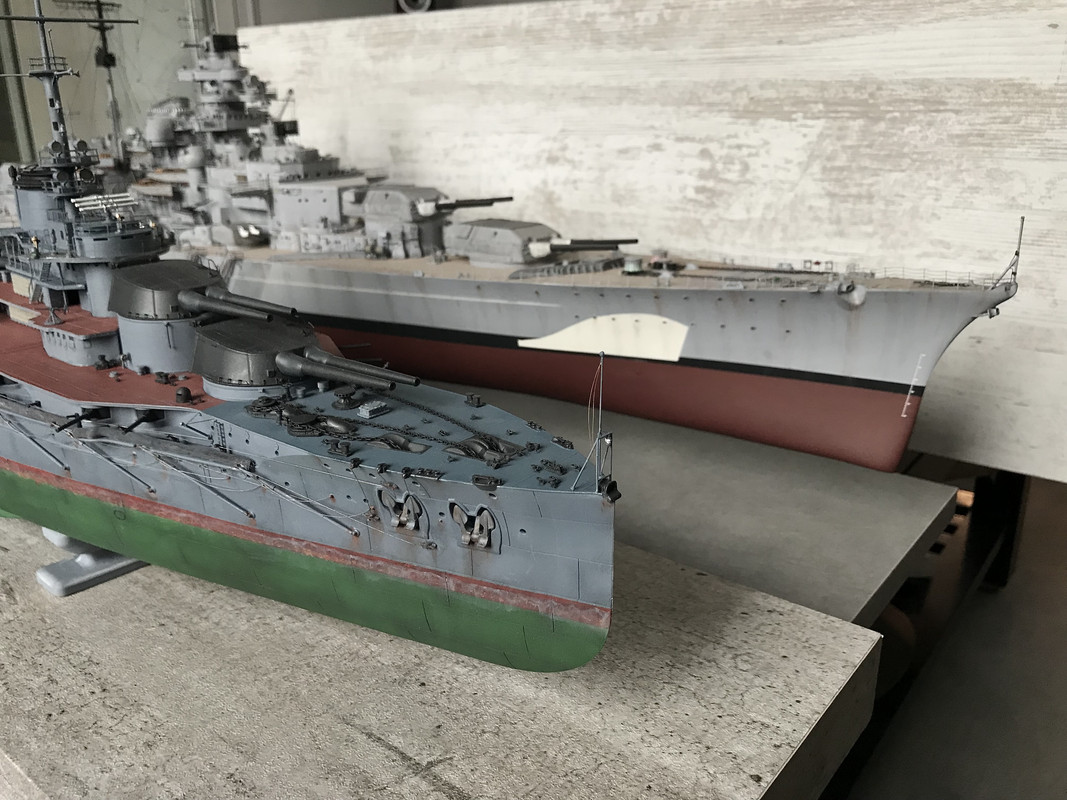

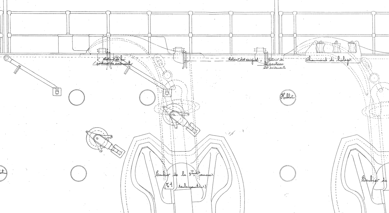

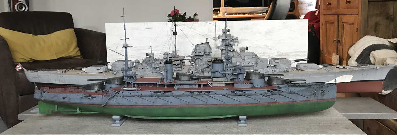

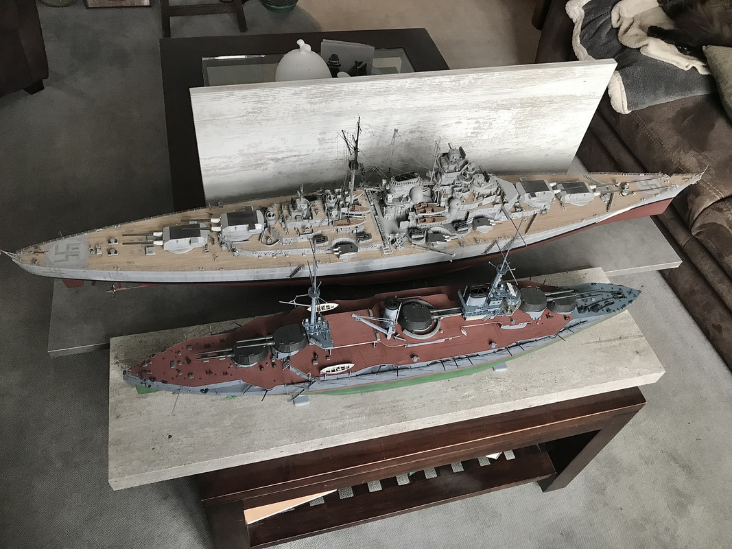

I spent 2 days on the cables that hold the spars of the Bullivant starboard anti-torpedo net. I drew, printed, installed the front pulleys, and the supports of the net's sea station.

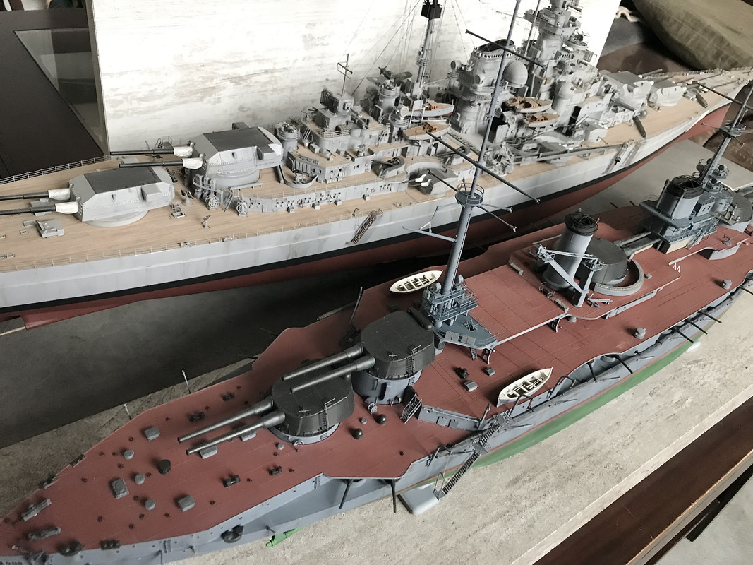

I had fun comparing the Bismarck and the Bretagne which are on the same scale. 20 years of evolution in design and shipbuilding techniques separate them.
viewtopic.php?f=59&t=314096
251 m for the Bismarck, displacement 41,700 tons: 166 m for the Bretagne, 23,500 tons.
Bretagne:
Lorraine:
Pascal

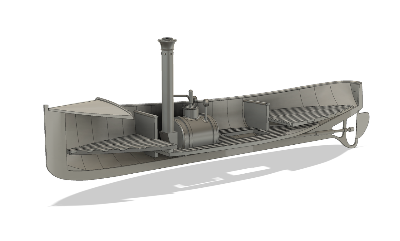

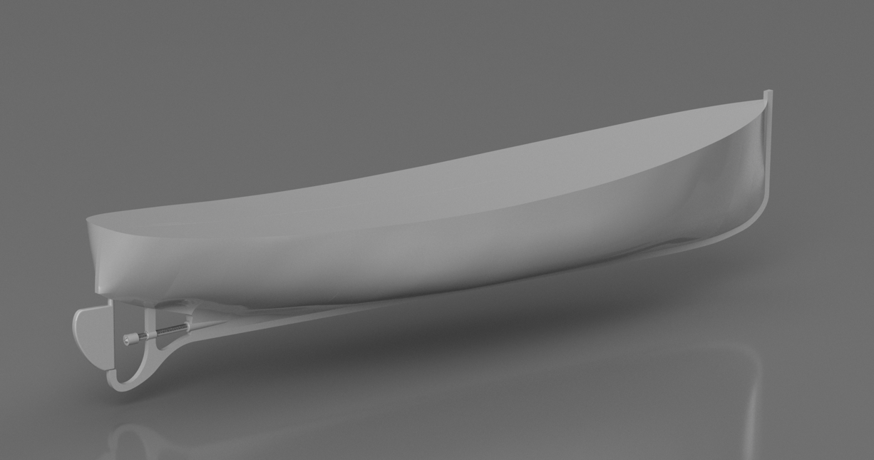

Posts: 1890
Location: Bretagne, France

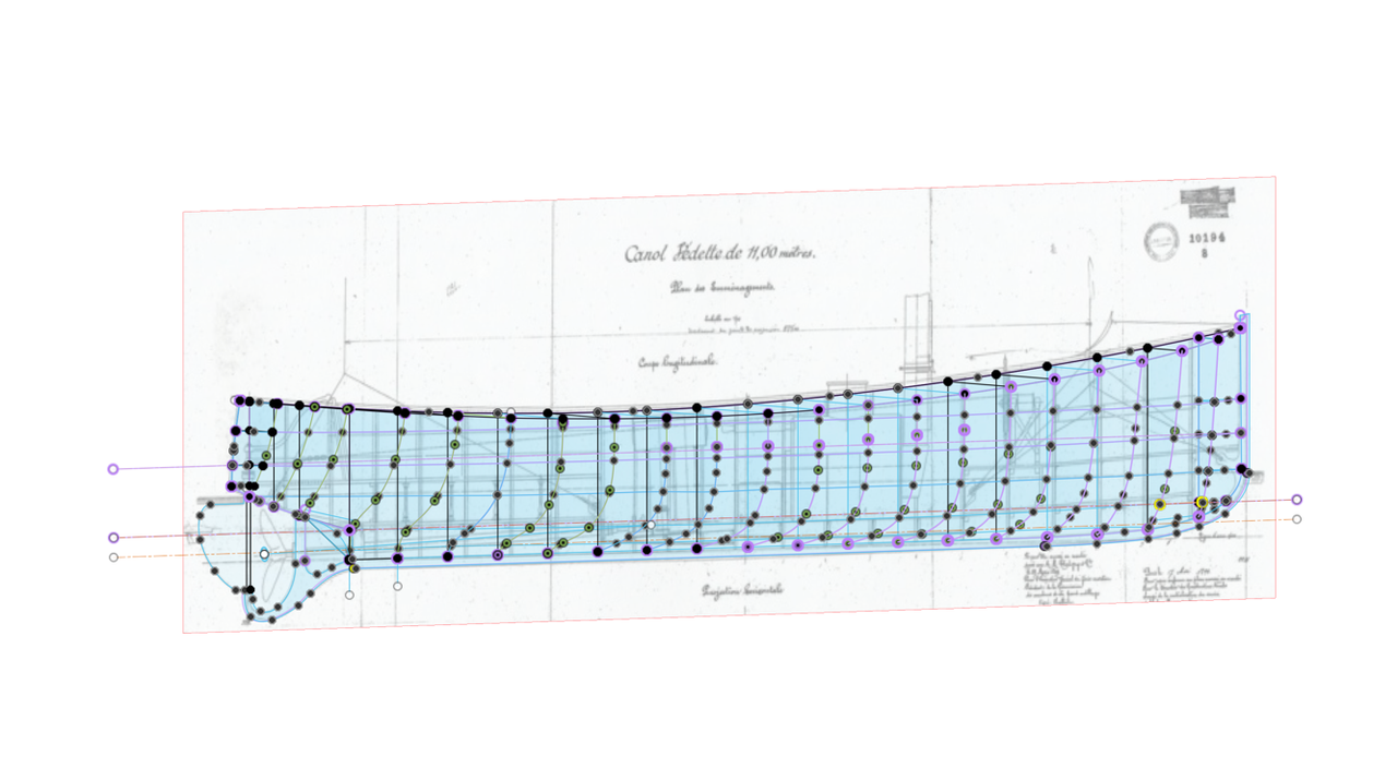

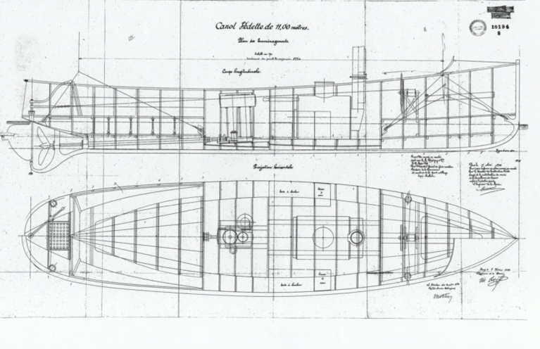

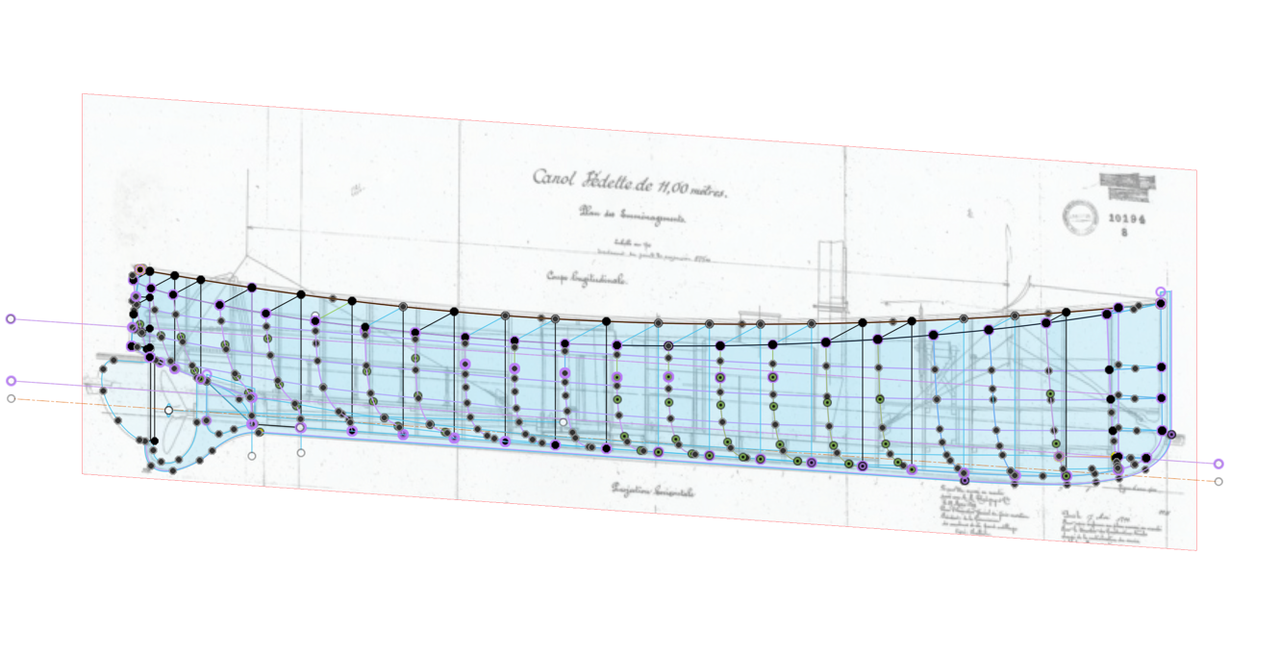

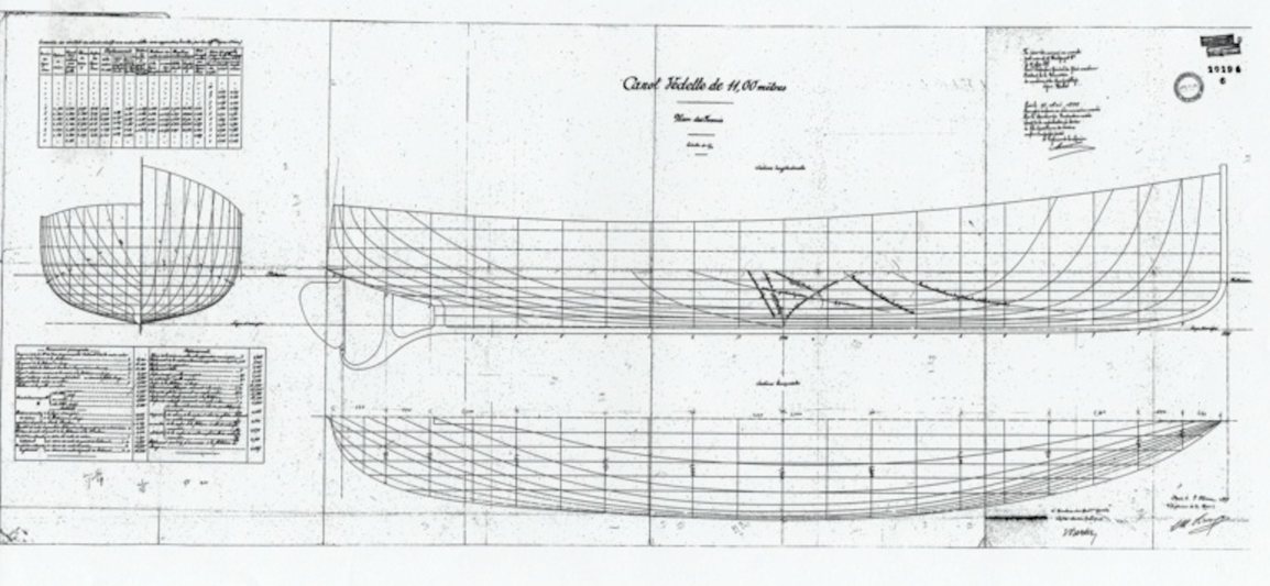

Back to the drawing board.
I have started to draw the boats, thanks to those who provided me with plans.
Not too many period photos of these boats in general. But if you look around, you can find some.

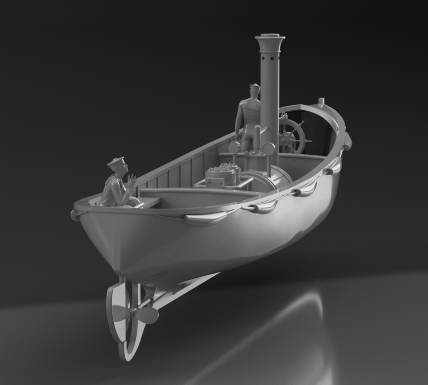

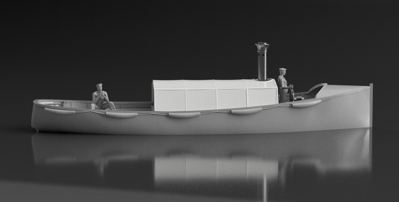

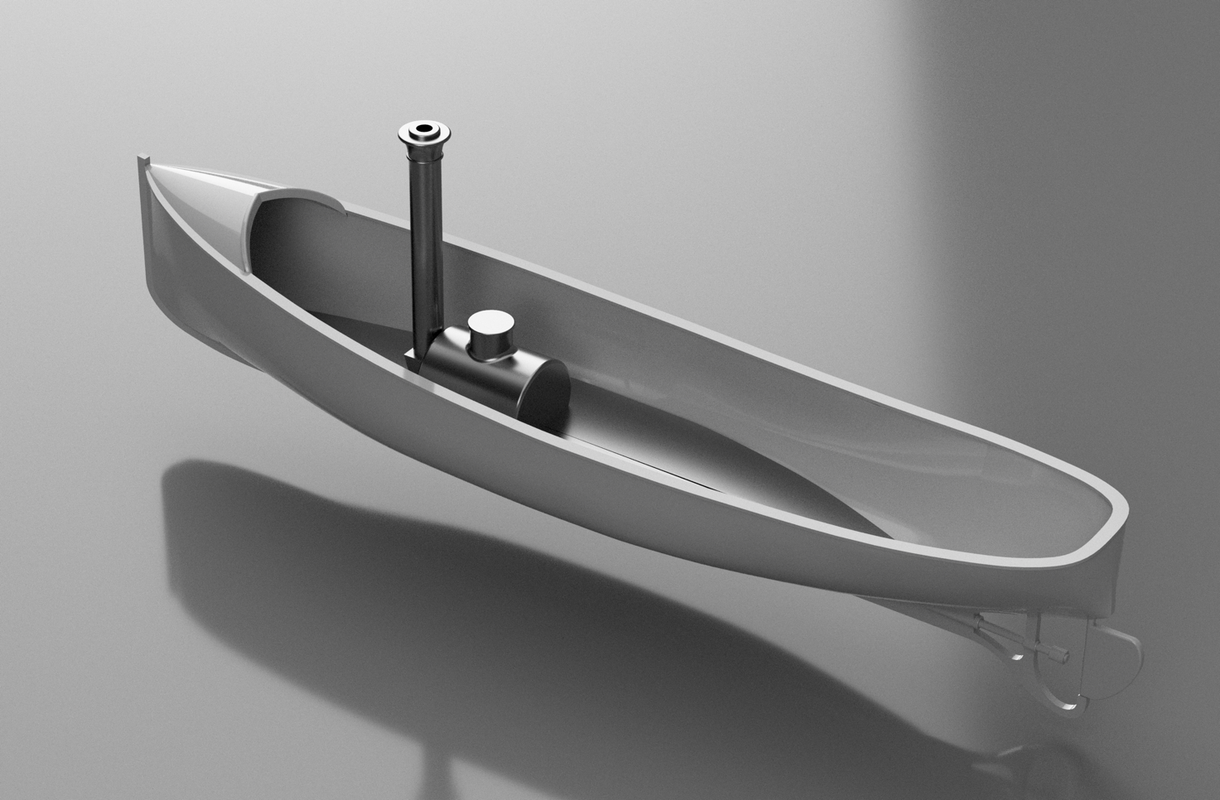

The 11mt steam launch to start with. It will be 55 mm long.
One day to get to this point, not too bad.
Pascal

Very interesting, as I am just working on a book on the German navy boats 1852 to 1918.

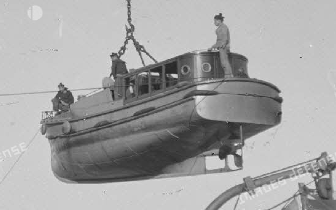

PostPosted: Tue Mar 14, 2023 2:57 am
Posts: 5579
very elegant-- you were quite well armed with photo information !
in your image of the two launches hanging the boat boom-
-the round bilge design is well reflected in the considerable angles of roll
in the seemingly not huge swell... ! :big_grin:

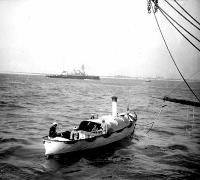

I can only admire the elegance of the lines of the steam launch-- I have similar looking boats on my 1/350 Bouvet
along with some sailing gigs-- did Bretagne carry sailing Gigs? ( pardon old fuzzy photo)
here is a maybe useful image ( certainly well loaded !!! )
The steamers carried impressive awnings and sprayhoods
the heat from the boiler under teh awning must have been considerable
The whalers are also very attractive with the handsome sheerlines...

Are you sure the last one is a whaler? My understanding was that whalers are double-enders and mainly used to land through surf, if needed. At least that's how we defined/used them in the German navy.
Eberhard
Image Image Image Image
PostPosted: Tue Mar 14, 2023 2:47 pm
Posts: 1890
The term "Whaleboat" has been overused in relation to the original pointed bow and stern boat.
In France, it still refers to a lifeboat. It has become a generic term.
Pascal

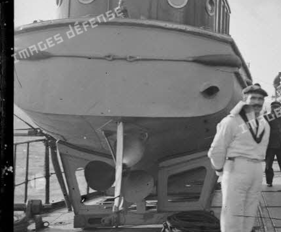

Do these boats have a steel hulI?
Eberhard
PostPosted: Thu Mar 16, 2023 12:34 pm
Posts: 5062
The figure program seems pretty amazing! I populated my APA with a hundred modified figures from a set of a Navy PT boat crew, crude by comparison!
PostPosted: Thu Mar 16, 2023 3:21 pm
Posts: 1890
I don't know, but it's possible:
Pascal

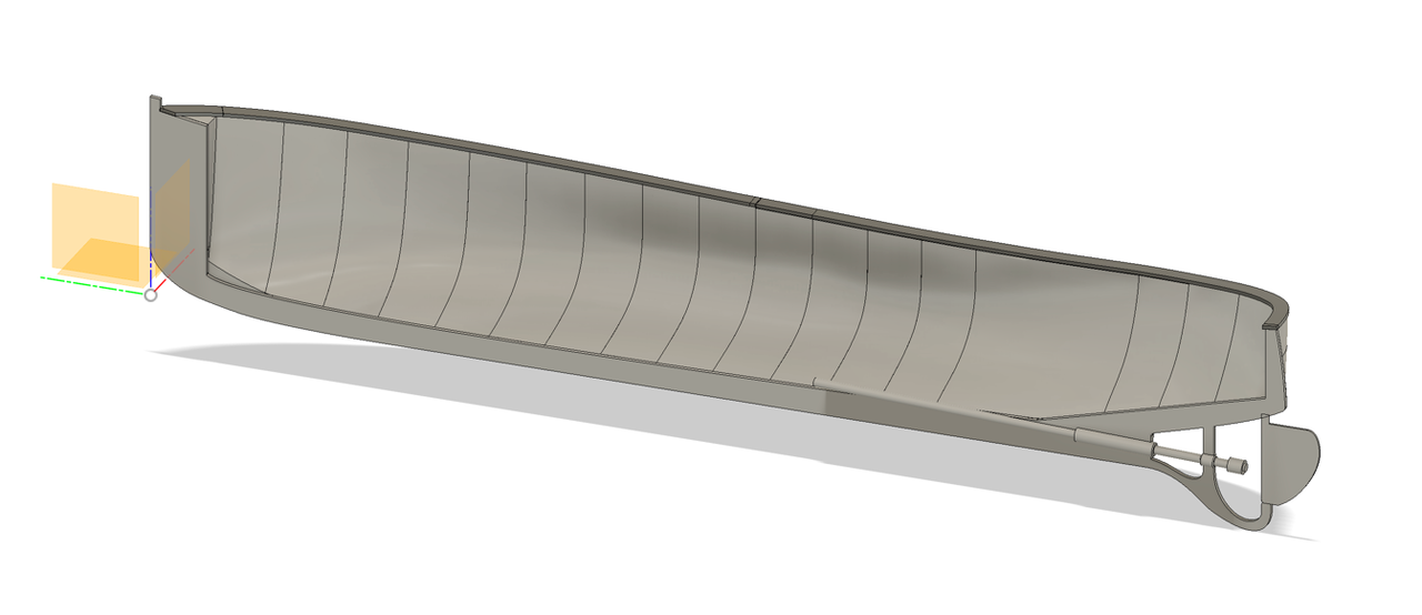

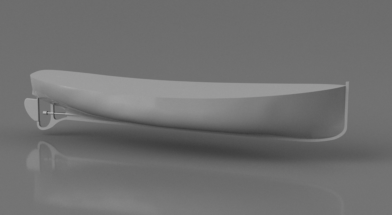

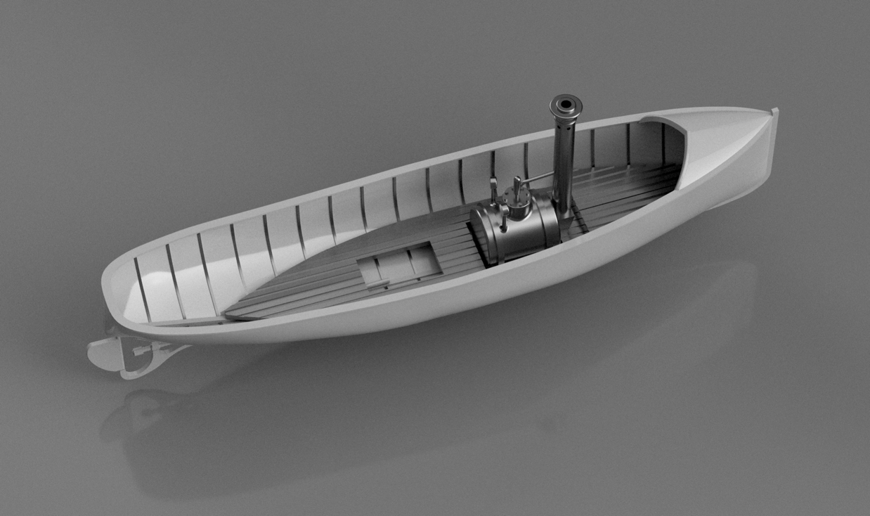

I drew the steam engine today and the rear benches. I've almost finished, no need to put much more detail. There are still the fenders to be placed on the planking, the hoops for the cover.
There will be two such launches on the battleship, I may cover one with a half-top probably.
Pascal

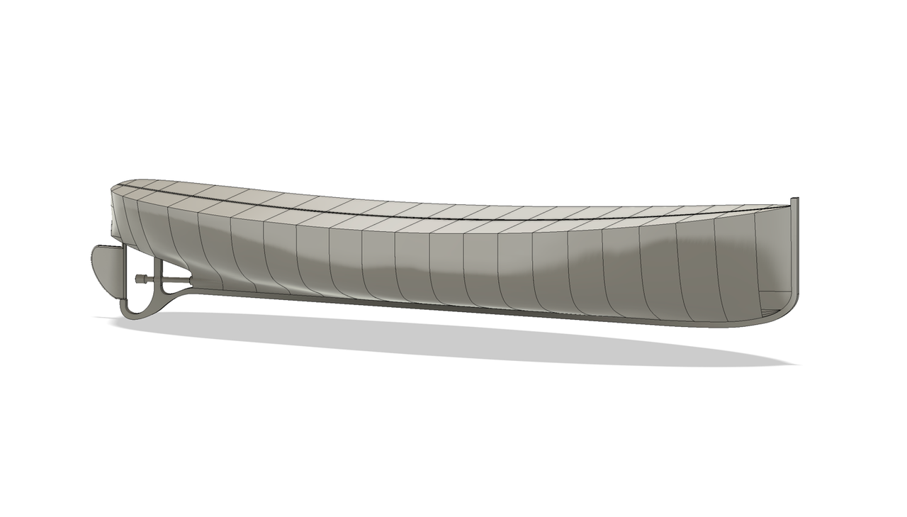

I looks indeed, as if the the boats were build with vertical strakes of sheet metal ...
Eberhard
