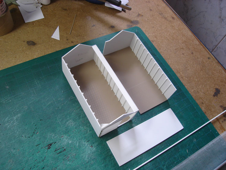

File comment: the two hangars

File comment: close off two hangars(flugzeughaffens)

Hi Norberto When building Tirpitz I was always puzzled as to how the hangers where fitted out. Is it your intention to show the hanger doors in the open position? with an ARADO 196 inside perhaps? Superb piece of styrene workmanship , very exact . :thumbs_up_1: :thumbs_up_1: :thumbs_up_1: :wave_1:

Dave, i was confused how this working but after analyze the images and drawings i conclude
have two doors one is sliding in one track and another appear closed in appearance, but not ,the second door is hinged by four hinges
and when the first door sliding to middle of hangar she connect with second door and twoo doors open together.
yes i am working to do it. opened hangar and showing ARADO inside.
my hinges is working now, but still need finish more things and the track
i thank you the encouragment and wishes to better.
:thumbs_up_1:

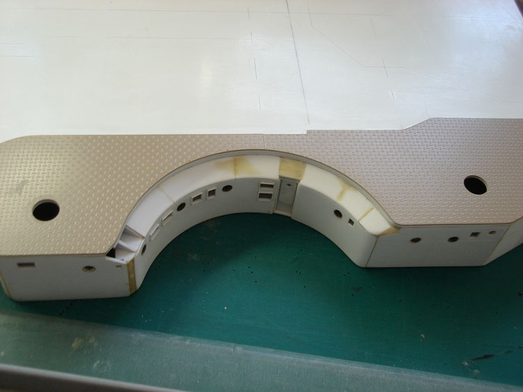

Hi fellow modellers i am here again to show the circular platform near medium guns.
still not complete but in the way... :wave_1:
File comment: this is the intricacy piece to do...
File comment: cheking the drawing in the shipyard

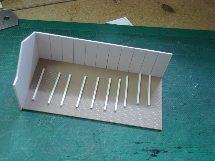

Hi fellow modellers. here a few of more of my work.
ventilation housing(i don't know how is the name of this house).
this is attached in the hangar starboard side..
And another parts.
re :wave_1: gards all
