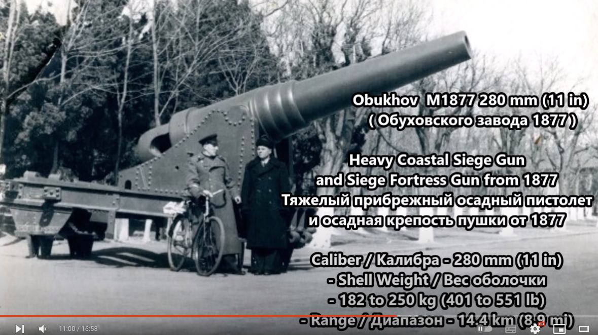

Talking about the gun, there was somewhere on the net film that shows a comparable 28 cm-gun, a Krupp-clone, being fired on a Russian fortress, but I can't put my hand on it right now. It's a silent movie, of course.
Eberhard
Image Image Image Image
PostPosted: Thu Mar 09, 2023 5:51 am
Posts: 1881
Location: Bretagne, France
Probably this one:
https://www.youtube.com/watch?v=VJaE7oiNuHQ
Pascal
