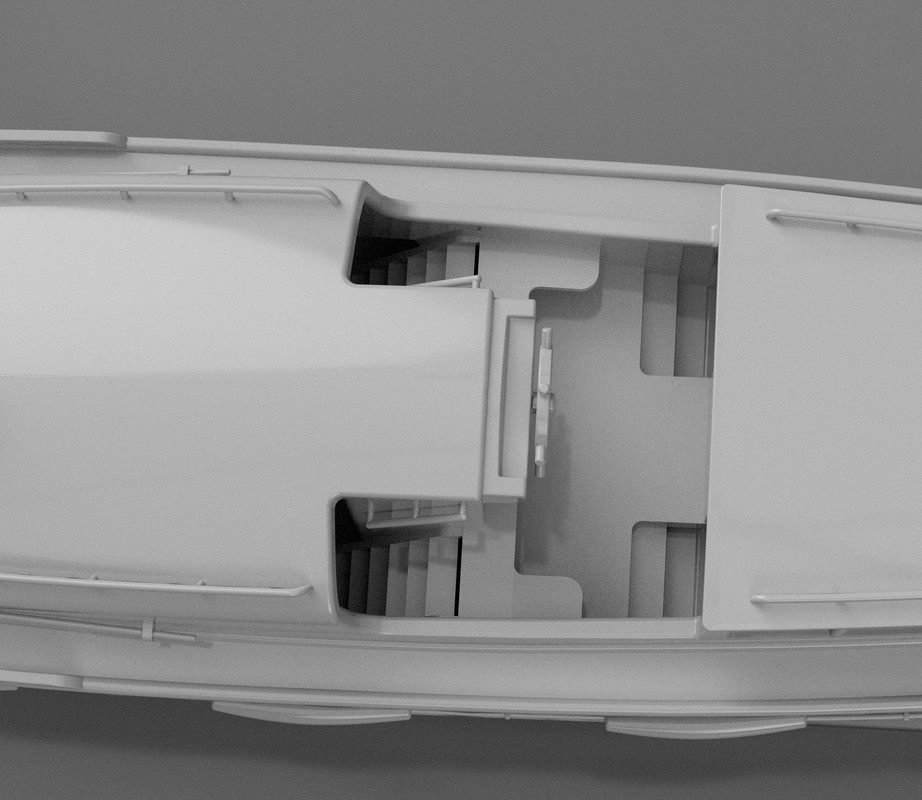

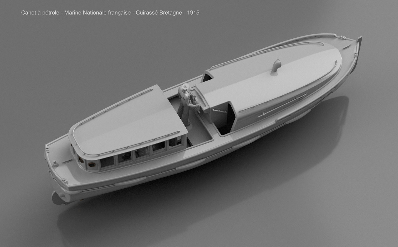

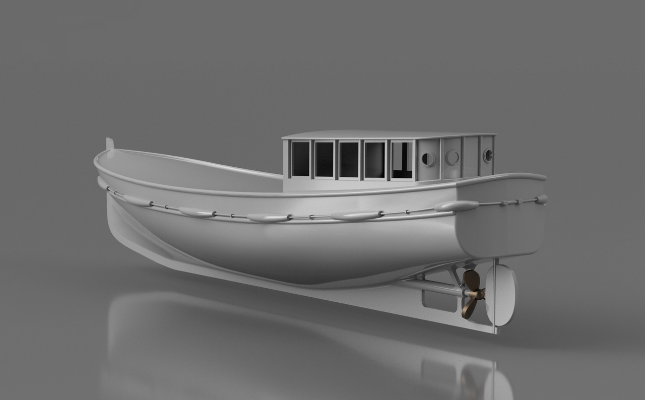

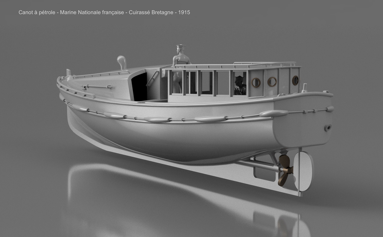

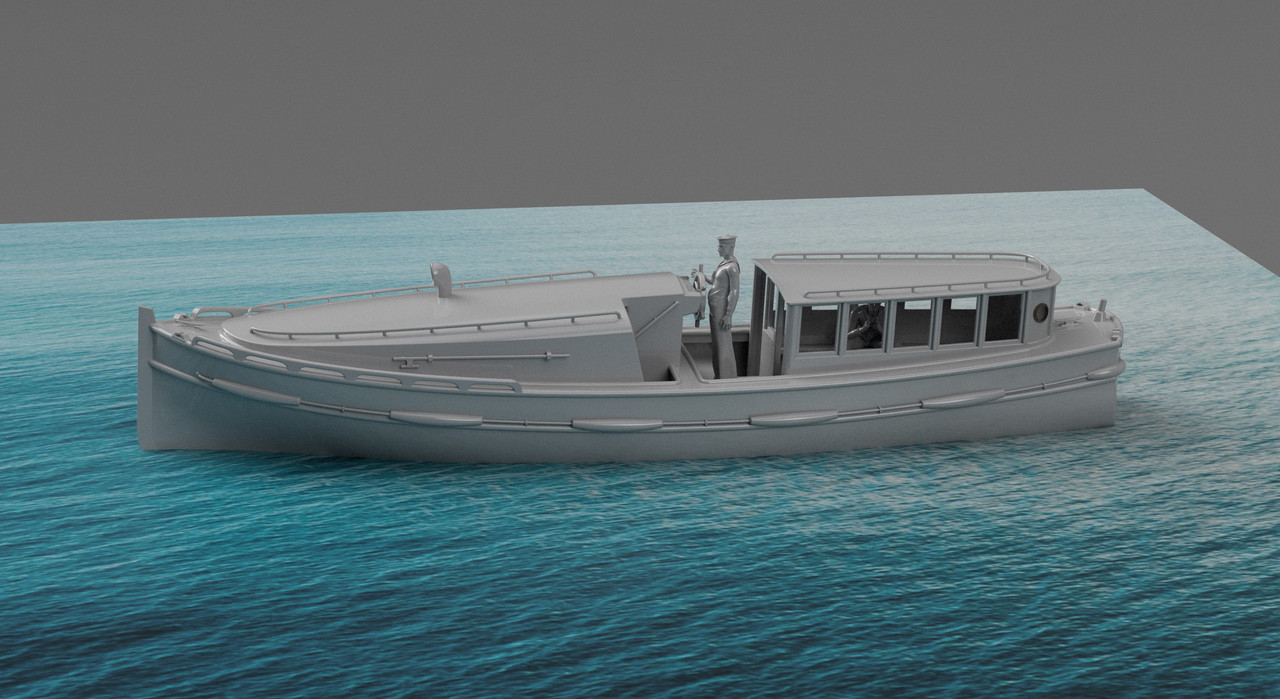

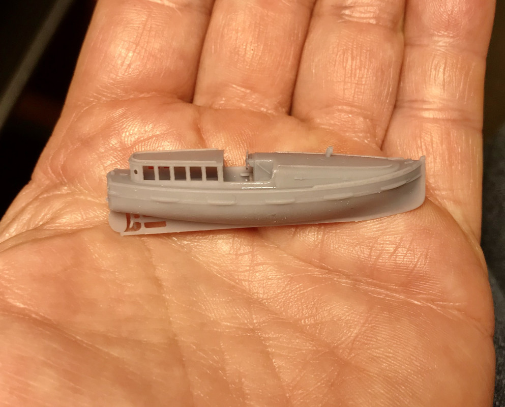

Drawings of the 2 cabins.
It's not totally finished, I still have a floor and stairs to draw, plus some small details.
I drew a vents, there may have been two (see photo), the front cabin houses the engine, these vents probably allowed the ventilation of the compartment and the air supply to the engine.
It does not seem to have glass windows on the back cabin.
Pascal

Pascal,
Nice work!
However, I count four rectangular windows in the sides of the rear cabin in the picture, and you have five in your model. Maybe the rear (fifth) one is the window with the round port.
PostPosted: Mon Apr 10, 2023 2:07 am
Posts: 1888
Location: Bretagne, France
Yes, it’s à choie, I made a mix of the diagram and the picture, they are not exactly the same boat. I wanted to keep the ratio length / width of the windows.
Pascal

Photo of the Bretagne at anchor in 1915, we can clearly see this type of boat with the typical keel drop, but with 4 ports instead of 5, as I drew, and a fender on the bow.
Looking at the picture of the Bretagne 2 days before she sank, I noticed this still different canoe with a 3 ports cabin with a different line on the water, more modern, normal for the time (1940):
Addition of a deck girder between the two cabins
Drawing of the stairs and I stop here.

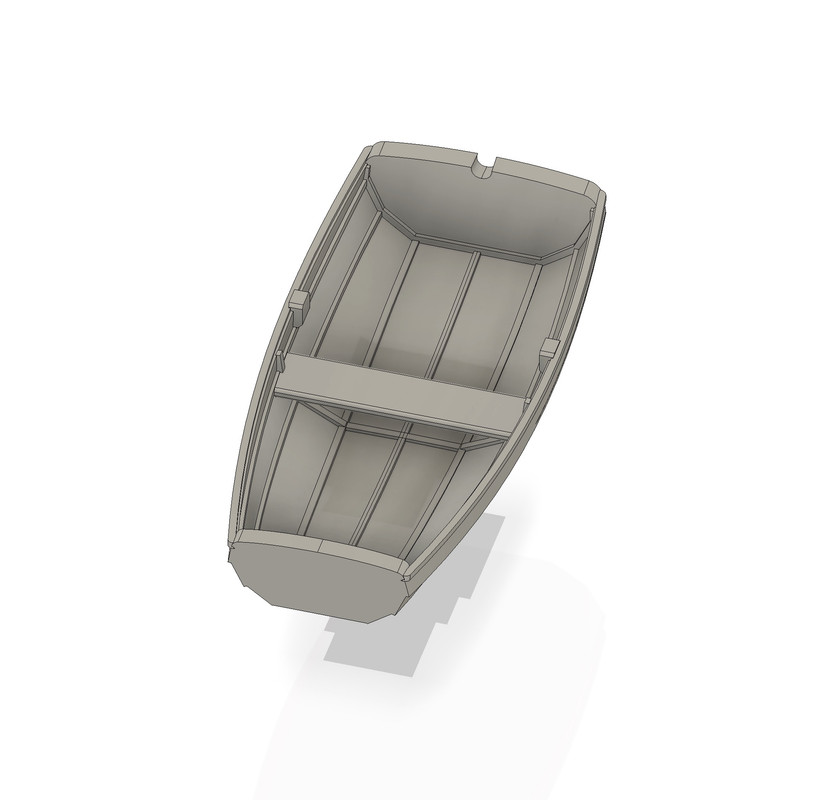

The launch boat fleet is complete.

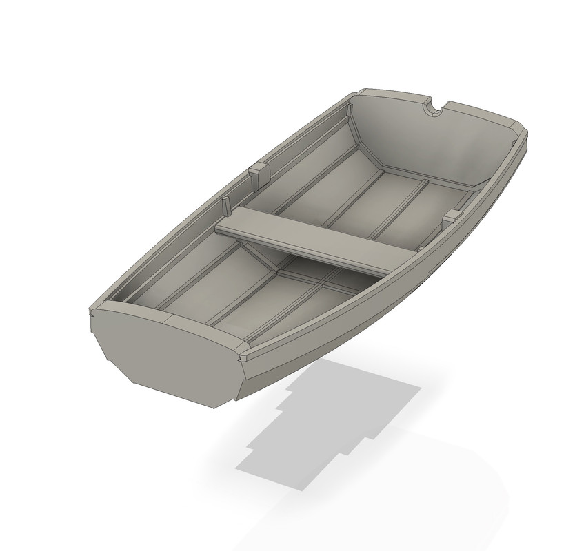

I made a quick plan of the little 3,5 mts clinthed pram. The hull is 0,25 mm thick.
Pascal

Interesting that the French navy used nordic 'prams'. What were they used for, for outboard paint jobs, like the British painting-punts?
What surprised me a bit in your design was, that you drew battens over the clinker-seams. Was it done this way in the French navy? Otherwise, it is not very common and technically not needed.
Eberhard

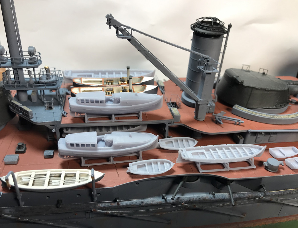

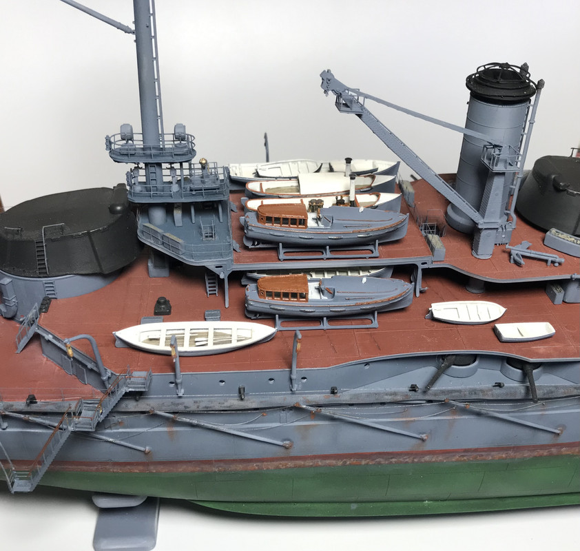

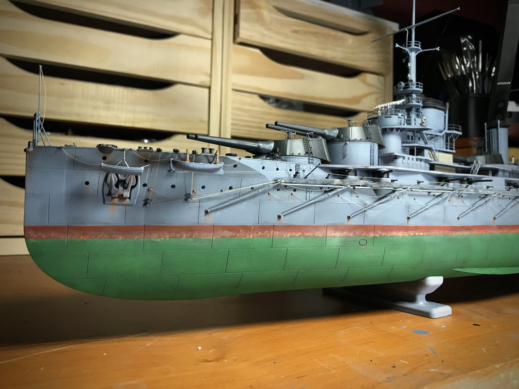

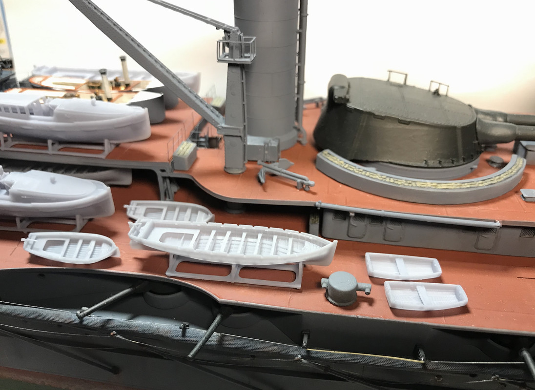

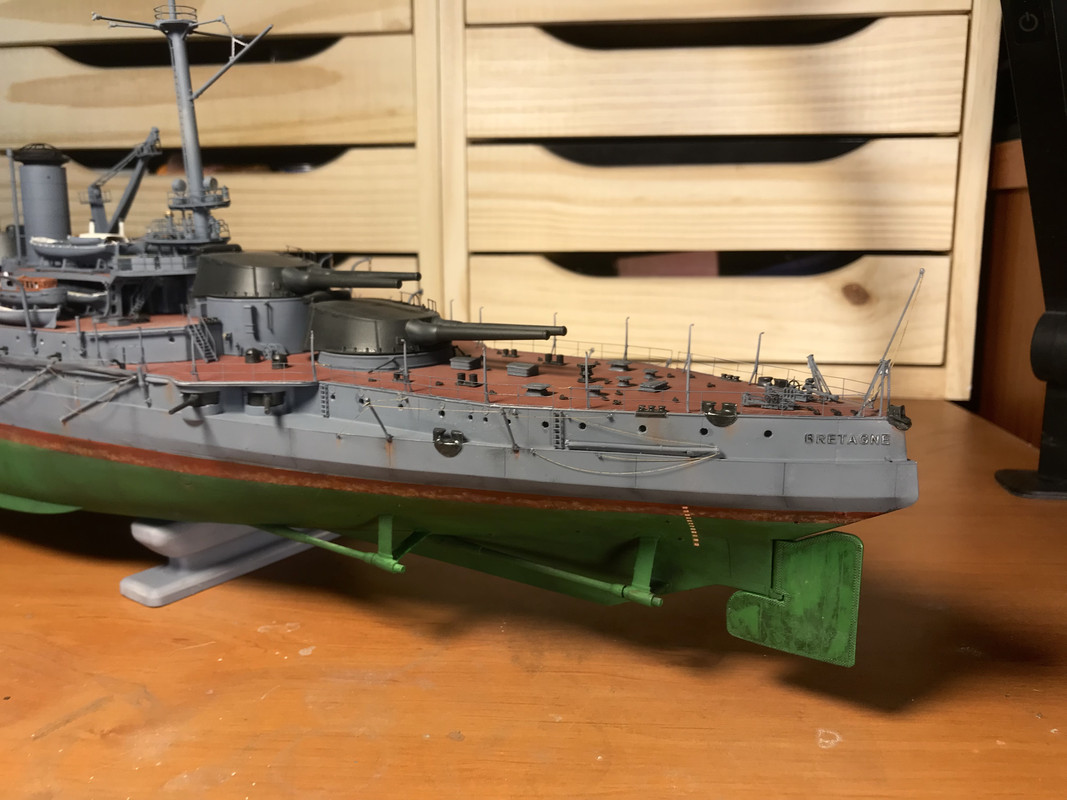

Work resumed on the Bretagne a few days ago.
I started drawing this battleship almost a year ago...
Painting of the dinghies is almost complete.
Installation of the stern railings is also almost complete.
Pascal

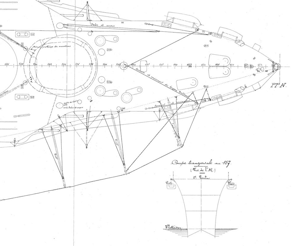

A lot of work has gone into rigging the spars for the port anti-torpedo net.
I'm becoming a pro at using stretched plastic sprues, which I'm going to have to do because all the rigging will be made using this technique, which I really like.
I still have two davits to make for the small mooring boats on the bow of the boat. They will only be on the port side of this model.
Pascal

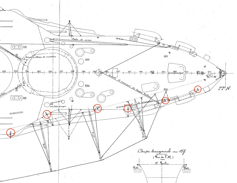

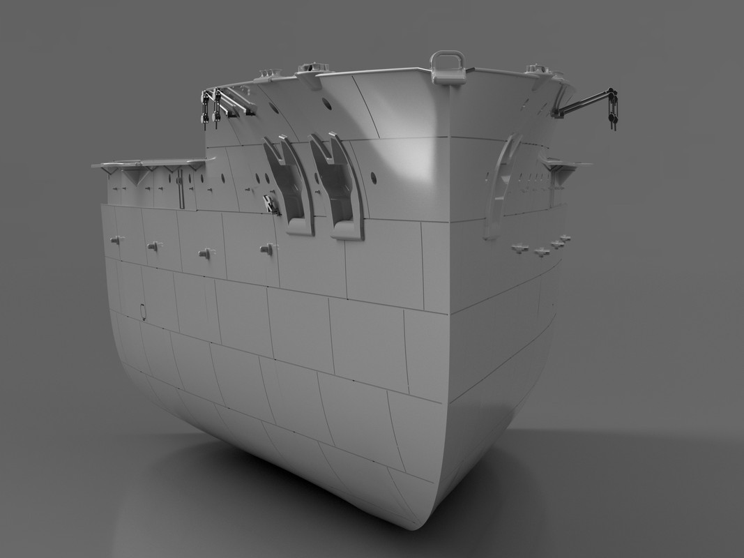

Drawing of the forecastle davits for the service boats to help them moor to the mooring boy and to anchor.
Then printing.
Installation of the rigging.
Pascal

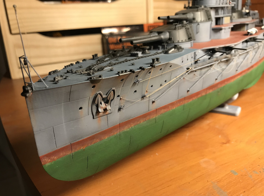

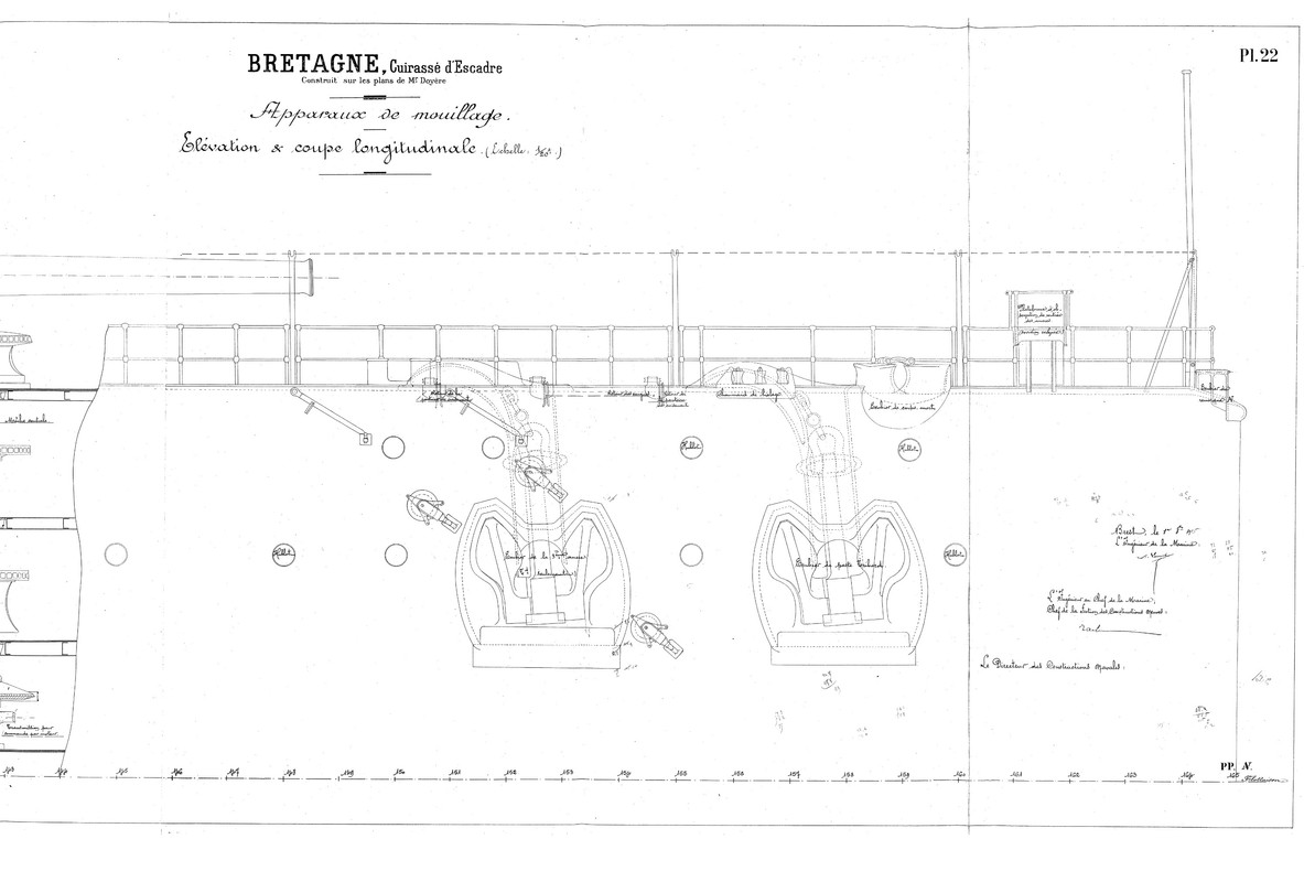

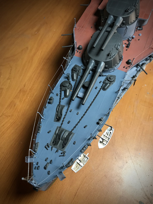

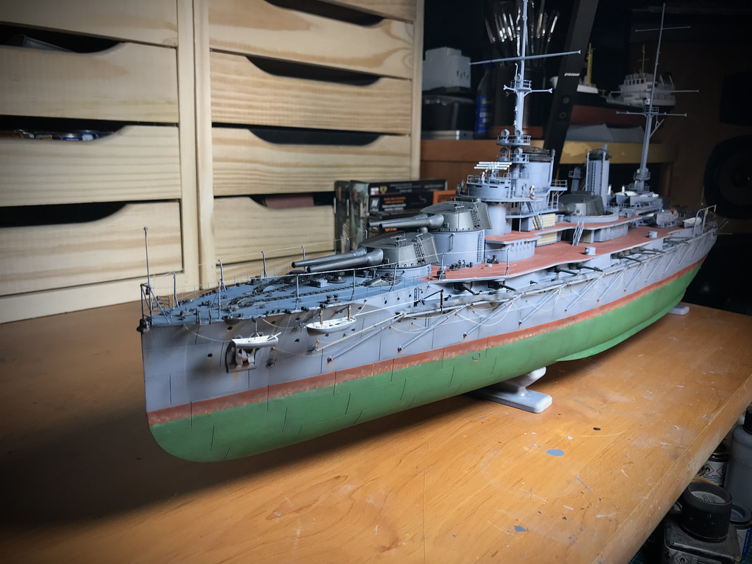

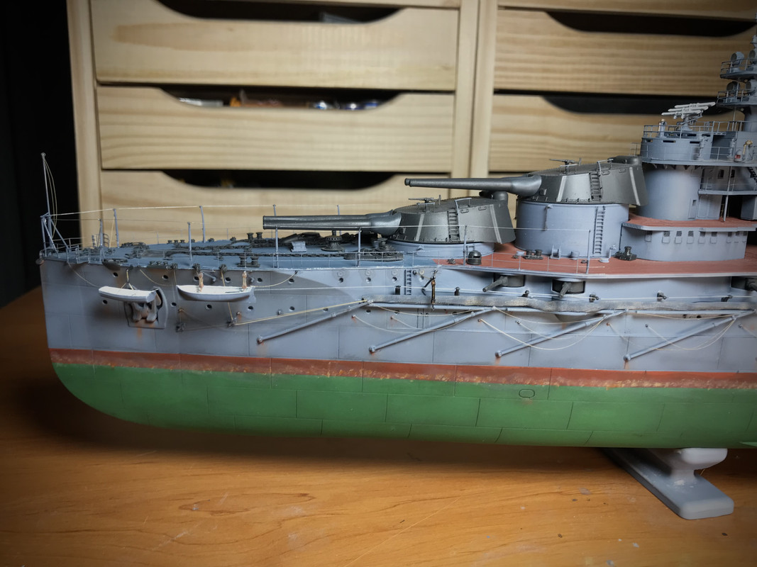

The forecastle is almost finished.
I've fitted the railing and the masts for the sun awning. Quite a few other accessories on the port side too.
The rigging is tricky to fit on the masts. It has to be lazy and taut without distorting the masts.
These masts are curved at the top, which wasn't always the case, especially when the ship was launched. On the Courbet class, they are straight, for example. I prefer this version, as seen in 1916, which is more elegant, and also allows the canvas to overhang the planking, so there's less rain/sun on the deck?
I've still got the droppable anchor chain fittings to fit. It secures the anchors to the sea.

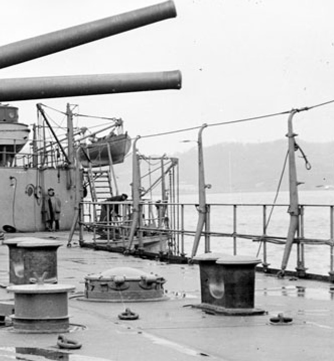

You can see the port anchor in this photo, disconnected from the chain, the ship is at anchor here (on the roadstead, no natural deep-water port at Saint-Quai), the port anchor is ready to anchor in case of a problem, you can see its chain swivel indicating that it is in the up position:
The masts in question:
Advances:
Pascal

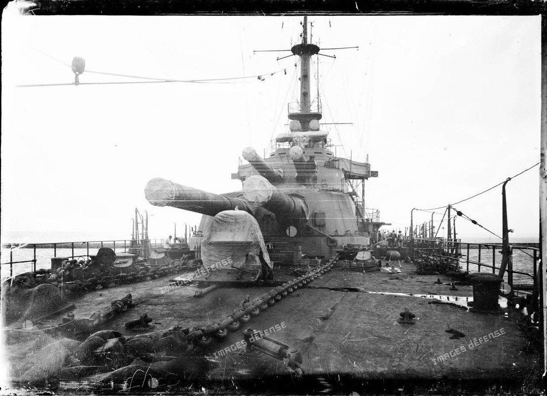

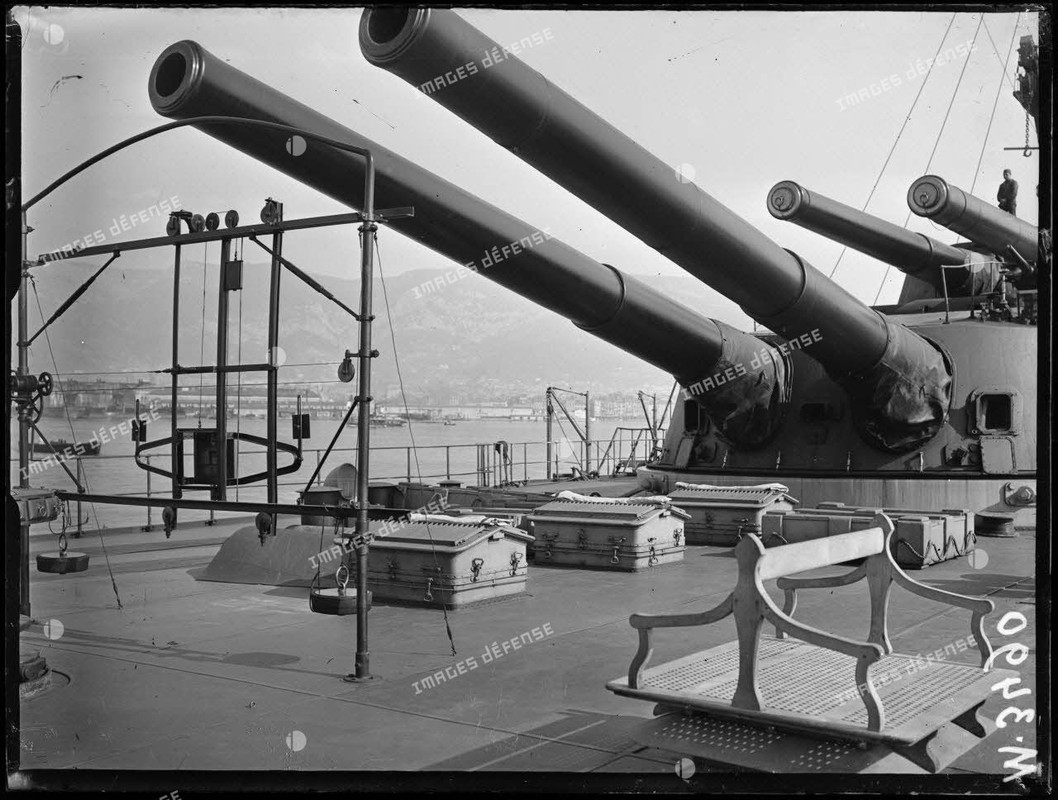

There were two types of Blast bag on the 340 mm guns of the Bretagne battleship: the "square" skeleton later found on the Richelieu, which of course has many more folds, and the oval following the opening for the turret gun.
The modification may have been made during the 1st redesign, when the 340 guns were raised from 12° to 18° to increase their range in 1919.
I've shown the 1916 oval version.
The "square" Blast bag model:
Without Blast bag:
Oval Blast bag :
Here on the Battleship Provence:
1915-16:
Two of my favorite reference photos that I use all the time for what I want to represent in 1916. These two photos are probably very close in time, but we can see small differences in maturity, as a warship is in perpetual transformation.

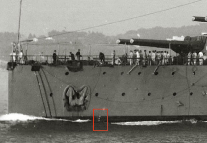

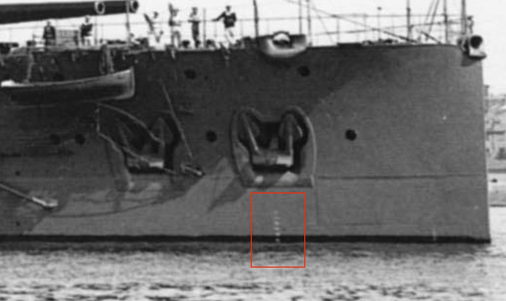

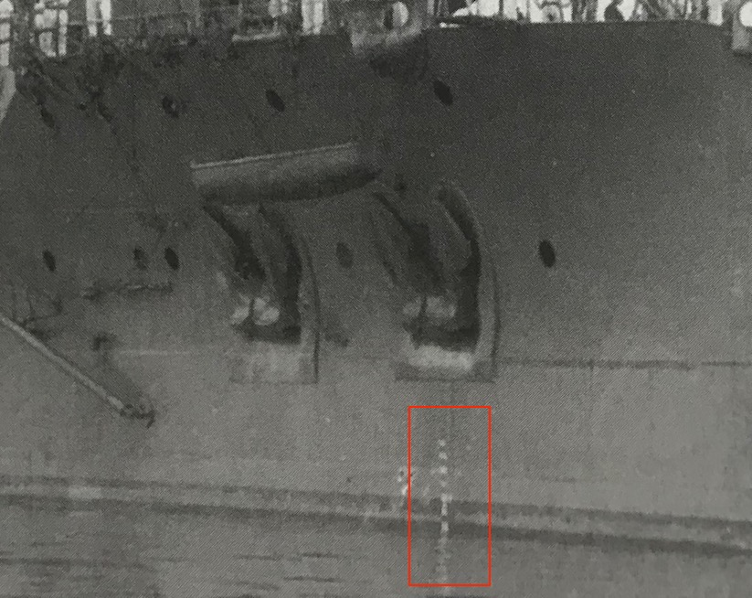

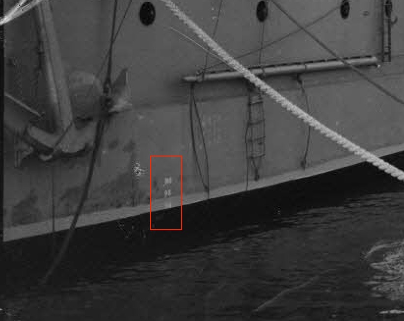

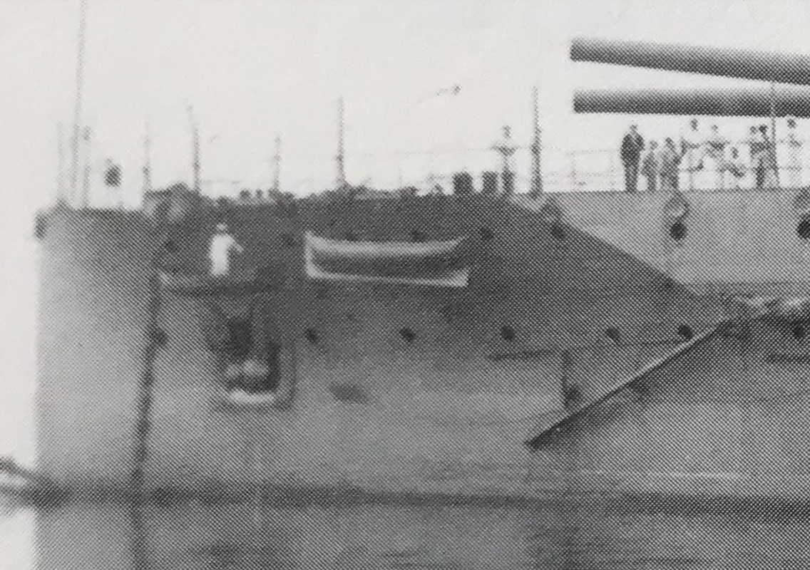

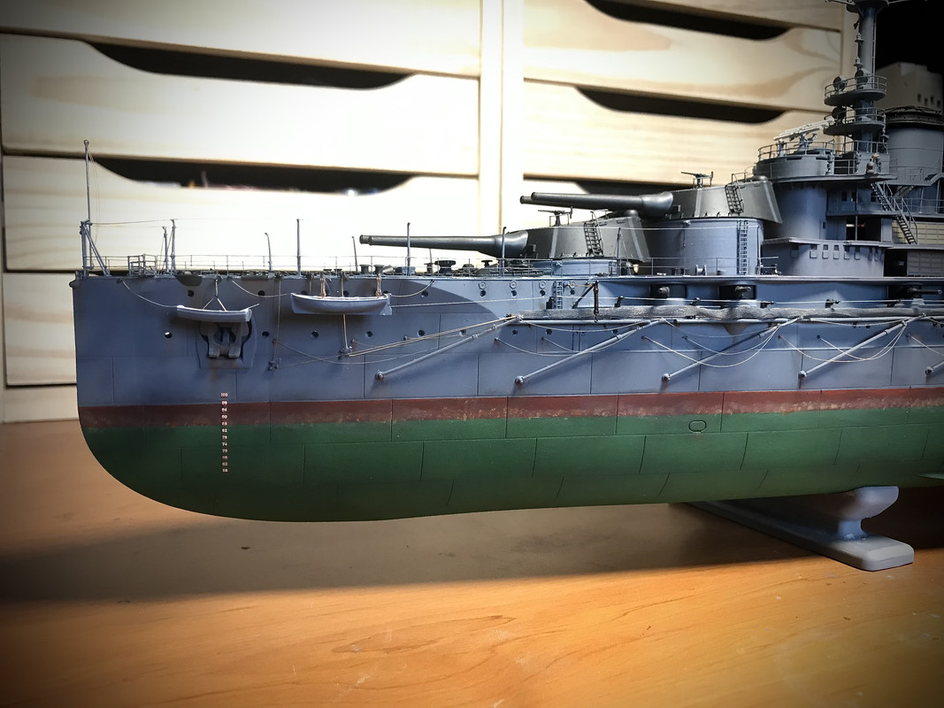

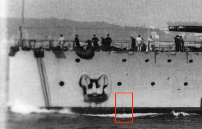

Evolution of the position of the forward draft scale:
Aft and forward draught, 1915:
Here it clearly reads 98 and above 100, i.e. 9m80 and 10 meters, which is consistent;
Technical specifications
Length 166 m
Main beam 27 m
Draught 9.80 m (full load probably, coal, water, oil, ammunition)
1915
After recasting, the forward draft scale is moved aft of the port anchor. No photo for starboard.
1926
1929

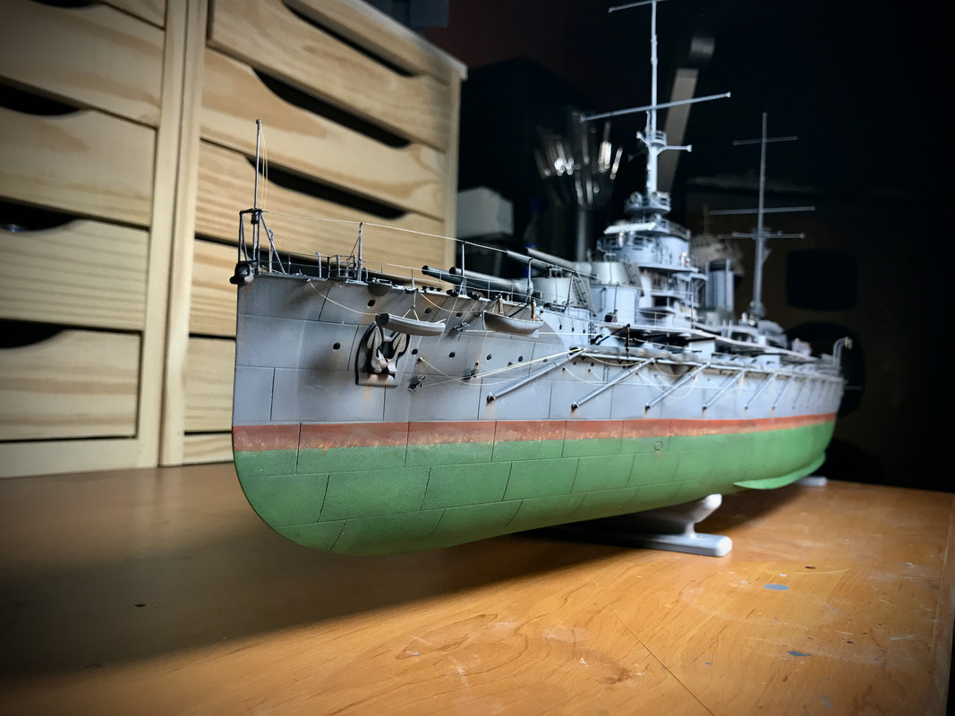

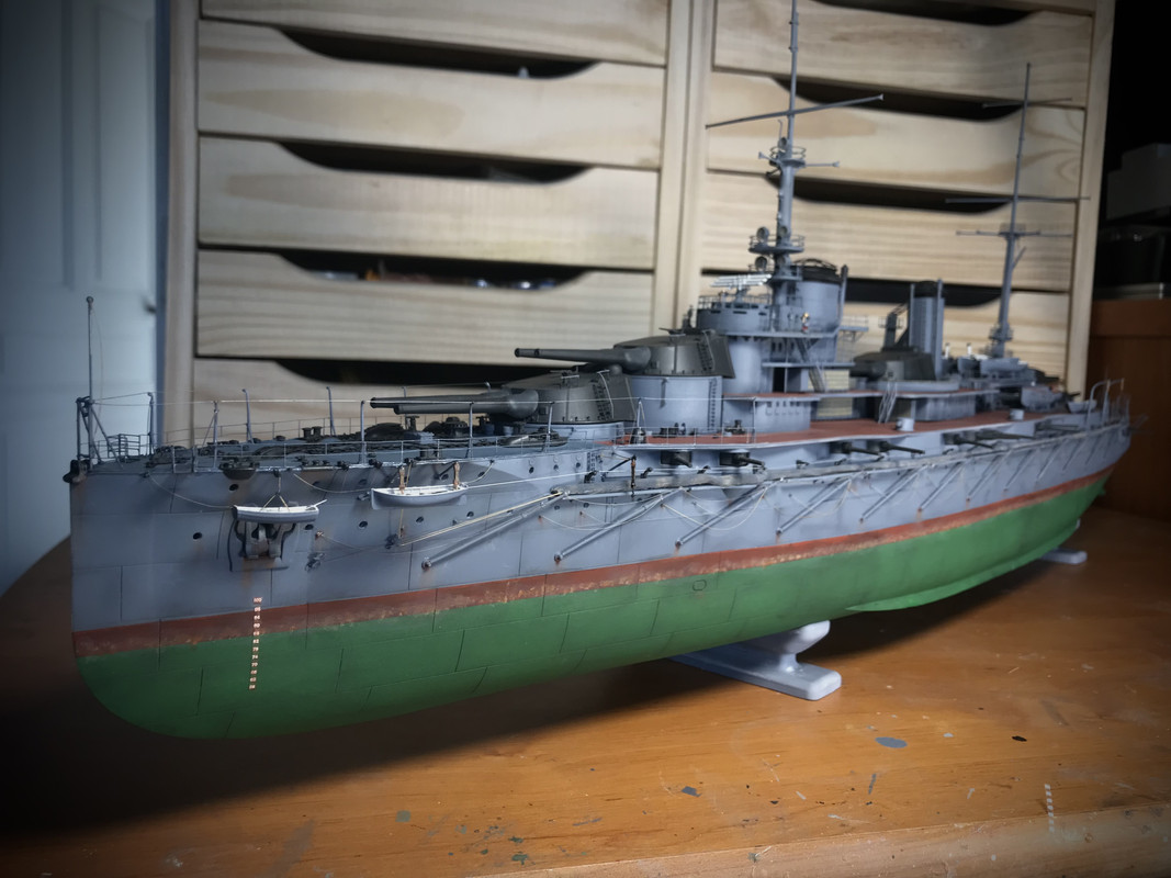

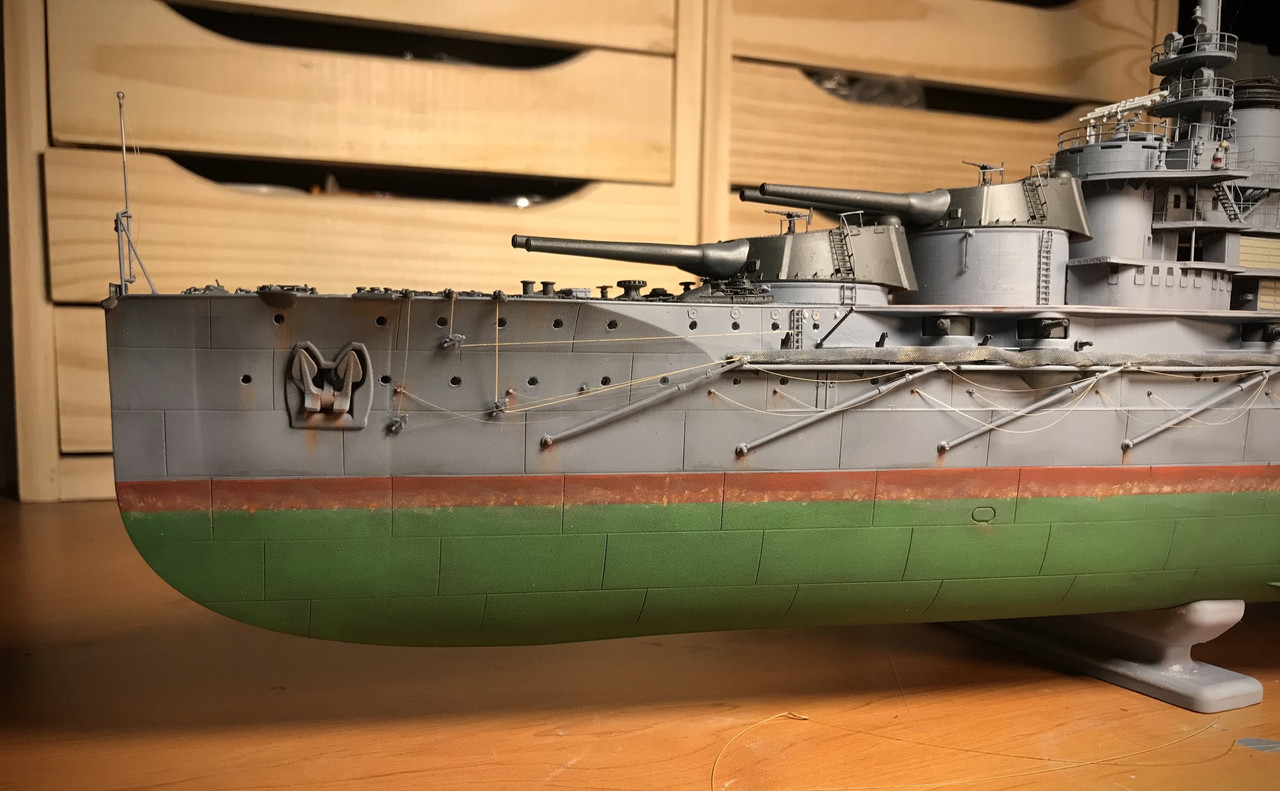

I can't conceive of assembling a ship without taking a close interest in its history.
It's often fascinating

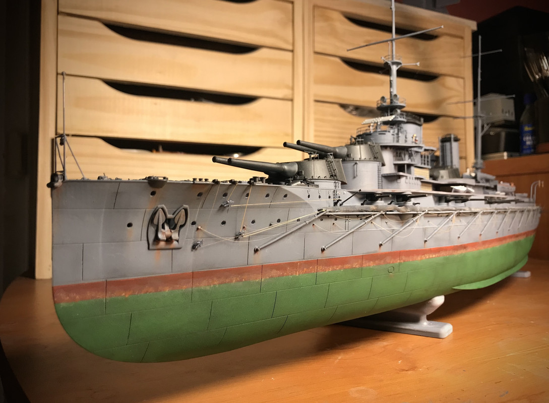

I've received the vinyl decals, and they're not bad. I reinforced the gluing with extra fluid glue, which I apply after gluing around the vinyl. But it'll be varnished later anyway.
I "rusted" the numbers. White is too white. But pictures increase the white effect.
Pascal
