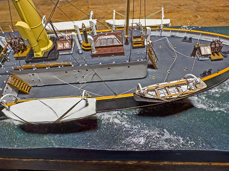

Installing the ship’s boats
This detail was the most dreaded of all, due to the flimsy character of the parts. The davits had been produced a long time ago, as were the blocks for the hoisting tackle, and, of course the four boats.
There are no pictures, except the very first photograph of SMS WESPE that indicate the arrangements for the boats hanging outboard on the davits. While it seems to have been a quite common arrangement on smaller warships of the time, it was already noted in reports by captains of Prussian gunboats ten years earlier, boats in such a position are prone to be carried away by seas of even moderate height. So, quite early on barrings and boat skids had been installed on the WESPE-class boat and the davits lengthened to lift up the boats. For this final arrangement, various images are available.
Somehow, the boats must have been prevented from swinging in their hoisting gear. A typical arrangement would have been a spar lashed across the davits and the boats pulled against them with cross-wise boat ties. In the absence of other pictorial evidence, this is what I opted for. There were, however, still some detail questions open: were those ties strips of heavy canvas or braided rope-work and did the spars have bolsters around them to prevent damage to the boats? For the latter questions there are examples of both option on photographs and (contemporary) models.
I recently visited again the Maritime Museum in Stockholm, which reminded me of a possible solution on a model of the same period. The boat-ties seem to have been heavy canvas and had triangular rings at their ends. They are attached to an eye at the top of the davit, run around the boat, then around the opposite davit, and are hauled taught with a tackle of blocks hooked in between them. No bolsters on the spars.
I decided to leave out the tackle and just use a lashing between the rings to tighten the ties. The lashing will be difficult enough to access behind the boats.
Boat ties arrange on a package of book-repair tape
The triangular rings were fashioned from 0.15 mm tinned copper-wire wound around the tang of a triangular file with 1 mm sides. The windings were cut open with a scalpel. The ties themselves are narrow strips of a special kind of material: a kind of very fine silk-paper tape with a backing of a thermos-setting acrylic glue. This material is used in book repair for instance. Brand and other details can be seen on the photograph. The 1 mm strips were cut with a new no. 11 scalpel blade and folded in two. The material is slightly tacky which is helpful when aligning the halves and inserting the rings. The glue was set with the help of my hot-air soldering gun set to 110°C as per instructions. The halves were pushed together using a tool as used in the old days to rub down transfer lettering. The ties were painted in Vallejo ‘hemp’.
Boat ties in detail.
It took some tries to work out a workable sequence for installing the davits, spar, boat-ties and boat-tackles, considering also the difficulty of access. Eventually the ties were fastened to the davits and the tackles hooked into the latter with the loose end already belayed to the clamp on the back of the davits.
Davits fitted out and ready for installation on board.
The davits then were inserted into their sockets and fixed with a drop of white glue. Next the spar is lashed to the davits. Then the ties were arranged in preparation of the boats and the lashing is reeved.
Davits ready to receive the boat.
The davits are now ready to receive the boat, which is slipped in and the tackles hooked into the respective rings on the boat. The ties are now pulled tight, so that boat rests against the spar.
Boat stowed in the davits.
Overall, the installation of the first boat went reasonably well. However, it is hanging a few millimetres too low. The boat’s keel should have been level with the bulwark handrail. Somehow, I didn’t manage to make the close-hauled tackled as short as it should have been. Also, the hooks on the blocks are a tad too long. Not 100% satisfactory, but I am not going back two steps to remake the blocks and tackles and all. Let’s assume the crew hasn’t done such a good job in stowing the boats and the officers haven’t noticed it yet …
To be continued ....

Ship's boats on warship were not exactly life-boats, but rather work-boats. For security reasons (preventing illicit traffic from and to the ship) warships typically were moored to buoys or anchored in harbours and roadsteads. The boat ensured the transport of personnell and supplies, but also were used for landing and reconnaisance operations and such. Usually only one boat was kept ready for emergencies, which is why I built the smallest boat uncovered.
Lowering boats from davits in anything but calm weather and a stationary ship was a dangerous operation. The hooks from the boat-tackles had to be released simultaneously. Imagine what will happend if the hook in the stern is released a second too late, when there is a sea passing under the ship. The boat's bow will undercut the wave and overturn the boat, while the stern is still suspended from the davit ... This is why slip-hooks were invented and patent-applications and publications abound with suggestions for quick-release gears that allow to release both hooks simultaneously. While slip-hooks were used in the Imperial German Navy, the quick-release gear never seems to have caught on (pun intended ...).
I know of numerous photographs and contemporary models from all over the world, where these boat-ties are shown, when boats are kept suspended from davits. This applies to both, naval and merchant navy ships. The ties could be strips of canvas, plaits, or simple ropes. When boats rested in chocks under the davits, so-called gripes were used to tie them down.
The problem I had, was that the tackles turned out too long. The reason was partly that the fake splices for the runners became a bit too long and would not run over the 'sheave' in the block, and partly that the took turned out too long as well. Maybe also the ring in the boats should have been lower. Just a fraction of millimetre error in each element adds up. There are so many degrees of freedom or variables in the system that are difficult to determine a priori. It's not like machining a piece to dimensions ...

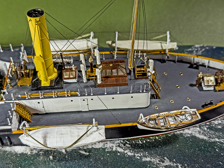

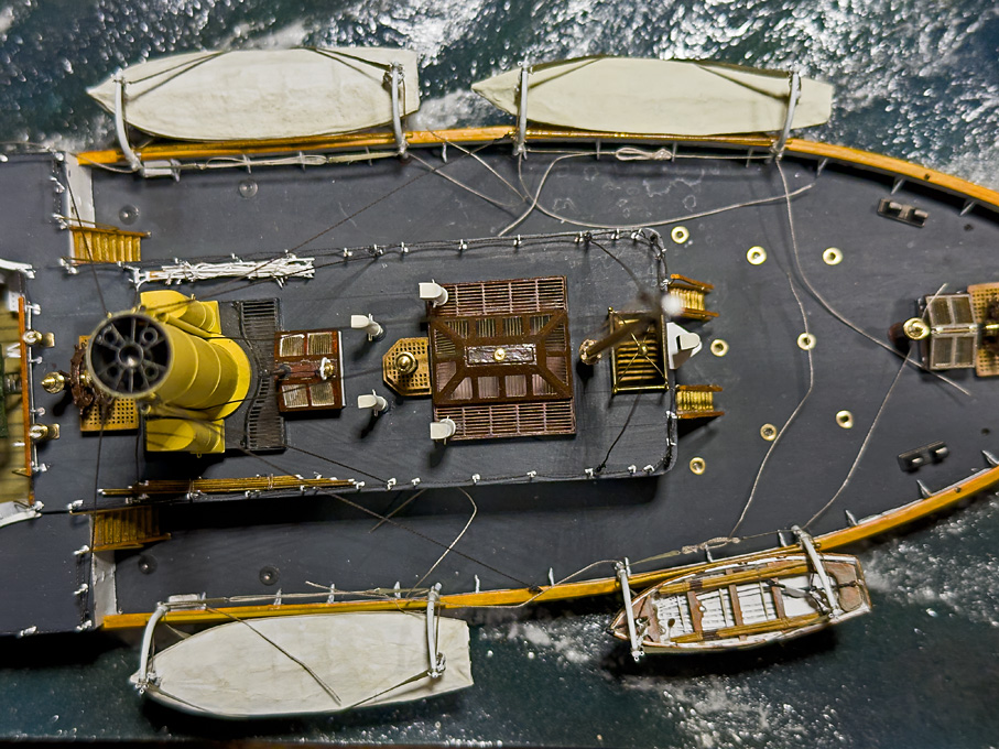

Installing the ship’s boats 2
It is done! All four boats are suspended from their davits and the work was achieved without major damage to other parts.
Good thing that there is not (yet) any brain recorder … because of the mental language that accompanied the process at certain stages.
Still there is a lot to be done, such as tidying up the loose ends, making and installing the coils of rope from the runners of the boat-tackles and the longitudinal chain-stays for the davits.

Installing the ship’s boats 3
The installation was movd further to completion by tidying up the loose ends and producing the bunts for runners of the boat tackles. The runners are about five times the distance between the head of the davits and the waterline long, plus some extra for handling. However, as the rope is slightly overscale the runners were cut a bit on the short side in order to make the bunts not too bulky. The actual runners were cut above the cleats and the bunts were formed over two clothes pins driven into a piece of wood and have a loop pulled out with which they can be hung over their respective cleat.
Note that the runners for the ‘ready’ boat are not arranged in bunts but in coils, ready to be thrown loose so as to allow the boat being lowered quickly e.g. in a case of man-over-board.
Again, working from the inside out, the next items to go on were the stays for the davits. Luckily, the stays are drawn in the lithographs so that their points of fixation are known. I had to deviate a bit from those drawings, as they pertain to the longer, turning davits for the boats stored on rack, which belong to a slightly later period. The stays are supposed to keep the davits aligned, rather than helping to swing them around.
It was a bit of a trial-and-error procedure, before I came up with a protocol for making miniature fake chains of exactly the right length and with loops at both ends. The chains would have been shackled into ring-bolts at the head of the davit. No way of making shackles in this scale, so I just tied the fake chains to ring-bolts with fly-tying thread.
Some people may think now that’s it, but in fact there still is quite a long to-do list for little details:
- davit for the stern-anchor
- flag-poles and flags
- for the gun: tampon, wiper, rammer, and two gun-sights
- and the … crew!
