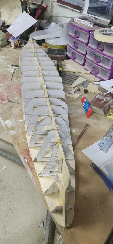

I managed to put all bulkheads in place this weekend. I will make some deck test fittings this coming week. I kept the other hull, maybe deal with it later, it could be used as a mould.Maybe used as a plug in the future.

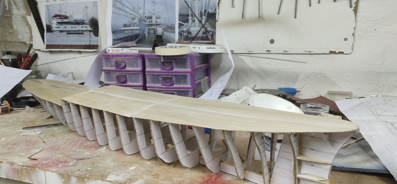

I did cut and glued the deck this time in 6 pieces. I used 1mm balsa handled carefully. Once foam filling will be put underneath it will be solid hard. However the thin balsa represents better the horizontal and vertical curves of the deck comparing to stiff and tougher 3mm MDF used before.
