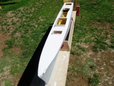

File comment: combings done
File comment: before
File comment: after Flo coat...sunglasses required!

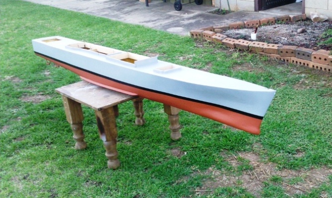

I have finally got round to ordering my weapons and bits from APS and have been busy getting hull painted and drive bits installed for a test run. With 4 SLA's motors and electronics she needs approx. 3kgs of Ballast fwd (under fwd 5") and 5kgs(approx.) aft beneath rear mk13 launcher.
The test run was good and bad: The Good she steers nicely and makes a nice wake! The bad: TX had some throttle issues and only gave about 1/4 power fwd! (And I didn't bring spare Tx...Doh) Gave her a second test run yesterday and found she is still a bit slow! I have tweaked the props with some more pitch and will try again, if there is no great improvement I will put a pair of higher revving motor's in!!
Bruce

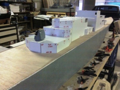

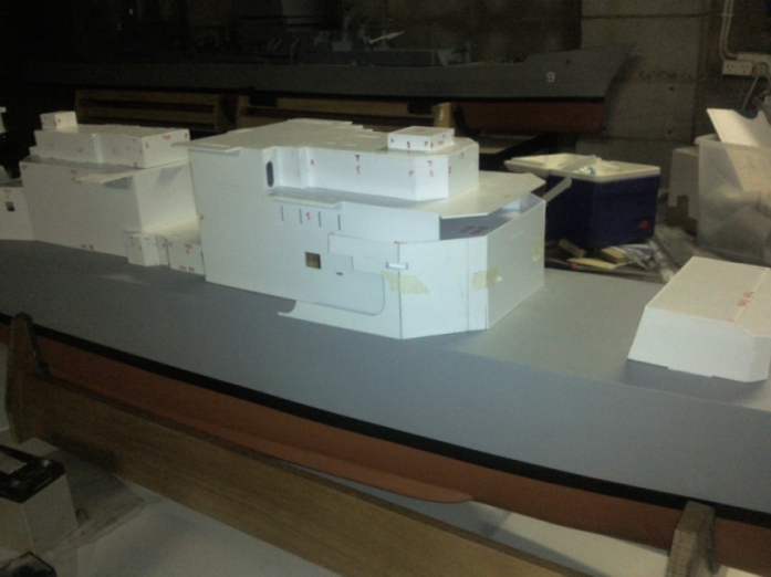

I have been fairly busy lately with work and rearranging the workspace in the shed, however have done a bit more motor testing and tried some cheap Johnson 700 motors in USS California she had great speed but these motors pulled a lot of Amps (over 15!!)at speed and that would not give acceptable run times. I have ordered some MFA torpedo 800's from the UK which should provide good power and lower Amp draw.
Also have done a small amount of work on her superstructure building the aft upper level, bridge upper level, then did a test fit of fwd bridge faces and assembled and painted the 5"mk45's and mk13 SM2MR missile launchers.
Cheers Bruce :cool_1: :cool_1:
