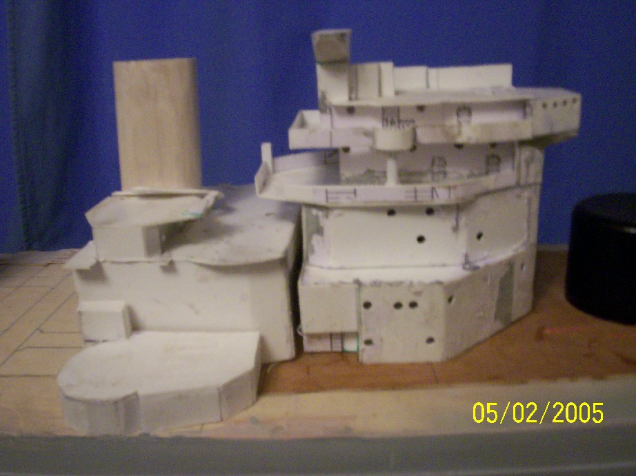

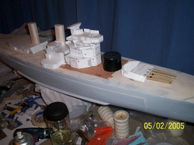

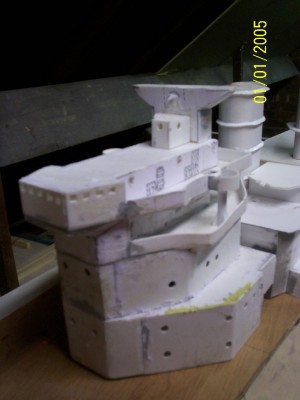

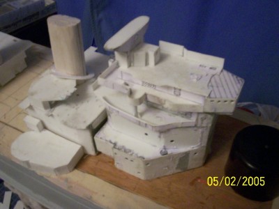

Have been away for a while but I have been doing some of the super structer and it is going a lot slower than I thought it would but here are a few update pics
File comment: These barrels are just for show made them about 6mm to short with other plans
File comment: All items are just placed in position for photos
The funnels that are there will be coverd with styrine. all the majore large work is done now to proced with the small items on the structre. Also waiting to get a one piece section for the compartments, instead of the three that I have now.

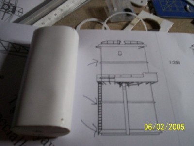

Question how do you get the er frills round the funnel, I have coverd the funnel with styrine as phots
File comment: Frills arrowed and there's one at the top also which I forgot to arrow
:huh: :huh: :anyone: :help_1: :please:

PostPosted: Mon Jan 30, 2012 2:56 pm
Posts: 1173
hi ian, if you go to 1/144 addmiral sheer scratch build page 16 and scrole down you can see what i did to get a angled,beveled splinter screen or what ever it is called,this may work for you.
PostPosted: Mon Jan 30, 2012 4:23 pm
Joined: Sun Mar 09, 2008 6:21 am
Posts: 174
Location: Wetzlar, Germany
hi ian!
i´ve cut the bottom and top plate from plywood and filed it to 45 degrees of angle...
photos soon!
best regards
joachim
PostPosted: Tue Jan 31, 2012 6:45 am
Posts: 1993
Location: Brasil
I cut 3 plates from styrene in the format that surrounds the funnel and each lesser plate that to another one and I filled with puty and later I sandpapered giving the format :wave_1:

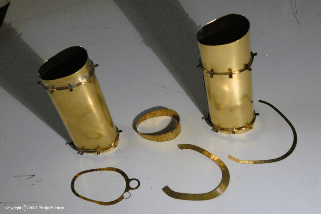

Here is the hard way to get the skirts around the funnel. First you create a 3D CAD model:
http://www.okieboat.com/CAD%20smoke%20pipes.html
Then you flatten the skirts into a 2D outline and make a photoetch:
http://www.okieboat.com/Copyright%20ima ... 24%20C.jpg
Someone posted a tip on how to calculate conical sections on the Forum somewhere, but I don't remember where. Maybe someone else remembers.
