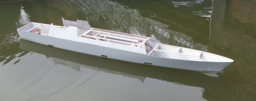

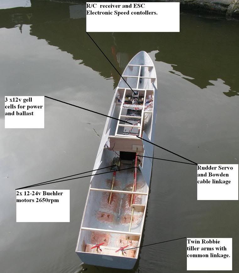

Thanks Norberto . By the way the black strips along the hull are not boot topping but are there to assess ballast and trim . I like to fit out all the engineering , motors, servos, R/C and power supply then conduct all the trials to test ballast -trim and of course power and steering trials. If all goes well I can move on to building the model.
Here is the Daring hull undergoing those trials . I tend to stay with the same method regardless of hull .
Here is the Daring hull undergoing those trials . I tend stay with the same method regardless of hull .

With the engineering , power trials and ballasting completed , that's one major job out of the way.
