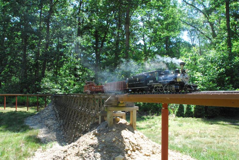

In my other hobby, Live steam 1:20.3 (Fn3) D&RGW narrow gauge trains, I found a way to make smoke. This C16 class engine was made by Accucraft, it's a 2-8-0 with 'D' valves and Stevenson valve gear, and a displacement Lubricator.
What I did was machine a part to fit the top of the steam exhaust tube (3mm) that is in the stack. The steam and oil (400W) are forced downward. The steam goes up the stack and the oil runs down to a brass tray that is angled back to the burner. Oil is burned and a gray smoke emits from the stack. This works even on the hottest day when one can't see steam.
Bob W

Thanks Bob I will give that approach some thought. Your smoke looks really good!
Glen
