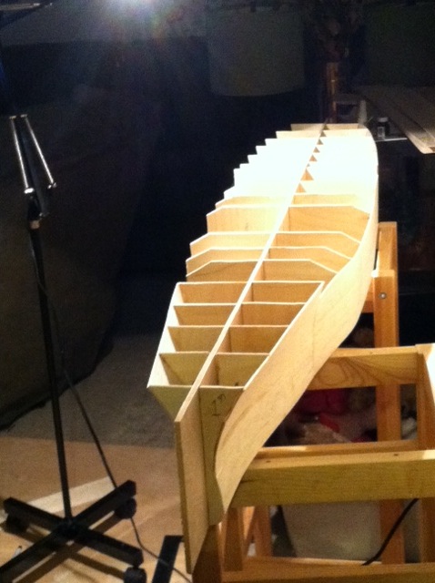

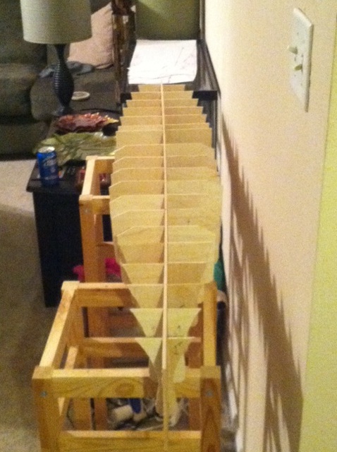

Hey guys,
If you have made the connection with my forum handle and the pictures/threads I've done, I got a thing for BB-60. I love Naval history, particularly Pacific WWII and Alabama was my introduction to this as a kid since it was close by to my hometown. I've spent many a summer there and find this ship fascinating as well as incredible pride for those who went before me and others and the United States.
Anyways, I am attempting a scratchbuilt model of her after building a 1/700 and 1/350 of the lady. I am using oak ply and basswood ply for the backbone and bulkheads. Once dry, she will be sheeted with balsa. Still not sure what to put on over that (bondo, fiberglass?)
PS - never mind the dog toys or the wife vegging out :big_grin:
Kyle

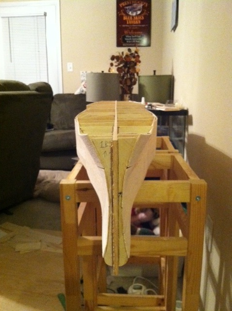

Okay, so her skeleton is about done. Still figuring out what to do about stem/bow and stern, thinking it would be easier to use balsa block and sand it into shape.
Kyle

Hi kyle Yes it's good to keep the good lady on your side . As for the bow I use block balsa or obichi, added once the hull has been sheeted. Also for a good reference have you had a look at ARHs North Carolina build some good ideas that could prove useful to you.

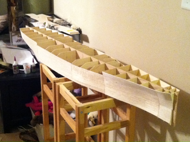

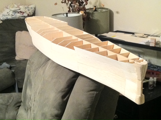

Little slower going than I had hoped, but got one side sheeted! Started on the starboard side now, then will do the keel.
Kyle

Hi Kyle nice building and very good way to build the hull :thumbs_up_1: :wave_1:

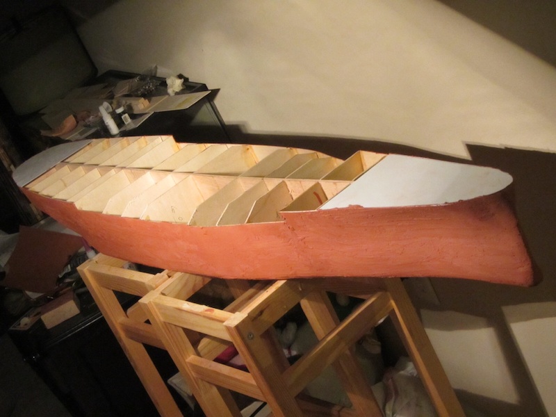

Alright got the inside epoxied up and have coated the outside in Bondo glazing putty. Sands down nice, will smooth her up tommorow - maybe even get some primer on her!
Kyle
