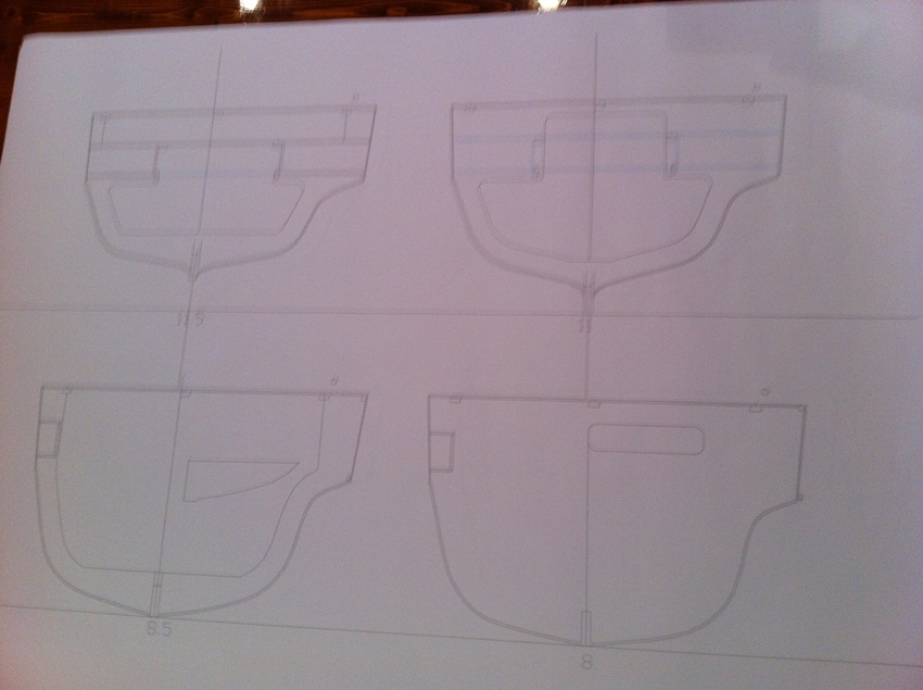

File comment: Concept Drawing by a friend Gunter

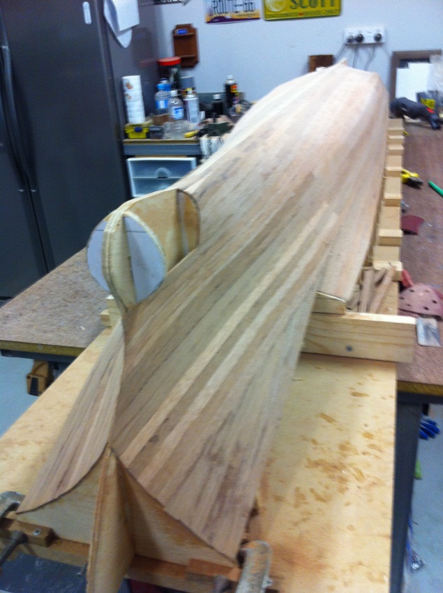

Thank you very much Dave for your kind words and with the last build of HMAS Sydney I can see that to do justice to Garibaldi she will take a while to finish! but thats the journey and the fun of building. Here are some more pictures of Garibaldi, sorry about loading so many pics but I just wanted to get you guys up to speed with my build and if anyone has any detailed photos of her new configuration as I've only got her plans as she was built not refitted that would be really appreciated. Scott
File comment: Garibaldi setting up for planking

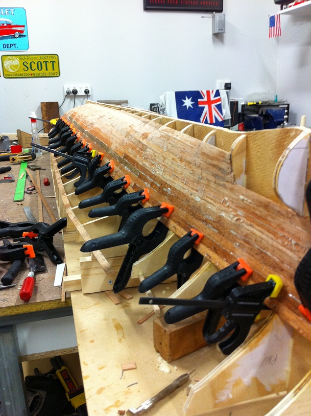

File comment: Garibaldi planking
File comment: Garibaldi with planks sanded
File comment: Port side cut
File comment: Stern hull section
File comment: 6 Cedar blocks gluded
File comment: Starting to shape the stern

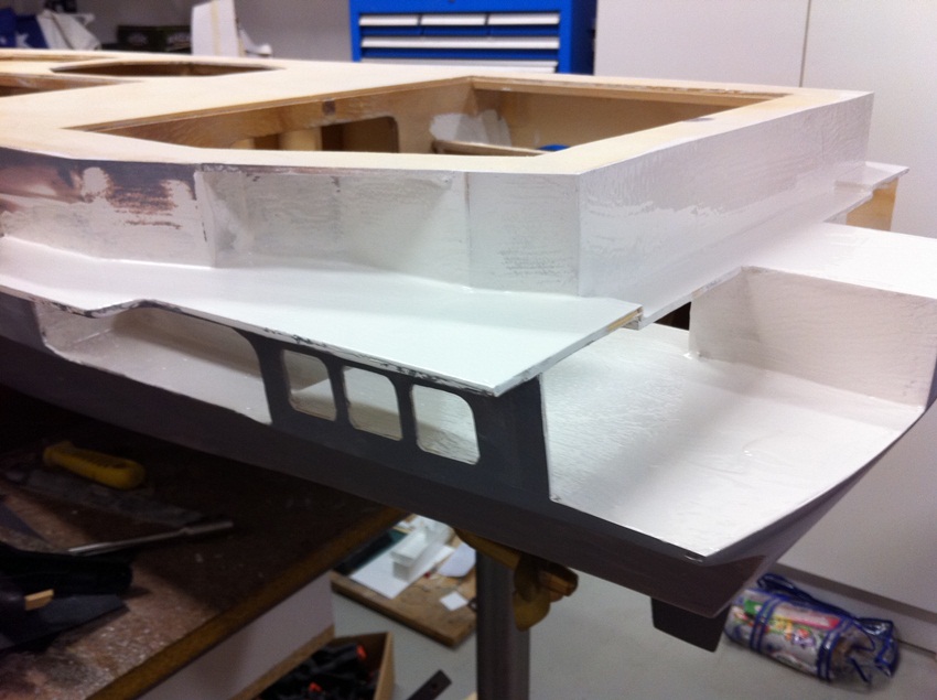

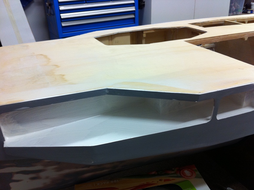

File comment: Flow coated the forward compartment
File comment: Flow coat of the stern deck
File comment: Flow coating hard to get to areas

Well that is it so far. I did say that this is my first scratch built ship but I did forget to say that one of my friends in my club Gunter helped me with getting the plans right as this is 1/72 and the plans did not have the right amount of frames to do the job so Gunter had drawn the missing ones for me and also built a smaller model out of cardboard to show me how all the frames would go together and some other hard sections of Garibaldi's curves went around her bow and forward areas.
Top Bloke and with out Gunter's guidance I would not have done Garibaldi. Thanks Gunter
File comment: Concept drawing with frame set, deck arrangment by Gunter
concept drawing with frame set, deck arrangment.jpg [ 197.53 KiB | Viewed 2160 times ]

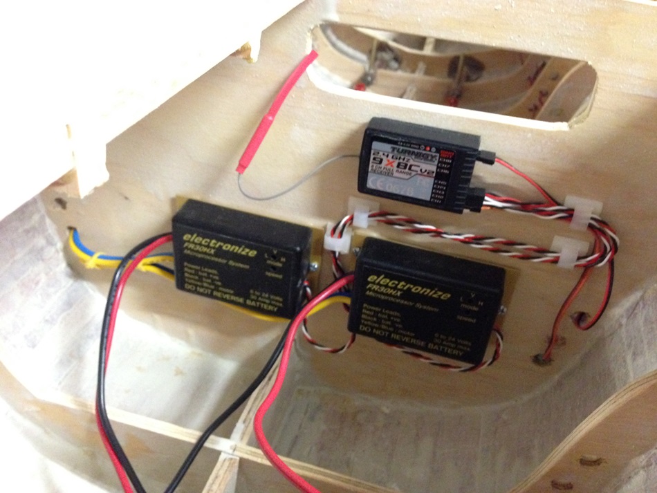

Mick I do have some progress on Garibaldi and yes them Kids are keeping me busy and my youngest is giving me less sleep then I'd really like! But that's cool it will not be for long (I hope). I had tried some motors in Garibaldi with not much luck she was way to slow and took a long time to take off from a standing start. So I looked at a mates vessel USS Longbeach and she runs 900 BB Graupners and her speed and exceleration was great so I went on a hunt for these motors and they are really hard to buy! but after a lot of web searching I tracked some down. Well I have had these motors for a long time and now that she is on the build table it was time to fit and wire up her new ESC's ready for a test sail, this is also the first time that I have had ESC's with no BEC so I had to fit one of those too! It's not a lot of progress but my time in the shed has been cut right down and with her bench tests I think I'm going to be happy with her water test. I hope to have a sail test this week crossing fingers!
File comment: New motors and mounts

File comment: ESC's mounted
