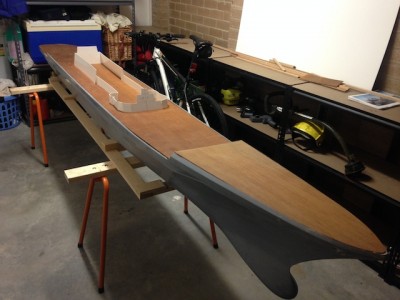

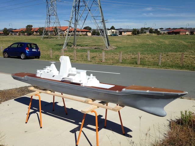

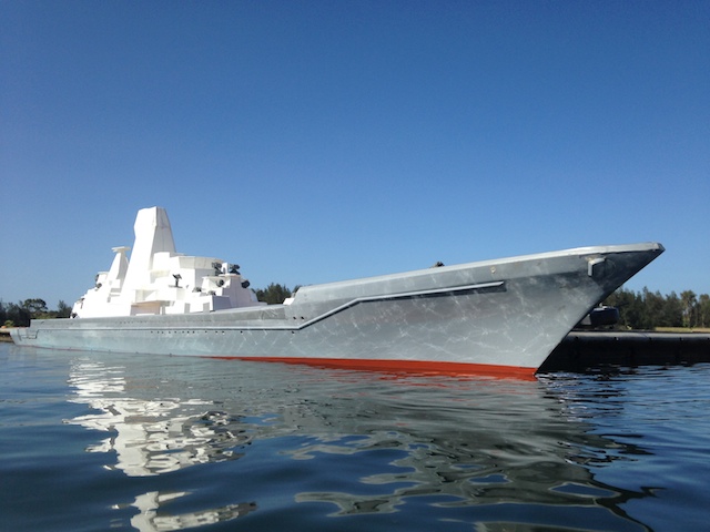

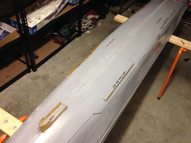

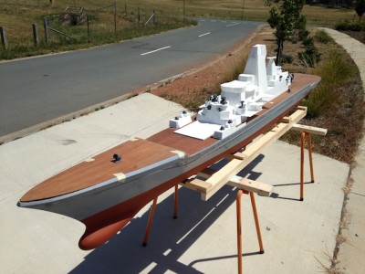

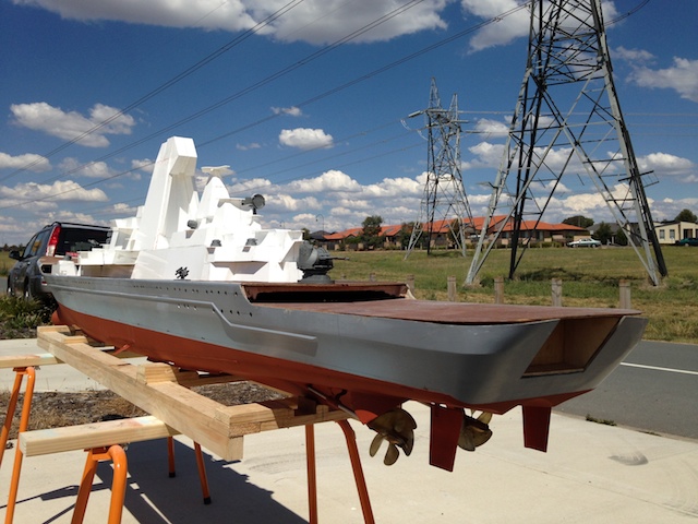

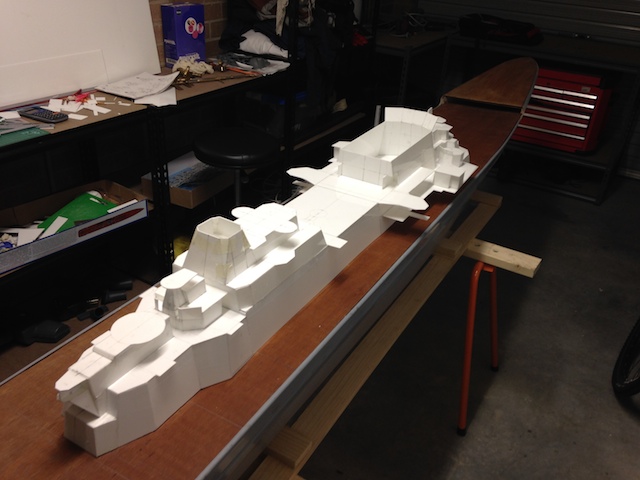

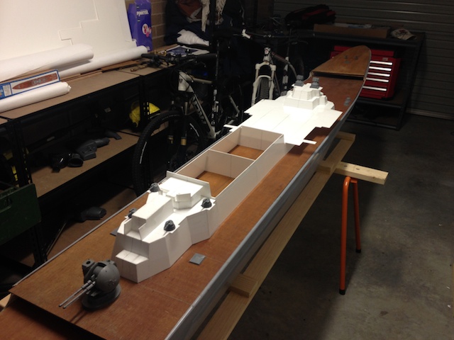

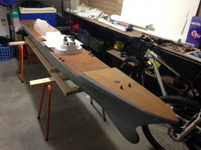

Hi everyone. Here are some photos of my 1:72 scale Soviet Navy Kirov class nuclear powered cruiser FRUNZE which I currently have under construction.
I've had this project in the pipeline since mid 2009. After building and operating 1:72 scale Krivak, Sovremenny and Udaloy class ships I decided to attempt the jewel in the crown of Soviet Cold War era naval architecture. The KIROV and her 3 magnificent sisters are my favourite ships of all time, and in my opinion, among the most striking and impressive warships ever conceived. Their innovation and capability is a tribute to the engineers who designed them, the tradesman who built them and the men of the Soviet/Russian Navy who sail them.
In late 2009 I obtained plans for the ship from Russia and commissioned Tim Amos of Southern Cross Models to build a custom made hull for me. After making a plug and mould he completed the magnificent fibreglass hull in mid 2010. In the meantime Allan Pew of APS Models was manufacturing a customised weapons and sensor set to suit FRUNZE and also a superb running gear set.
I collected everything in November 2010. And she sat basically untouched (and was almost sold in the meantime) until 13 Nov 2013 when I walked past the hull in my garage and spontaneously decided to start building it. And I have been loving every second of it.
This is by far the most enjoyable model project I've ever done - made more enjoyable because I love Soviet warships and the goal of building a Kirov is what made me get into this hobby in the first place. Now she's a reality it is quite exciting.
The photos below show progress over the past 7 weeks or so - from a hull with nothing more than bracing and a plywood deck fitted to having the superstructure and hull work basically complete. Once I fit the motors and radio control gear she'll be ready to hit the water for the first time.
You can also follow my build at http://www.taskforce72.org/forum/viewto ... =48&t=1013
Cheers :smallsmile:

PostPosted: Thu Dec 26, 2013 1:57 am
Joined: Thu Dec 12, 2013 11:31 pm
Posts: 40

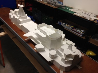

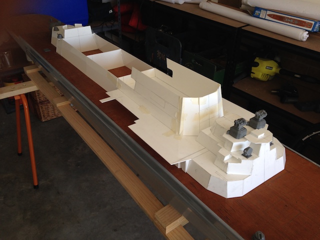

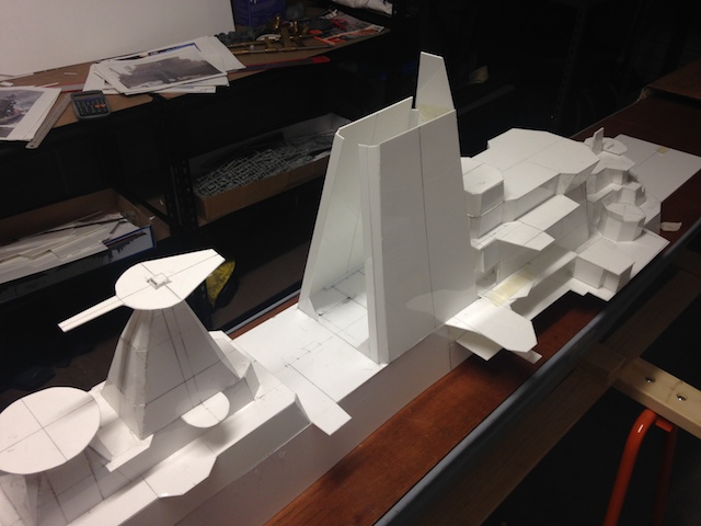

Continued from above - more photos going back to day 1 of superstructure construction

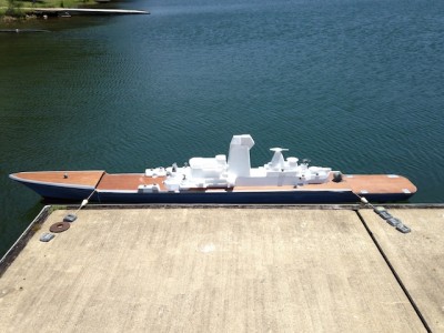

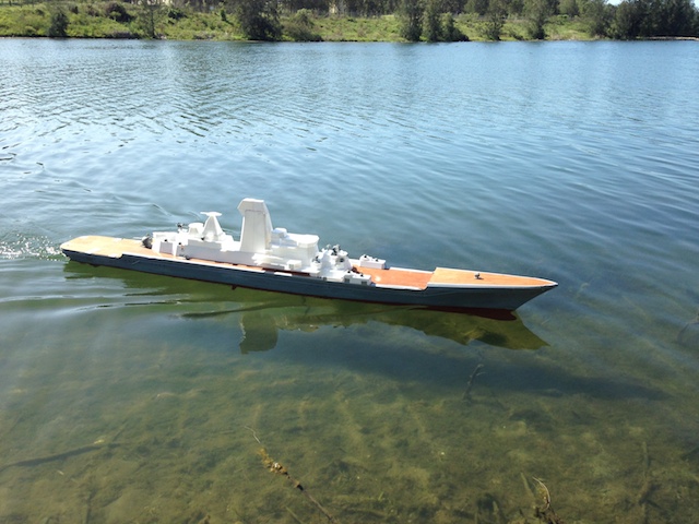

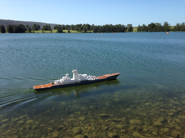

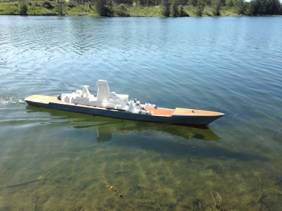

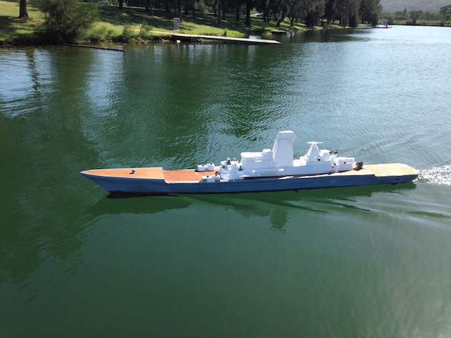

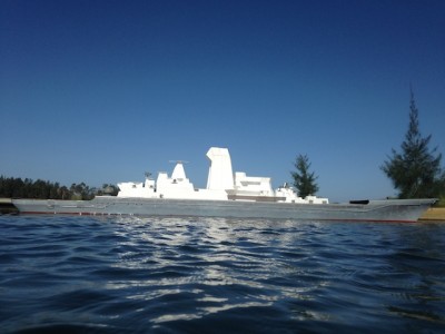

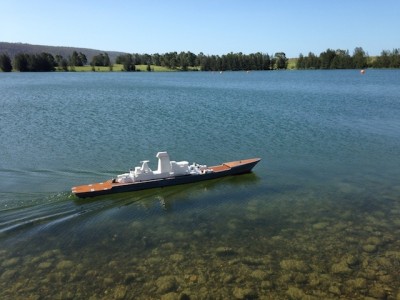

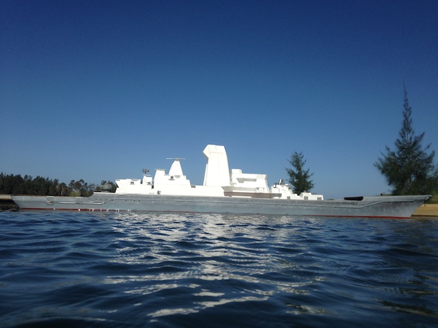

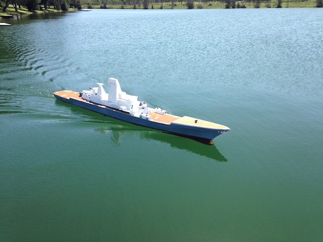

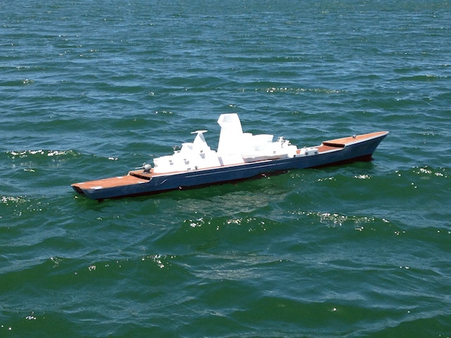

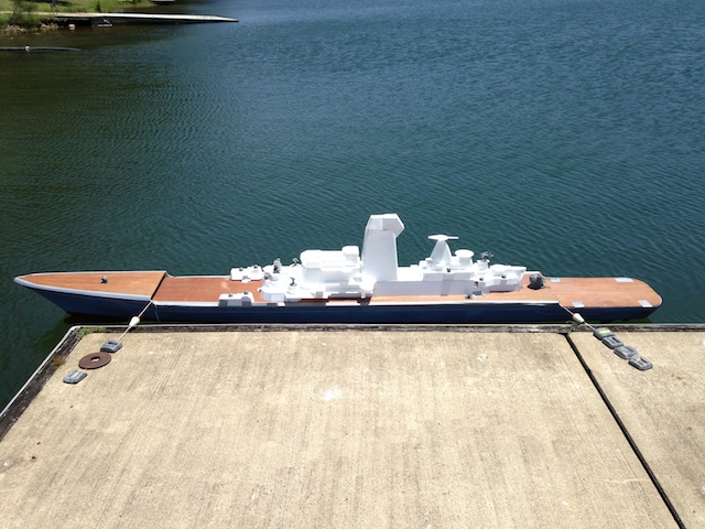

I took FRUNZE out today to test her for the first time in her natural element which for any model builder on a new project is a moment of anticipation and excitement.
Task Force 72's Fleet Base Sydney had a run at the Sydney International Regatta Centre at Penrith (which is a terrific place to sail model ships, I highly recommend it) and it was very nice to join the gents up there on what turned out to be a perfect afternoon of sailing.
I had the ship in the water for just under four hours and underway for a large proportion of that time to test her endurance and see if anything was not up to scratch. After making some minor adjustments to the ESCs and steering she performed superbly and she passed this first sea trial with flying colours. It was a big pay off following 7-8 weeks or so of intensive building.
At flank speed she does about 30-35 knots in scale speed, sails along very comfortably on a single main engine and handles choppy water with ease thanks to that elegant and beautiful hull.
There is still a bit of improvement needed in the steering gear. I'm going to make a larger (and slightly oversized) pair of rudders and modify the servo to provide a greater angle of attack. This should improve the steering a bit more and reduce the turning circles. This is aided even more by having independent main engine control. Not only is this a lot of fun, it also comes in very handy when in close quarters or confined waters.
With a successful water test run complete and a major milestone achieved I'm having a break for a week or two. Then the next jobs will be to do the modifications to the steering gear, make mountings inside the hull for the ballast, permanently mount the radio gear and ESCs, flow coat the inside of the hull and then permanently seal the decks in place.

Nice to see Penrith without weeds!! Looks like you had some good North Sea testing as well in one pic!
Cheers Bruce

Thanks Bruce, yes it was a nice day there and made better by our colleagues and their ships from Sydney.
There were a few weedy areas to steer clear of but on the whole it is a really terrific place to sail. The water is quite clean too which is always a bonus - especially when you drop your sunglasses into the water and have to swim down and get them (yes, I had to do this).
I'll look forward to running FRUNZE with your LONG BEACH one day. I think they'll make a nice pair.

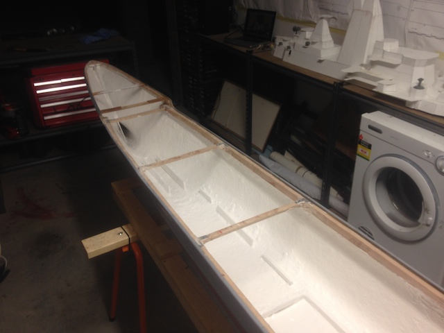

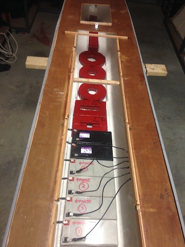

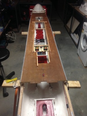

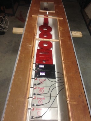

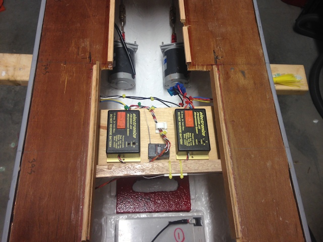

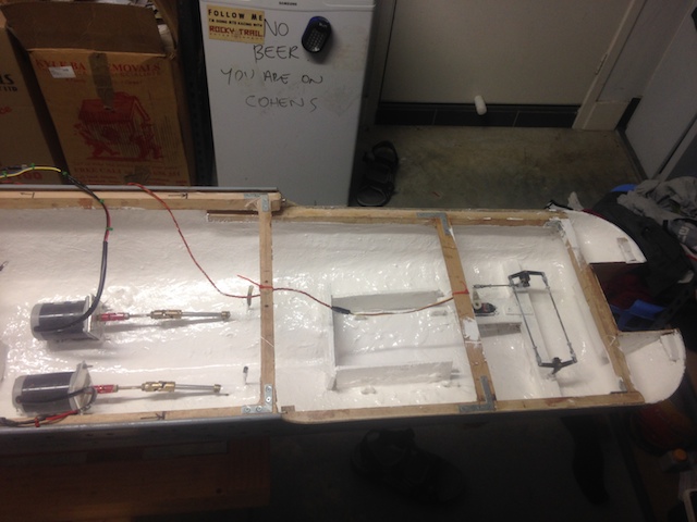

Update on FRUNZE. After having a successful and highly enjoyable first test on 29 Dec 2013 which proved the initial set up I have spent the last week or so making everything permanent inside the hull so the main deck can be sealed in place forever. The main jobs of note have been:
- Making cofferdams along the centreline to accommodate the 9 chunks of scrap mild steel that (with the batteries) ballast her down to full operating draft and trim, and fibreglassing everything in place. The ballast is the red objects in the photos below;
- Installing a platform for the ESCs and receiver to sit on below the aft superstructure where they are accessible;
- Designing the final cabling layout for ease of access and maintenance;
- Cutting out access holes in the main deck and fitting timber/plywood supports to lock the superstructure firmly in place (NB on the test run I used gaffer tape. Where would modern engineering be without it? That and WD40).
- Figured out where to put the ON/OFF switch. This is always a hassle. It needs to be accessible so you don't need to pull the model apart too much in the water just to turn it off (made that mistake once before), close to the batteries and ESCs to try and avoid voltage drop and excessive wiring and it must be sufficiently concealed from view. I've solved all of the above by putting it under the 130mm gun mount;
- Coating the entire hull interior in white flow coat. I was debating whether this is necessary but now its done I am glad I did it;
- Permanently fitting in the cable runs once the flow coat had sealed.
As per usual I managed to get more flow coat on me and my clothes than inside the hull and went through 3 paint brushes. So that went well. Lucky I had plenty of acetone available to clean it up afterwards.....
With the above completed I'm ready to fibreglass the decks permanently in place which will be the next major job, and the final major task on the hull. Then I'll return back to superstructure work again to commence all of the fine detailing.

All looking good mate! Well thought out wiring layout too!!
One question? why are you using the scrap steel as ballast?? (Did you have it easily available?) Lead would take up less room and weigh the same and makes for quicker setup/packup (In theory I have found it takes around 20mins(ish) to setup CGN9 and 15 to packup).
Cheers Bruce
PS Graham(Grumpy) Donnell uses dive belt wts as ballast you can get em in different wts too...
