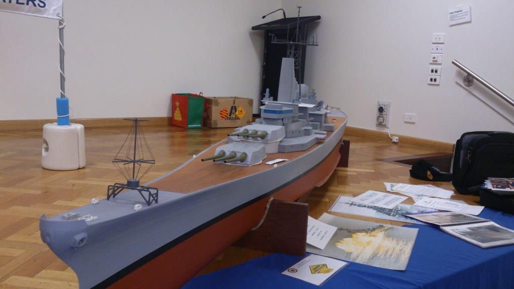

Here is my mates BB63 on Saturday....

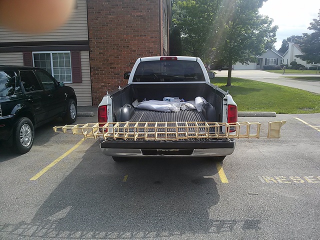

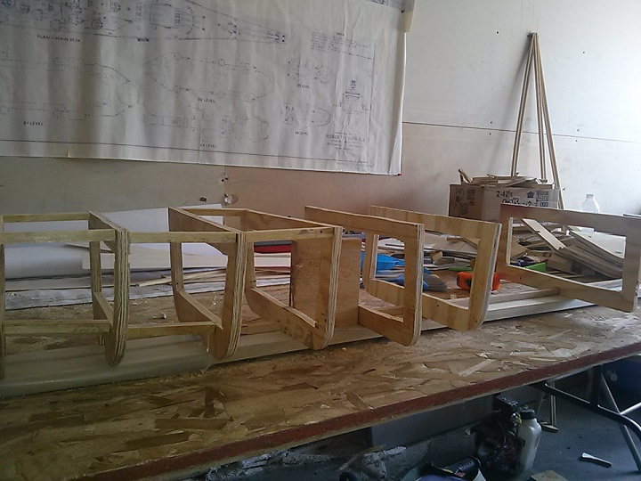

Time for a weekly update. Most of the frames are glued up from frame 220 thru 110 (11 frames cut out squared away), Should have the rest up tomorrow. Has anyone done a planking on the insides of a frame as well as the outside? also haven't seen this on the board or didn't find it, was to use Spay insulation like Great stuff to go in between the outer hull and inner hull. any thought on that. Will post pics tomorrow.

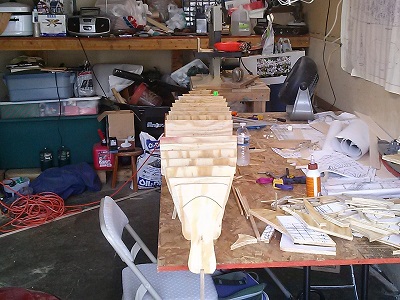

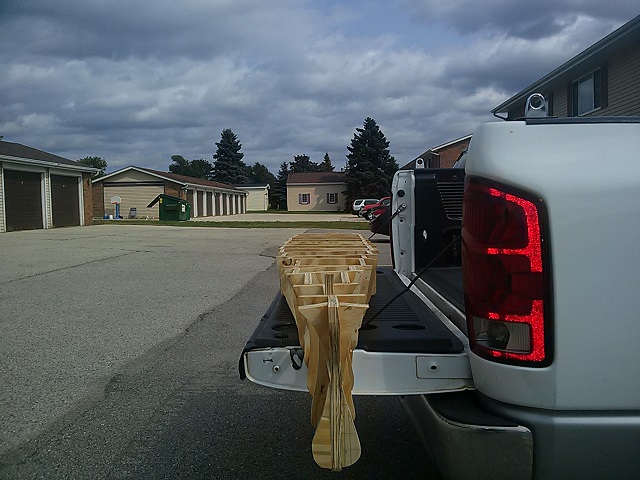

Here are the pics that I promised. Ignore the mess on my work bench
- start of the dry fitting of the hull
- 0712141534resize.jpg (75.61 KiB) Viewed 3820 times
