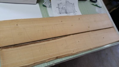

Re: 1/200 NEW JERSEY
Thank you, gentlemen!

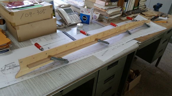

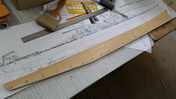

I've made the keel ,9mm thickness of plywood.
And attach 2 panels the both side of keel for prevent bending.
Song.

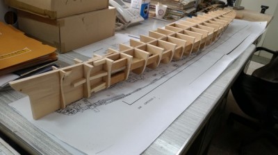

thank you,Tom and Jorge!

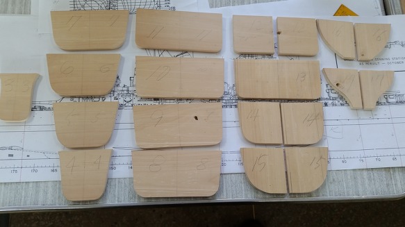

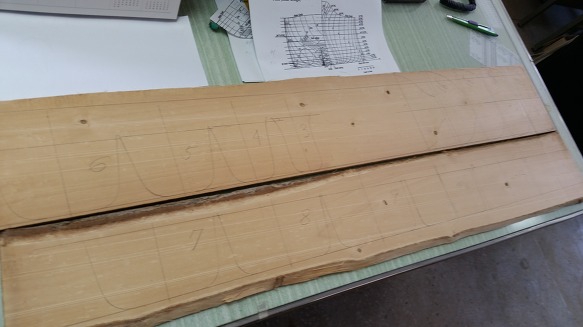

I've made ribs and attached the keel.
Song.
Song.

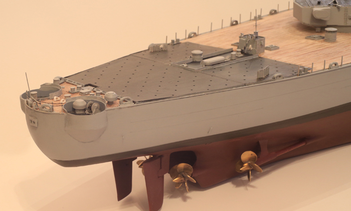

Please give us lots of hull pics... the hull shape (especially the stern) is a very interesting detail for those of us who are accurizing the Trumpeter 1/200 kit.

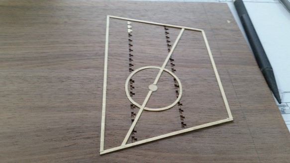

Thank you,Jason,Norbert!

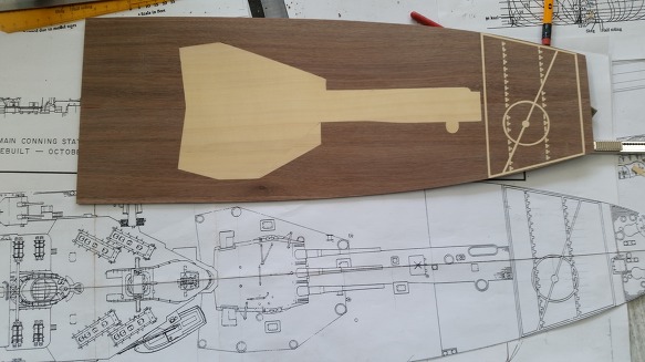

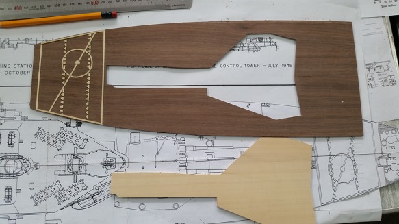

I've made main deck. I didn't want to painting on the helo deck.
So, I excavate on the walnut panel and insert the white color wood dn the slot.
The result is pictures.
Song.
Song.
- Goodwood
- Posts: 1257
- Location: Detroit area
That's a really awesome idea for conveying the differences in the deck between the WWII version and modernized version, yet retaining the natural wood. Damn Song, you keep thinking of ways to take us to school!

- Posts: 5068
Song:
The helo deck is itself suspended about 18" over the original decking, with a ramp that slopes downward to the main deck level. The extension forming the slot in the middle remains at main deck level and forms a recessed slot in the helo deck ramp. I'll see if I can find a photo taken aboard Missouri of this area, which is mostly the same except for the extent of non skid.

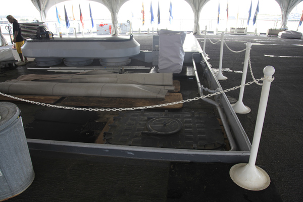

- Posts: 5068
This shows (WIP stage) the stern helo deck and how it is raised and ramped with the peninsula area with a low bulwark.

- Song Jung Gun
- Posts: 1631
- Joined: Sat Apr 26, 2008 5:21 pm
- Location: chun an city chung nam Korea
Hi Tom!
I always thank you. Yor advice is very useful for me.
I under stood your comments of helo deck as my scktch below.
Is it correct?
Song.
Is it correct?
Song.
- Posts: 5068
Yes that is a correct sketch. I have a number of photos taken aboard missouri in this area and will try to find them.
Best regards. Tom
Best regards. Tom
- Posts: 5068
Viewing the aft end, facing to starboard. Maybe 12"? over in the CASF IOWA's we could get Cliffy to measure it?
