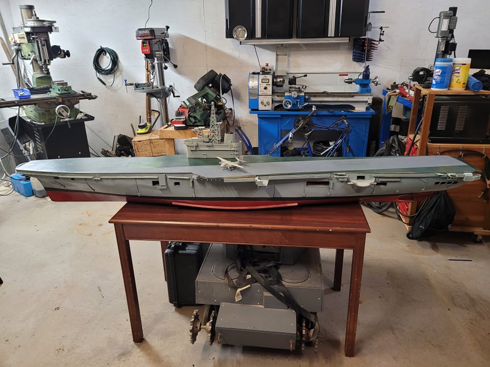

Good afternoon gents,
Long time lurker, not a regular poster...but I suspect that may be changing.
I recently purchased a partially complete model of the HMCS Bonaventure from a local gent that 'rescued' it. He is a professional builder, but usually of smaller scale ships and aircraft...this is a bit bigger than he normally does, so he was willing to sell it to me.
It has been, well, a while, since I built anything RC. I have an old 1/144 Graf Spee in the attic of my garage, and a 1/125 WW2 German Destroyer (Z-36) that I worked on a long time ago, but not much recently.
As 'inherited', the ship comes with props, shafts, hull mostly complete, superstructure somewhat complete, flight deck painted but not marked, and one S2 Tracker that came from Shapeways.
I've got the intent to get the ship in the water, with motors spinning and rudder turning before the end of December. Anything after that is detail...however, I realize that the heart of a CV is always its aircraft, so that's where I've started my project.
I've got a 3D printer, and in looking at the model, realize that I can do a lot of the remaining 'fitting out' and 'fiddly bits' with that, but decided to start with the air wing.
For awareness, I'm not planning a 'museum grade' model, I'm planning to finish this as a '10 foot scale' model - where, looking at it from 10 feet away, it looks pretty detailed, and pretty good. I'm not concerned about the 6 inch scale - is the fire-hose station in the right spot or is it an inch out? Does that hatch have 8 dogs, or just 6? Nope. I'm not that picky.

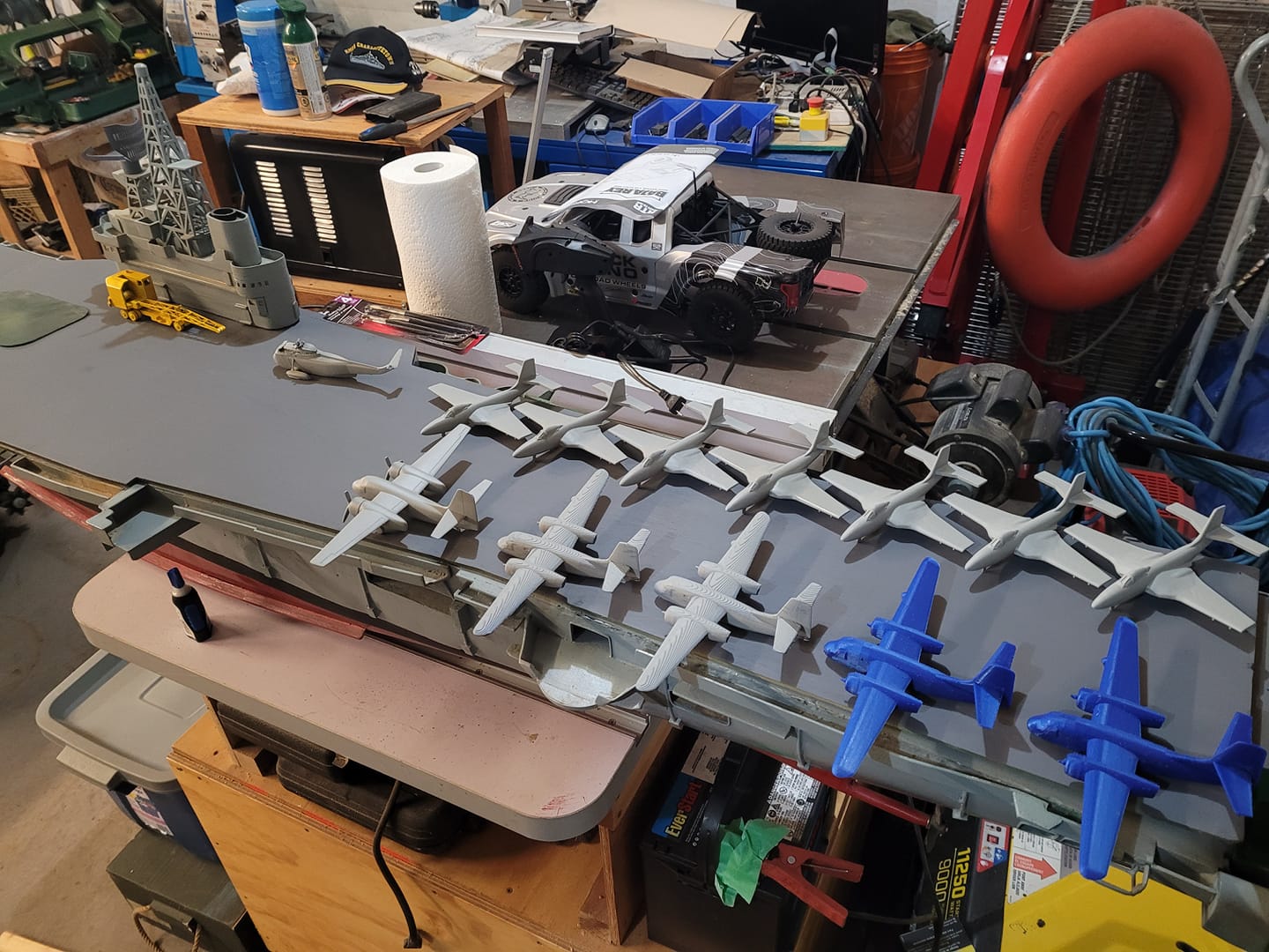

Well, a quick update. I have been doing a bit of 3D work and have managed to get 8 Banshees printed, and primed.
I'm expecting decals to show up this week, so I've put some work into the flight deck and may need to do some additional paint work to get things ready.
I spent some time today digitizing a 3D printed version of the ship's deck crane. My intent is to build a functioning deck crane - we'll see how that works. It's about 6 inches long in scale, and the base is about 1.5" in diameter. I'm pondering how to do that.
Here's some more photos.

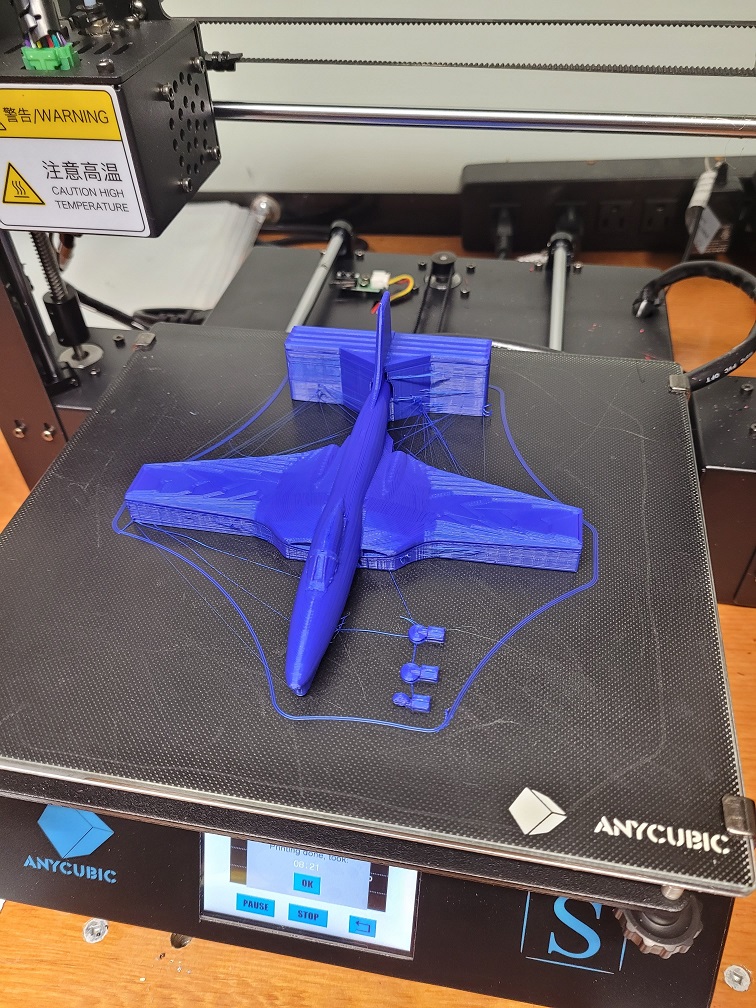

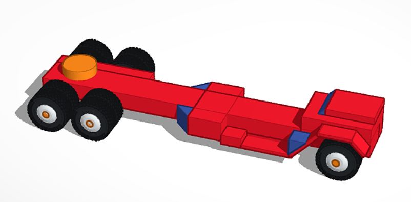

Well, Tried a test-print of the Tracker fuselage I got from my CAD guy last night - not very nice looking - a lot of artifacts in it. He's working the problem.
So, in the meantime, I've got a Ship's Crane printing right now, and this morning I designed the Ship's Recovery Truck in TinkerCAD and am reasonably pleased with the outcome.
In an ideal world, the back of the crane housing would be rounded, but if I print thick, and sand, I'll get some of that texture.
We'll see how long this takes to print tonight.

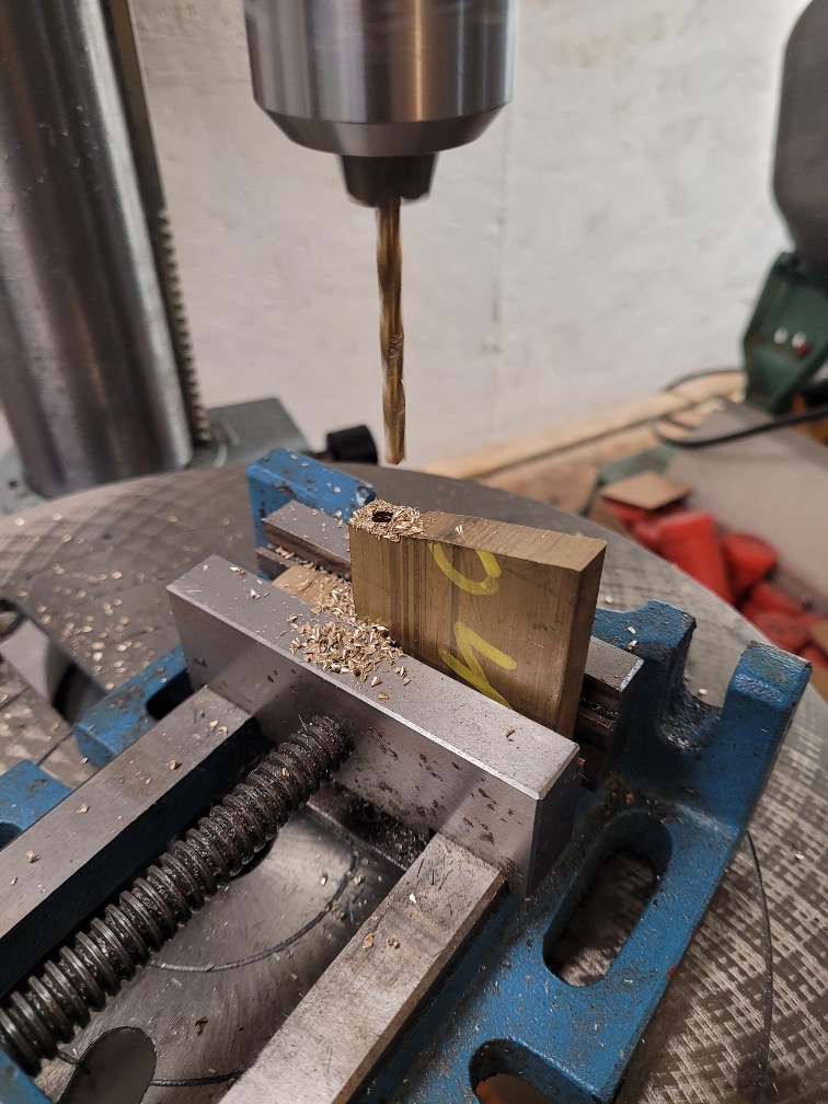

Last evening I decided to get the Rudder done.
Here's the progress - cut from a 3/8" block of brass.
ICBM Address: 44:78N 063:63W
PostPosted: Mon Dec 06, 2021 9:22 pm
Posts: 291
Location: Windsor Junction NS
The rudder got connected to a servo and tested this evening. Life is good.
Unfortunately, I was painting the flight deck too often as I tried to remove get a nice smooth clearcoat. I got greedy...and the result was that the paint below wasn't drying enough, and was causing the top layer to bubble up...and wrinkle/crinkle. So. I had to completely strip down the flight deck to bare wood and start over. I have 2 layers of primer on now. I'll add the green again next.
I 3D printed the crane mentioned above, and am generally pleased with it. It came out about the right size I think.
I've now got a good number of Trackers and Banshees, and have another couple of them in progress. Goal is an air det of 8 Banshee, 8 Tracker and 4 Sea King.

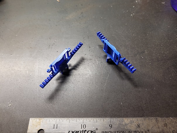

Over the weekend, I got the rudder functioning, installed a couple of motors, connected the shafts and I could, theoretically, put the boat in the lake tomorrow and see how it runs.
It will probably see water next weekend.
I've also added about 5 pounds of lead shot that I've fiberglassed into place in a few strategic spots along the keel. I know this ship is going to need some ballasting, so it seemed like a good idea to add some strength, and some weight.
I do plan to 'clip the wings' on a few of the aircraft and fold them for storage. One of my 'ideas' is to have a Tracker on the Forward elevator, have the elevator move up/down, and when the elevator gets up, have the wings unfold. I'm pondering how to make that work.
