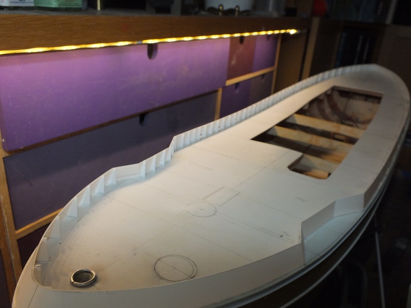

With the bulwarks now fitted the next stage was to fit the numerous stanchions on the inside. Using various reference photos the position of each was marked out on the deck. To obtain the angle of each stanchion relative to the deck a simple adjustable tool was made from plastic sheet which was placed against the upright bulwark. The tool was then transferred to a jig, also made from plastic sheet and the angle marked onto a strip of plastic. The angle was then cut and the back edge marked with a set square and also cut. The stanchion was then glued in place with liquid cement. The whole procedure was then repeated for the next one and so on.

With all the bulwark stanchions in place on both sides the top rail was added using strips of 3.2mm wide x 1mm thick plastic starting with the two anchor wells and working towards the rear. Around the bow the strip wouldn’t bend to such an acute curve so this section was cut from 1mm thick sheet to the required shape.
