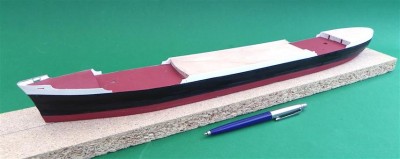

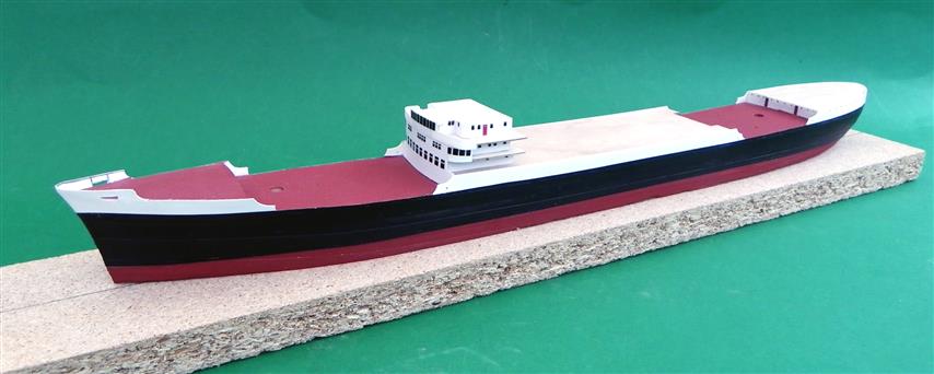

Scratchbuilding (in progress)
Bob
File comment: Ready to start
File comment: Looking a bit rough
File comment: Looking a lot better

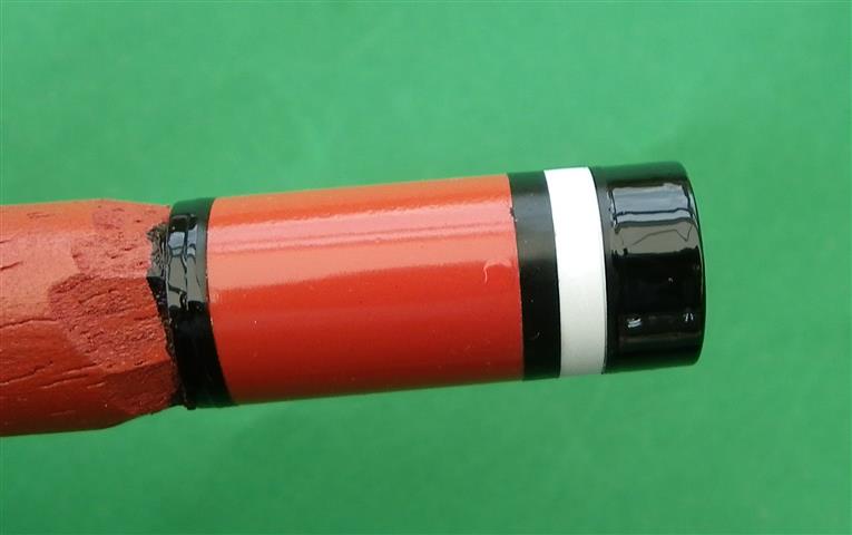

Jim,
I will first mask off the top of the funnel, and spray paint it with red oxide matt. After that is dry, I will spray paint it with vermillion on top. The reason I do this, is that the red primer tones down the vermillion a bit to give the correct shade. I will then mask the bottom part, and spray paint the top with black. Next, I will stick a white band round the black part. The white circle with the blue star on it will be produced in the compter with the drawing section of Word 2000. I will print it out on this, good quality white paper, cut it out, and stick it on. This method is very effective. The attcahed images show the Tuscan Star funnel being painted. The bracket on the second picture is so that I can stick the star on the top, turn it over and stick the star on the other side, knowing that they will be directly opposite.
Bob
PS Sorry for late reply, I didn't get a notificatuon of reply!
