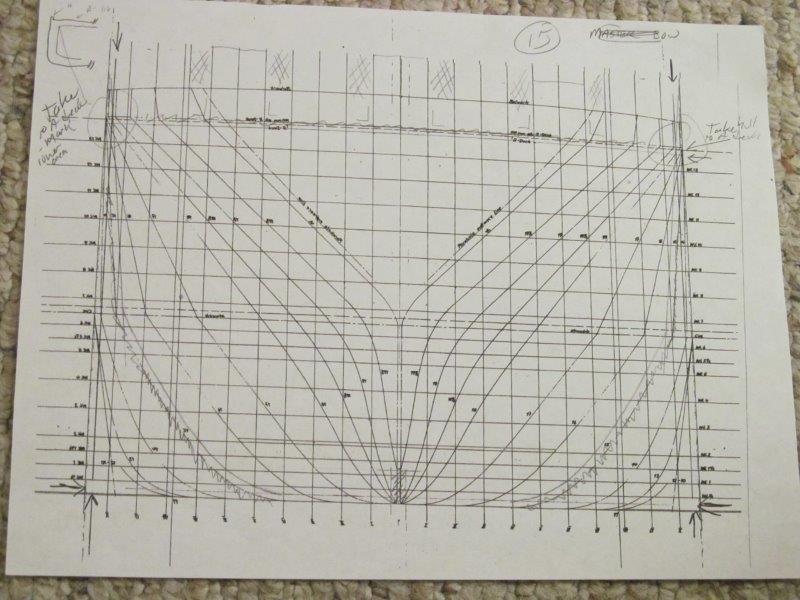

Author:  KimmerWerft [ Fri Nov 10, 2017 12:47 am ]
Post subject:  Re: 1/100 M/V AMBASSADOR (late 1980s)-stern ramp ro-ro for R
I am using the Body Plan portion of the Lines Plan for the frame shapes. There are 24 stations on the Body Plan, yielding 24 frames. I may have to create my own intermediate station lines near the bow and stern to get the correct shape, but to start will just use the 24 from the plan.
File comment: Body Plan
Only the “zero” Body Plan station (at the after perpendicular) has an equivalent on the GA plan, so I had to carefully transfer the station locations from the Body Plan to the GA plan to be able to work between the two. In addition, the “A” deck (the upper-most deck on the stern, which essentially runs the length of the ship to the bow) will form the upper limit of my frames and has a significantly rising sheer towards the stern, resulting in about half of the frames having a deck height different from any other frame.
I combined a reverse image with the normal image of the Body Plan to come up with the full frame shapes. The “A” deck height was taken off of the GA plans for each station and marked for each frame.
File comment: Stern frames Master (rough)
I then reduced the dimensions of each frame to account for the thickness of the planking and coating that I intend to cover the hull. Modifying each frame plan by hand with dividers was more tedious than I expected.
File comment: Frame 15-marked up
(For a more modern—and no doubt more accurate—approach, see the current build log on this forum for the 1/24 Clyde Class Lifeboat, using building plans created with CAD and ribs and keel cut with a CNC router—nice work!)

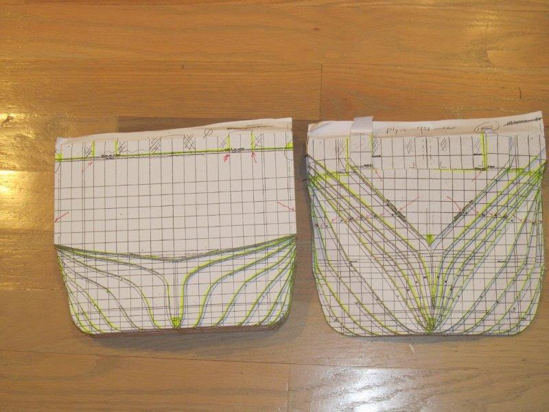

Author:  KimmerWerft [ Tue Nov 21, 2017 10:38 am ]
I made a working copy of each completed frame station in the event I ever want to do this again or, more likely, that I tear or otherwise damage the paper pattern while working with it. I then cut each frame station pattern to roughly the same size with a horizontal cut at the bottom of the frame and vertical cuts at the extreme width of the frame.
File comment: Frame stations cut to size
Each frame plan was then glued onto ¼” plywood using white glue (Elmer’s in the US) thinned 50-50 with water.
(When first considering scratch-building a ship from hull lines I thought that I would have to trace the completed lines onto the wood before cutting, which I was not looking forward to. Some years ago I got to look inside a beautiful scratch-built RMS LUSITANIA and saw the remains of the paper hull lines glued onto the framing material and immediately thought--Aha-that’s how it is done!)
File comment: Frame stations glued to plywood
I pre-cut the plywood into uniform smaller pieces to make gluing, handling and cutting each frame easier, although it no doubt was not the most efficient use of the wood. I also marked the lines that I need to cut with a high-lighter pen so that it is easier to keep track while cutting.
Another tip—you might also consider using heavier than regular copy paper for this step. When I first started gluing I found that I had to be very careful to keep the paper from getting bubbles, creases or distortions. I then copied the remaining frame stations onto slightly heavier paper (28 pound rather than 20 pound) and it was much easier to glue the frame stations to the plywood without problems. I might try slightly heavier paper than the 28 pound for this step if I make another scratch-built hull in the future.
