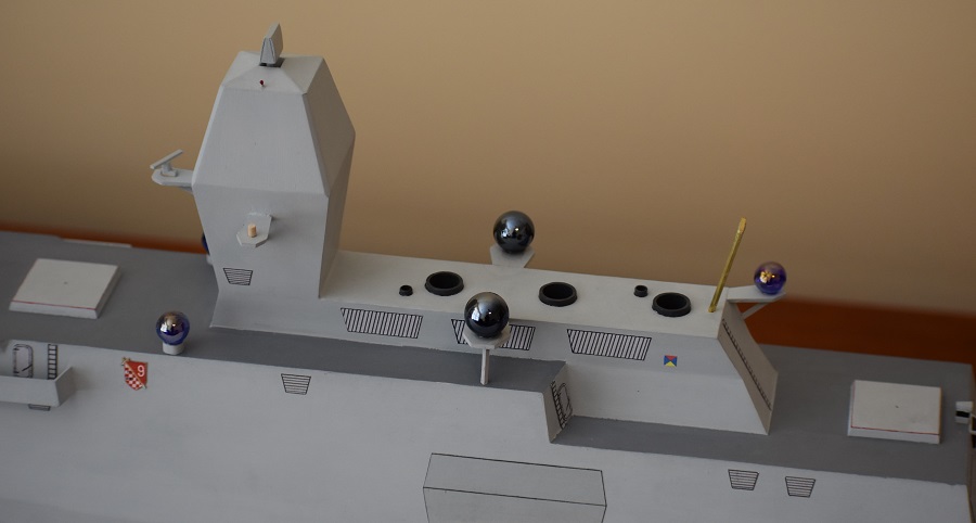

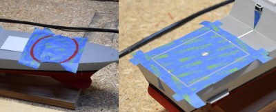

Here are some photos showing my progress in painting details that are better done before the decks are cluttered with stuff.

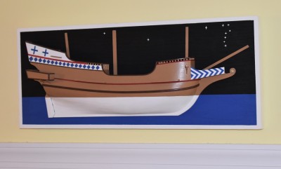

Between major projects, or in the middle of a really difficult project, a half-model can be a simple and enjoyable distraction. They are (relatively) quick to make since you're only making half, and they are generally focused on the hull without the detailed finish work. They can either be hung directly on a wall or be mounted via a board that can be decorated. They also lend themselves to display in places that would otherwise remain empty. I like to put half models above doorways.
Unlike traditional half-models which are carved from boards glued or pegged together, I make mine plank-on-bulkhead. It's what I do.
My references for the Balao class fleet sub were the Historical Naval Ships Association for a booklet of general plans, and Navsource.org for photos and the wartime letter of instruction for submarine camouflage. Information on the schooner came from Howard I. Chapelle's book The American Fishing Schooners 1825-1935, published in 1973, which I picked up at Mystic Seaport Museun in the mid-1990s. Images and information on Elizabethan galleons was from a Google search which I failed to document.

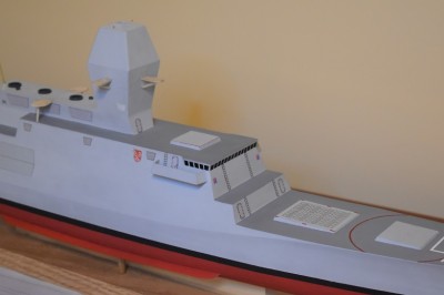

Continuing to work through the long list of details to be added for a finished model. The watertight doors, vertical ladders, engine intake and ventilation grills, and DESRON 9 crest are all images from the 2D printer.

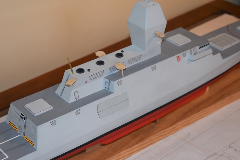

I haven't had much time to work on the model over the last month. Here's some progress on the details. The bitts and chocks are made from index card and scrap wood. The satcom domes are glass marbles. The main gun mount and the two radar antennas are cannabilized from FFG-62. I'll also be reusing one of the anchors, which isn't attached yet.

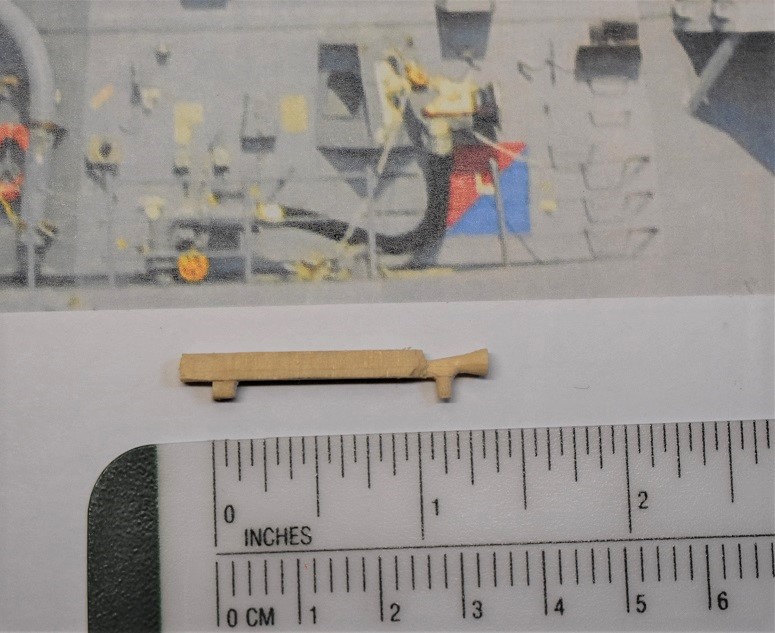

I am whittling a couple drogues for a refueling at sea rig. The right side of the piece is a partially completed drogue. The left side shows how it started, and will become a second drogue. The hose and pipe will be made from brass rod.

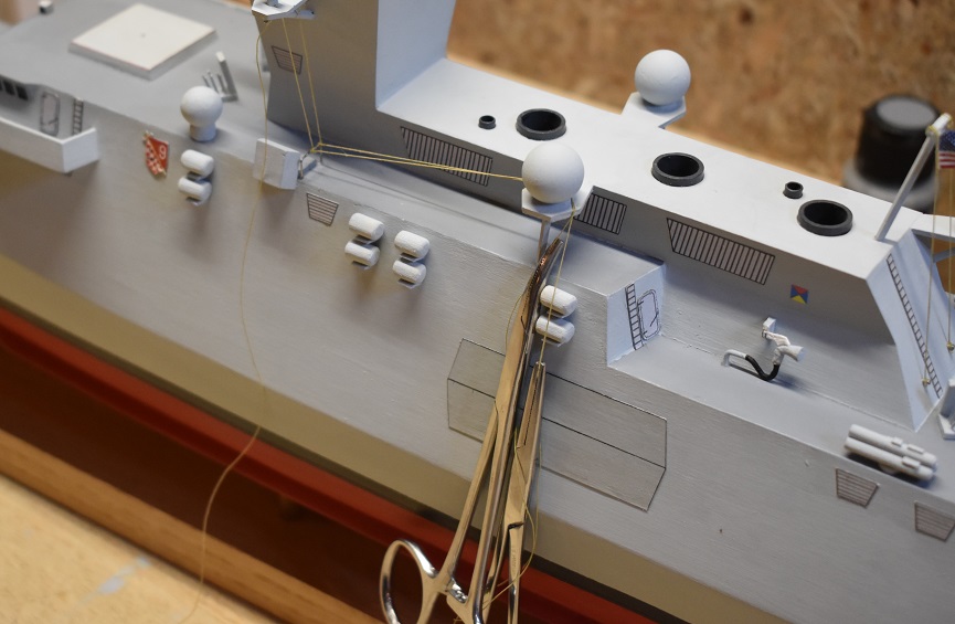

Keeping the signal halyards taut while the glue dries.

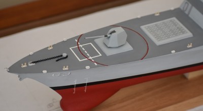

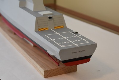

The USS SAMUEL B ROBERTS (FFG-63) is now complete except for PE lifelines and safety nets. Those will happen when I've experimented with technique on the previous FFG-62 model.

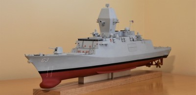

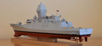

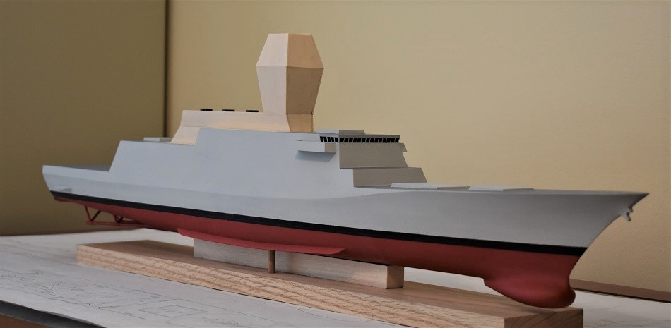

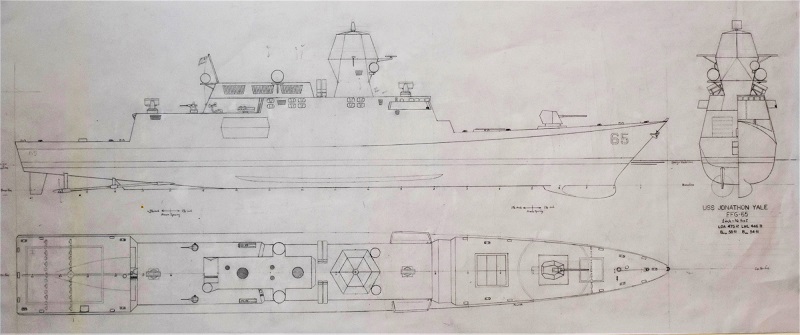

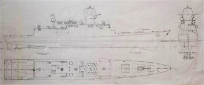

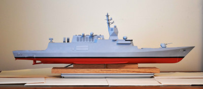

I cannot stop thinking about the FFG Concept and have continued to draw variations since finishing my FFG-63 model in 2018. I was pleased when the Fincantieri Marinette team recently won the contract for the U.S. Navy’s new frigate and my latest drawing is a good cross between the FFG-63 model and the Italian FREMM. The two photos contrast this new design and the FFG-63 model. The ship has been shortened by 10 feet to 475 feet overall to better match the FREMM. The radar tower was lowered by 10 feet compared to the FFG-63 and the upper section is hexagonal instead of square.
I absolutely refuse to accept a 57mm main gun for a ship this size and am sticking with the 5-inch 62 caliber mount. I did compromise with 48 vertical launch missile cells, splitting the difference between 64 on the FFG-63 and the US Navy’s requirement for 32 cells. That was mitigated by adding 8 cannisters for the Naval Strike Missile in a gap between the radar tower and the stack. I had previously assumed that the anti-ship missiles would be part of the VLS loadout. But for now, the NSM has no provision for vertical launch.
The FFG-63 model included two imaginary combined gun/missile close-in weapon mounts, above the pilothouse and above the hanger. The Navy wanted a RAM launcher instead, so for realism this time I put a 21-round RAM launcher in each of those locations. I also added two remote 25mm chain guns above the hanger since the real ships will have 25mm or 30mm guns installed regardless of the minimum contract requirements.
The new drawing is named USS Jonathan Yale (FFG-65). Corporal Yale was one of two U.S. Marines who gave their lives in Ramadi, Iraq in April 2008 while defending their shipmates from a truck bomb. Their story can be found here. https://www.businessinsider.com/john-kellys-speech-about-marines-in-ramadi-2013-6
I’m not sure if I will actually build this model or just be satisfied with the drawing. Stay tuned.
