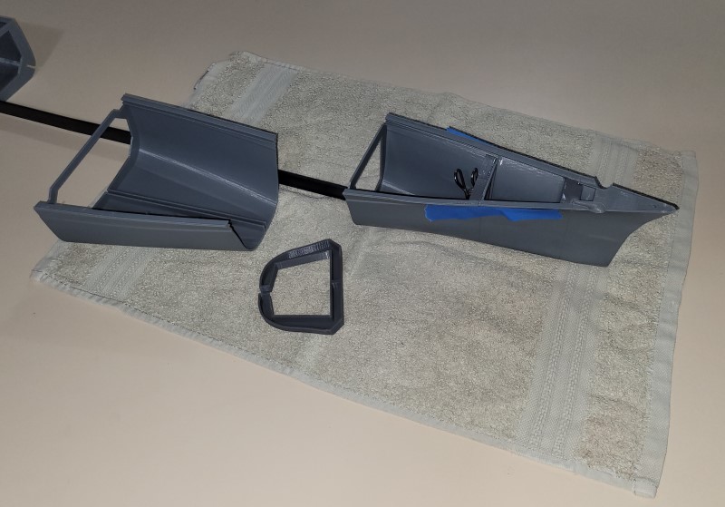

As an example, between the Hull Piece 1 and Hull Piece 2:
File comment: Hull 1 and 2 Pieces
Becomes
File comment: Hull 1 Glued

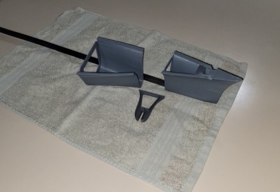

So, the steel keel support is a flat steel bar 3 X 20 mm, 1055 mm long. The angled cut-out at the rear is to accommodate the centre prop shaft and housing for an RC version.
File comment: Keel reinforcement bar.

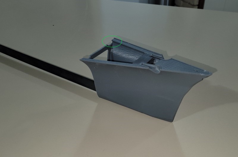

BTW, in case you were wondering, I have been at this for around 2 months now. Currently the model looks like this:
File comment: Current Status 1
File comment: Curren Status 2
It is currently held together by gravity, friction and 2 pieces of masking tape so I really need to start putting it together, hence this build log.

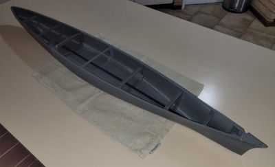

Finally, the hull is complete:
File comment: Hull Completed!
For securing the hull sections in place I tried:
    Super Glue
    2 Part Epoxy
    3D Pen
And the winner is (by multiple furlongs AKA Country Mile).....3D Pen!
In terms of part join strength its remarkable. The hull parts deform and collapse before the join fails (I had a few spare hull parts to destructively test), and I haven't seen a join fail as yet. It sets quickly and is fairly easy to control.
The Only issue I have is that I find my current pen feeds filament too quickly (you want to make sure the parts to be joined get fairly gooey so the pen needs to move slowly to spread the heat around) and only has three speed settings, so I have ordered a new one with 8 speed settings. Hopefully that may get around the problem.
Definitely thinking of making future designs 3D pen friendly for jointing.

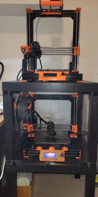

NS: I certainly do like the MK3S+:

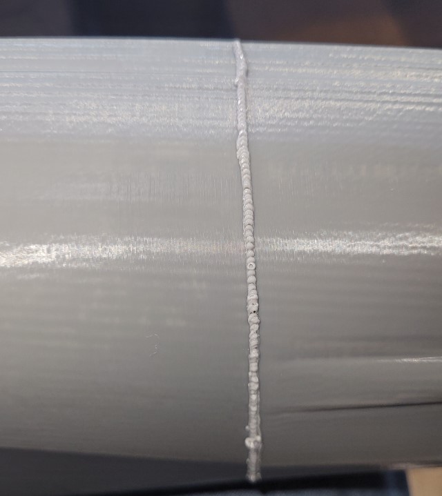

I forgot to mention I also tried friction welding with a rotary tool and UV resin. They all have pros and cons, but I'm fairly happy with the 3D pen results so-far.
Here is a gap that needs some work (Sorry to hurt your eyes like this):
File comment: Ugly gap
With my preferred amount of preparation (none) a weld bead is inserted:
File comment: Weld Bead
I could choose to leave my "stack of dimes", like any good welder should, to demonstrate to the world how amazing my welding skills are :whistle: but craft side cutters are a better option in this case:
