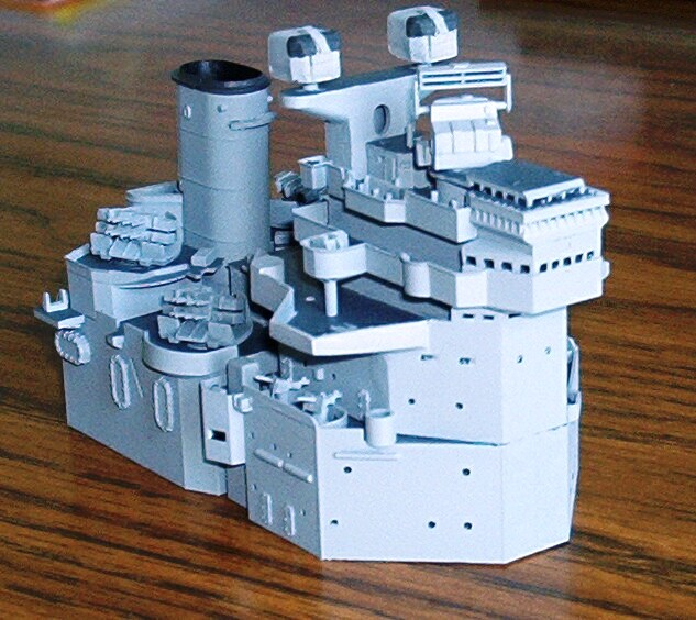

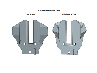

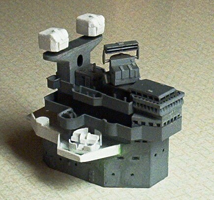

The ships of the UK's World War II-era King George V class are handsome ships with terrific service records. Like many warships, each is slightly different in appearance. HMS Duke of York is best remembered for her part in the sinking of the German battleship DKM Scharnhorst.
Inspired by Kjetil Lindahl's superb 1/350 scale late-war King George V, I had nearly completed Tamiya's excellent 1/350 scale HMS King George V kit but then decided it would make a great conversion project to create HMS Duke of York as she appeared in late 1945.

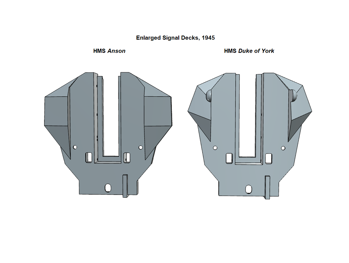

The most significant differences between DoY and KGV include an enlarged signal deck on the bridge superstructure, different directors for her secondary armament, an enlarged aft stack platform, six additional quadruple PomPom mounts, and a different 20mm Oerlikon fit. [edit: this structure has since been replaced with one of more accurate "pointy" shape.]
Armed with good photos and plans, many of which were provided by modelers on this website (thanks, gentlemen!), I created a master for the new signal deck, directors and PomPoms from Evergreen styrene. I then cast copies from resin.
I felt that the Tamiya kit's deck fittings were simplified and detracted from the appearance of the model. Duke of York's deck was a menagerie of fittings, elevated vents and intakes that really would be fun to try to replicate. I also wanted to lay down scribed V-groove styrene deck for a good planked effect and to rid the kit from the ugly seams between the three kit deck sections.

wow that was a quicky!!! Good job i like it alot.

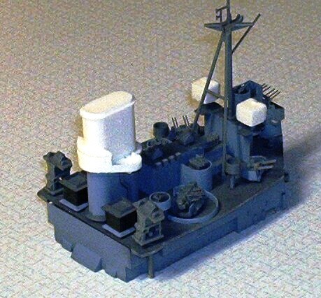

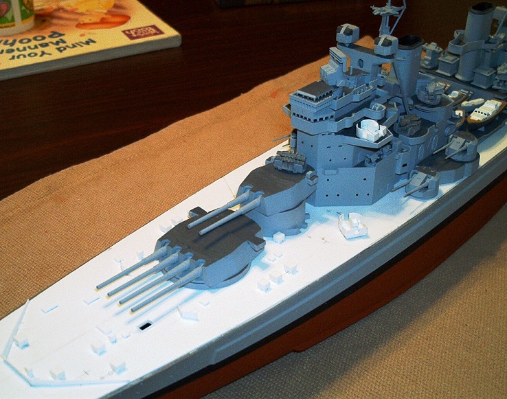

September, 2005.

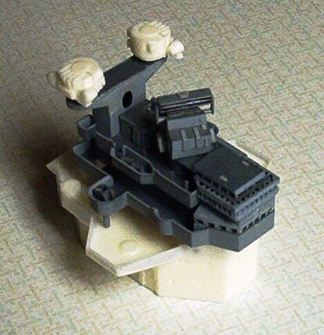

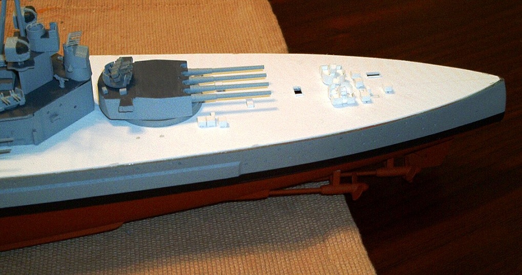

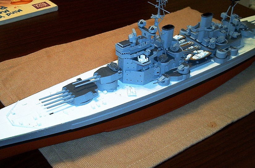

Here are some pictures with the deck fittings such as vents and intakes at about 80% complete. Also, major superstructure components are laid out including quad PomPoms (minus barrels and ammo racks), Mk V Directors, extended aft funnel platform, fore-most breakwater, winch breakwaters, deck hatch openings and relocated turret-top ammunition lockers as they appeared on DoY.
By joining the V-groove sheet polystyrene deck at points hidden by structures such as the breakwater at Turret B, I was able to avoid the very noticeable, nasty seams between the kit's three main deck parts.
[edit: all of the cast resin parts see in the photos below have since been replaced with more accurate and better detailed 3D-printed parts.]

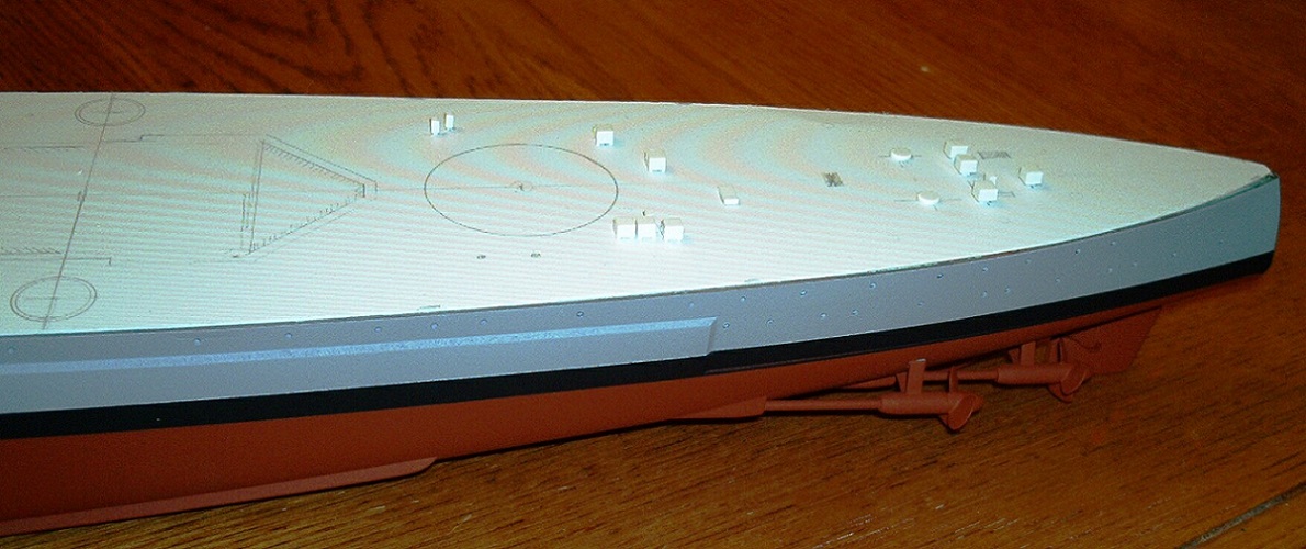

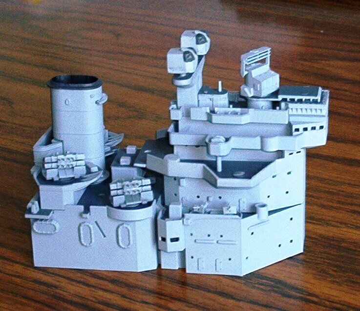

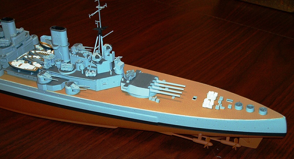

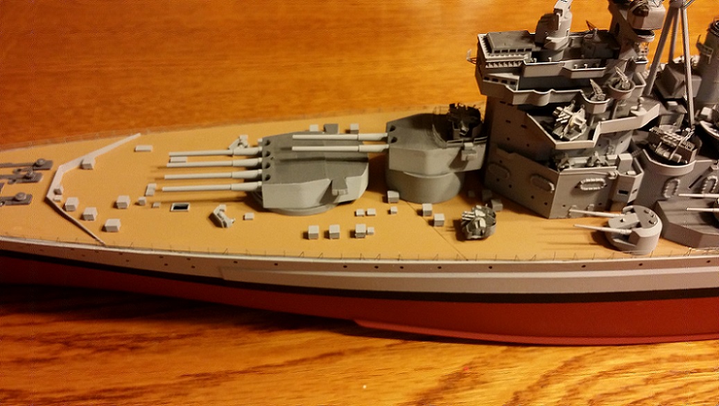

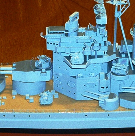

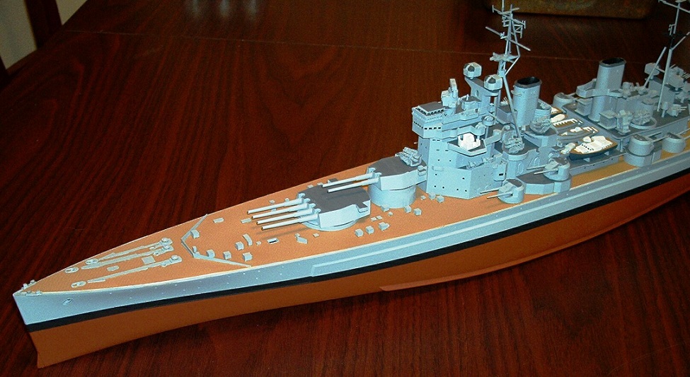

November, 2005.
Here are a couple pics showing the painted main deck. Once weathered it will look lighter and more gray. I am not sure what color the anchor chain skid plates should be or the chains themselves so any help here would be appreciated.
Some of the features unique to Duke of York are visible. Besides the new signal deck and nearly complete quad PomPoms, notice the twin, powered 20mm Oerlikons on the forward stack. These are kit parts relocated from the discarded KGV signal deck that were no longer needed there. The single 20mm fit generally is different as well although exact locations for 1944-45 are difficult to confirm.
The model is almost ready for photo-etch. There are still many deck details yet to be installed such as another pair of breakwaters, cylinder vents, winches, breakwater fillets, anchors and chains, bollards and chocks, etc. But I'm getting there.
The red hull is red automotive primer purchased from an auto parts store sprayed from a can. I like the way automotive red primer replicates real anti-fouling red. Boot stripe: black automotive primer sprayed from a can. Gray hull: gray automotive primer sprayed from a can. I used automotive primer on the hull because it looks great and gives the hull a
tough finish that handles well.
The hull was painted before the decks were installed. Red primer was sprayed first. The boot stripe was painted rather unconventionally. I think most modelers paint the red bottom and gray upper hull then finally mask off and apply the boot stripe last. Rather than that method, I tried painting in this order, red, black, then gray upper works last. I taped off the red with Tamiya masking tape along the bottom of the boot stripe then sprayed black primer all above. After the black hardened, I taped off the boot stripe top and everything below and sprayed gray all above that.
The decks and superstructure are all airbrushed with ModelMaster Acryl using a Badger 200 I have had since I was 13 (that's 31 years ago). Trusty old Badger!
I have four small, curious kids so I use non-toxic acrylic almost exclusively now when indoors.

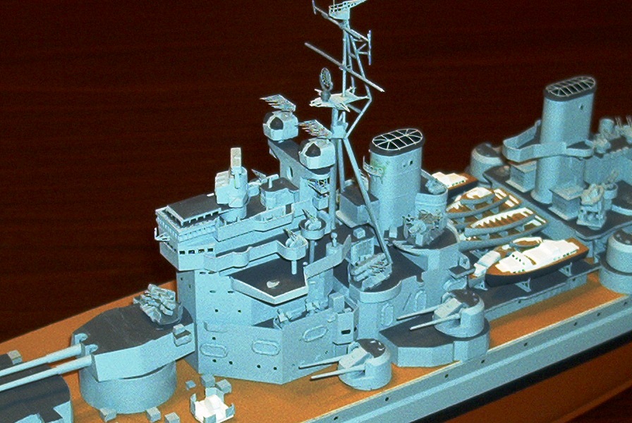

January, 2006.

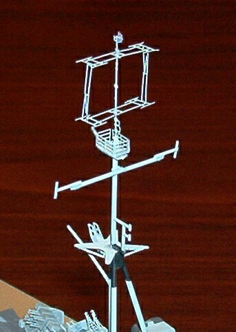

For Christmas, my wife Cathy bought me two PE sets including WEM's Ultimate King George V set. What Loren Perry did for Tamiya's Missouri, WEM did for all the ships of the KGV class. Unique parts are included for each ship of the class. Although the photographs do not do WEM's set justice, here are some of those parts installed on Duke of York.
- Funnel grills, fore funnel walkway, and foremast and director radar aerials. Look closely under the Mk V Director platform, you can see the maintenance catwalks. Compare the two octuple PomPoms next to the funnel: the forward PomPom is OOB but the aft PomPom at the base of the funnel has WEM parts installed.

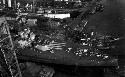

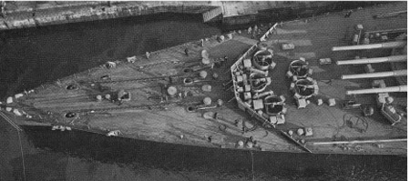

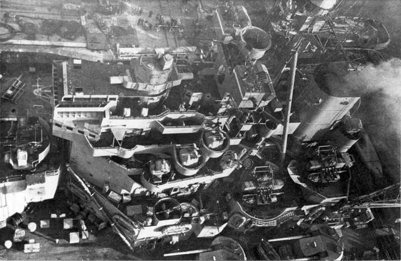

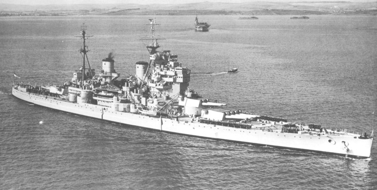

DoY did carry the midships aircraft catapult in 1943. Peter Beisheim built a fantastic DoY in 1/200 scale in her December 1943 fit. Photos of the model found in the link below may prove better than a drawing:Solomo wrote:Hi Steve:
I have a 1/700 Tamiya PoW that I'd like to convert to DoY in her Dec. '43 configuration (you can guess why).
Do you happen to know of a good source for a drawing illustrating the changes needed? I believe DoY still had the midships catapult arrangement and the extra secondary aa bridge wings at the time, but not the full '45 Pacific aa fit.
Thanks !
PTH
http://www.bismarck-class.dk/shipmodels ... sheim.html
Here are a few pics of DoY in 1943. When compared to KGV or PoW, you can see there are many detail differences. And, of course, she does not yet have the enlarged signal deck and increased AA fit.

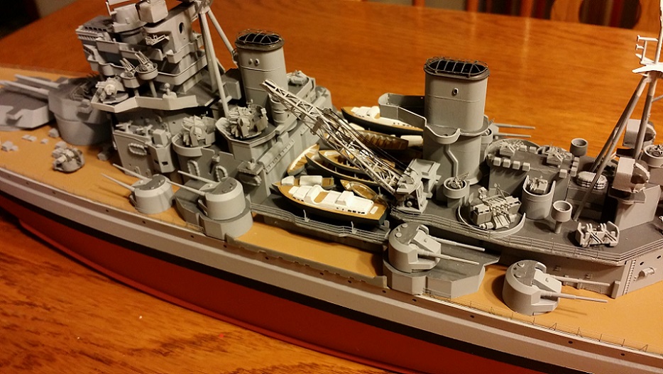

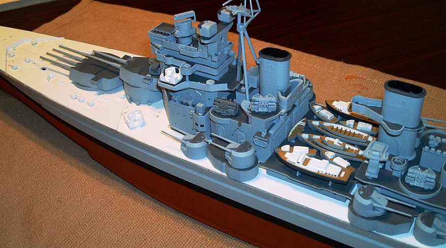

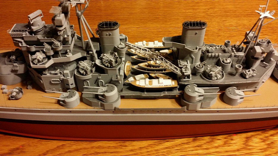

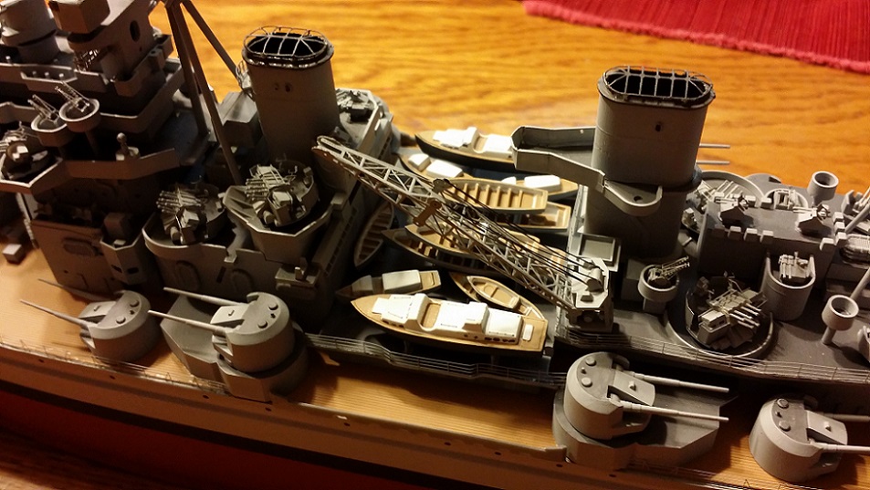

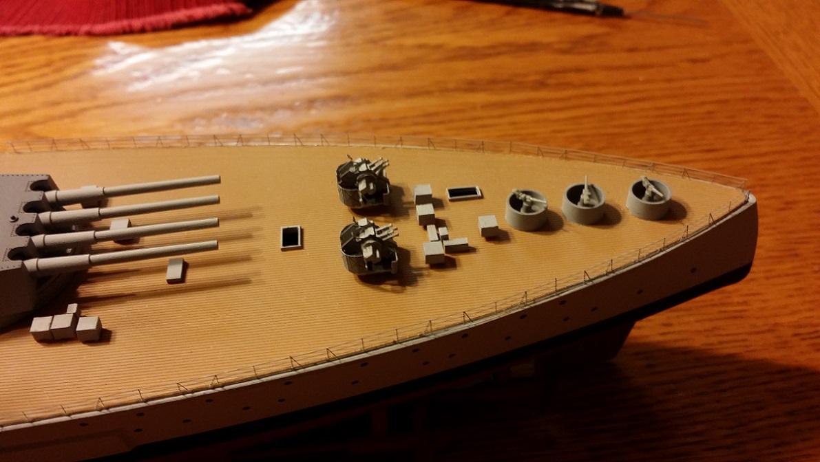

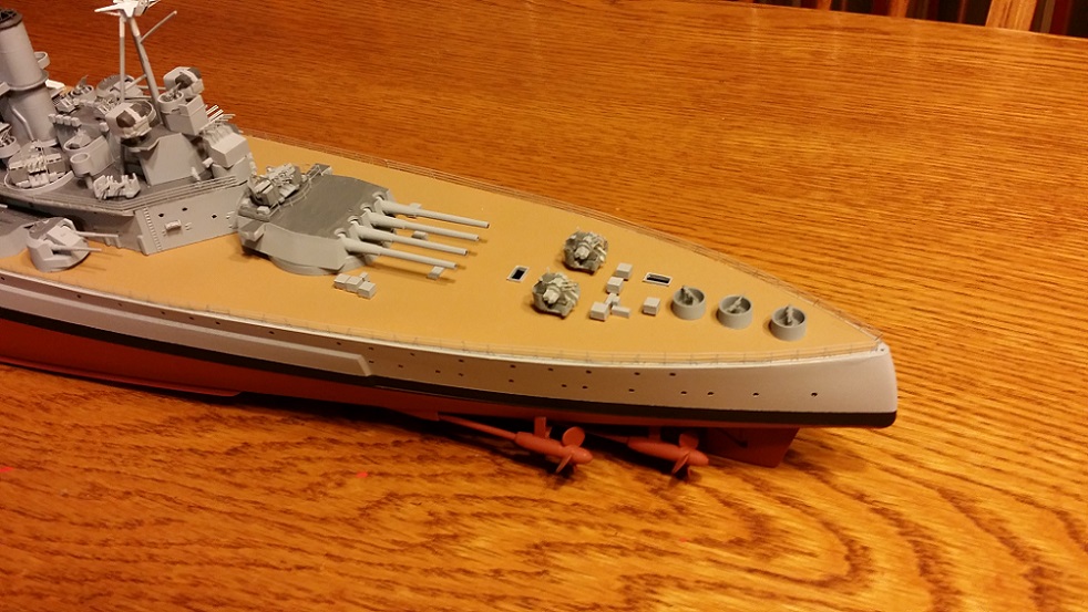

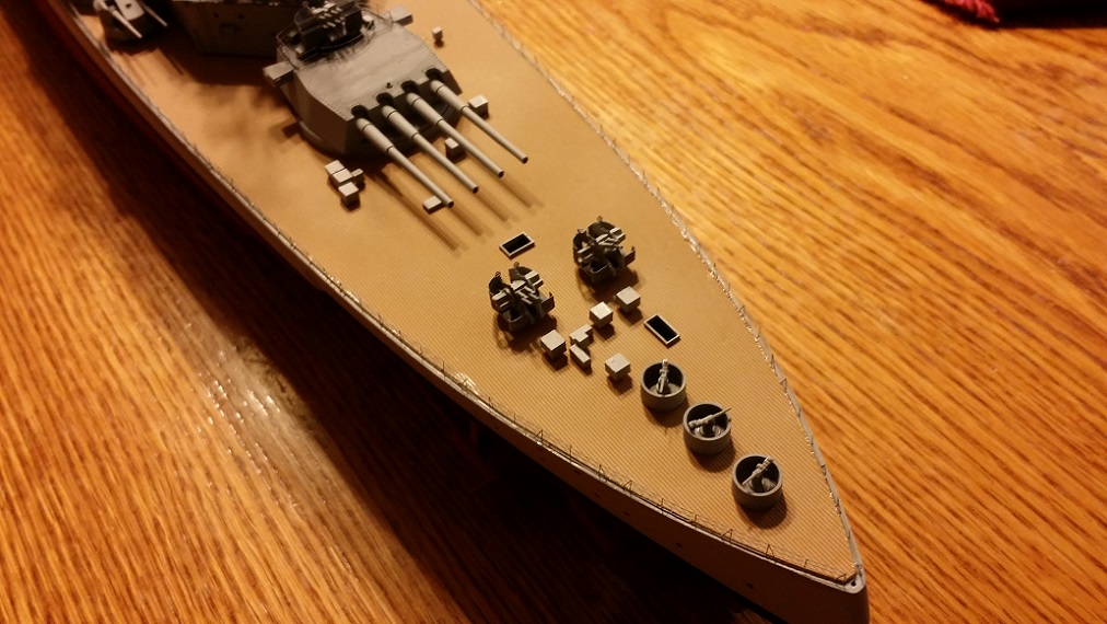

Some more work done.
1. Detailing of the octuple and quad PomPoms is underway. The WEM resin barrels are very fragile, as were the plastic kit parts, and I have broken off some accidentally. Broken barrels are difficult for me to repair. Doh. Now if I could just persuade EJ Foeth to send some of his PomPoms...
2. The port boat handling crane is now about 50% complete. It's not yet mounted, just placed into position for photo purposes. The WEM PE crane parts are very good (nicely rendered, not too fragile) and it was not difficult to give the cables a realistic under-tension-but-with-subtle-sag appearance. Photos of actual cranes indicate that even with the cranes elevated with their associated cables under considerable tension, as is depicted here, there is a bit of sag noticeable.
3. The funnel grills, each also known as a "Grande Arche", have been adjusted for a better shape. They still need some tweaking but look much better than they had. Thanks to EJ Foeth and his HMS Hood for some inspiration with funnel and PomPom detailing. To see some world-class scratchbuilding, see EJ's Hood here: viewtopic.php?f=59&t=104121
With the model in partial shadow, the raised effect of the deck vents is more visible making the effort to build them worth it and definitely an improvement over the kit's vents molded as very flat squares on the three deck parts.
- Good sag on the crane cables. In the area between the boat deck and the edge of the main deck will go four 20mm single Oerlikons on each side of the ship. The quad Bofors on the real ship were probably unshielded so the shields seen here on the original Tamiya kit's quad Bofors will be removed. I'll probably replace the Bofors mounts entirely with L'Arsenal resin mounts.
- The location of single Oerlikons is only partly known. Alan Raven's "British Battleships of WWII" was key in determining DoY's 1945 AA fit. But even Mr. Raven had difficulty in researching the precise location of all of the 20mm mounts. He was able to find the total number of single Oerlikons on board at the time but could only confirm the location of some of them. These three locations are specified in Mr. Raven's book.

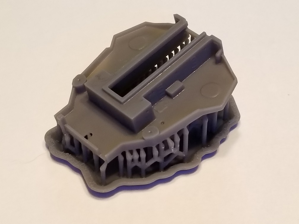

Re: 1/350 HMS Duke of York (1945) - modified Tamiya KGV

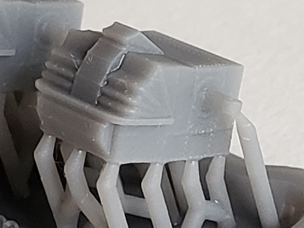

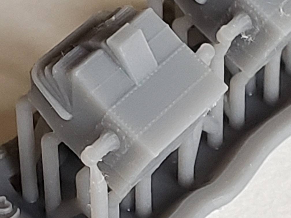

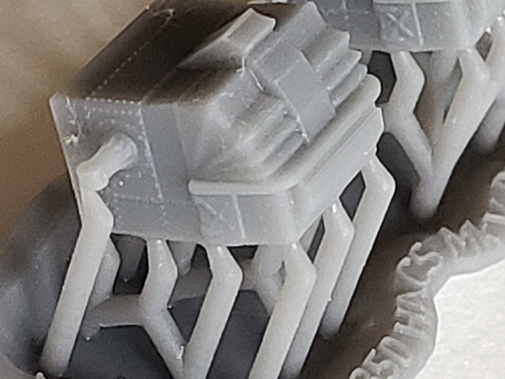

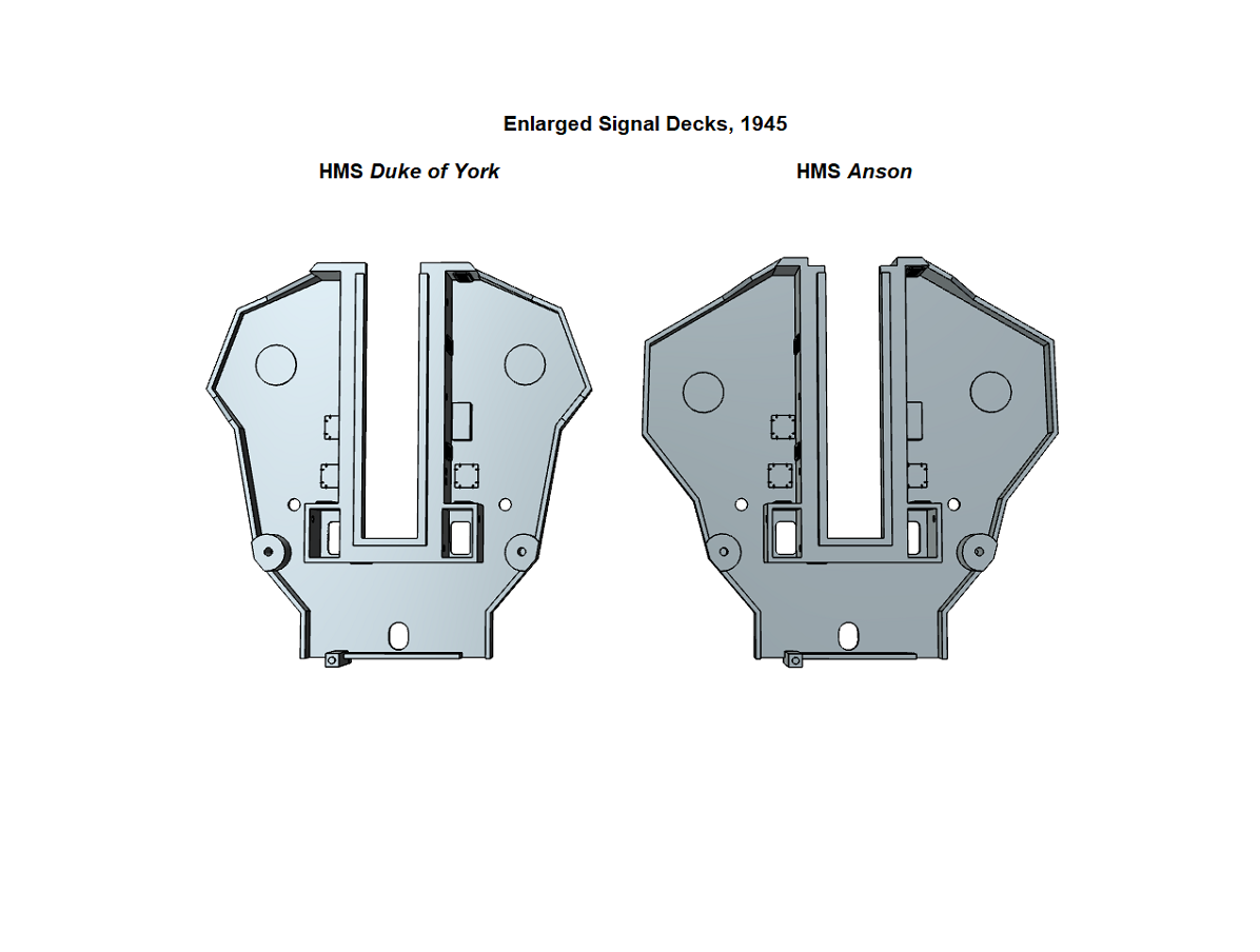

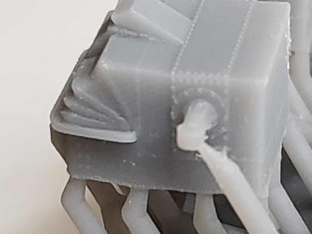

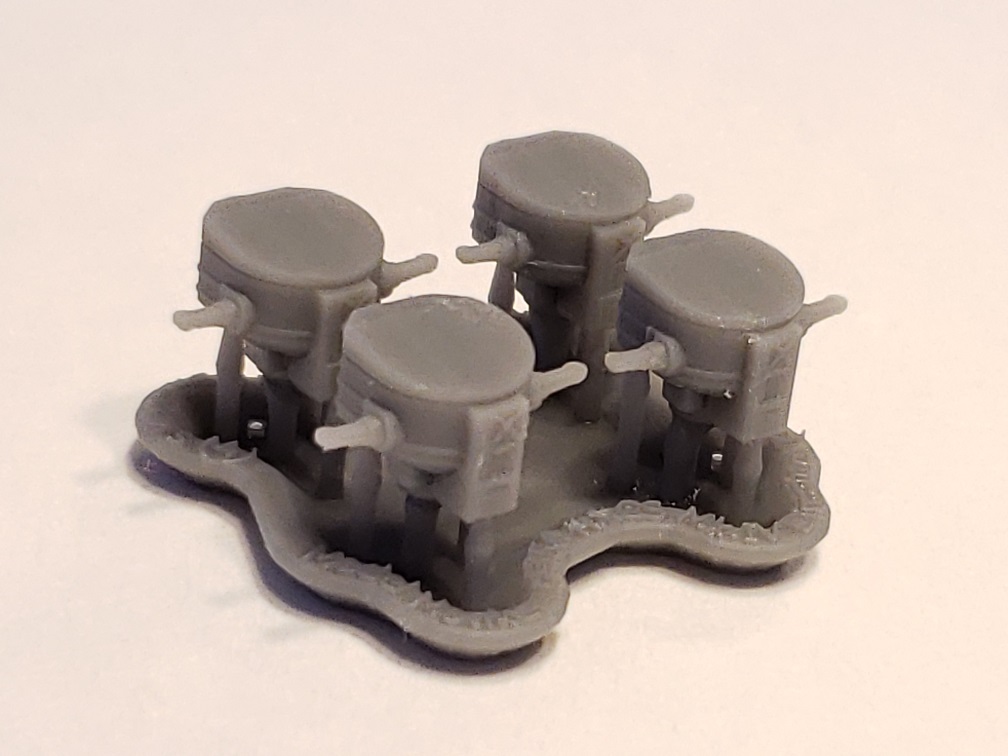

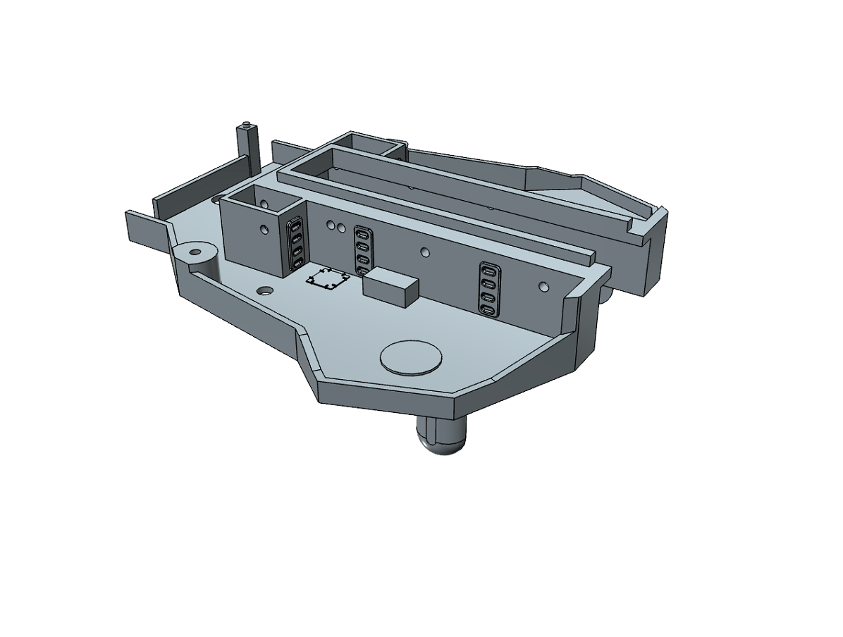

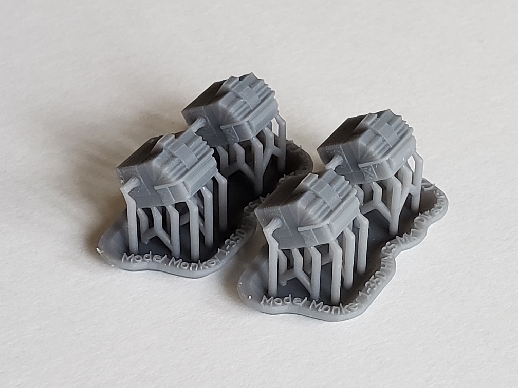

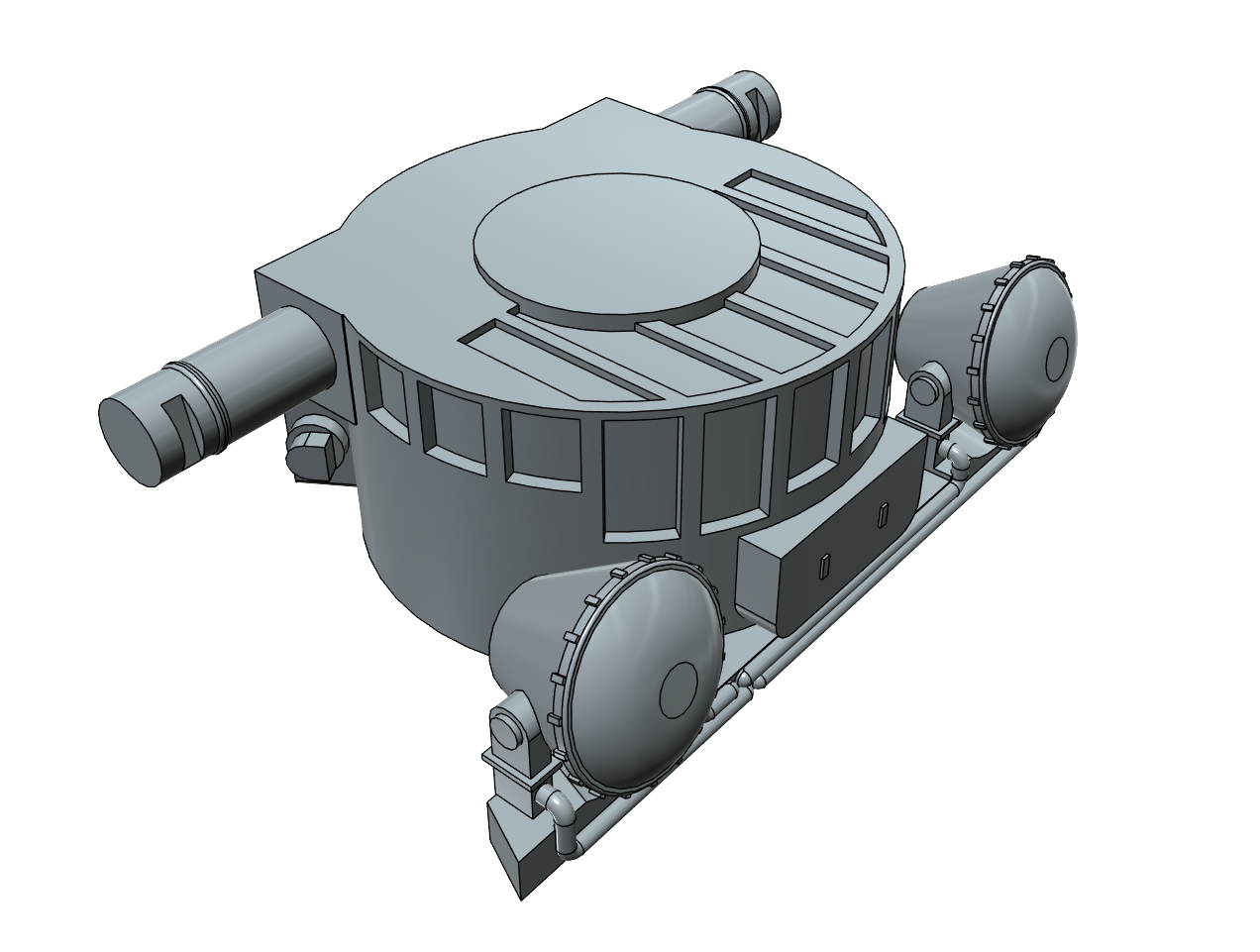

A set of four 3D-printed Mk. V HACS Directors are available for HMS Duke of York and HMS Howe, too, as well as Mk.IV directors for HMS King George V and HMS Prince of Wales, and Mk.VI directors for a late HMS Anson:
Thanks for all the kind compliments!

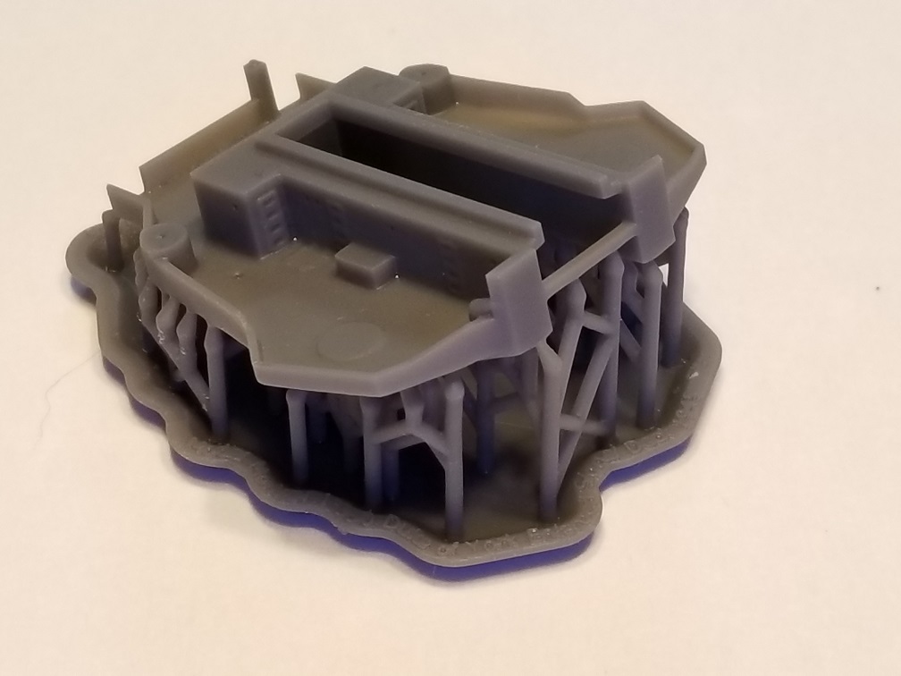

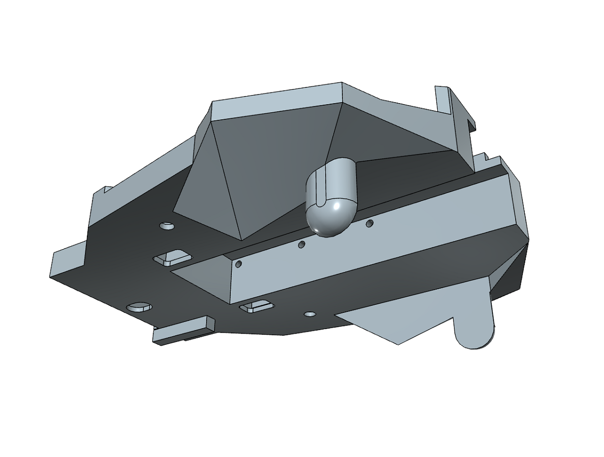

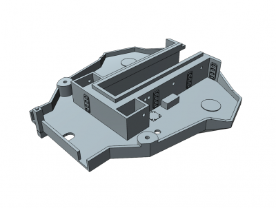

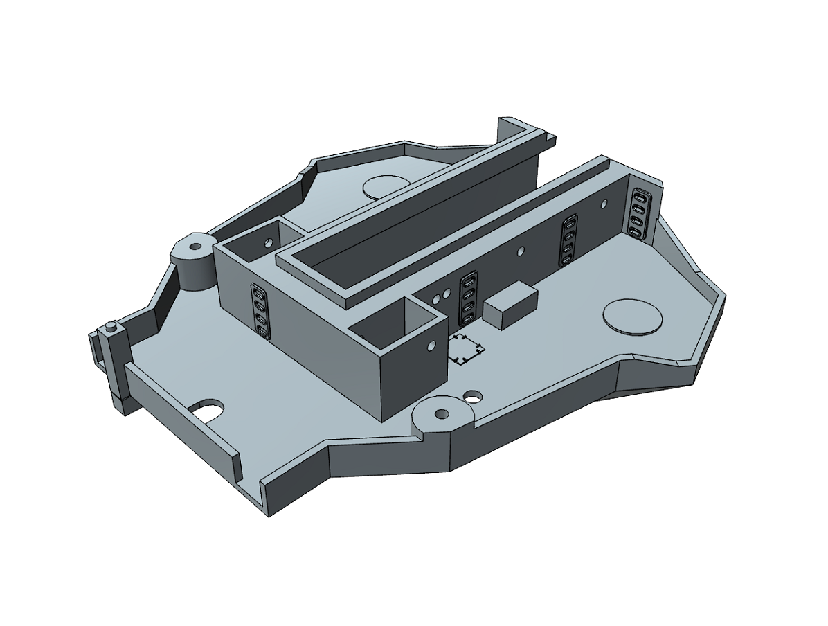

Here is a 3D-printed signal deck for HMS Duke of York for those who would like one to convert their Tamiya or Academy KGV kit. Anson's signal deck is also available. Anson's signal deck's shape is noticeably different than Duke of York's signal deck. This 3D-printed signal deck will replace the inaccurately shaped scratch-built signal deck installed on the model.
They are also available in 1/700, 1/570, 1/400, and 1/200 scales.
