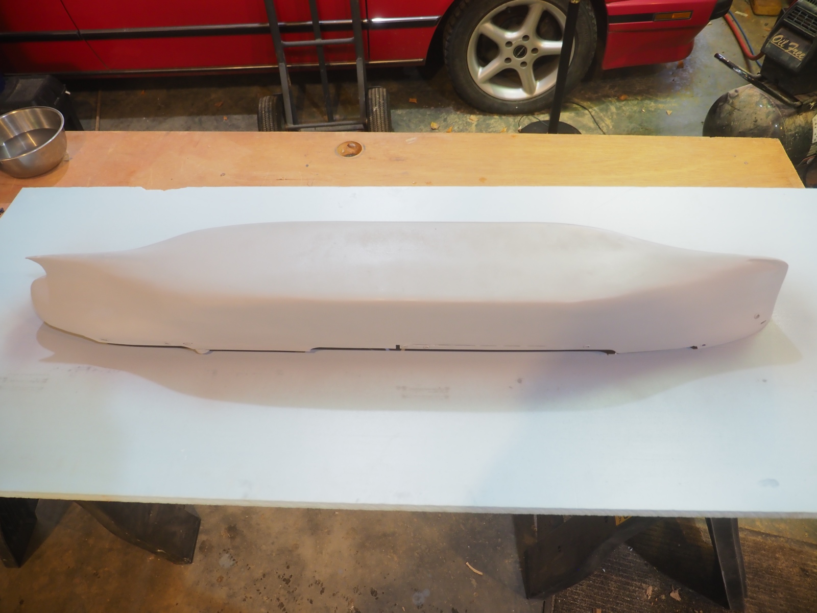

This particular project has a rather long history. Some 55 years ago I built an AKA using plans out of a modelers magazine for a C3 Cargo Hull. This sat in my parents attic for at least 40 years, and became well seasoned. I cut the frames from 1/16" plywood with my Dremel scroll saw I had at the time and planked with balsa strip. In retrospect the hull contours were quite good, but of course I had no recollection as to what the scale was. Some work with calipers and proper dimensions arrived at exactly 1:120. The only issue was the hull was too short? The reasons for that I cannot guess, but as the bow and stern were properly proportioned, a 7" plug in the middle solved the problem. It was a bit of a commitment when I turned on the band saw to cut the ship in half!

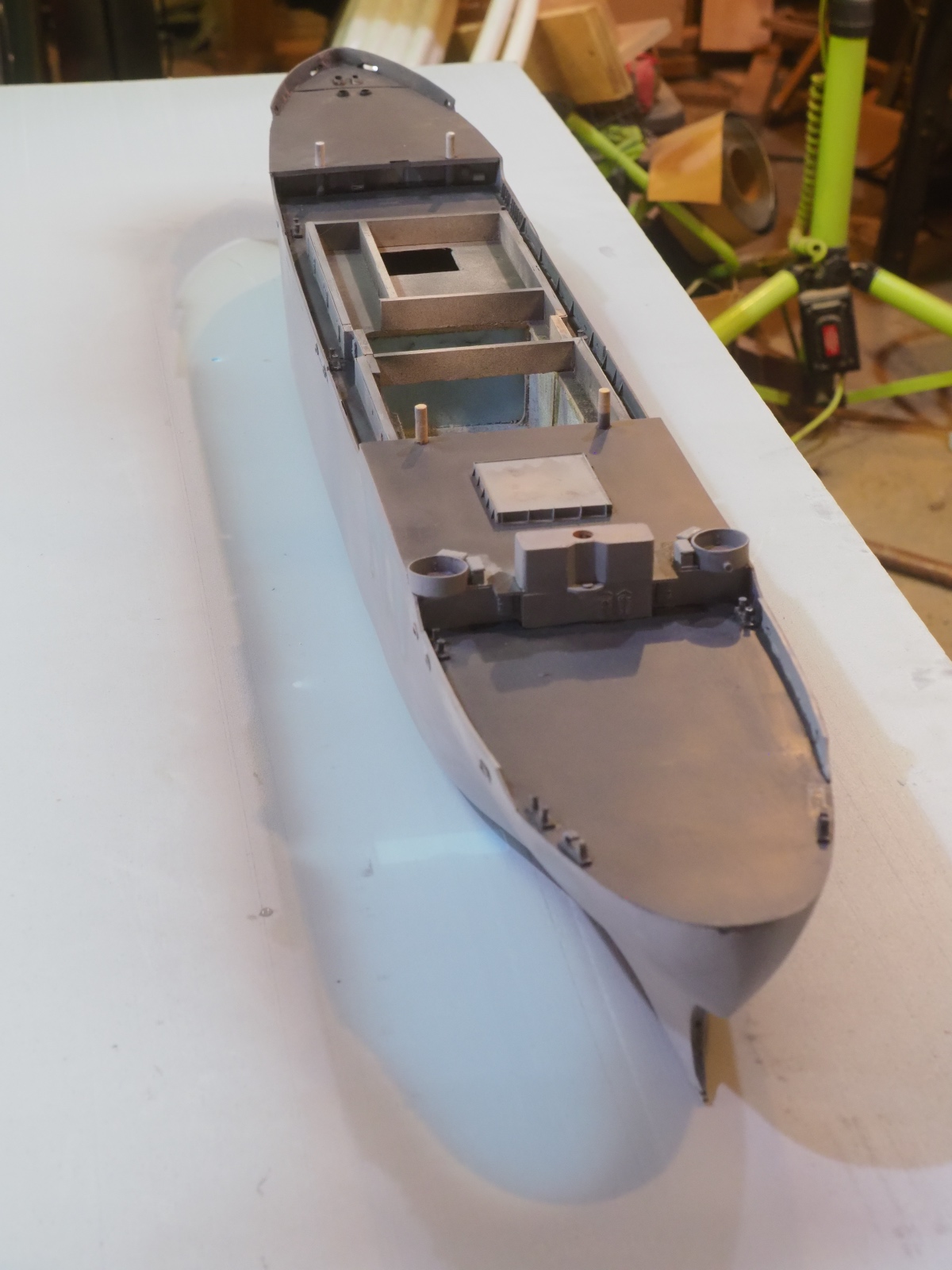

This is what the topside looks like at the moment. The stubs sticking up support brass King Posts which slip over them.

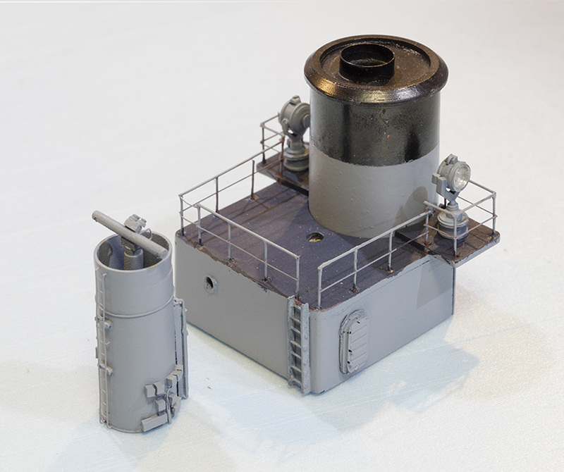

Posts: 5060
This has been a top down build... I started with the uppermost superstructure and than have been building down from there. The bulkheads are basswood, decks plexiglass, the stack a piece of copper plumbing pipe. I turned the stack top from two pieces of plexiglass, the stack opening is from a brass cartridge shell section cut off. The Search Lights are turned from Aluminum rod with a plastic lens punched from clear plastic. The rangefinder tower is also copper plumbing pipe. Rails are brass and steel wire.

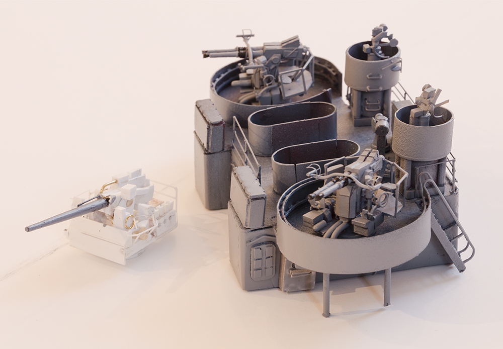

Photos always make everything look worse!
This is the Aft Deckhouse, 40 mm's, directors and the as yet unpainted 5" 38.
Bulkheads, Basswood. Deck and bulwarks plastic and Strathmore. Barrels wood.

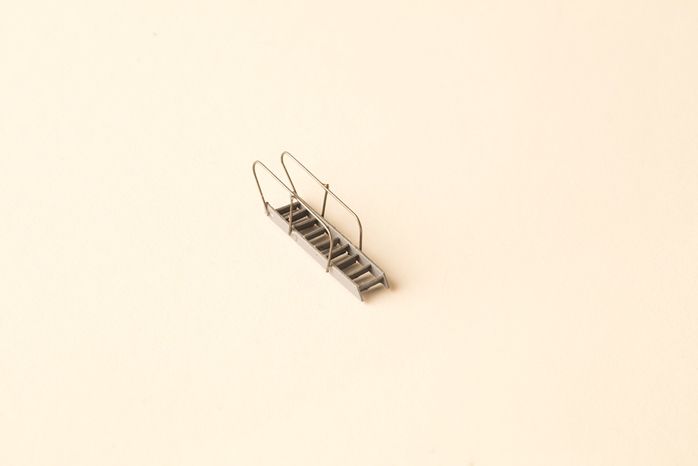

The ship has a plethora of inclined leaders of various types.
This is one, constructed of Strathmore Paper and Steel wire.
